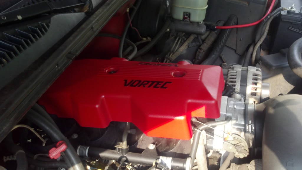

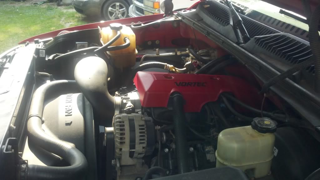

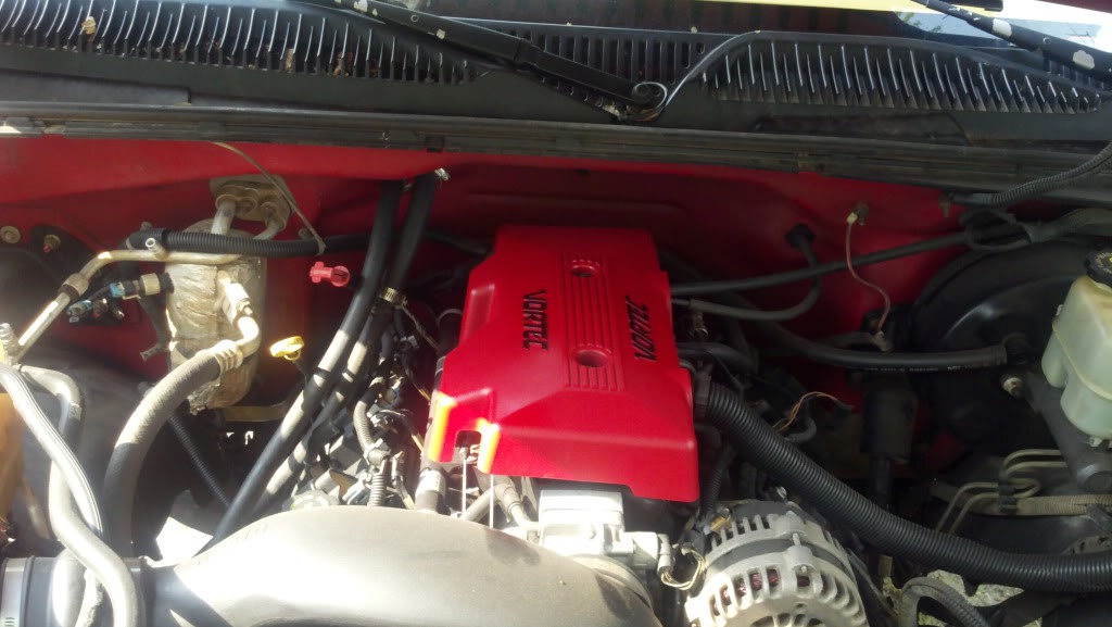

Not much going on today so decided to spruce up my cover. Best part bout it was i got paid to do it....turned out ok for a spur of the moment job with stuff we had on hand to use. Cell phone pictures suck tho.

Looks good. Did u sand the texture off before primer?
Old May 25, 2012 | 05:34 PM
rj2's Avatar
rj2
Joined: Feb 2011
Posts: 272
From: indiana
For the most part. Then used filler primer and sanded that smooth before color
Old May 25, 2012 | 05:51 PM
smoggist's Avatar
Joined: Dec 2011
Posts: 171
From: Bow Island, AB
Sounds like the same process I used then. What'd u use for the lettering? When I tried it looked like **** an I ended up repainting the whole thing.
Old May 25, 2012 | 06:12 PM
rj2's Avatar
rj2
Joined: Feb 2011
Posts: 272
From: indiana
Just masked, papered, and cut around and air brushed a couple coats of gloss jet black
