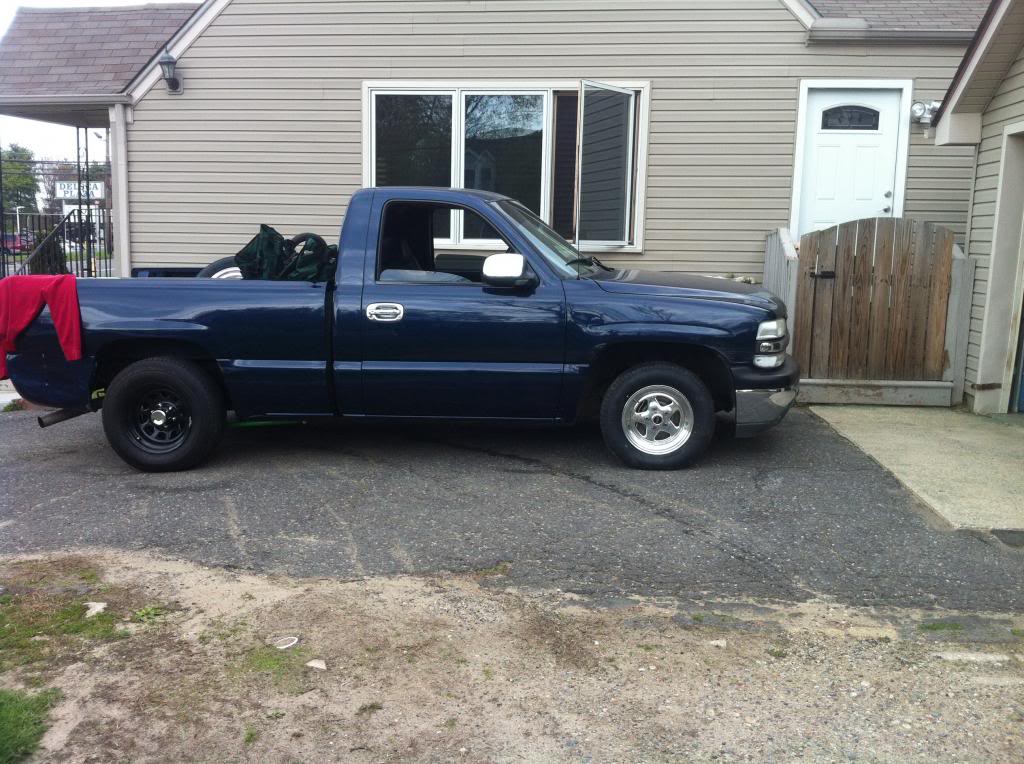

My trucks current stance.... The fronts are a bit smaller then the rear by 1.5 but even with regular tires/wheels it is really raked out... I will try to figure out how to get these pics to post bigger.

Trucks current stance with the drag setup, and street wheels.

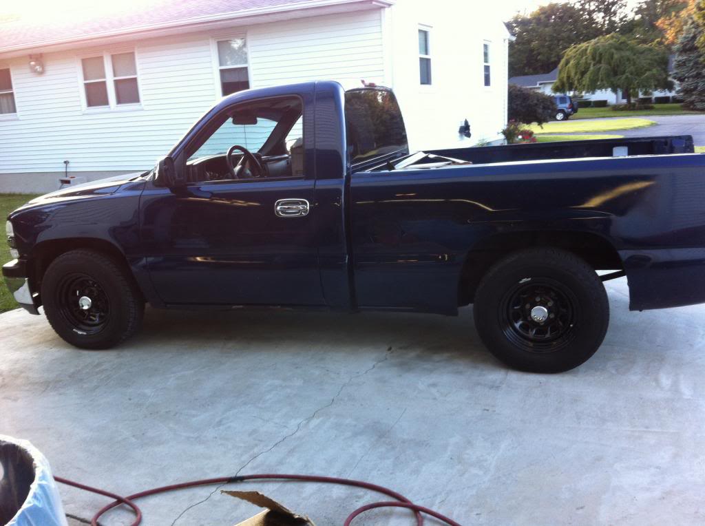

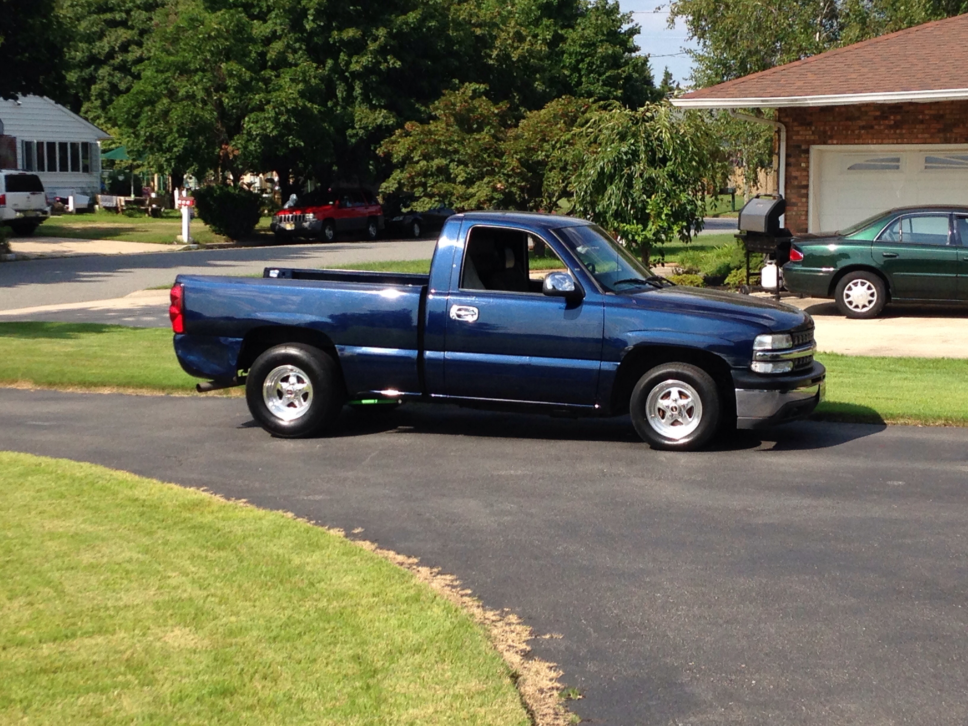

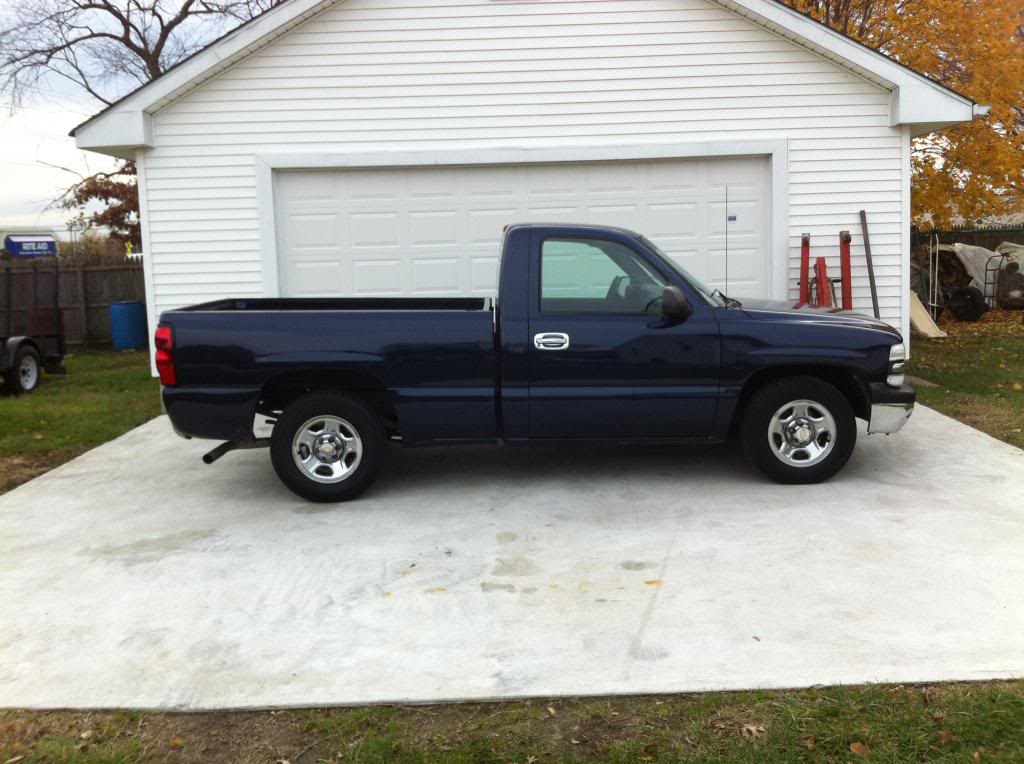

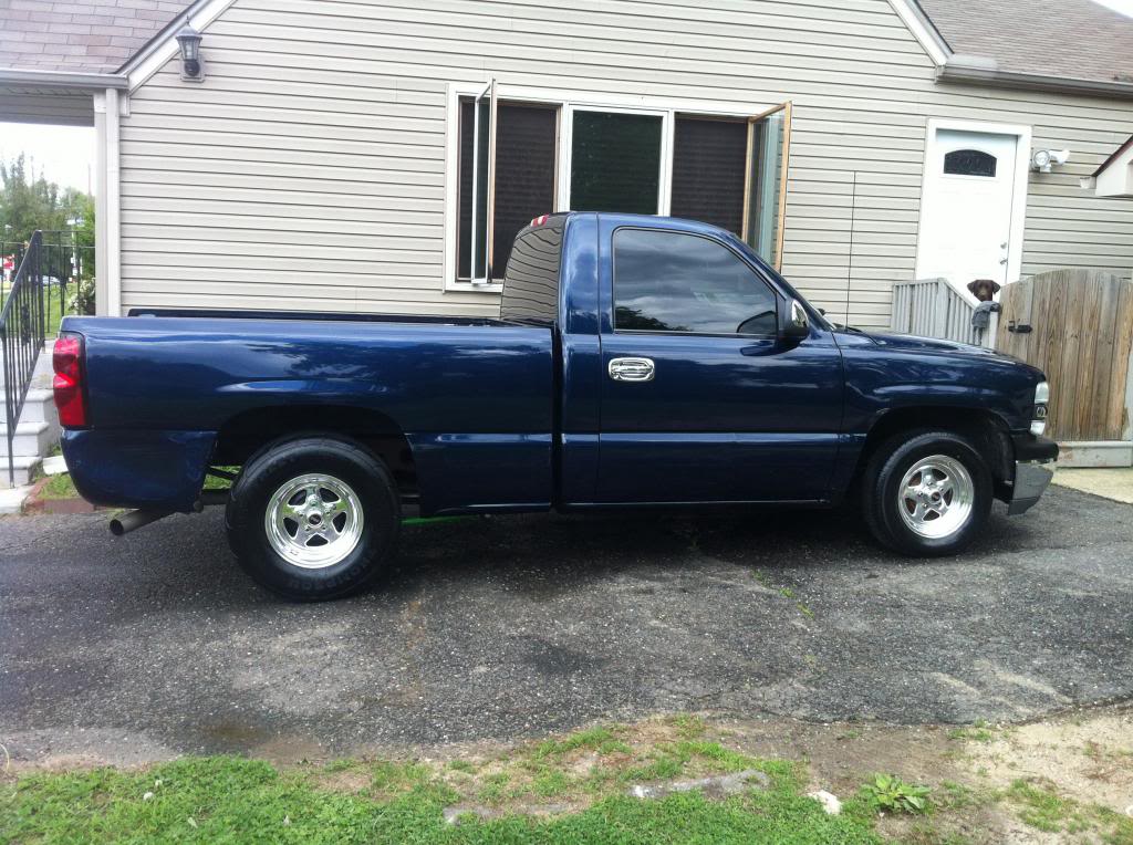

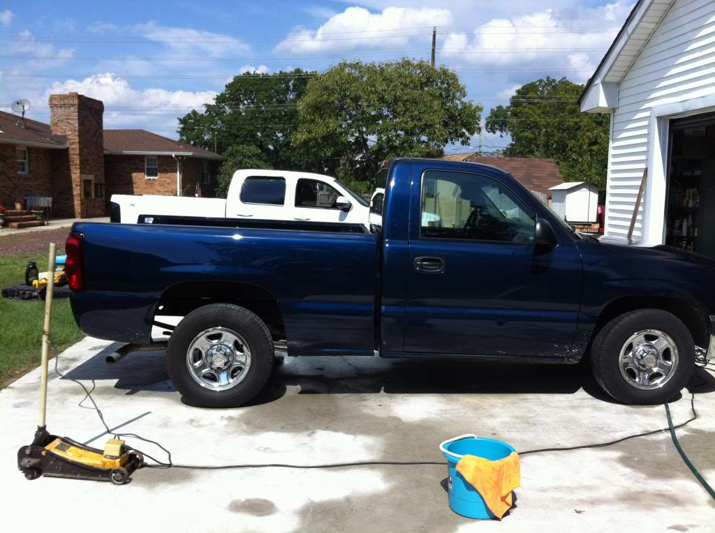

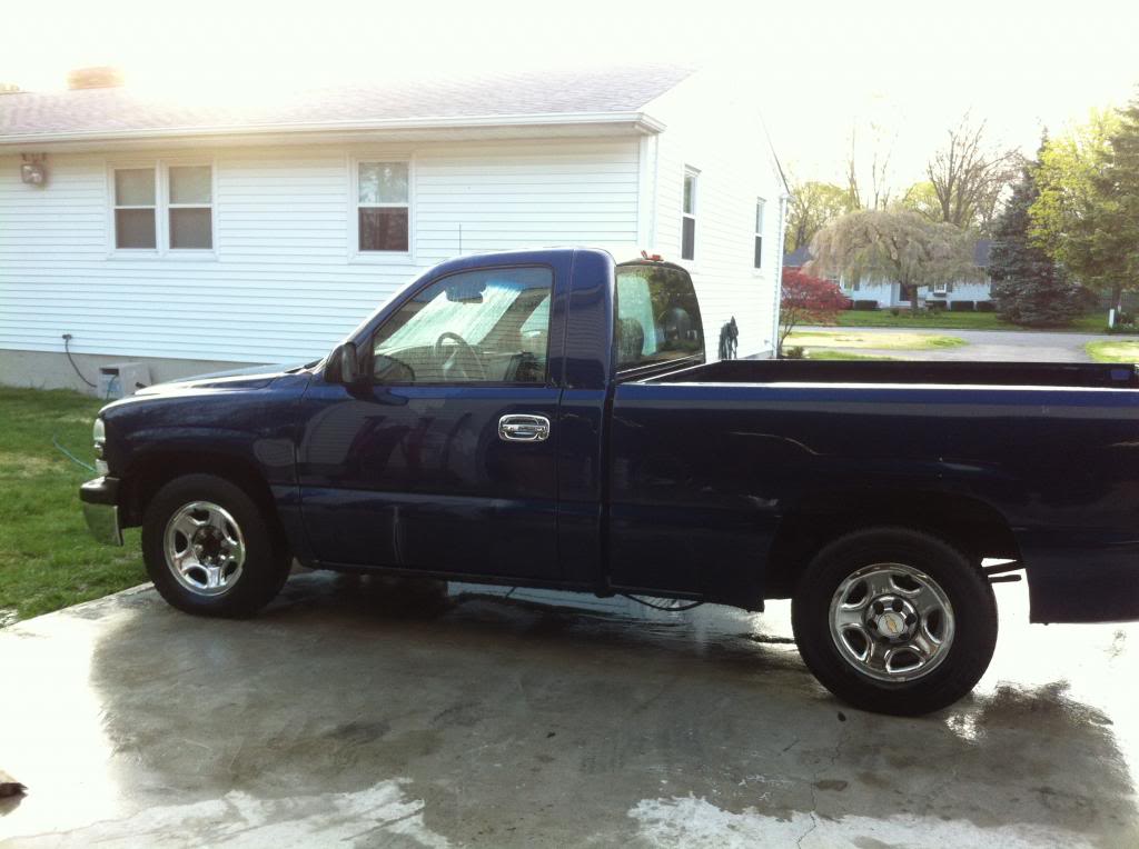

But just to give you the idea I was trying to make, I lowered it 3" in the rear and the nose still drags the ground....... I know the front tires are small in that pic, they were my spare until my proper sized wheels came in. But you get the point lol

Damn I see what you mean, *** sits way to high compared to the front.
What size tires do you have on it?
Best bet would probably be a flip kit in the back with a 1" lift shackle so you would be at 5", or if you only want 4" get hangars for the front of the leafs.
Then figure out what you have up front, and what you want to do. 2/4 and 3/5 both sit pretty level. If you wanted 2" up front get stock springs and put spindles on, for 3" spindles and a 1" drop spring would be good.
If you wanted to do coils you'll have to measure at your desired ride hight first so you can get the right size shocks.

Tired are stock size, and I already lowered the rear 3" in those pics....... Do you think that someone installed 2" springs bin the front and never dropped the rear? Or should a 2/4 sit lower in the front then it currently does now

Ya it looks like they might have, for reference here is my truck when it was stock on stock size tire (29" tall)
And here it was at 2/2, rear sits higher than the front, a 2/4 drop would be level (maybe a tad rear bias).
