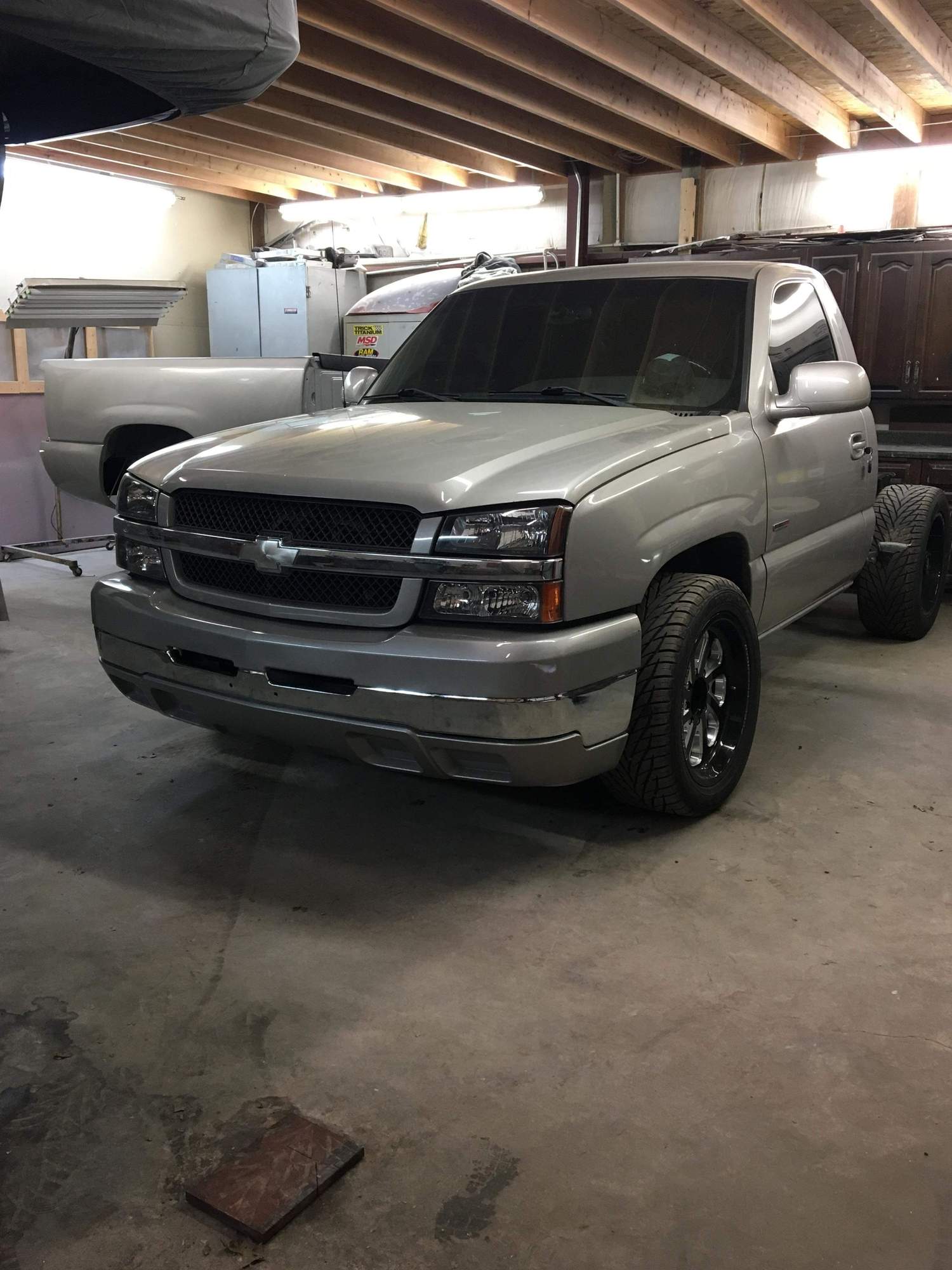

Lly korey Willis dsp5 fass150 s&b intake larger intercooler tubes rbp header 4 inch downpipe stock turbo thays about it. Everything was moved forward and rear of frame was cut. Its a tire shredding machine

Thing is beautiful! Is it 4x4? and did you keep the alison?

Nope its a 2wd and yes has the Allison stock for the moment built trans is next on the list and I'm considering coverting it to 6 lug so I can run some oem 20s to make it look even more like a half ton

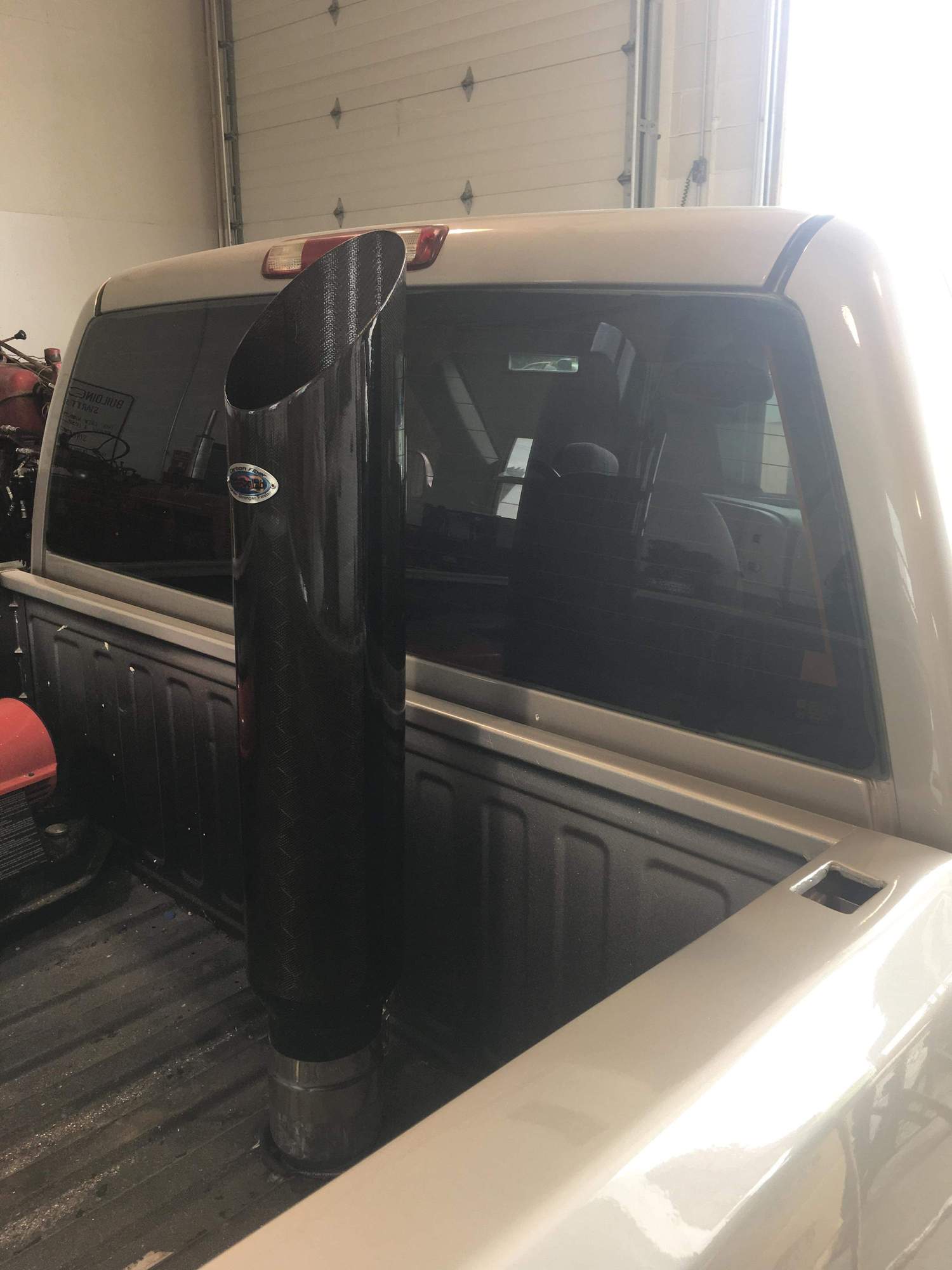

That would be pretty sneaky but I think the stack gives it away a bit!

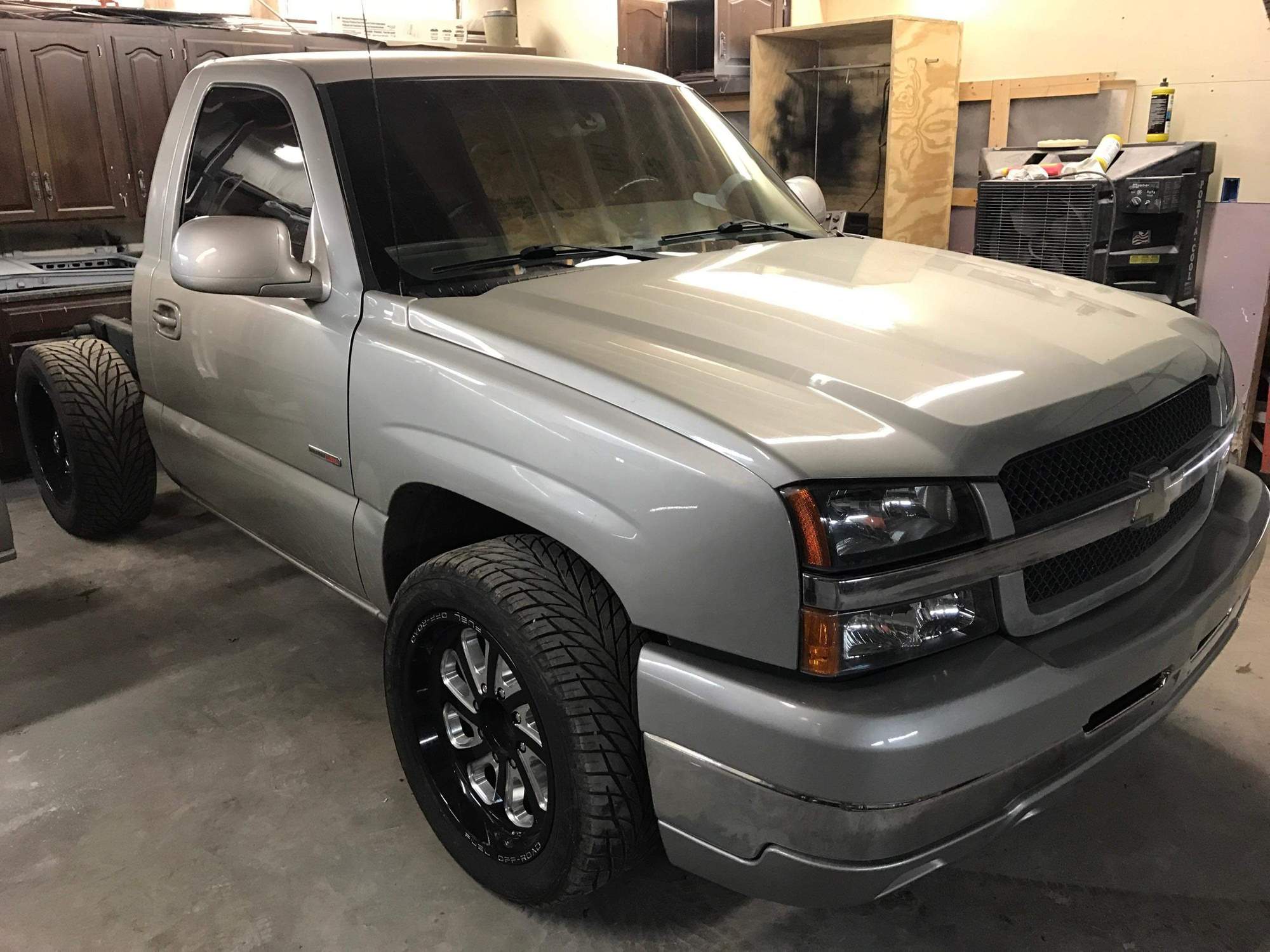

2 inch shackle on rear spring removed bilstein shocks front de cranked flipped tie rod ends drop shocks rides like a covered
Wagon I will eventually 4 link the rear

The step side would really make it look like a 1500.
I think the 2wd HD front ends are easy to convert to coilovers which would help ride quality a lot. What rear end is it Corp 14? did you put in a locker or anything?
