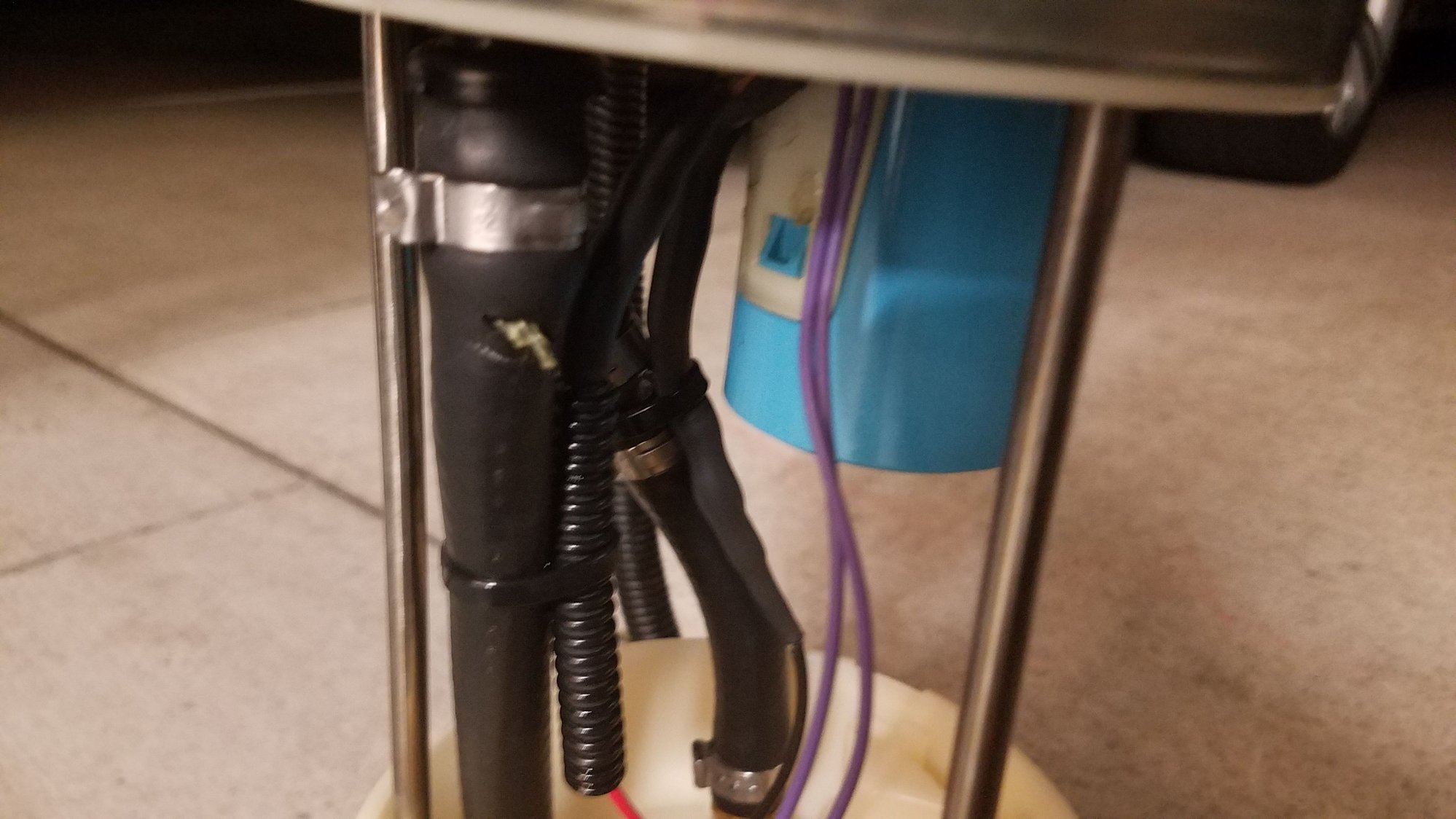

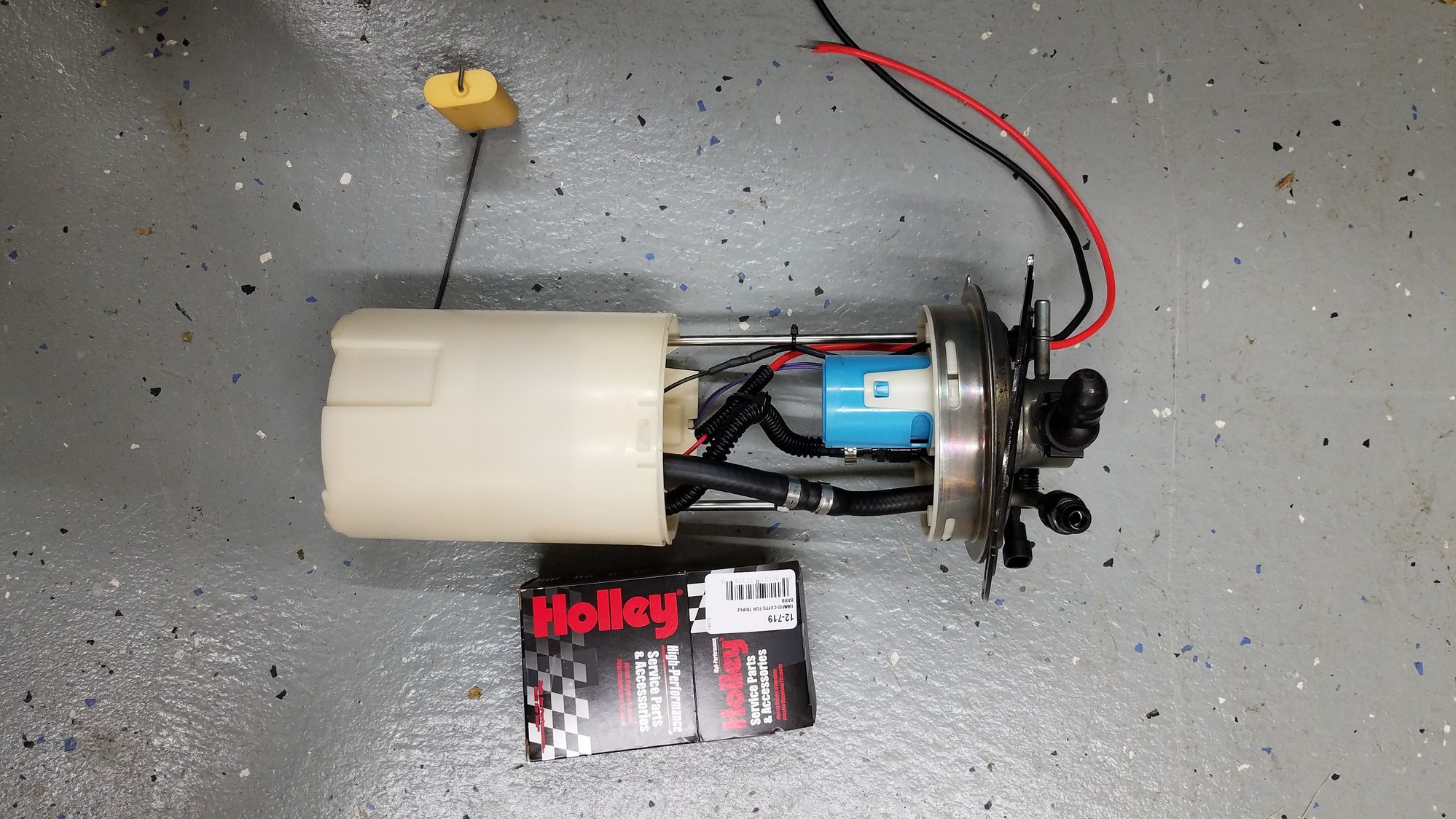

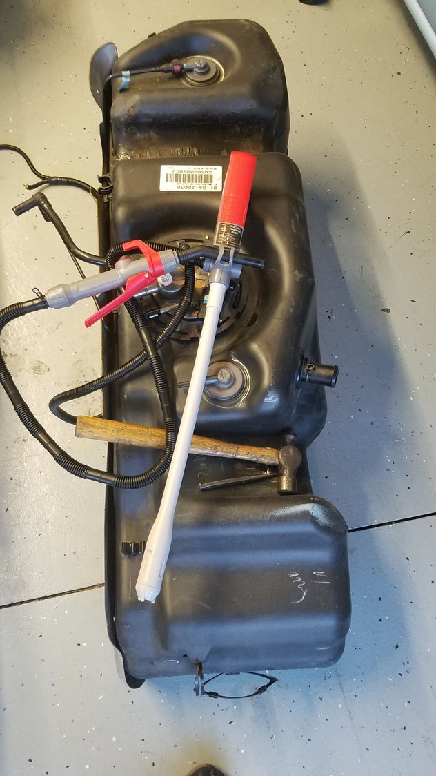

Up to 14lbs... I'm going to add a little bit of timing and call it good. I think ive had the fuel tank in and out 6 or 7 times. Ditched the gates submersible hose for holley, not saying the gates hose is bad, I stretched it way out to fit the hose barb fittting i had and expected it to fail, but it failed sooner than i thought it would...Ditched the intank plug for walbro 450 fuel pump which failed and soldered the connections with heat shrink wrap. Cut a piece of the stock fuel line to cover positive wire splice.

Limped truck home on 25psi of fuel within half mile of home, then towed it home with my zero turn mower in the pouring rain.

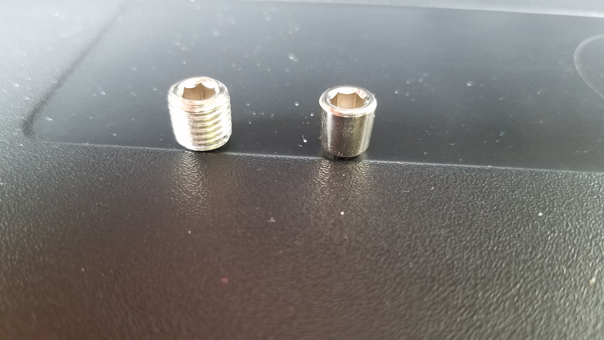

Blow off valve was an easy fix. Plug on the right is what came in the box... missed getting the threads rolled. I emailed turbosmart and they sent a new one free of charge. Tried to find one locally but it must be BPT. I had it just forgot to put it in.

Do you have any pictures of the fuel pump wiring passing through the fuel hat or bulkhead? Very nice build BTW

I either got it from summit or Amazon. It didn't come up in my Amazon search tho. They are called cable glands.
