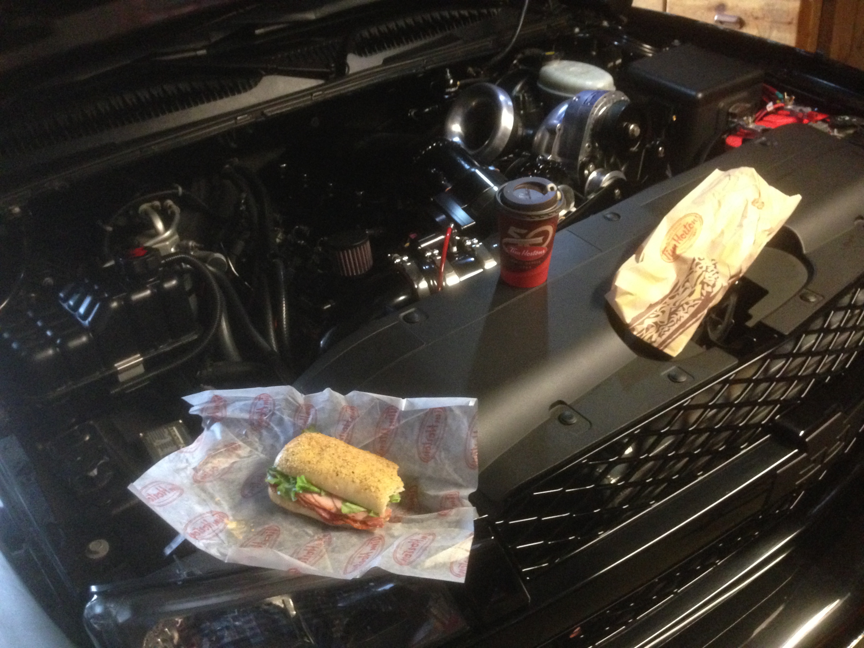

no updates really.... truck is just sitting in the shop till the weather gets better, then i can get it tuned and drive it

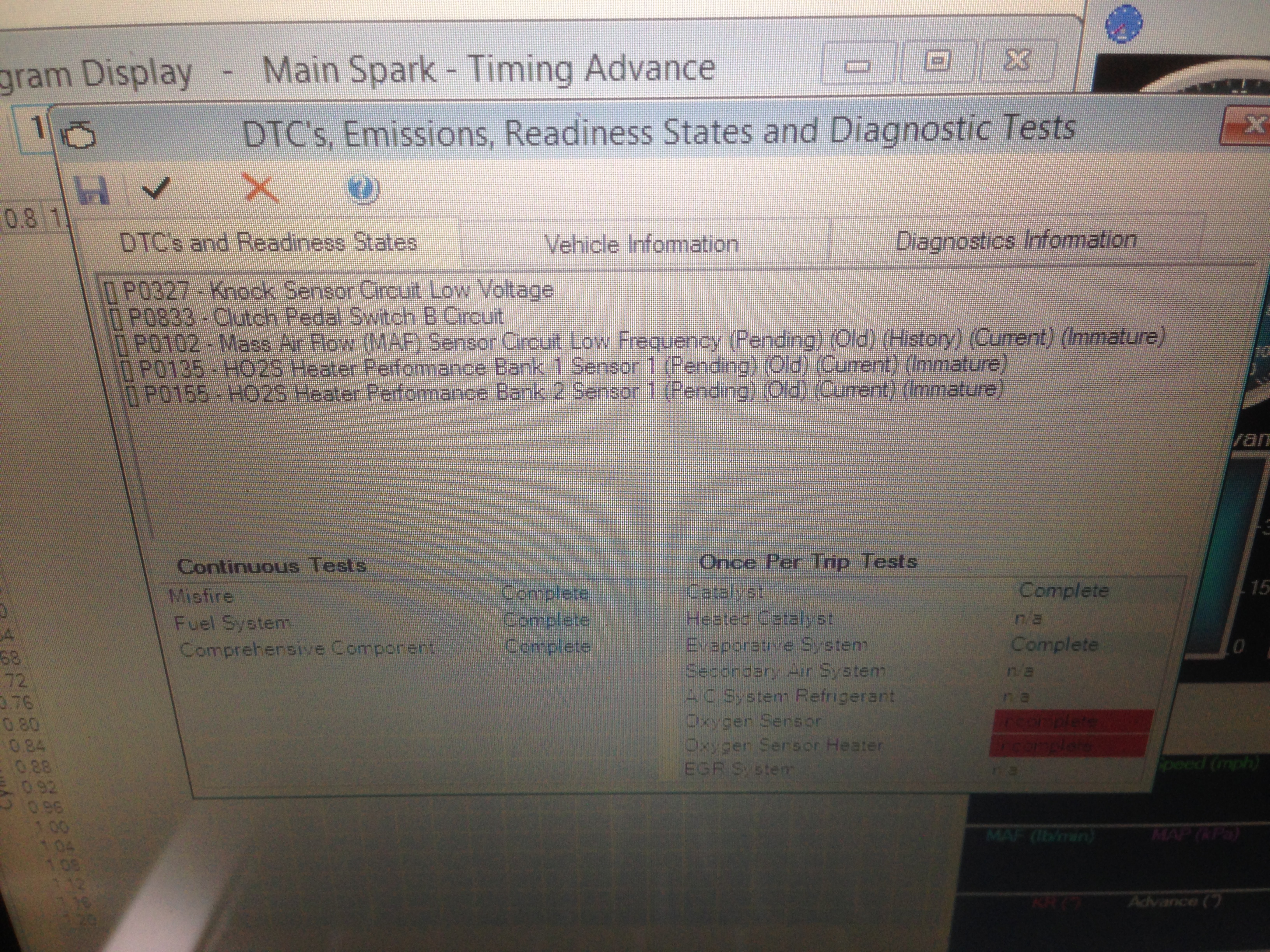

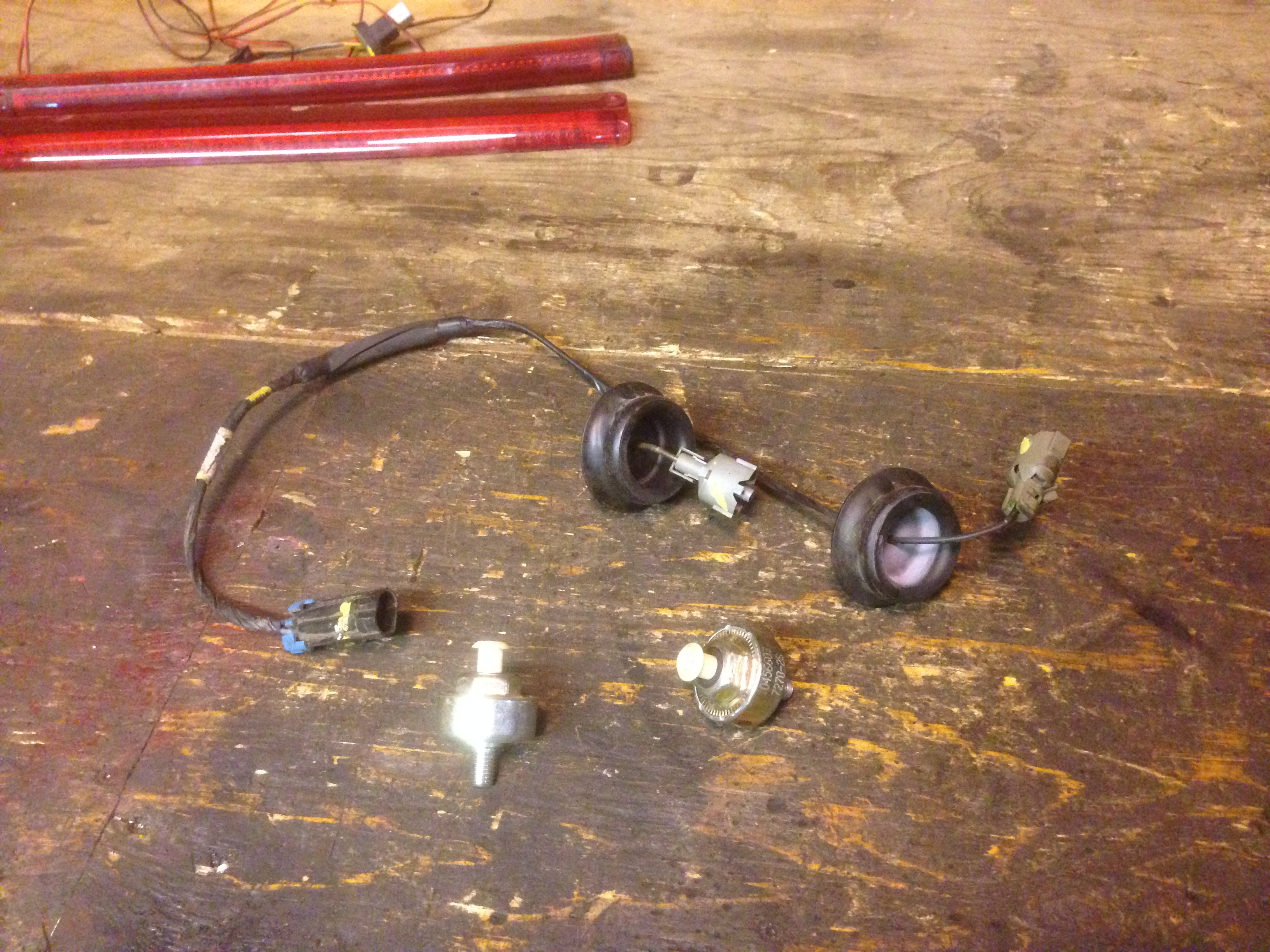

was getting cel p0327 for knock sensor low voltage, after pulling everything apart saterday i found out the rear knock sensor was broken.
got some knock sensors and harness from the wreckers, got them in and everything is working great now.

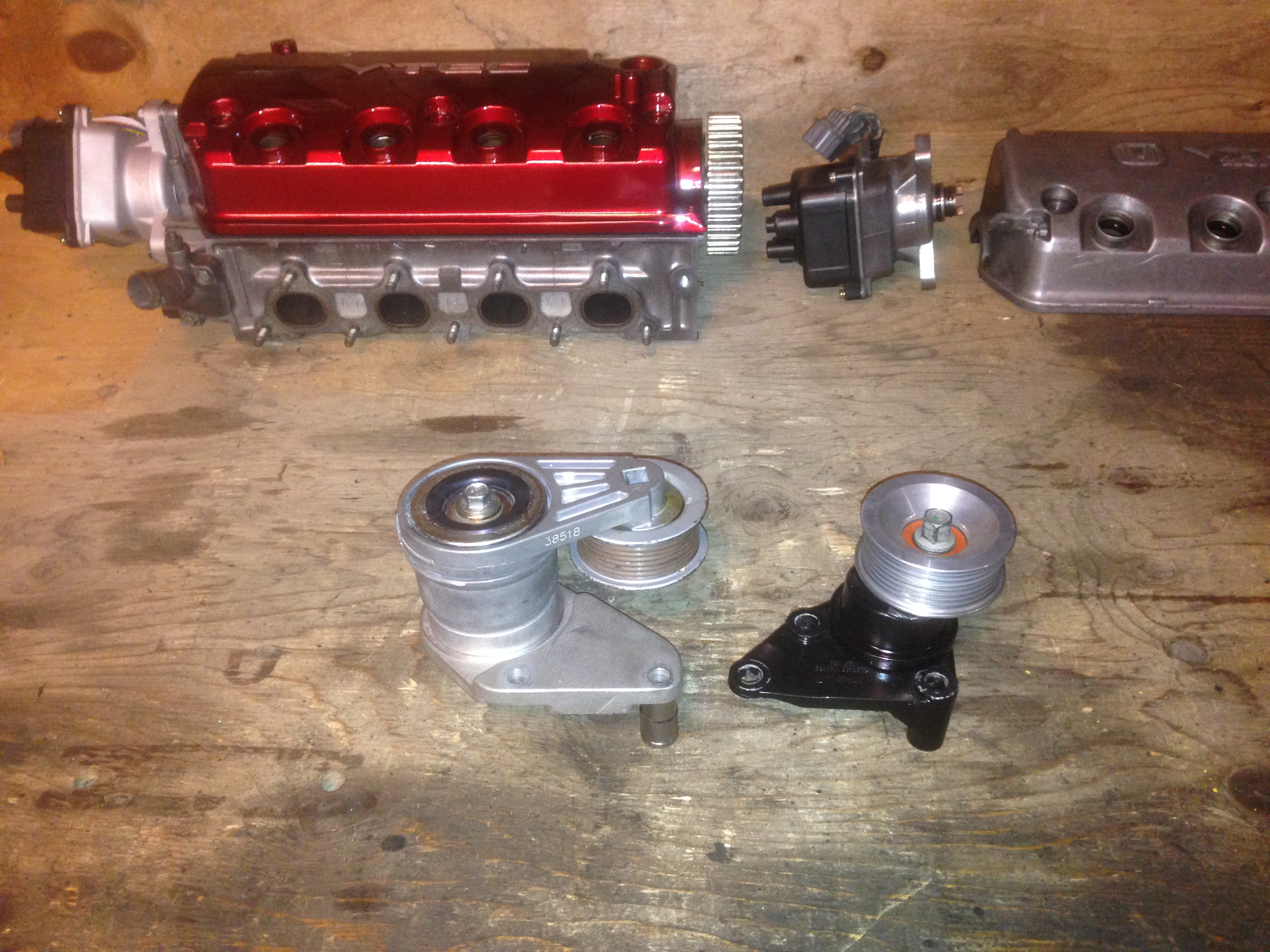

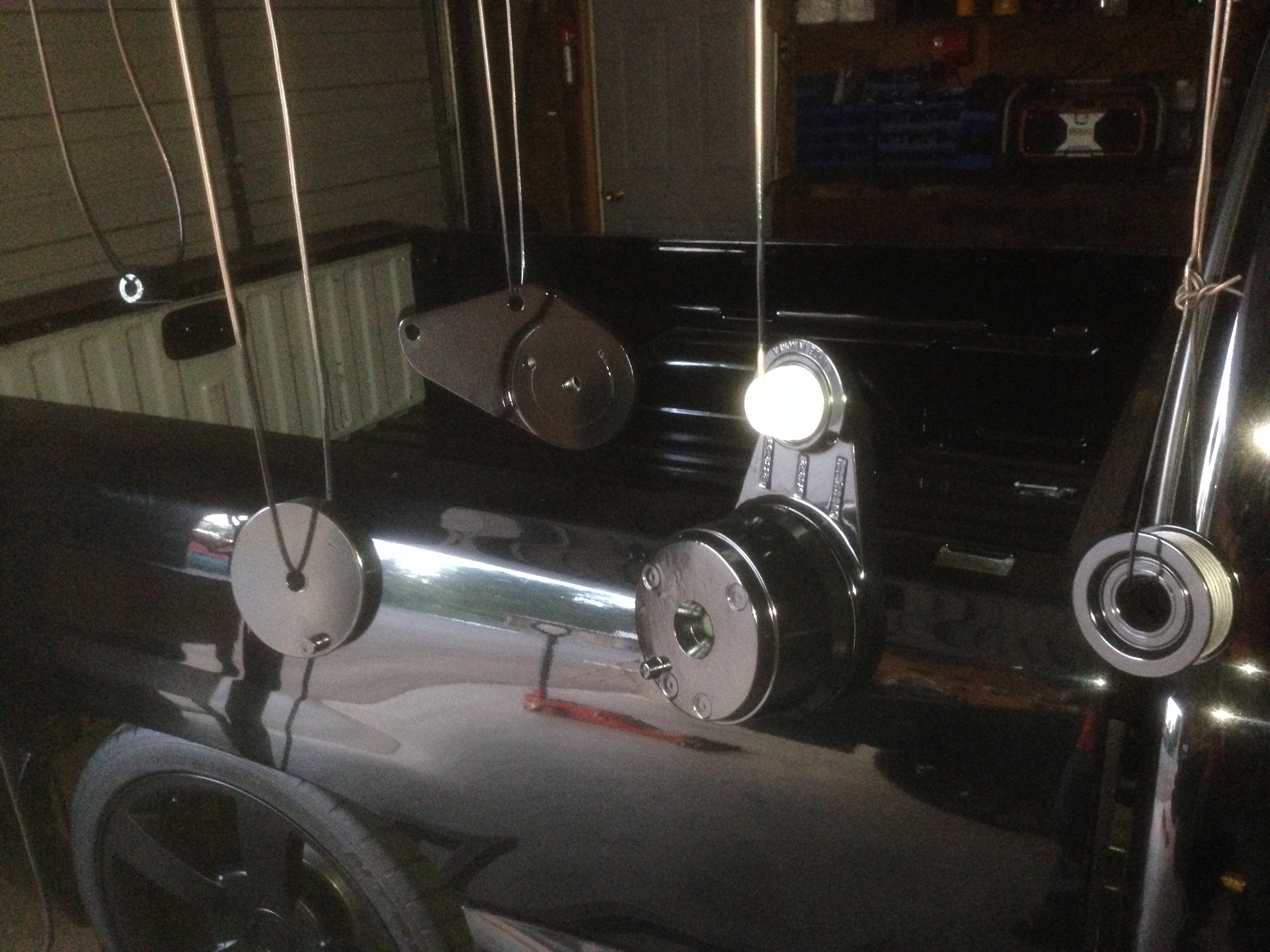

picked up a hd tensioner from member jg53, thanks again man.
did a test fit to figure out how long of spacers i need to align the tensioner with the belt, going to paint it and get it back on this weekend.

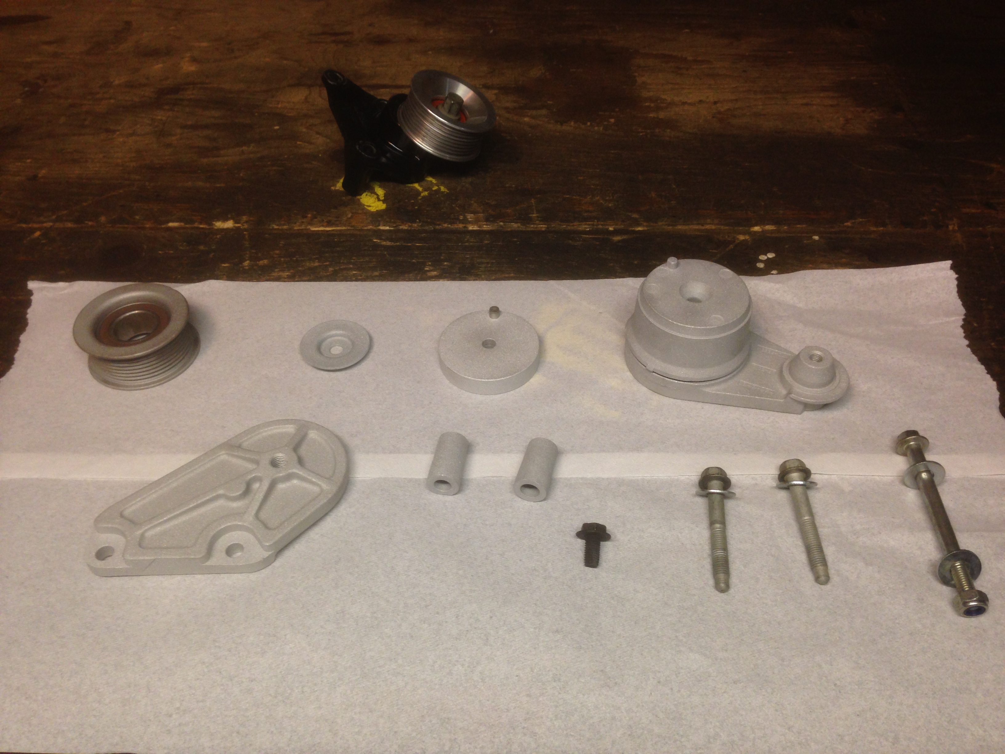

made some spacers and sand blasted the tensioner today, did another test fit before i paint it black.

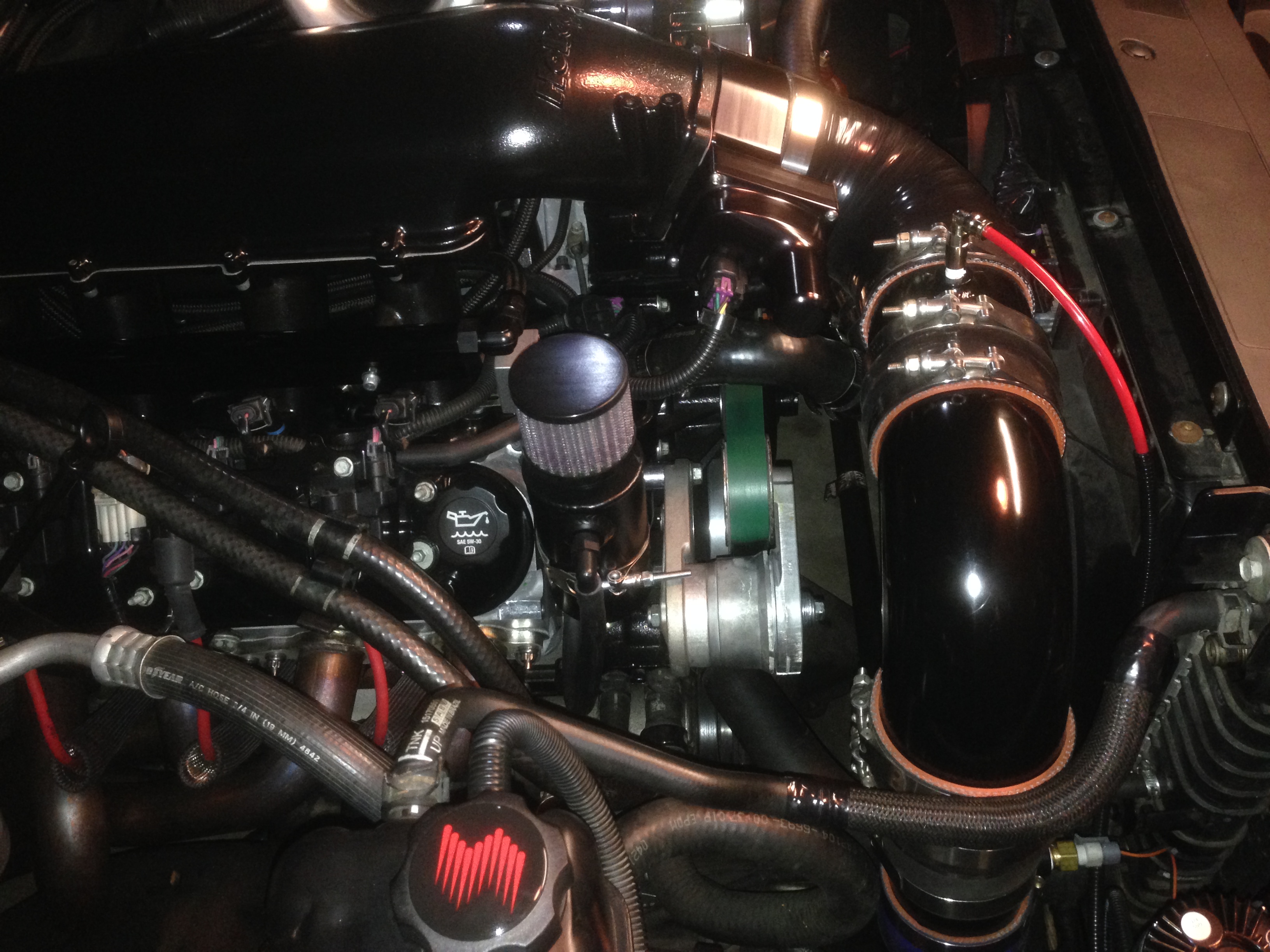

finally painted the hd tensioner.....

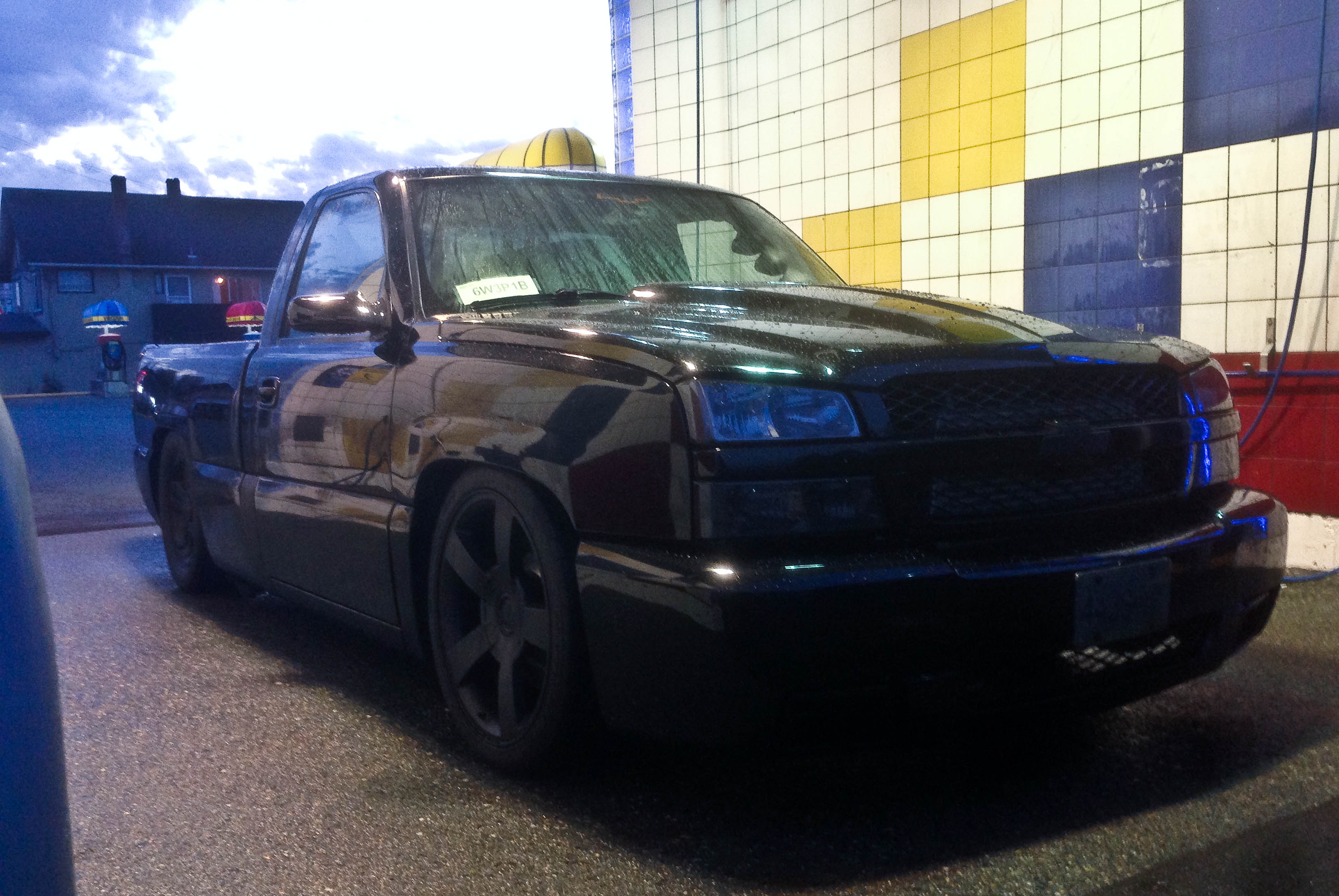

drove the truck today with the et streets, hooks up pretty good and holy **** is it fast
