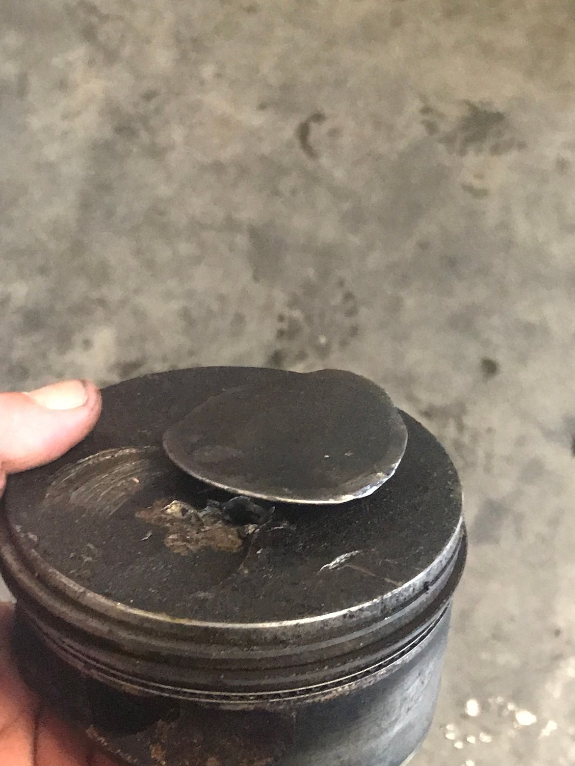

So to start I got a steal on a 6.2 (l92). It dropped a valve and ate the piston. Got lucky and made no contact with the cylinder .. Head on the other hand got trashed.

and here is the damage the 6.2 received

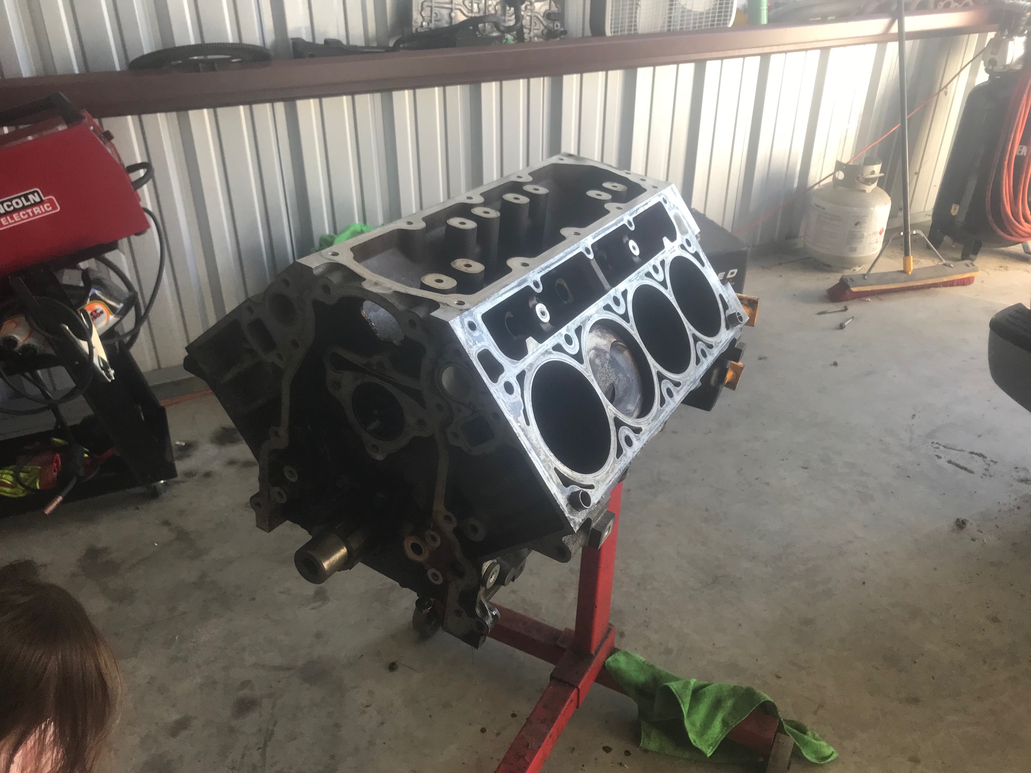

Well little update, nothing big. Machine shop called blocked is all cleaned up and was deglazed. Cylinder that dropped a valve I guess did hit the cylinder. Has one tiny scratch can barely feel it with his nail, machinist said if it was his he would run it... He is very reputabled so I may just roll with it. Still debating it really.
