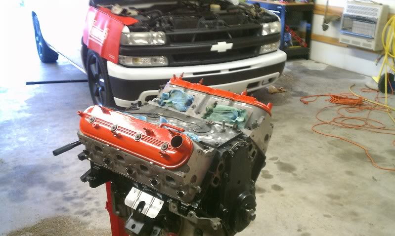

The only accessory I removed before I pulled it was the ac compressor I just left it laying on the frame hooked up. The power steering pump I just unhooked the lines from it. I got all the way to the top and the end of the water pump caught the end header(pictured above), I had lower the motor some and remove it.
Dayumm. Thats a tight squeeze! I've never pulled or put a motor in with the accessory brackets on.
Going in tomorrow

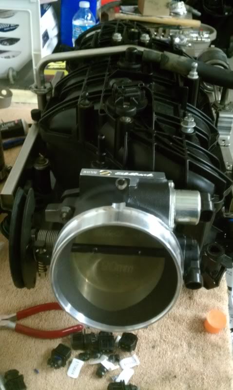

Tbss intake with elderbrock 90mm DBC throttle body

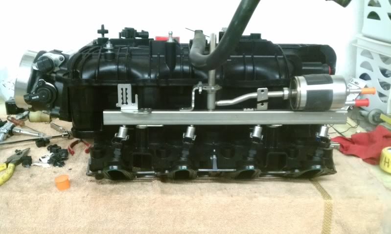

Also used the vette fuel regular/filter. Had to cut the bracket and bend the line it plugged into to make it go on though
