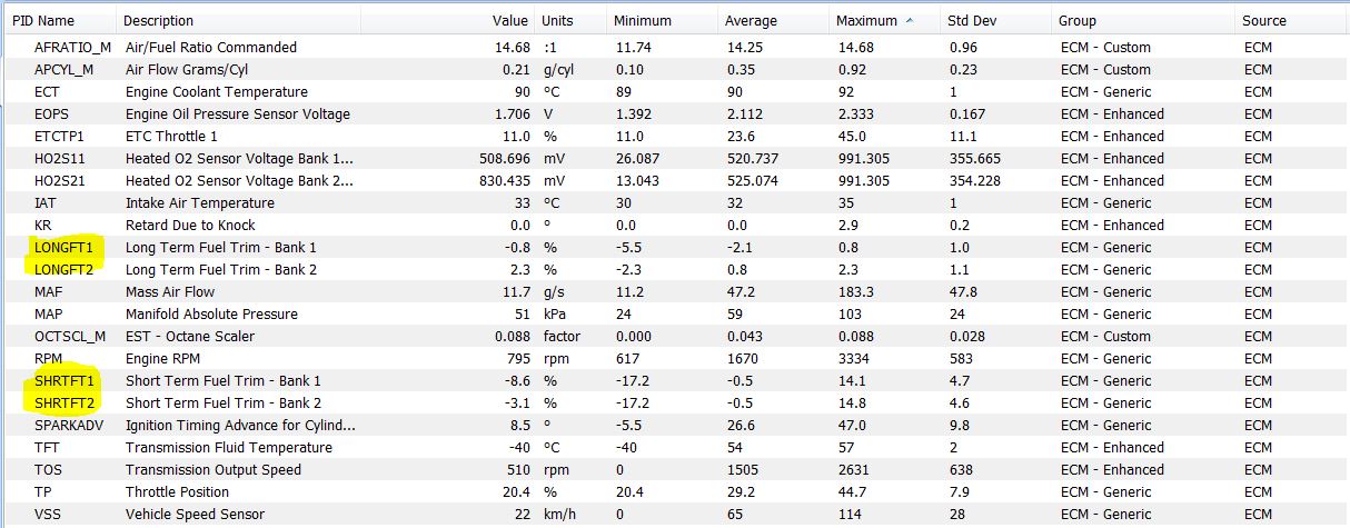

Got a P1175 code...been reading about it...lots of things could be it...

See if you can attach a log file. It would be a big help.

Attached is a scan of my EFI live scan i did few days ago last time i drove it.

idle only scan

Im not any good at this, tried to pull up a summary of the driving around.
