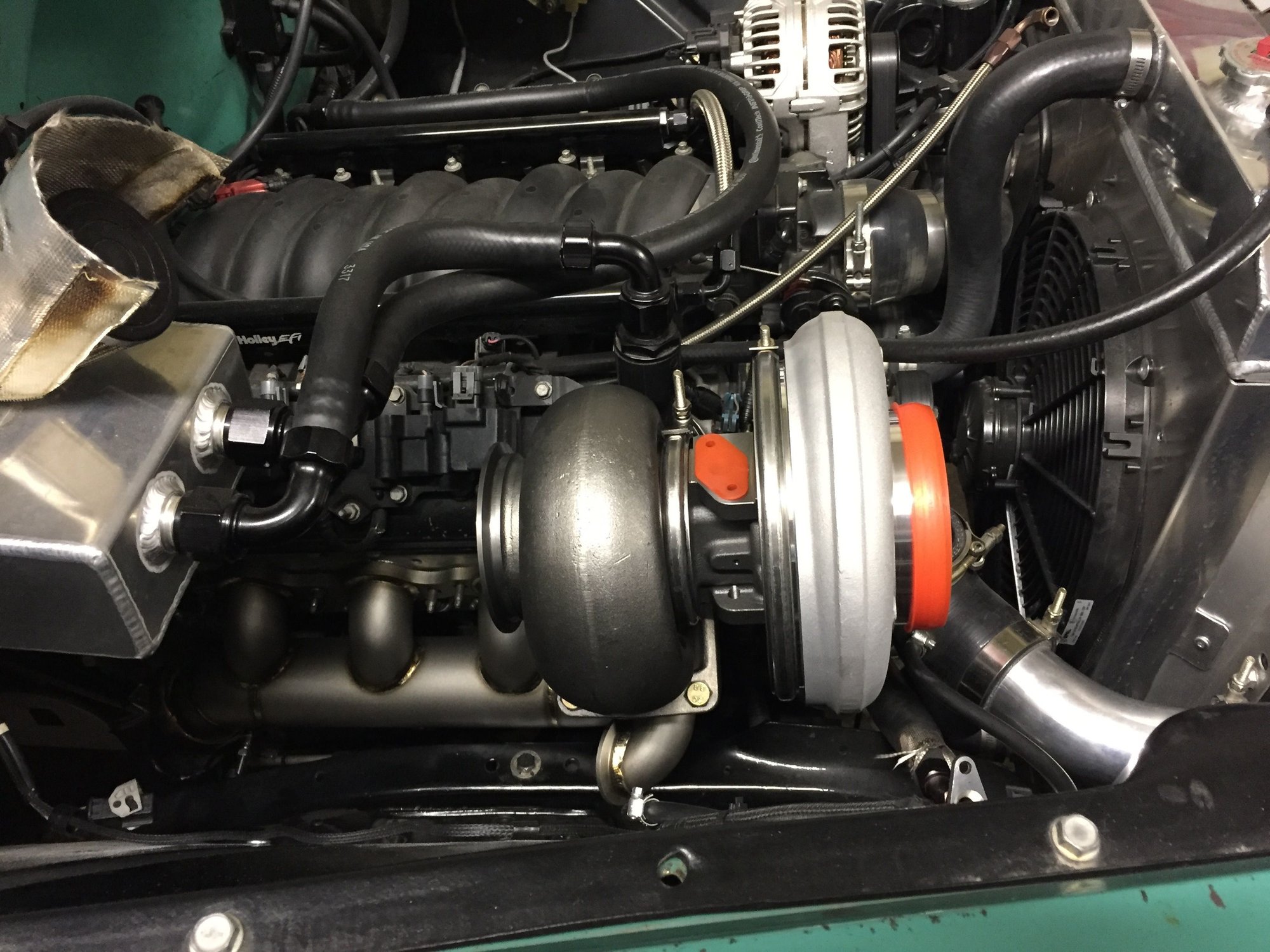

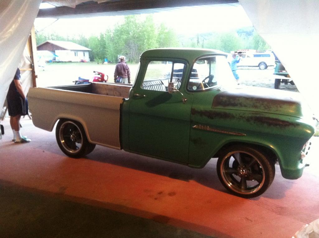

I have been working on this for the past year and a half: 1955 chevy pickup, 2nd series. I currently have a 93 Fullsize Blazer that I LS swapped a few years ago and is my DD, I needed a truck and figured a turbo LS is the way to go. Turbo piping isn't optimal but it seems to be doing great, frame is a bit narrow for the 99-07 log manifolds.
Got it running and have been making laps around the neighborhood, but still needs a tune and a few things finished up before i beat on it.

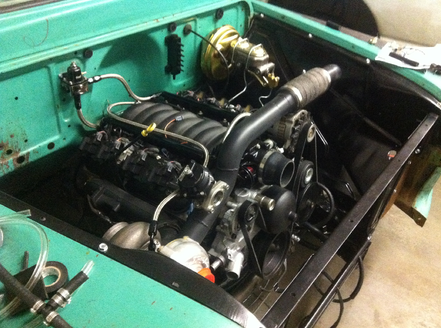

2004 5.3 engine with "317" heads, upgraded valve springs, push rods, melling oil pump, head studs, ls6 cam and an ls1 intake.

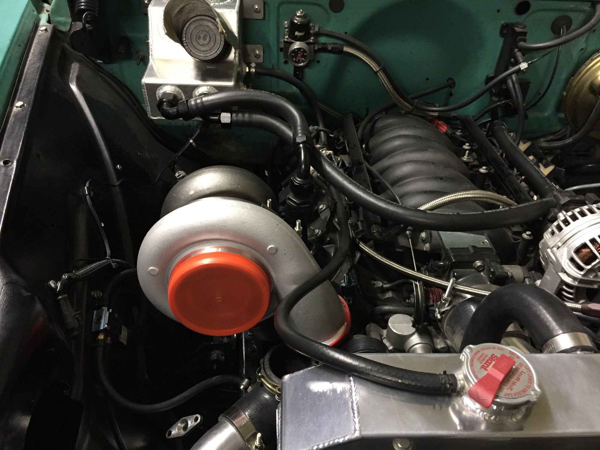

Home built turbo kit using flipped truck manifolds (Ceramic Coated)
Home built downpipe into magnaflow 3" muffler and dumping under bed.
70mm on3 T4 turbocharger, May switch to a master power t76.
Precision 38mm waste gate
50mm BOV

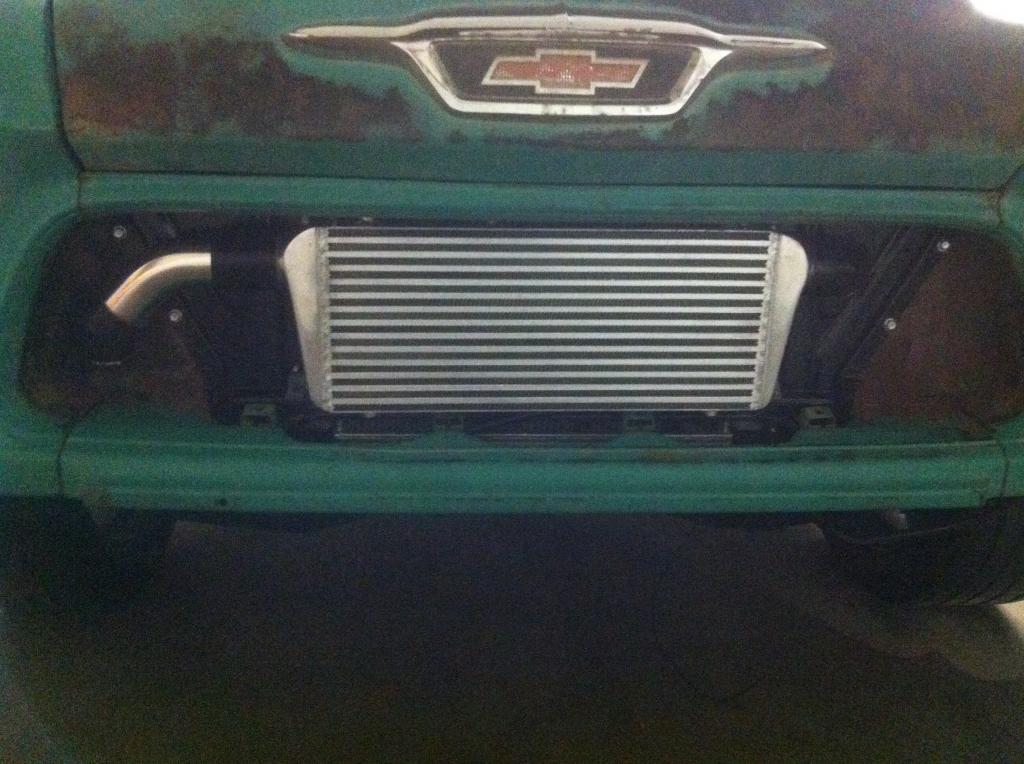

Front mount intercooler 31" x 11" x 3"

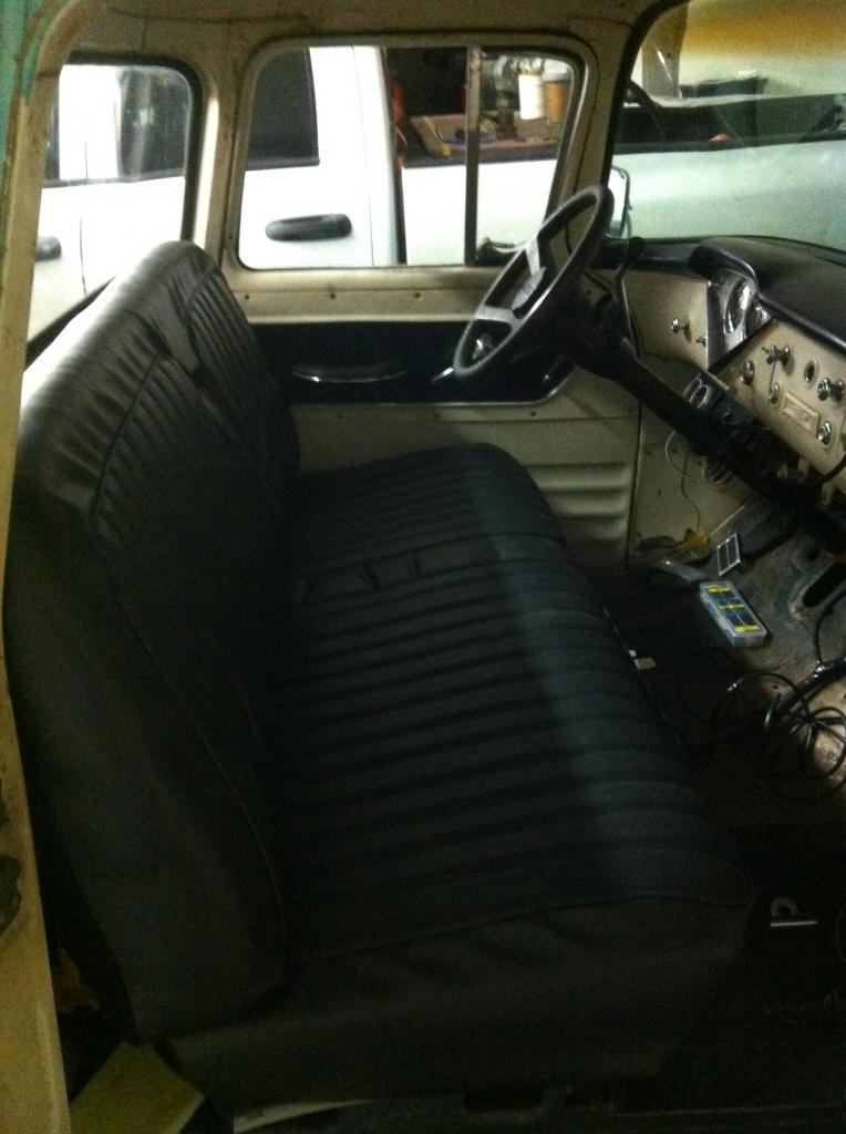

70's van column, 94 chevy truck bench seat.

thanks guys, im currently out on a remote job working, should be back home in august to wrap things up, Blackbear is coming to alaska around then so perhaps have them tune it in-person. definitely a huge project building from the ground up basically, never thought id see the day it would drive lol..
So I got bored of the 70mm and swapped in a master power 76mm, then got bored of that and put on a meth kit and a on3 7875 along with a 4L80e swap. Now I have gotten bored of the low compression 5.3 and stock cam setup.
I did switch out my “custom” top crossover to a more conventional log setup but it was built by some backwoods “performance shop” in Pencilvanyia. I ended up pulling it off 4 different times to fix cracks. It actually ballooned due to the thin tubing. I bought a Huron log manifold and a tbss driverside manifold. Built my own crossover. In addition I picked up the vs racing s475 t4 clone. I was just gonna slap it on my JY 5.3 setup but I think she’s tired after 4 summers of beating on it. There’s some updates on the build in my link below. (DD gauges, new tire/wheel setup, pics of crappy log setup) I’ll try to update in here as stuff progresses.
