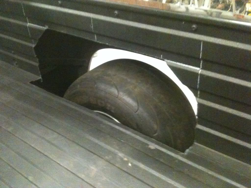

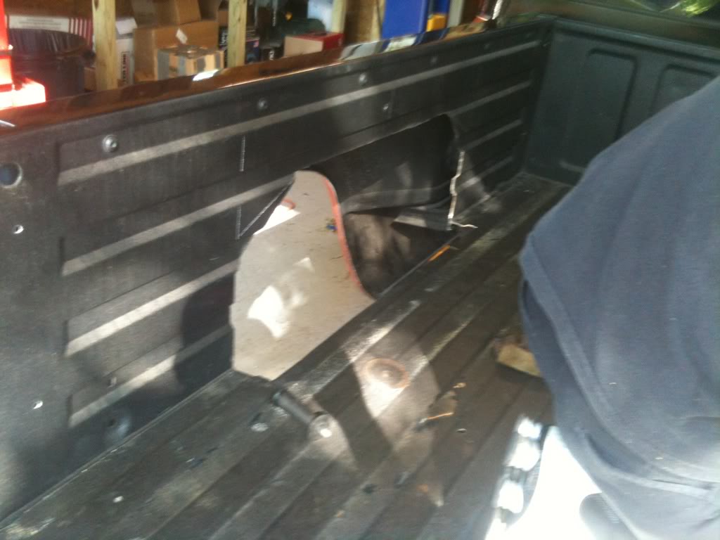

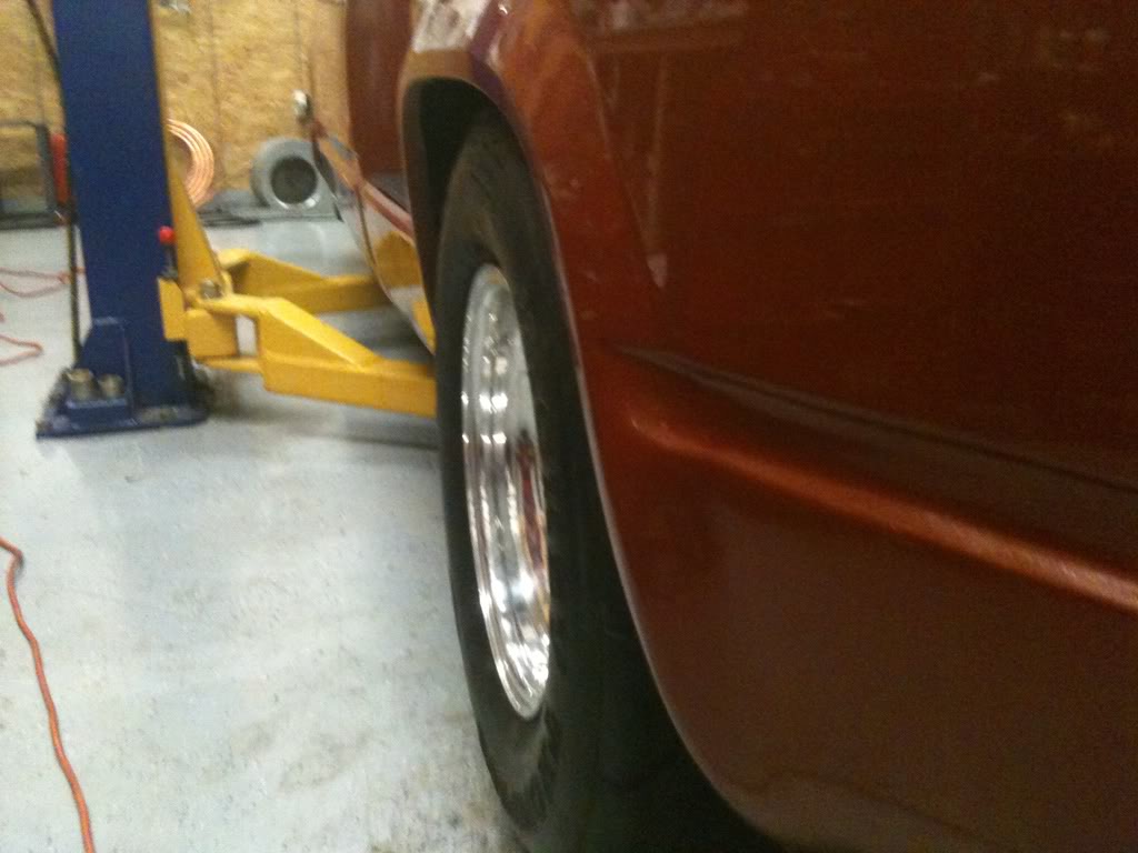

Just wanted to try and document this part of my build as much as possible for anyone who has this in mind..... Got this done in a day so far, removed rearend, cut holes for wheels and tubs, measured for new wheel tub, started grinding old perches off axel tubes & measured the new distance from backing plate to backing plate of the mockup rims with the tires im gonna be using.... Ill be taking 3" off each side of the axel tubes, ordering some moser axels, new ends and possibly trying to convert over to some disc brakes, throw the 3.42 gears in w/ a girdle cover, and yes this is all to a 8.5-10 bolt chevy rearend!! We will see how long this beast will hold up......

First side cut!
Then other side!

Oh Yeah and the new rim choice! Im having problems finding a nice sporty front runner tire that will be 28" tall fit on a 15" rim and have around 8-9" Section width!! Any suggestions would be great

Looks good man, I've been seriously cosidering tubing my truck. You could run a 205/75R15 front tire I run the Hankook Optimo 724 on a 6" wide rim, mounted it's about 8.3" wide.
