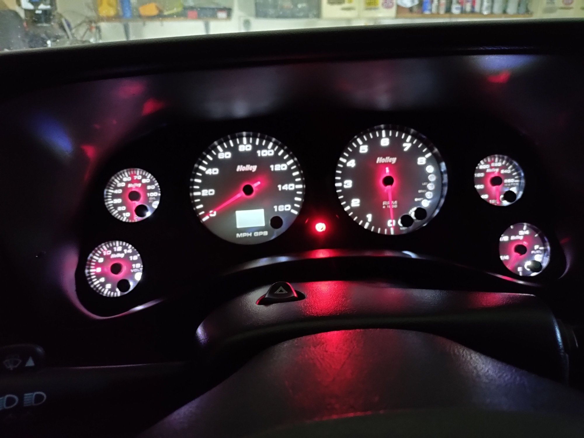

Got all of the electrical done, dash gauges and indicators working. I didn't know what to expect with these Holley gauges, but I'm pleasantly surprised and happy how they turned out. Had to add some stand offs to angle and push out the panel to get the correct viewing angle, trimmed the dash bezel accordingly. Moving along to the exhaust next. Hopefully will be able to make the maiden shake down test ride soon.

Wow those gauges look amazing! Nice work.
Old Jul 19, 2021 | 04:42 PM
  #24
@dantheman1540
Old Jul 27, 2021 | 05:17 PM
  #28
dantheman1540's Avatar
Joined: Jun 2014
Posts: 3,149
Likes: 792
Originally Posted by tjmath
He did say "Holley gauges" looks like total custom which I'd prefer not to have to do.
