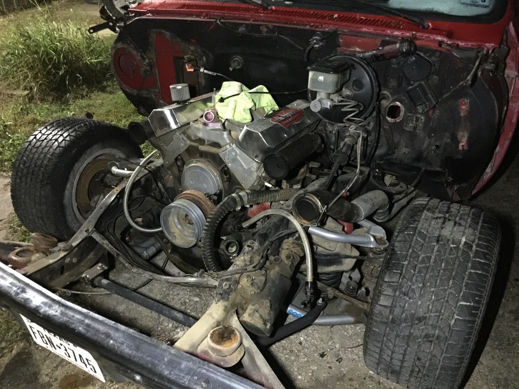

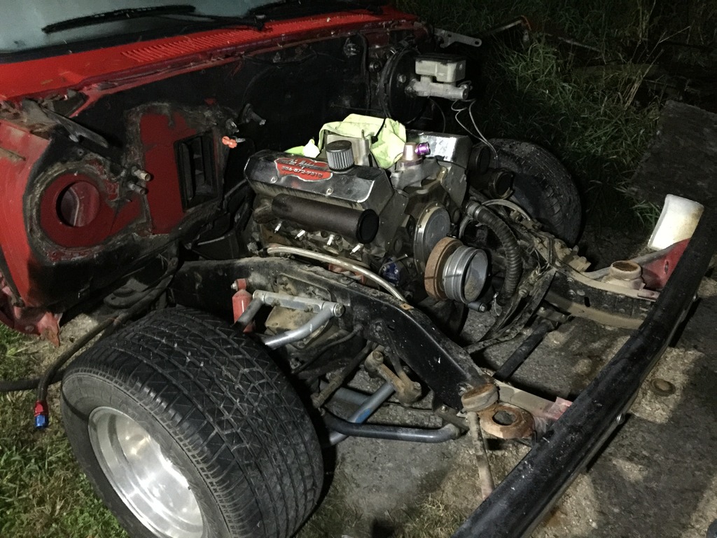

Started stripping the front down to prep for engine removal and cleanup of the frame. Eventually everything will be pulled off down to a rolling chassis and pretty much be rebuilt from the ground up....

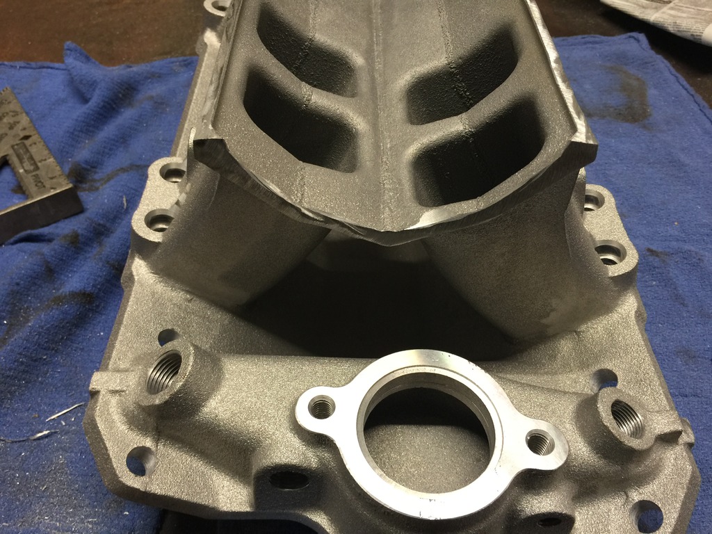

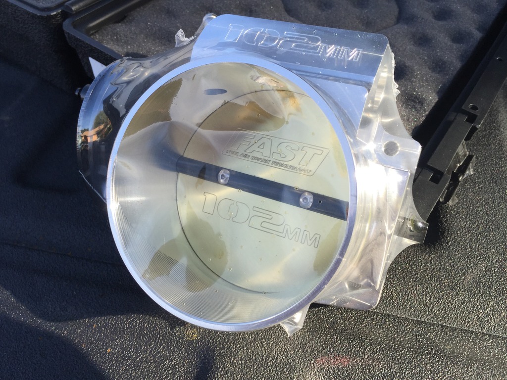

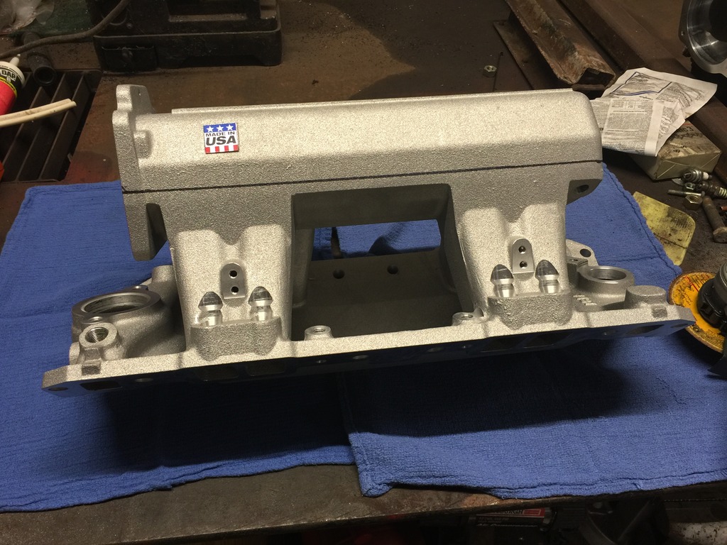

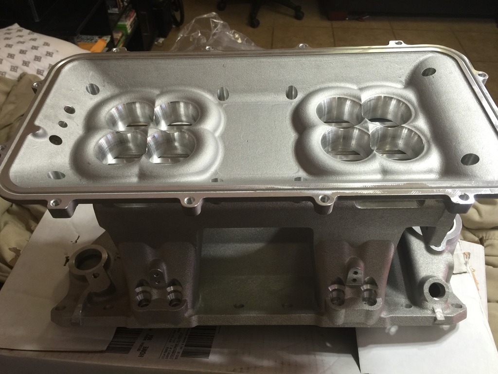

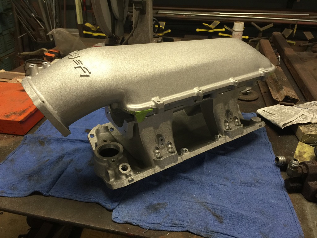

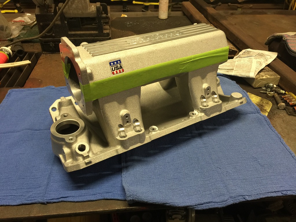

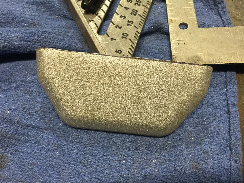

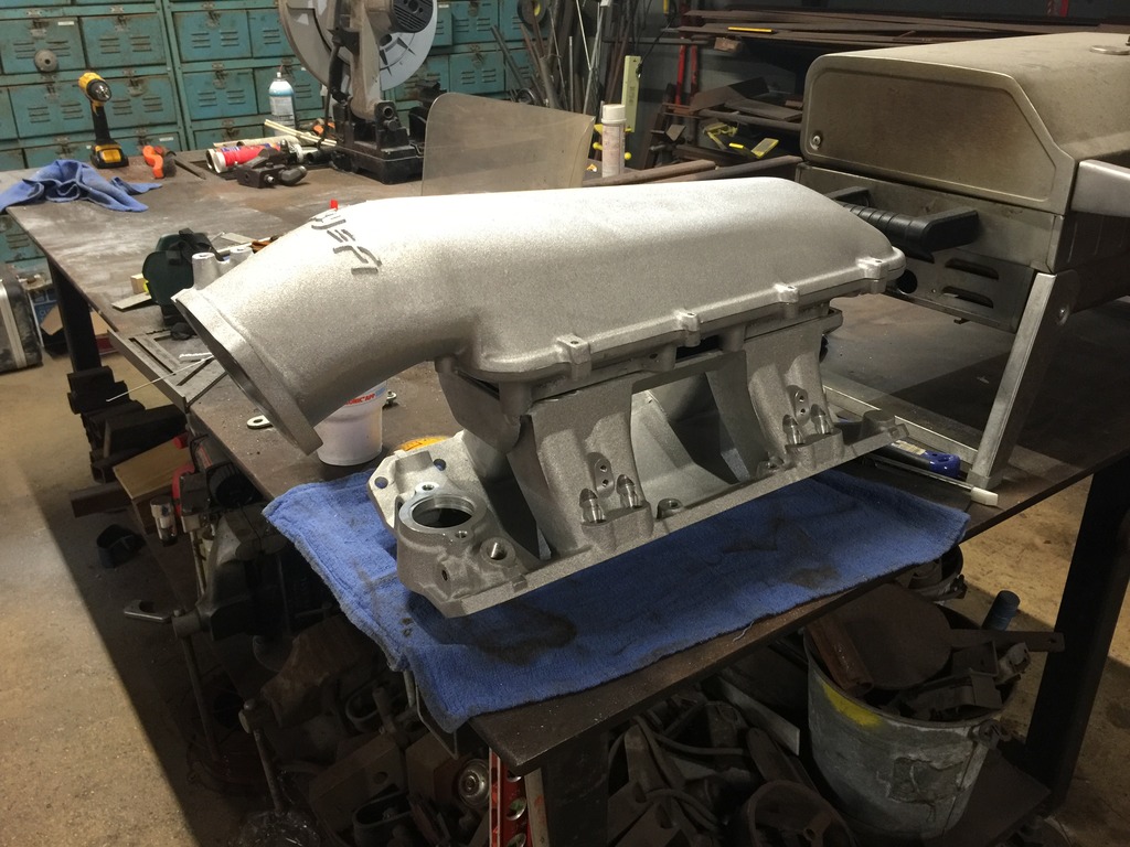

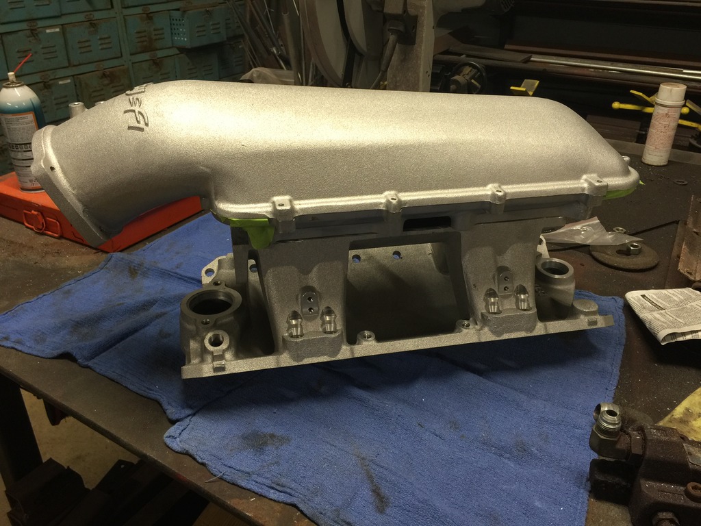

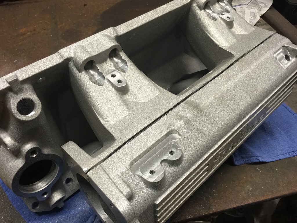

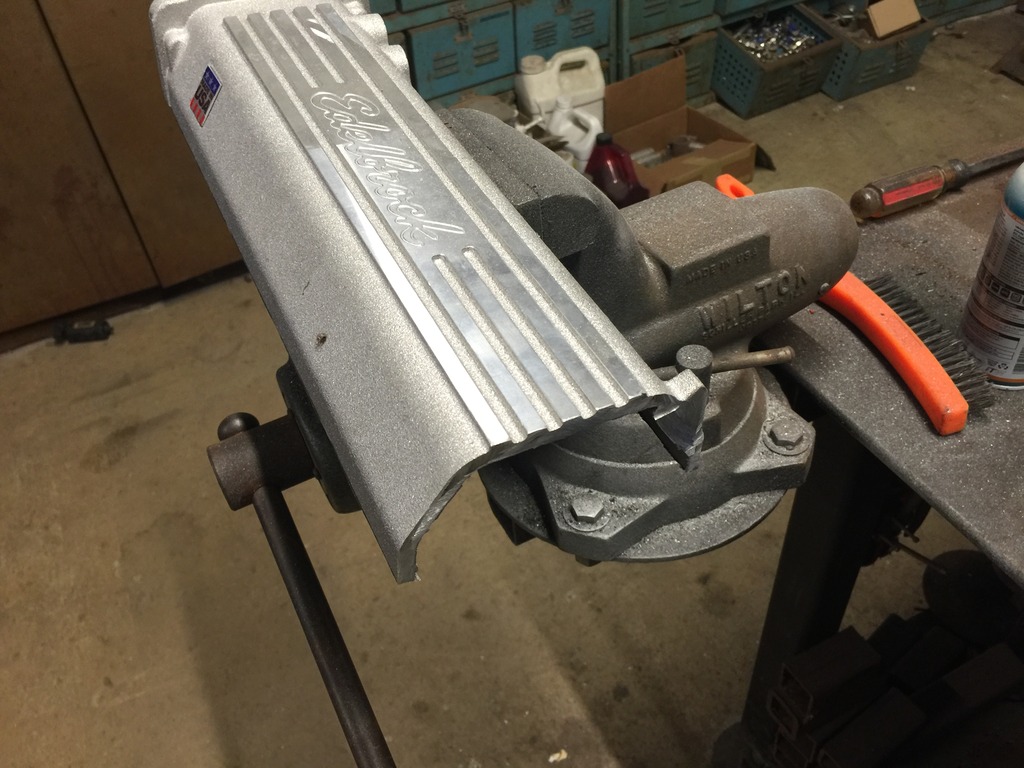

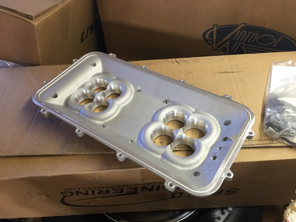

Jumping around while I wait for the suspension parts to keep it as a roller, I started to work on the new intake. Did something a little different here too. I wanted to keep the turbo cooling system pretty easy and straight forward so wanted to go with a high ram and a 417 intercooler sandwiched in there. Well as it has it Holley doesn't make a high ram for a SBC so I have to make my own... Started ordering a few parts to see if I could kinda frankenstein some stuff together. I have no idea if this is going to work as planned but hey what the hell....
Started off with a Edelbrock SBC efi intake manifold and basically cut it in half. Then from there got in the Holley parts that matched the closest to the Edelbrock and went from there. Its still a work in progress but you get the idea I'm going for...

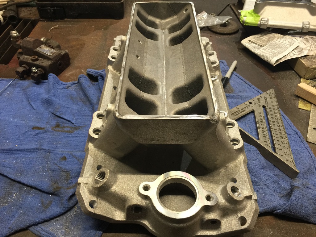

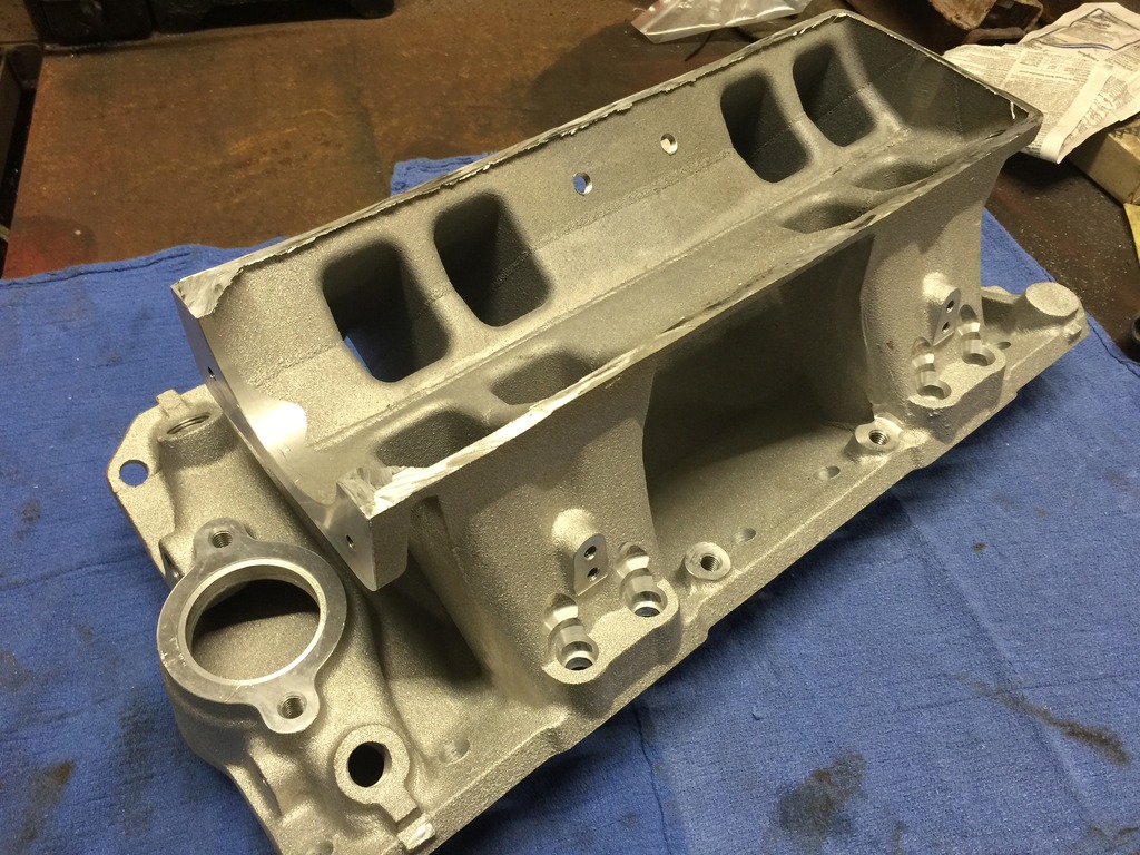

It is by no means finished still positioning stuff so everything flows like it should. Fig it couldn't be too much different then how the Edelbrock originally flowed into the cylinders. The center of the Holley lower lid will be machined out to match the Edelbrock and be welded together. Basically a open lower plenum. The intercooler will be mounted in-between like I have it on my black GMC and should operate like any other high ram.

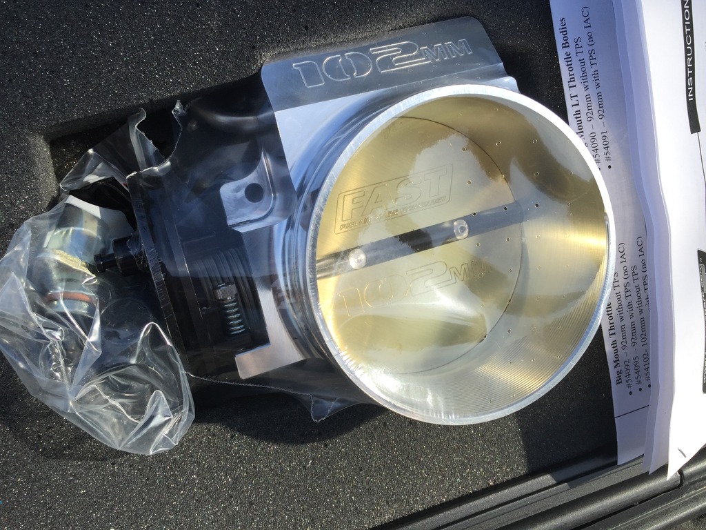

Got some more goodies for the intake...
