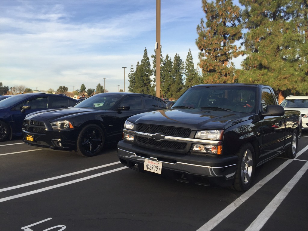

Just a few updates. I got the everything together and got some miles on the truck. I drove it out to the Motor 4 Toys car show and got to see how the shocks worked out. Started them at 10 clicks from full soft (middle of the adjustment and I was very impressed. The truck was much more stable and comfortable to drive, even with the crappy freeways. Ended up firming up the front a few more clicks and it was perfect. Obviously I'll end up making adjustments when I do the next autocross event and see how they help there.
Pic from Motor 4 Toys:
