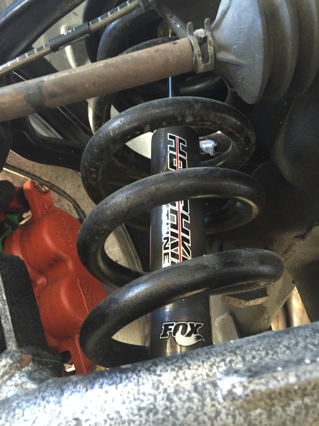

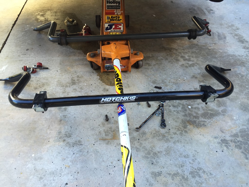

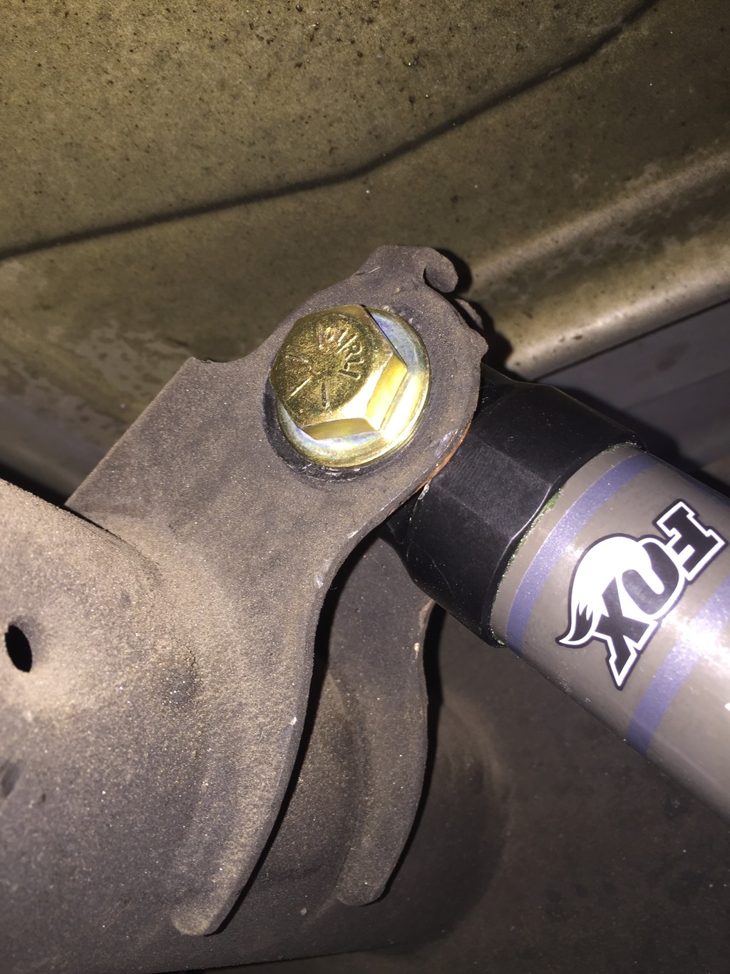

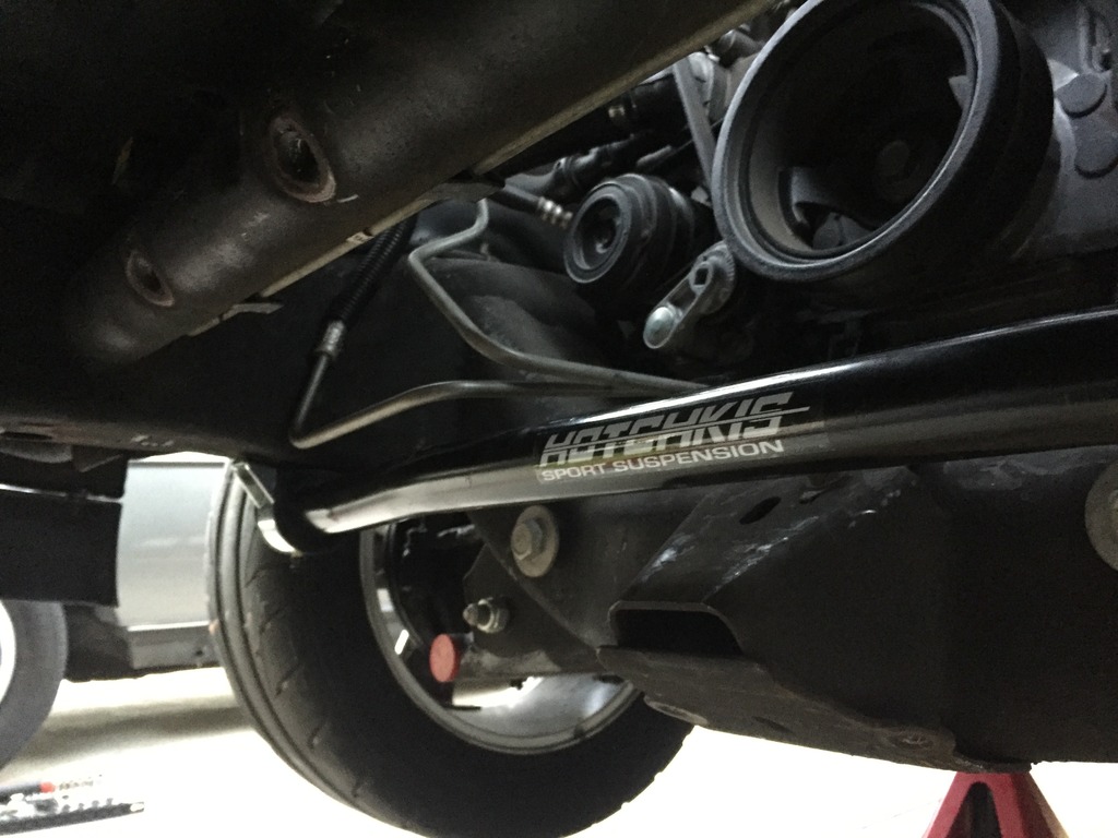

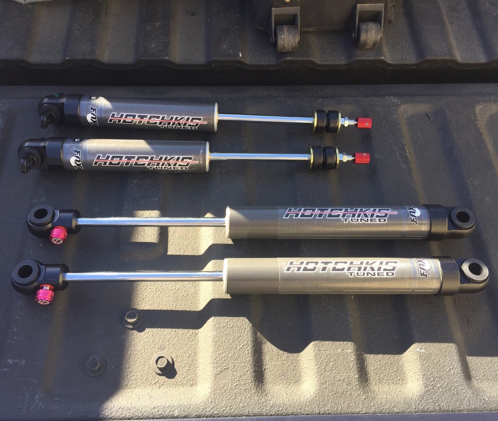

Finally had a nice day to get my shocks installed as well as my new matching Hotchkis front sway bar. I did have to make a slight modification to the rear upper shock mounts. The larger end/cap on the new shocks was hitting the mount. Just cleaned up the edge of the mounts with a flap wheel and touched them up with a little paint and the rears bolted right in with more new bolts. For the fronts I had to clearance the opening in the bottom of the lower control arm to clear the t-bar lower mount. Other than the slight clearancing no issues. I mounted the rears with the adjusters on the bottom for easy access and the front's have the adjuster on top instead of bottoms like qa1's and similar. I'm just waiting for a set of front sway bar links from Spohn performance with heim's at one end. The link mount on the lower control arms is terrible for a straight link so to keep them from binding I'm going with a heim at one end.

Unboxed:
Clearance issue:
After a little grinder work and a little paint. Hardly noticeable.

And the front's.
New Hotchkis sway bar vs the Belltech.
