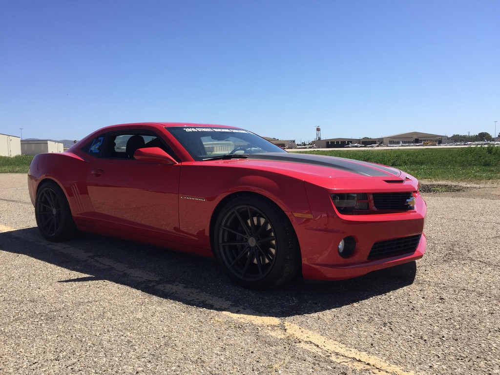

A few updates. A few weeks ago Claudia and I got to do another Autocross at the Airport in Camarillo, CA. It was pretty fun. Limited to only 30 cars it kept things moving quickly. Got to hang out with Rob and Brandy of PCH Rods and learn a little more. Claudia got to drive my truck a couple laps and see how it felt compared to hers. Overall a good day. No obvious casualties until I started taking the front end apart for a spring swap.

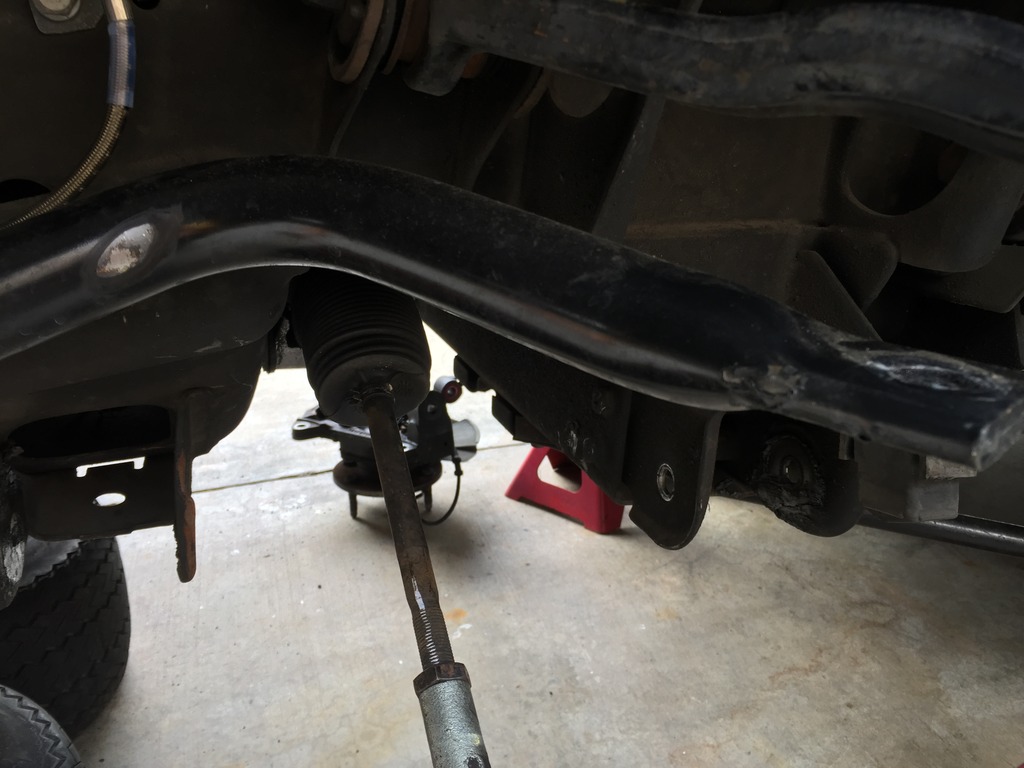

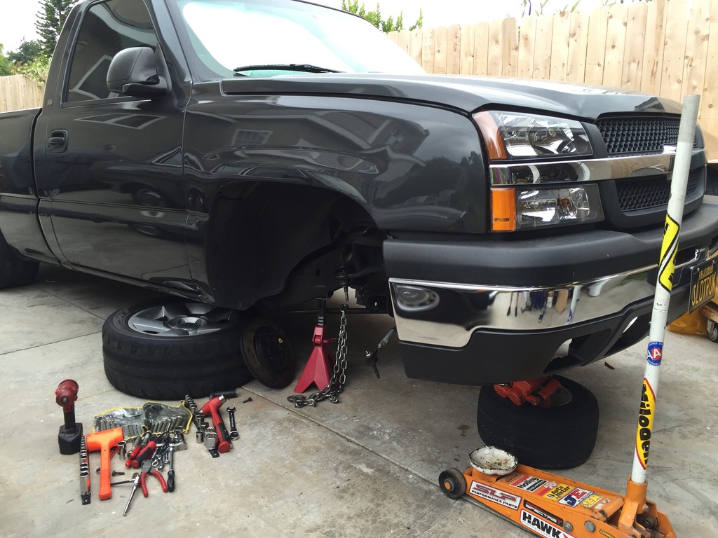

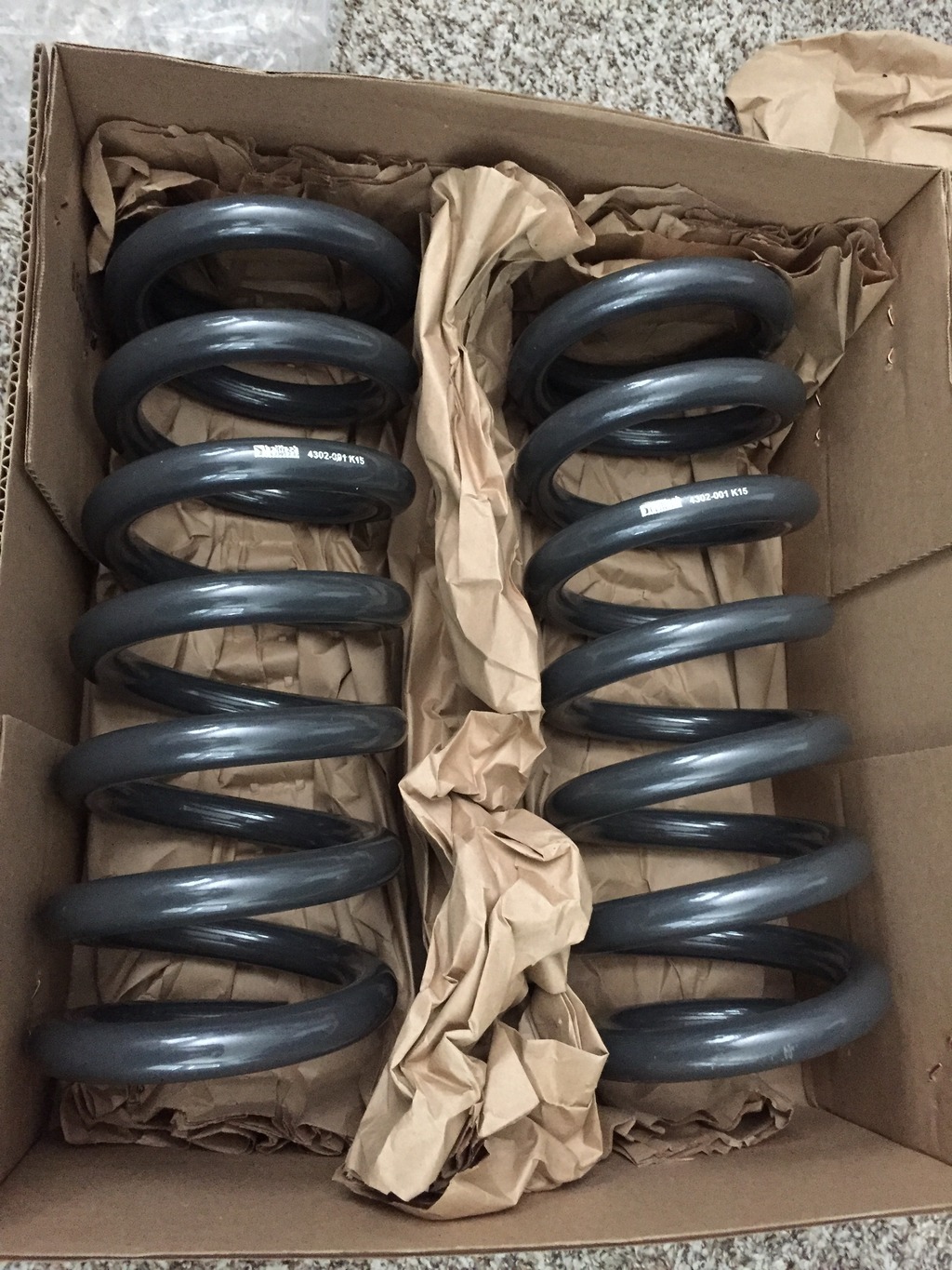

I needed to get a higher rate front spring in the front of the truck to keep the truck from nose-diving into corners. Up to this point I've run the stock 106,000 mile coil spring and lower control arms to achieve the height. I started calling and emailing a handful of places to find out spring rates/heights on their GM truck coil springs I ended up going with Belltech. They were the only ones that would give me any info on the springs. Everyone else gave me replies like: They are like stock, or we don't have the info on them.
The springs were delivered last Saturday so got to un-bolting.

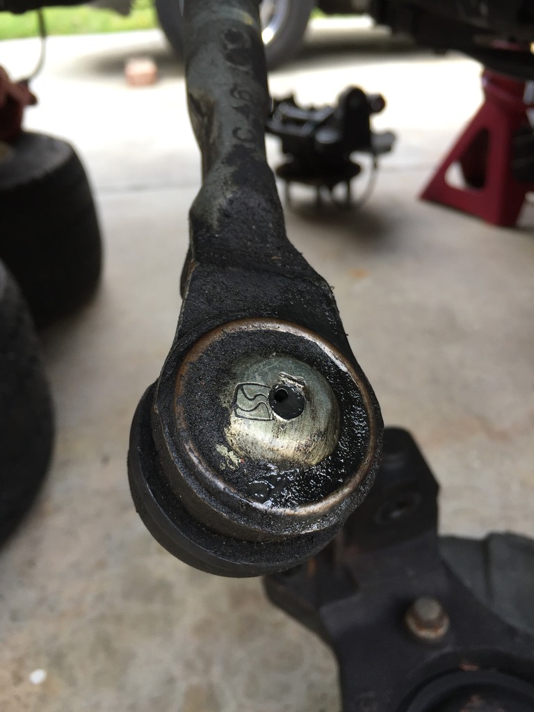

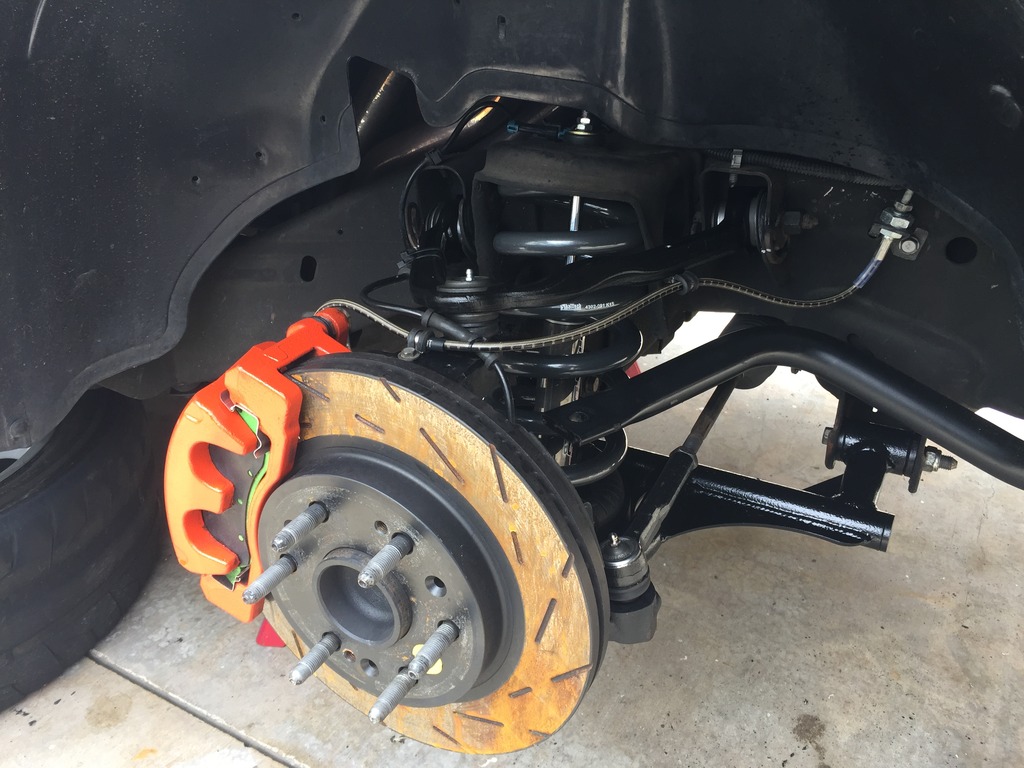

I found that I had a missing sway bar link bushing on the passenger side. The missing bushing let the sway bar to slide toward the drivers side which bent both links. The bar rubbed against the tire and ended up knocking the grease fitting off the driver's tie rod end.

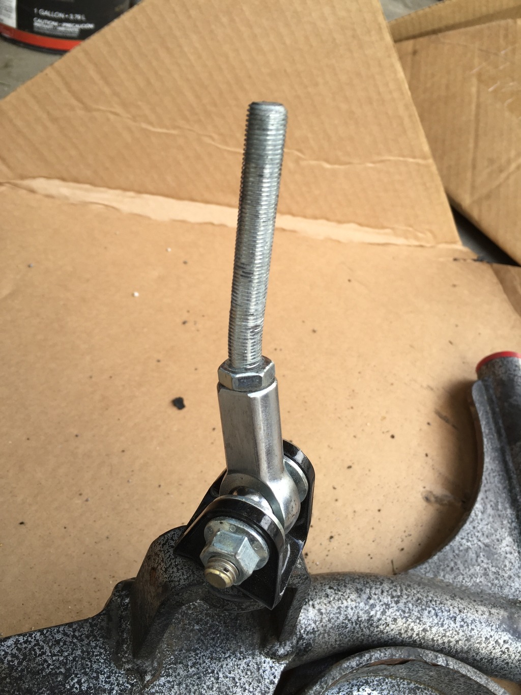

The upper control arms boots were leaking and the bushings were drying out and starting to crack, So I ordered a new set of and new tie rod ends. I already had new Moog ball joints for the DJM arms that I never got around to installing so I did everything all together. Just need to figure out sway bar links for the front and she'll be ready to rock for the next Hotchkis event in June.

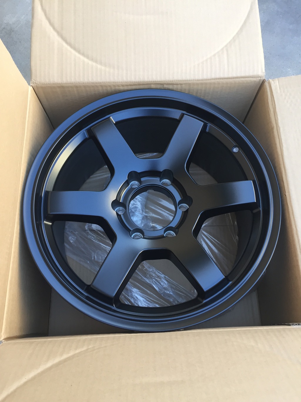

I also pulled the trigger on new wheels and because my NT05's are pretty much completely wasted new tires too. Not going to be leaving the wheels black. Taking them down to get coated today and then have the tires installed. Will hopefully have them back soon and get them on the truck.

Love the truck and what you've been doing with it! Looking forward to more updates. In the meantime, do you mind letting me know the specs on your new wheels? They look like the level8 mk6's. What size, offset, backspace, and tires you going to run? I have an '06 with a 4/6 drop and want to pick up a set for track use, but obviously want them to fit without rubbing issues

Yes they are Level 8 MK6's. They are 18x9 with a 12mm offset. Might have them widened. I am waiting until the tires come in and see how they look. Having the wheels Cerakoted now. Might have them ready and on the truck next weekend. Depends on how busy the coaters are. Will be running a 315 series tire all the way around.
