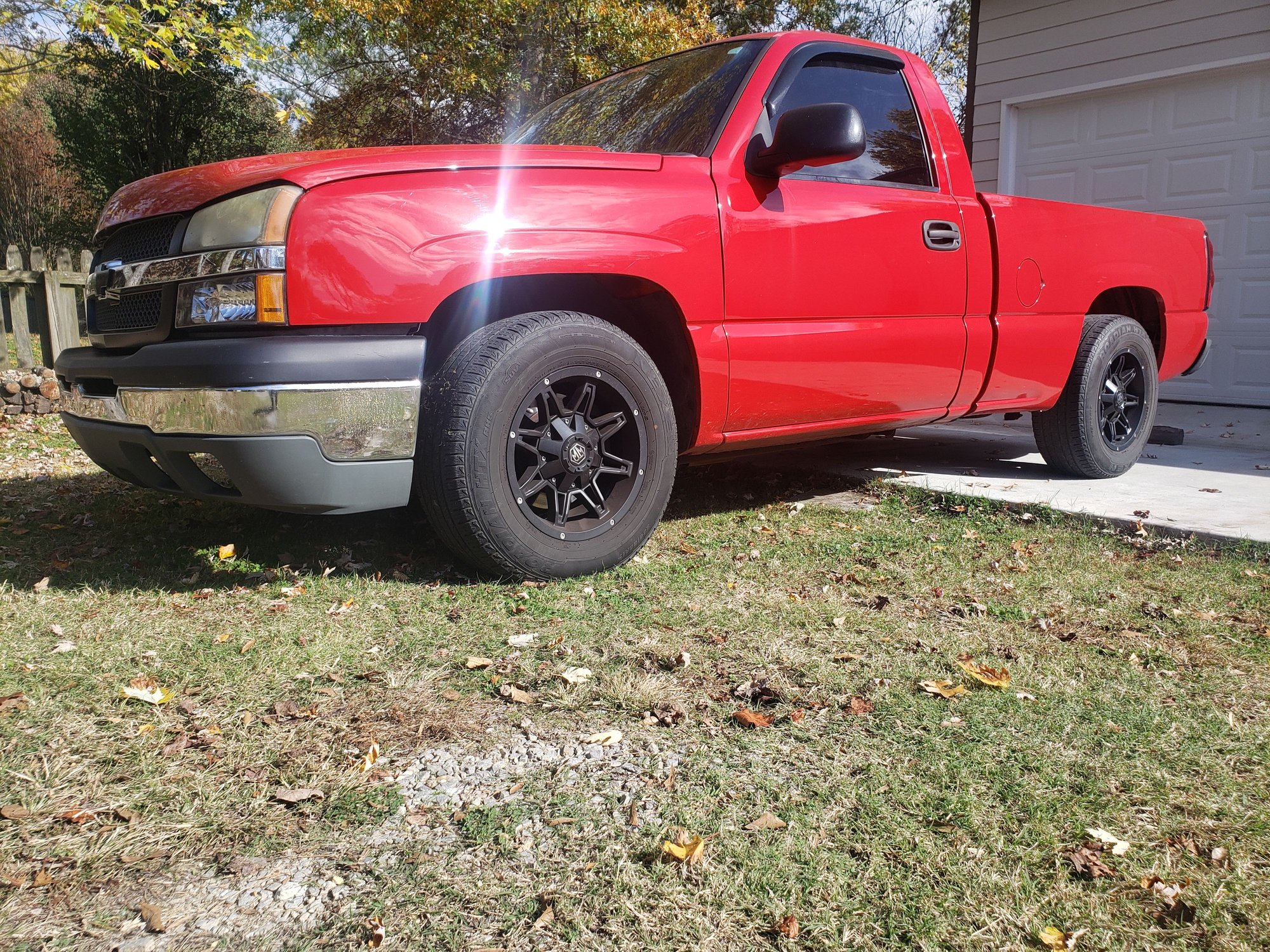

got the Sierra Dropped 2/4

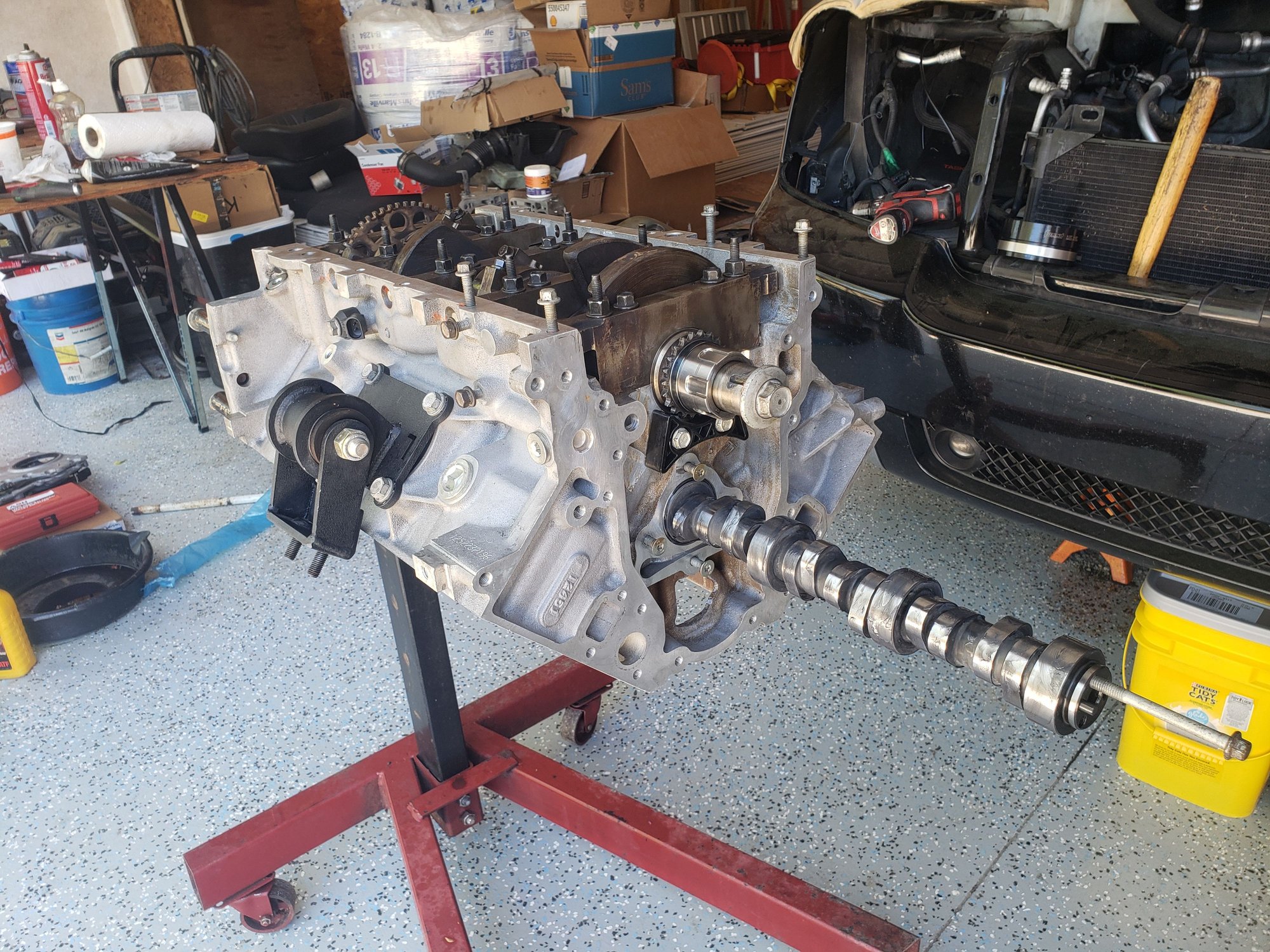

built a flat top 5.3 with a little cam

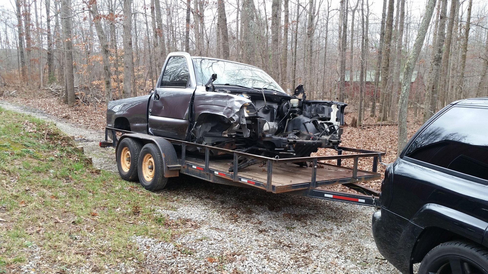

Sierra got smacked by a drunk driver
Bought it back & parted it out

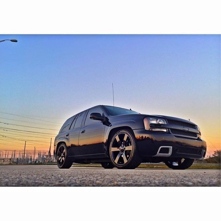

Picked up a blown Tbss

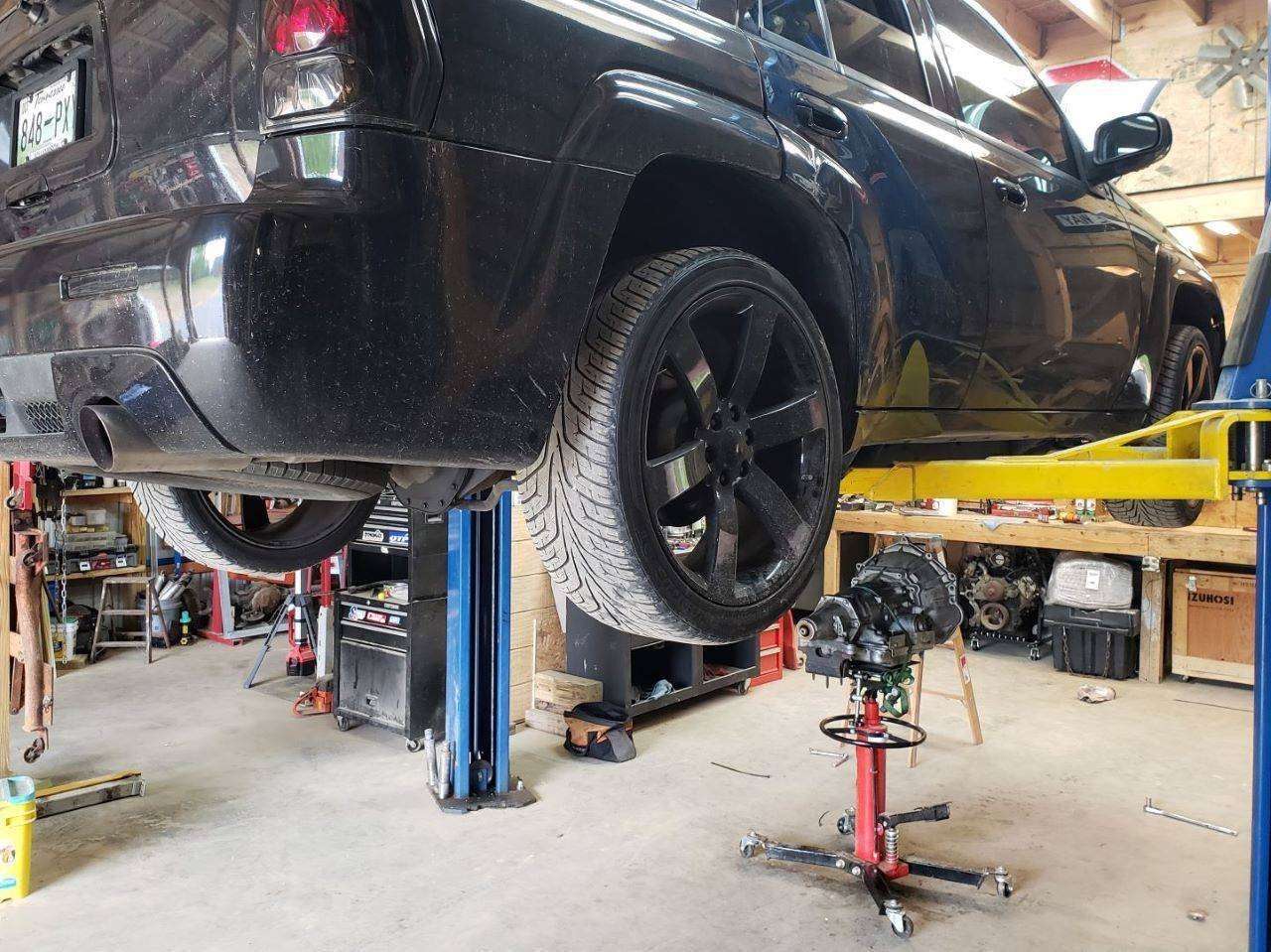

replaced door pins, suspension & the transmission at a local shop
snapped the input shaft on a hard 1/2 shift. the shop replaced transmission under warranty

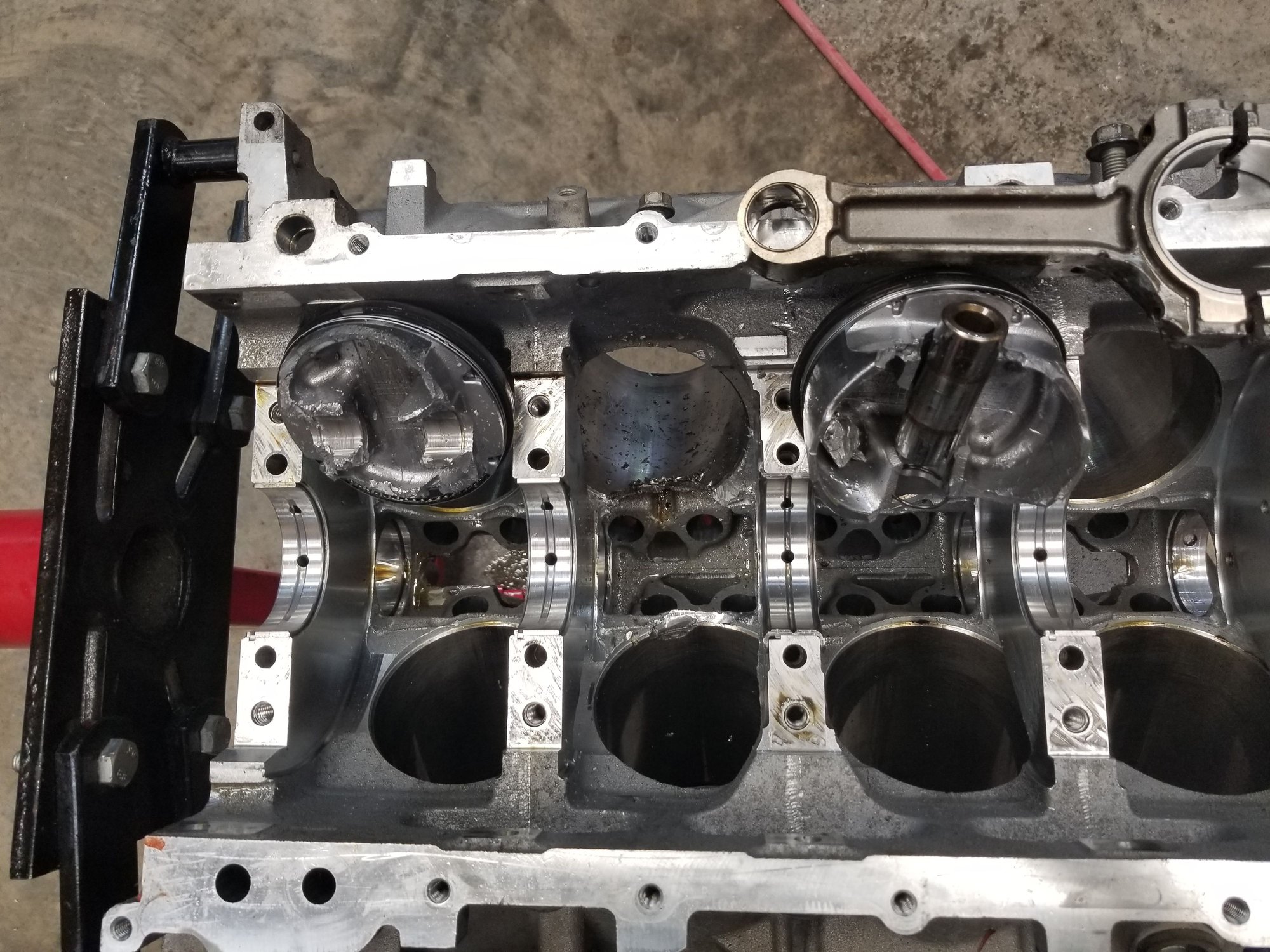

hydrolocked the 6.0 when the brick leaked & bent a rod
built the 6.0, then blew it up

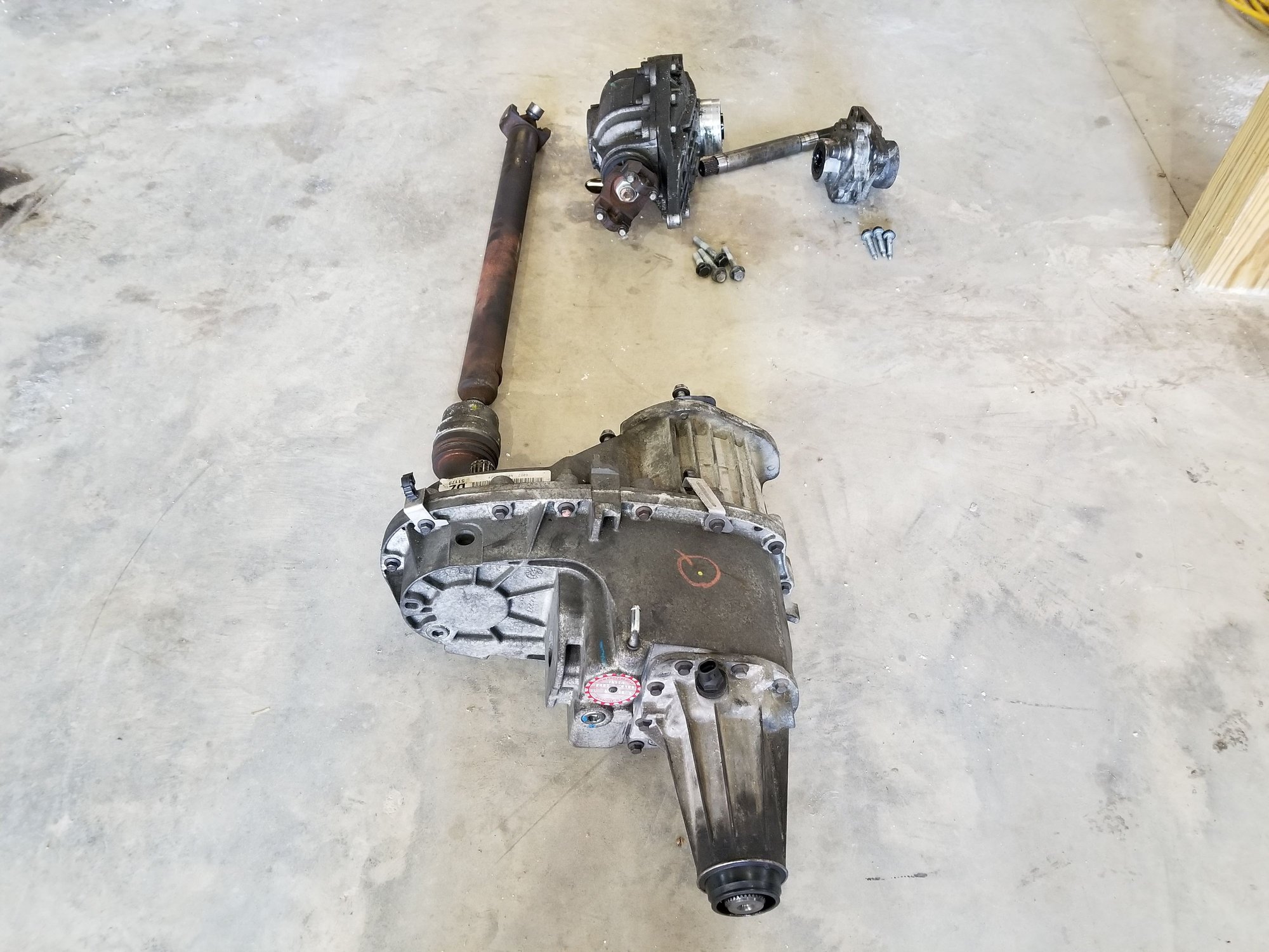

ditched the awd & replaced the trans

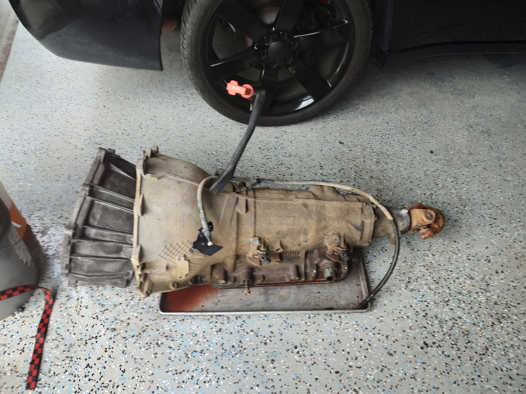

4l80 swap. Decided I'd try my hand at rebuilding an auto....
aaaaand it didn't work out. Probably because of an issue with my Tcm repin & a tune problem
Pulled it back out & sent it off for a rebuild & a PCM 4l60 conversion harness (that's transmission #7 for those of you keeping up)

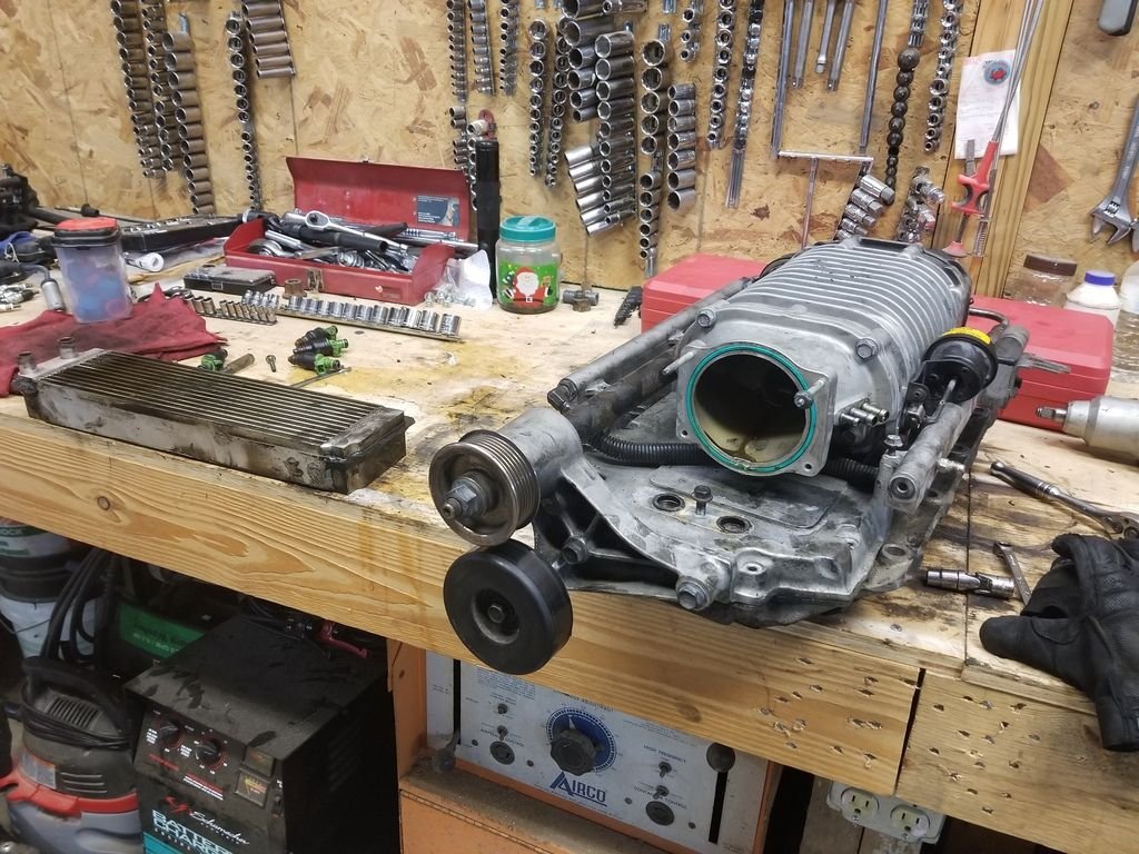

i sent the blower off to have it checked out & ported. Guy "fixed" the brick...

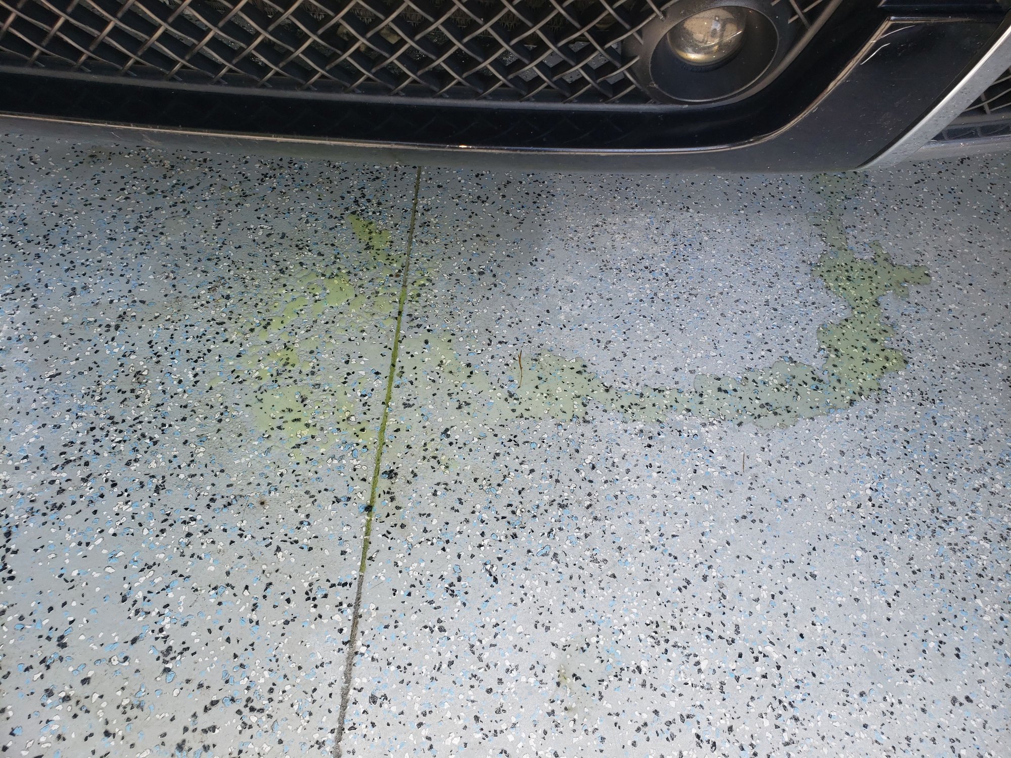

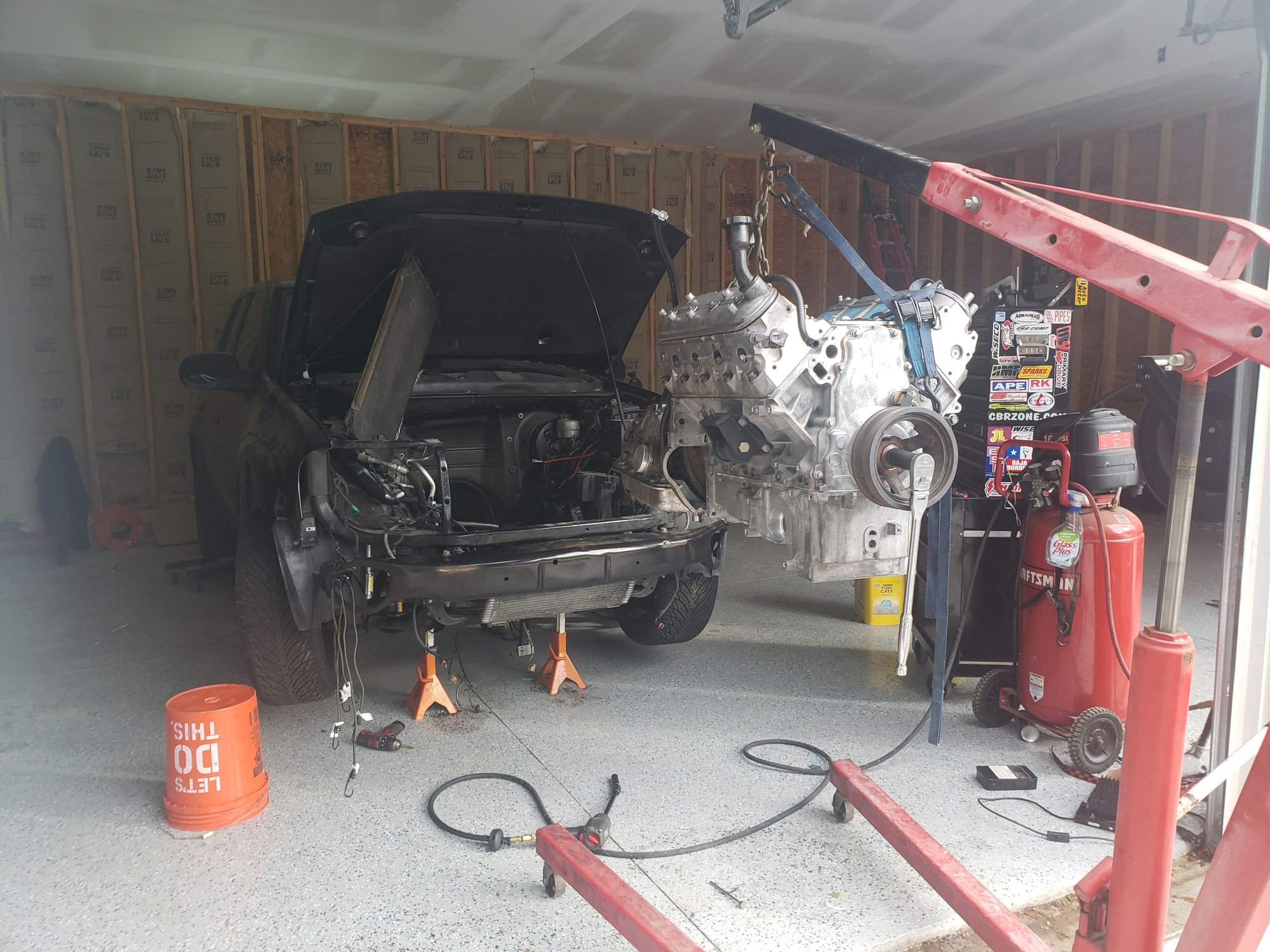

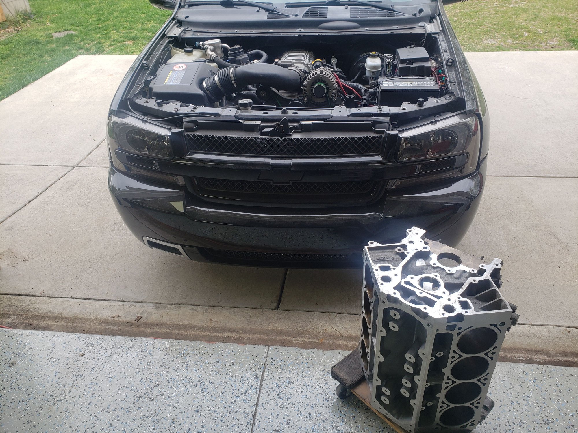

Got the new engine in & had an issue with surging which I thought was a problem with the blower. Decided to pull the belt off the blower to eliminate that possibility & encountered a runaway condition. 2 minutes of run time on this build:

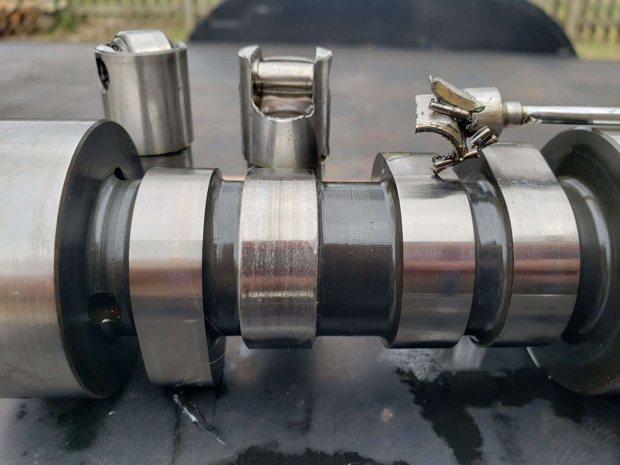

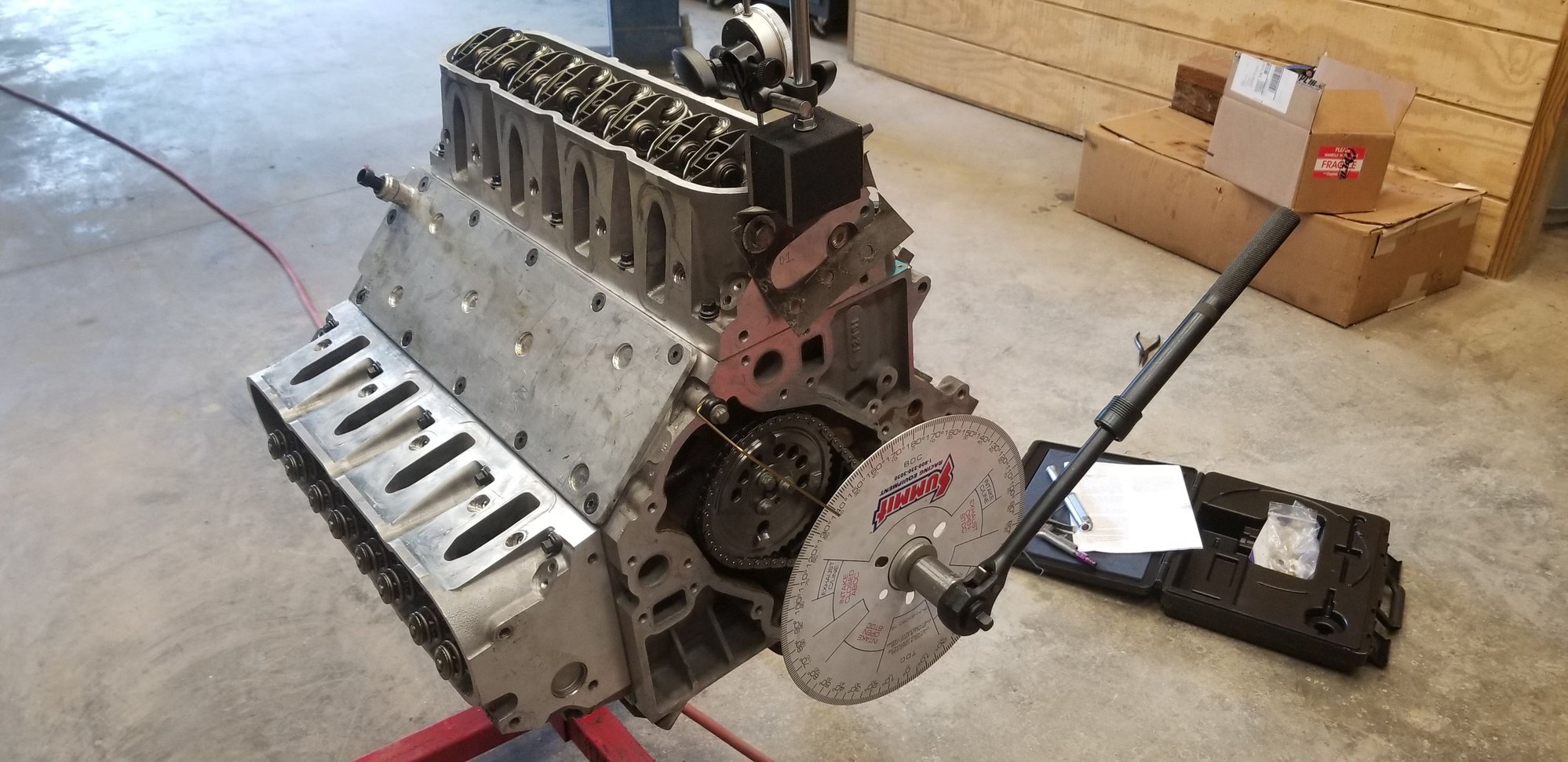

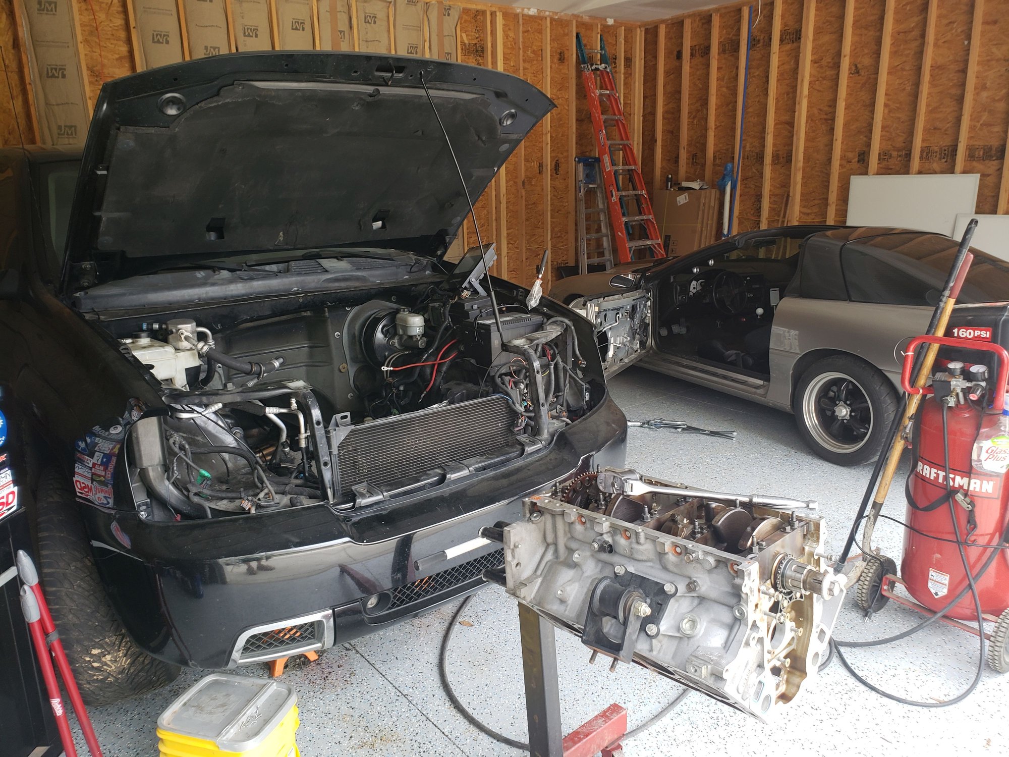

Found a 6.2 shortblock, for sale in good condition. Popped a set of rings & bearings in it & ready to go.

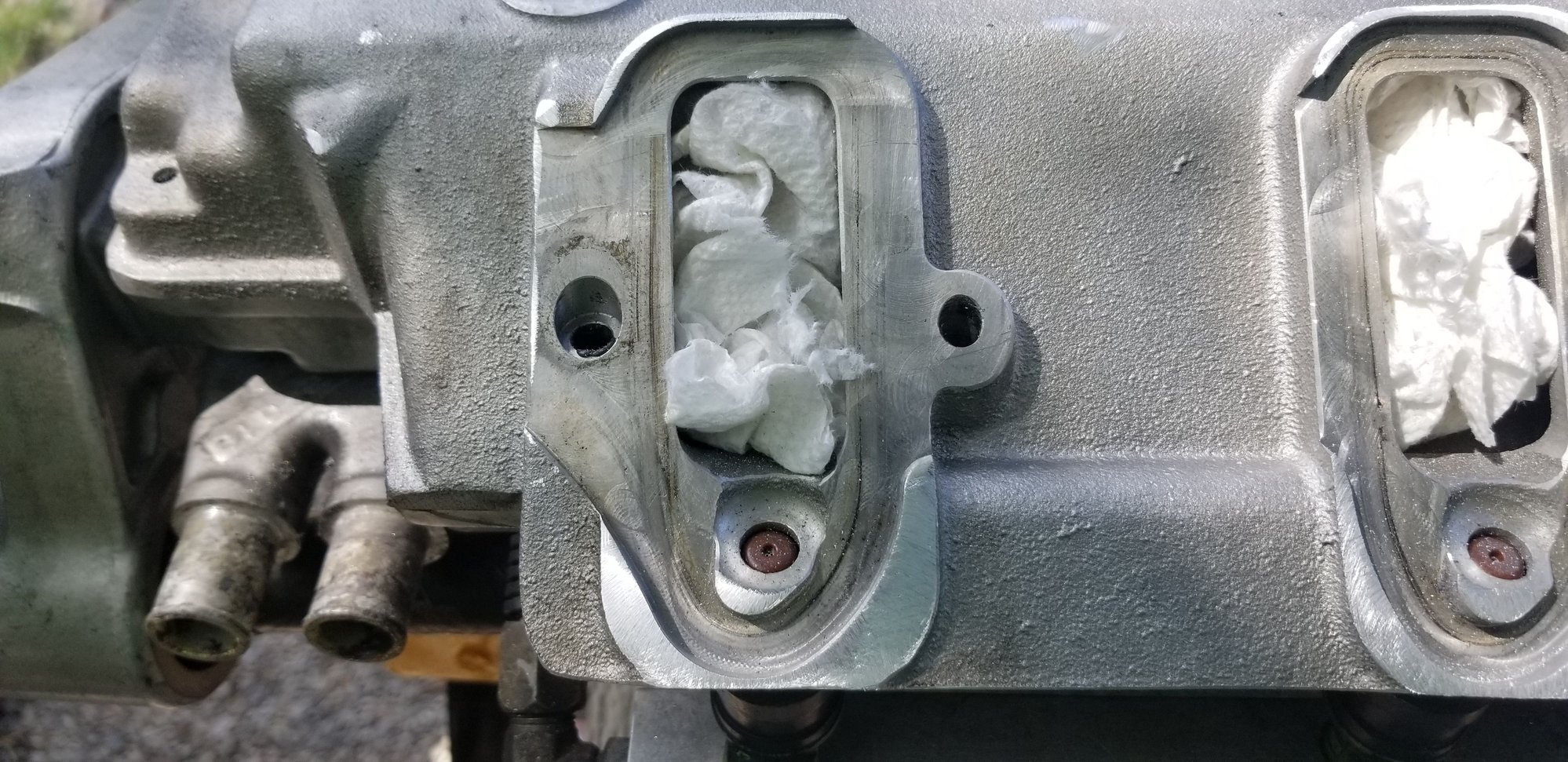

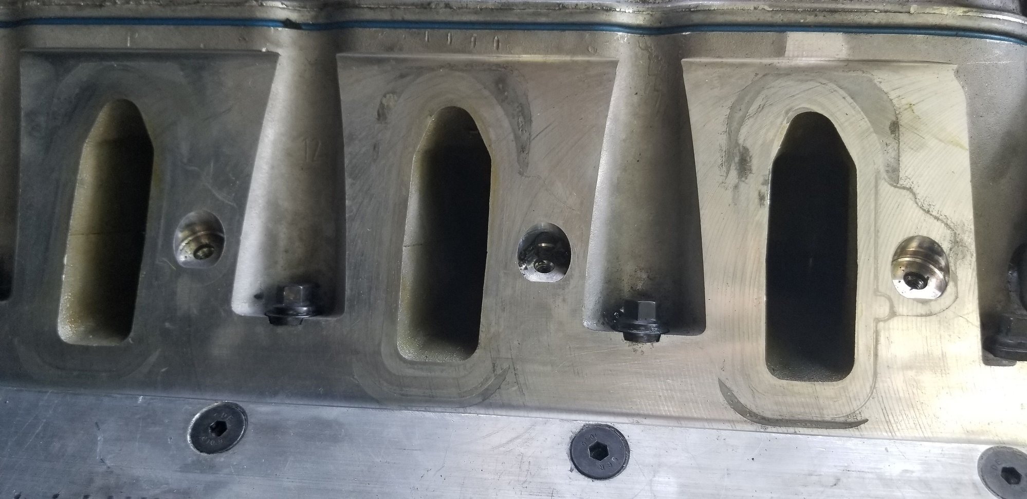

I was still losing sleep over that runaway condition & hadn't figured it out until I noticed these witness marks on the heads:
I'd used aftermarket intake gaskets with the metal backing & had created 8 intake/vacuum leaks since the blower has shoulders:

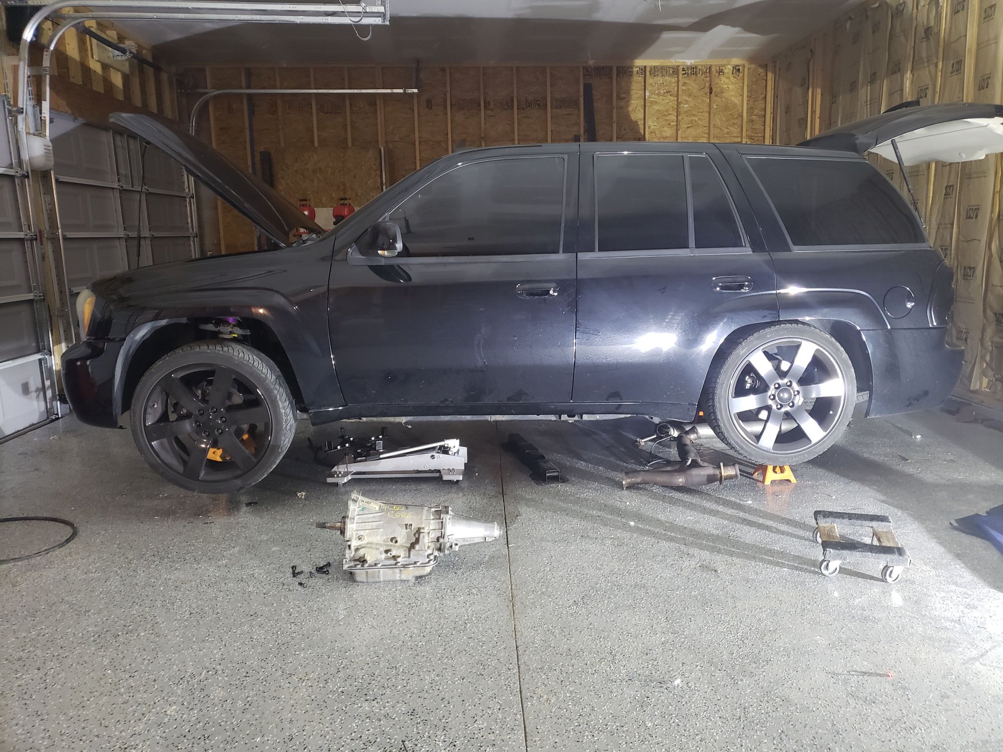

Started tuning the 6.2 & the 4l60 didn't like awd shifts. decided it was time for the rwd conversion
Some guy was being a jackass on the way home, so I rolled into the throttle, but also enough for a downshift. 4l60 no likey boosted downshift
Truck was great for awhile, then developed a significant knock on my way to pick up a '68 C10. Found a lazy rocker on the side of the interstate, so a buddy came & towed me home on my own trailer. Sure there's a moral there....
Decided I'd try the whole deal out the top this time.

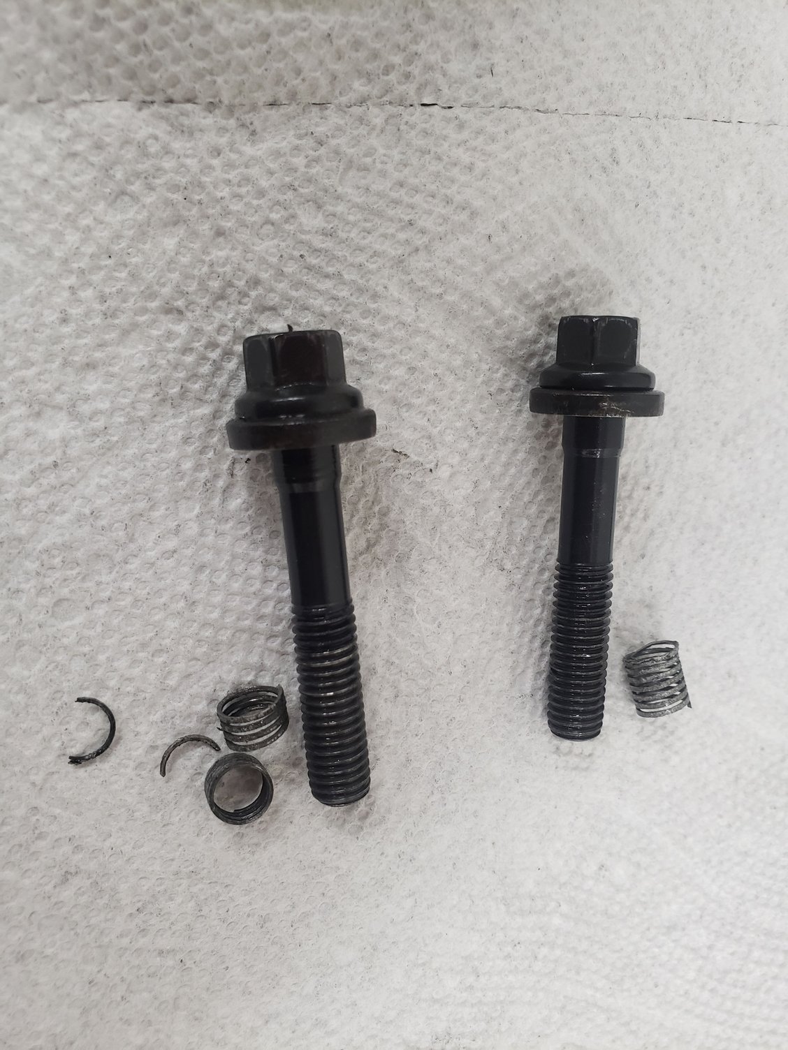

Well, there's the problem. Only set of Morrell's i've ever had an issue with

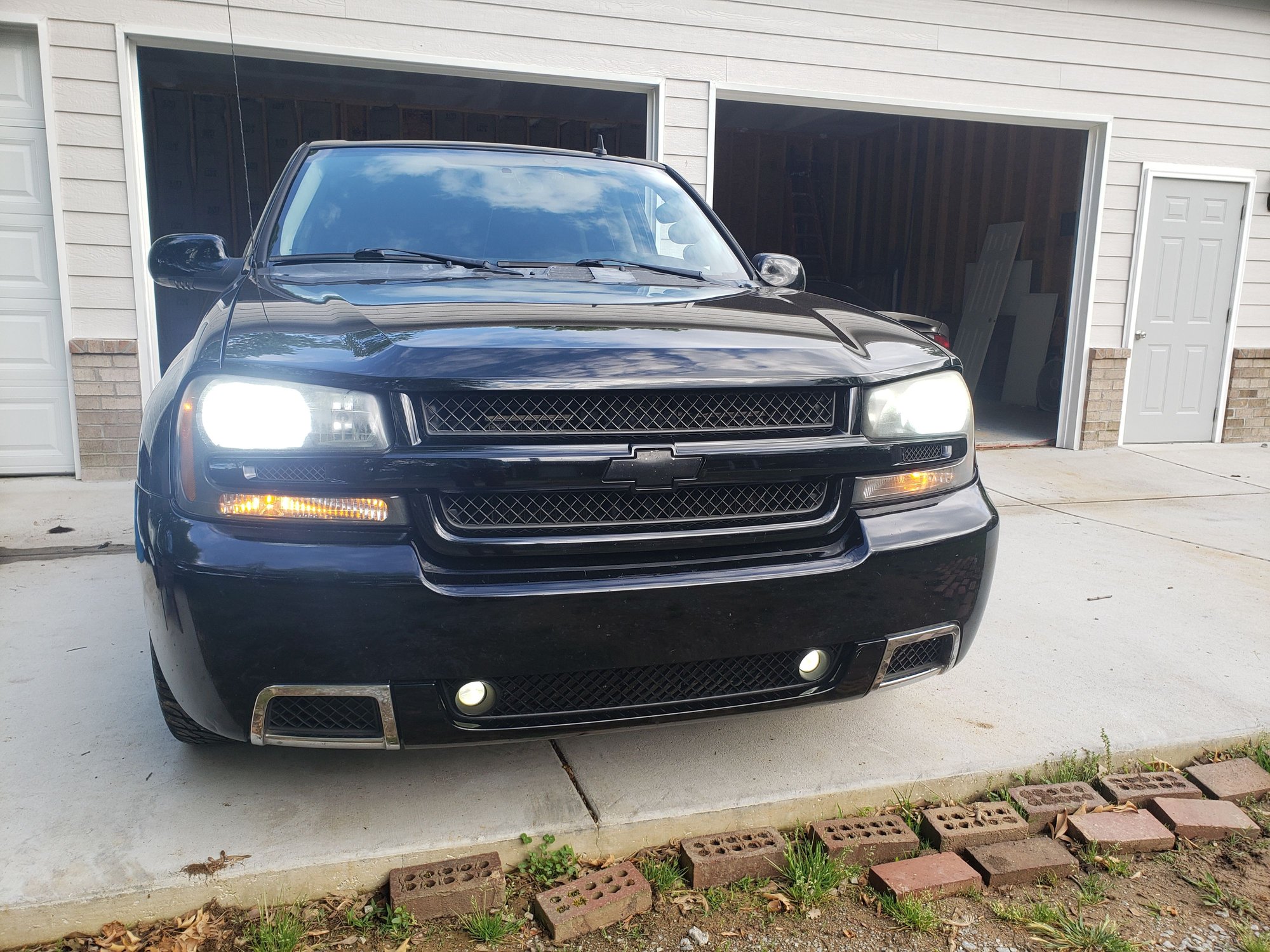

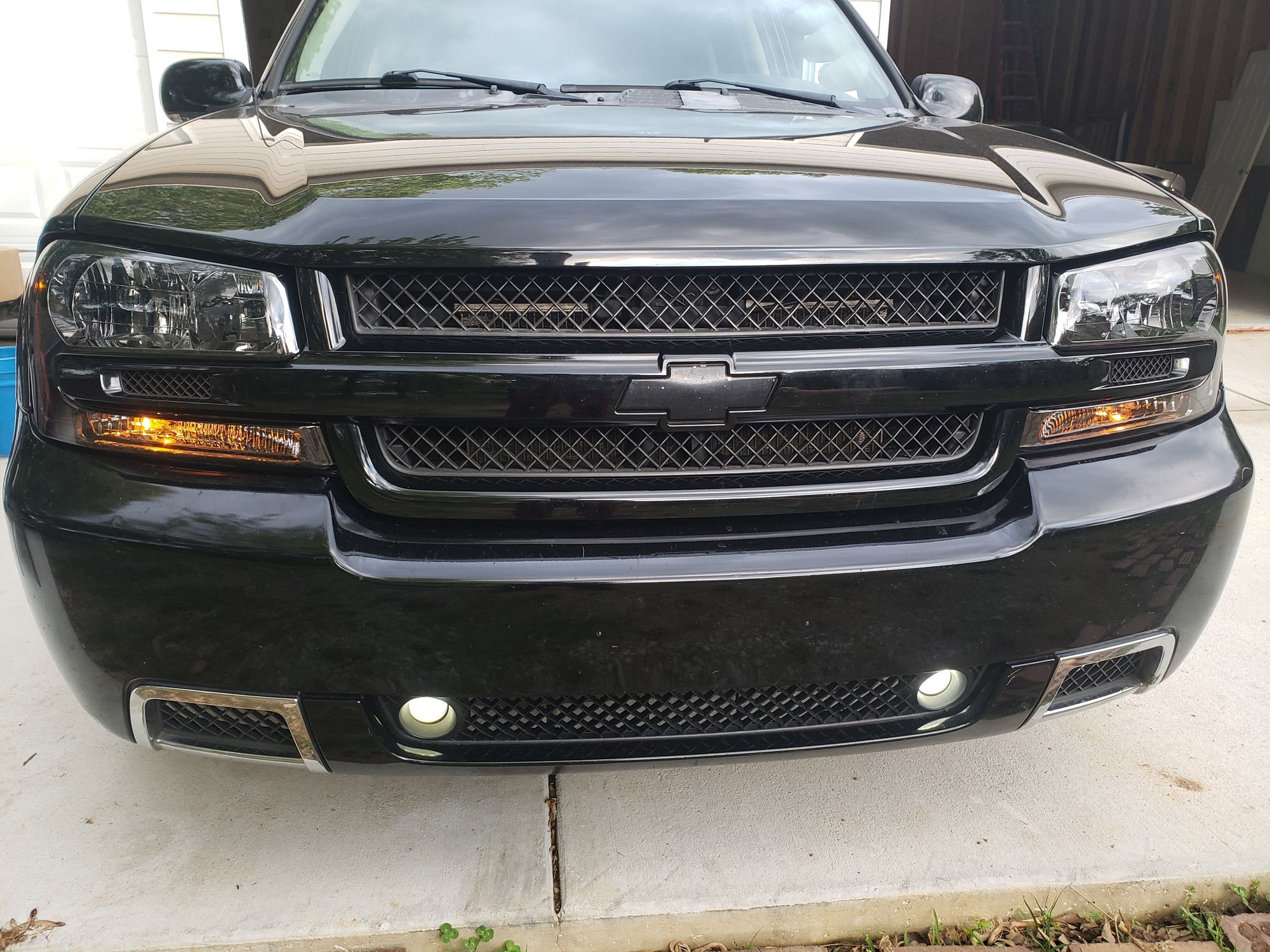

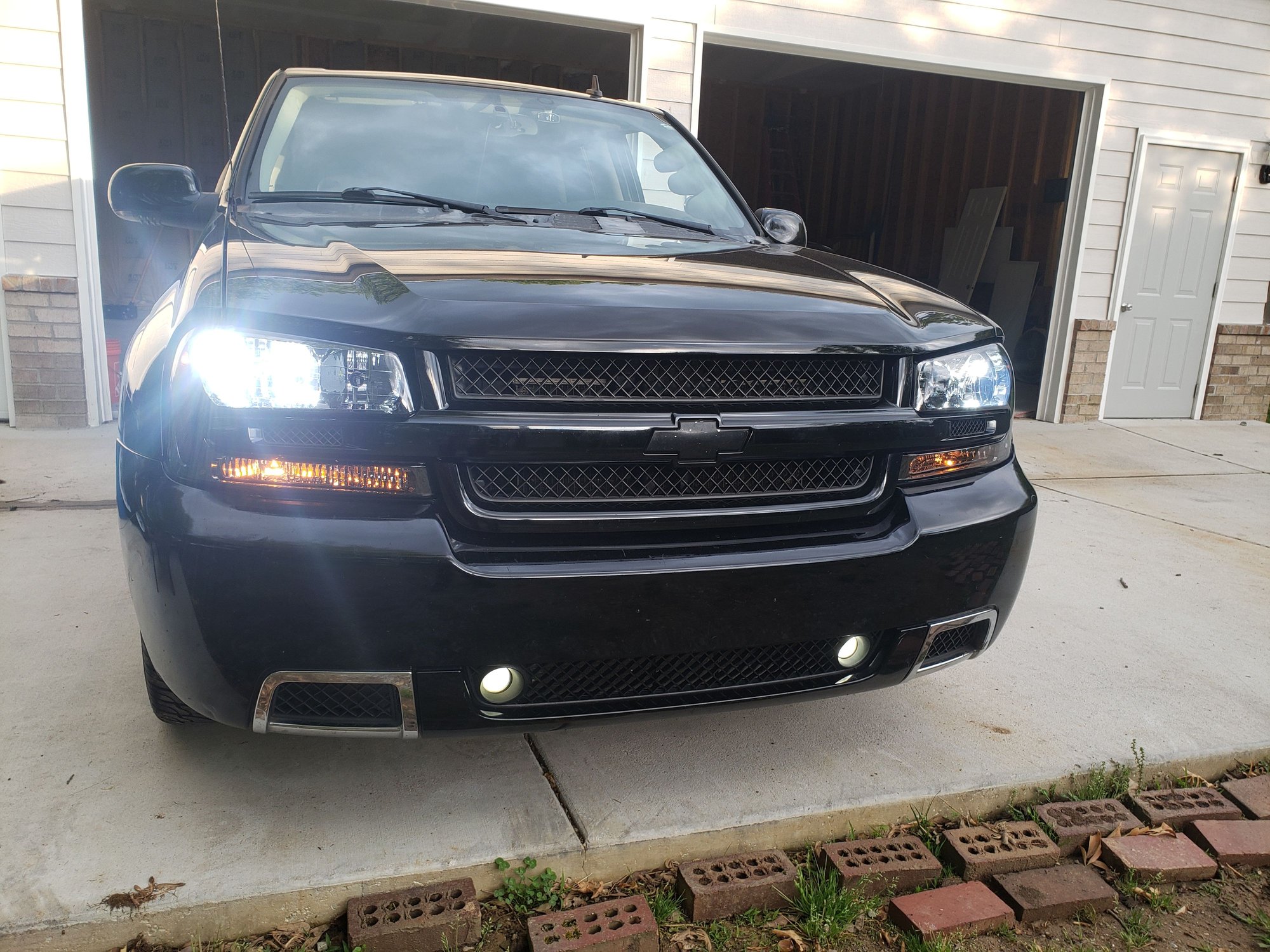

updated the headlights

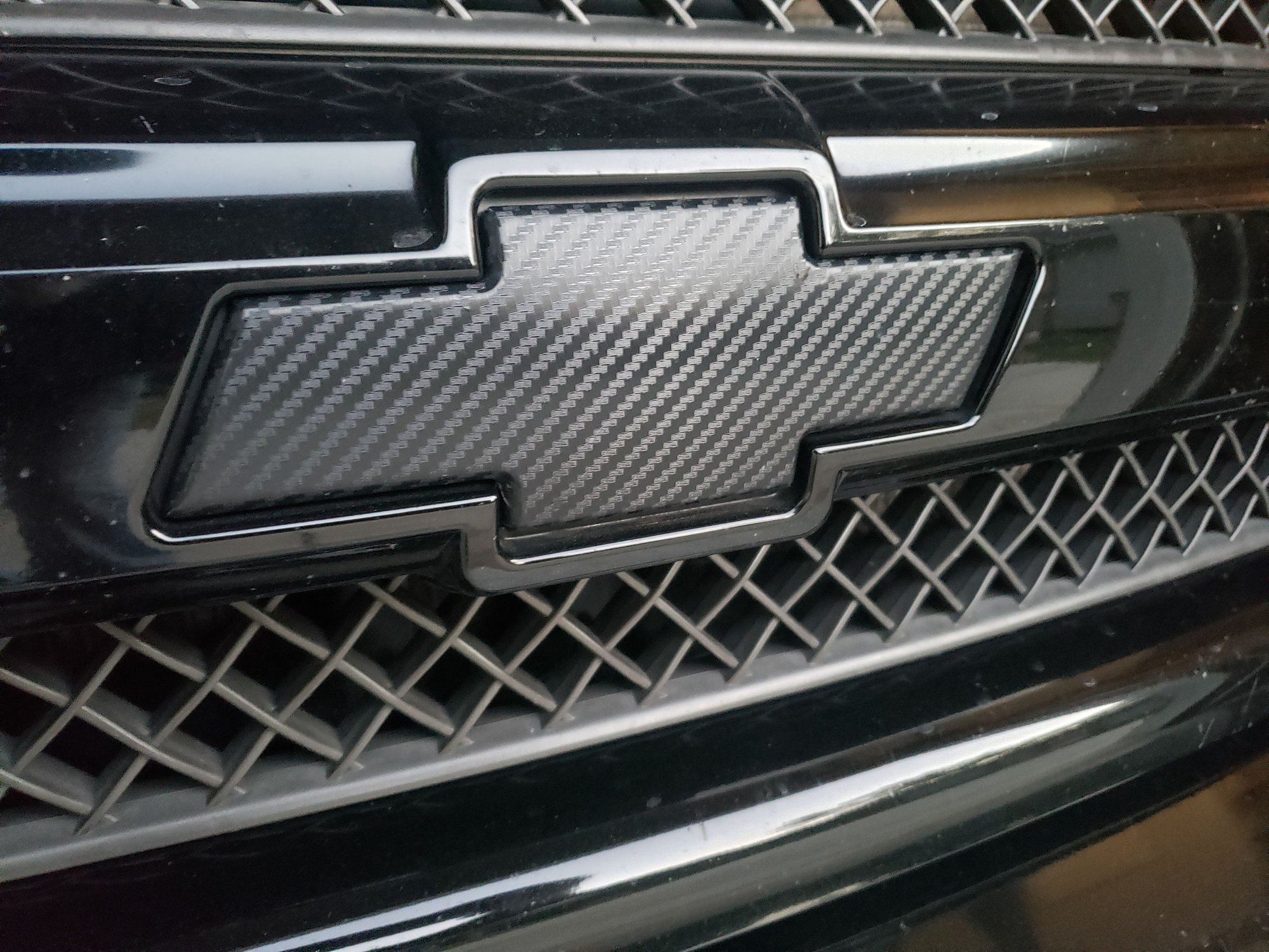

A little 3m Carbon Fiber wrap

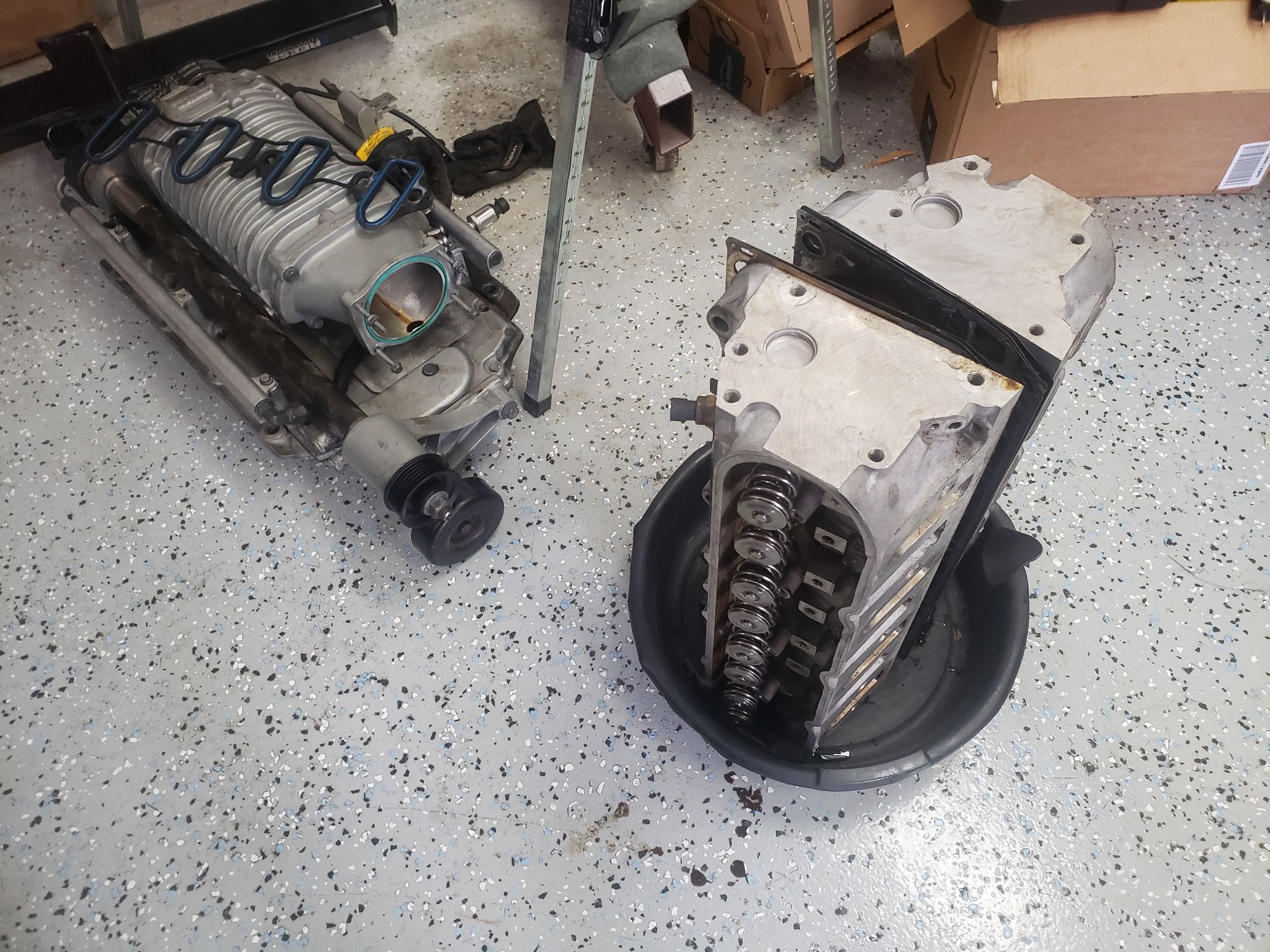

Time to pull the heads back off again.

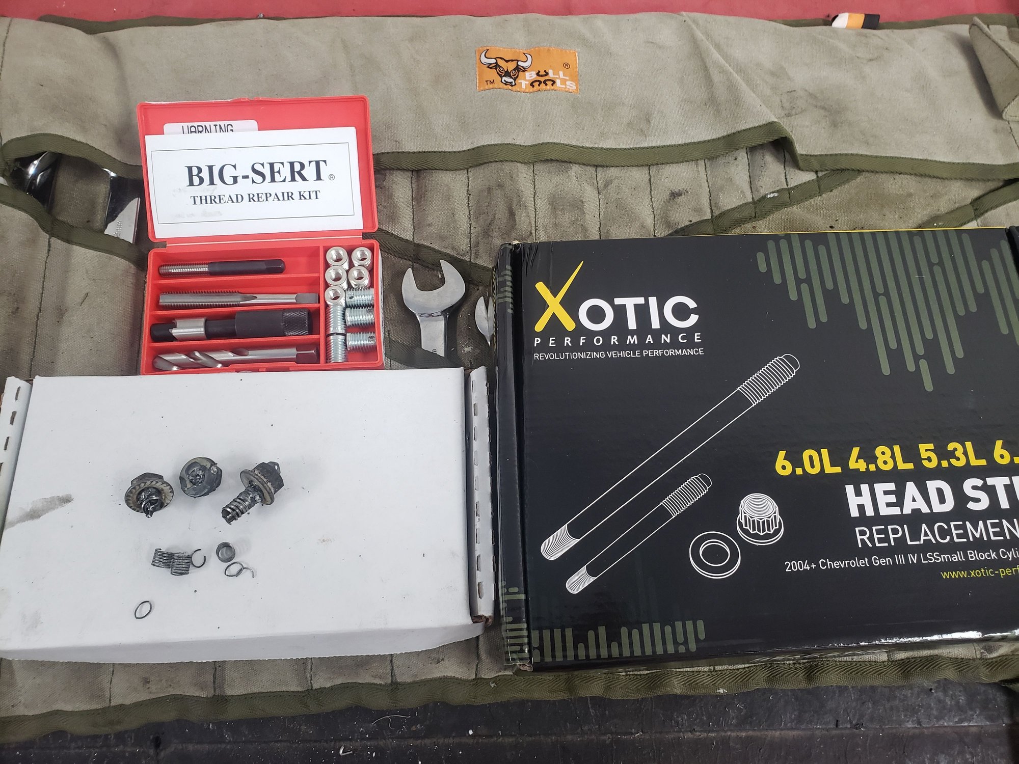

You know it's going to be a bad day when that bolt starts getting easier to turn halfway into the torque spec

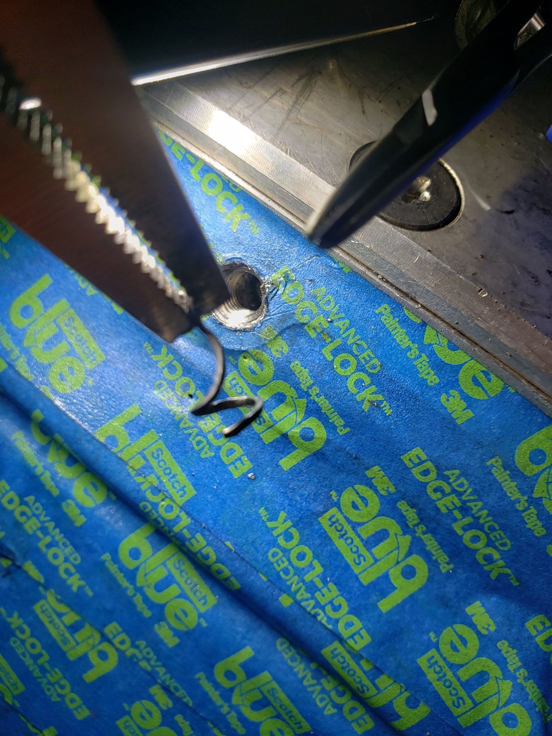

Found out you can't helicoil these.
Big Serts are the ****! Also broke a tap trying to get the helicoil out. Figured I'd try out these new studs i came across. They're really impressive

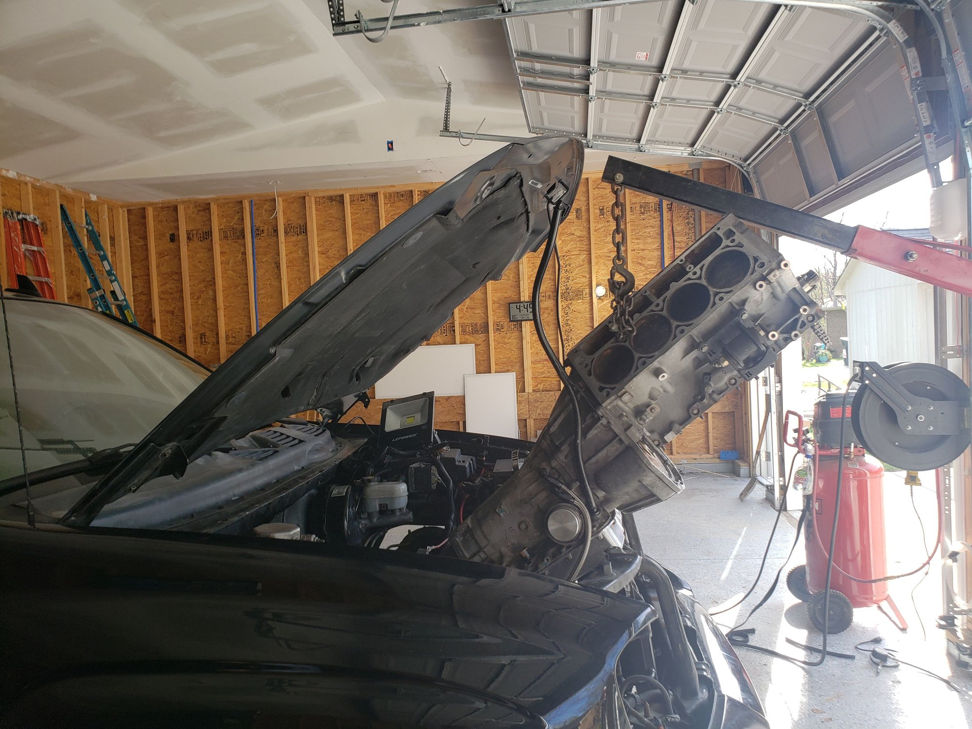

Since I was still pushing coolant out, I decided to get another bare block & swap all my stuff over. Machine shop later found a low spot between 2 bores on the block

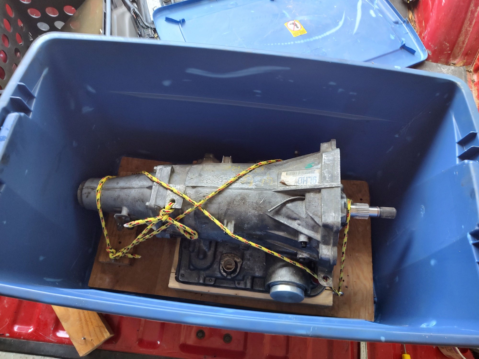

I sent the trans back to have CPT fix/ refreshen it. Ended up selling it on marketplace & had CPT ship it directly to the buyer.
All of my transmission problems are over! 4l80 swap time!

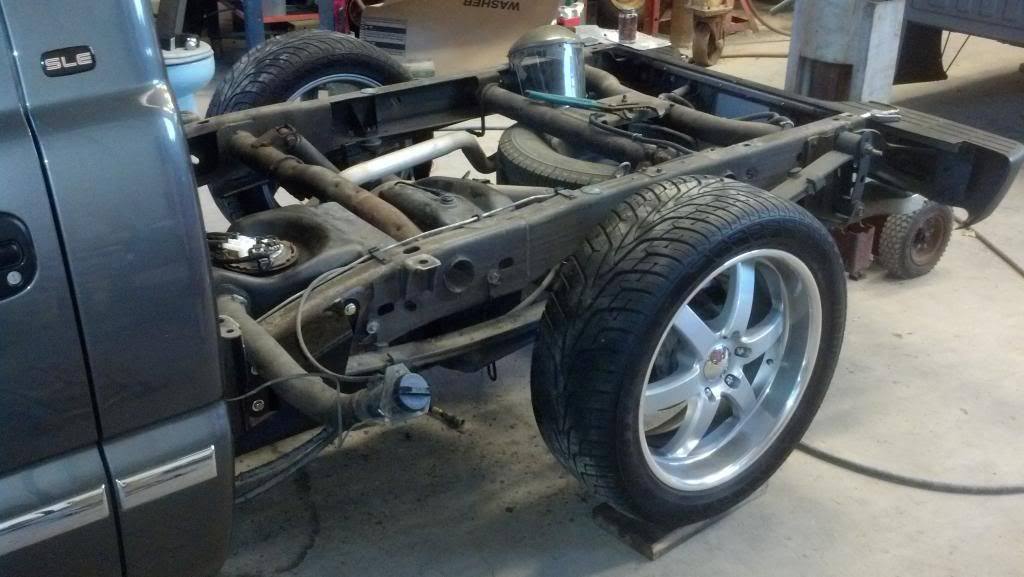

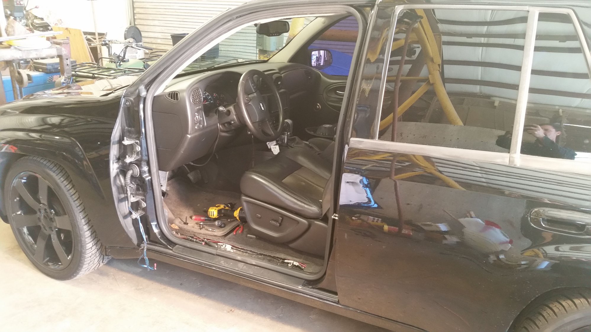

Replaced door pins

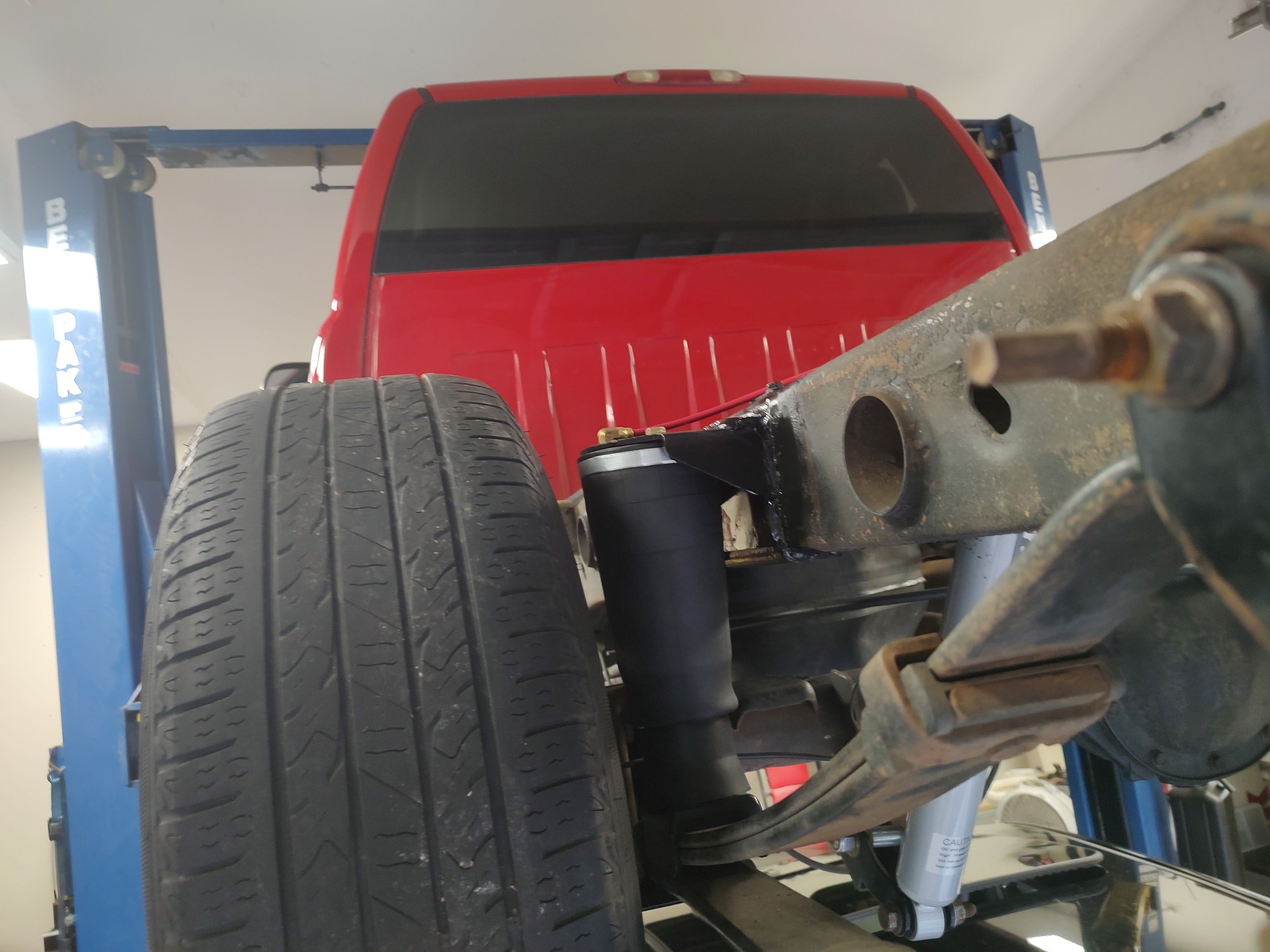

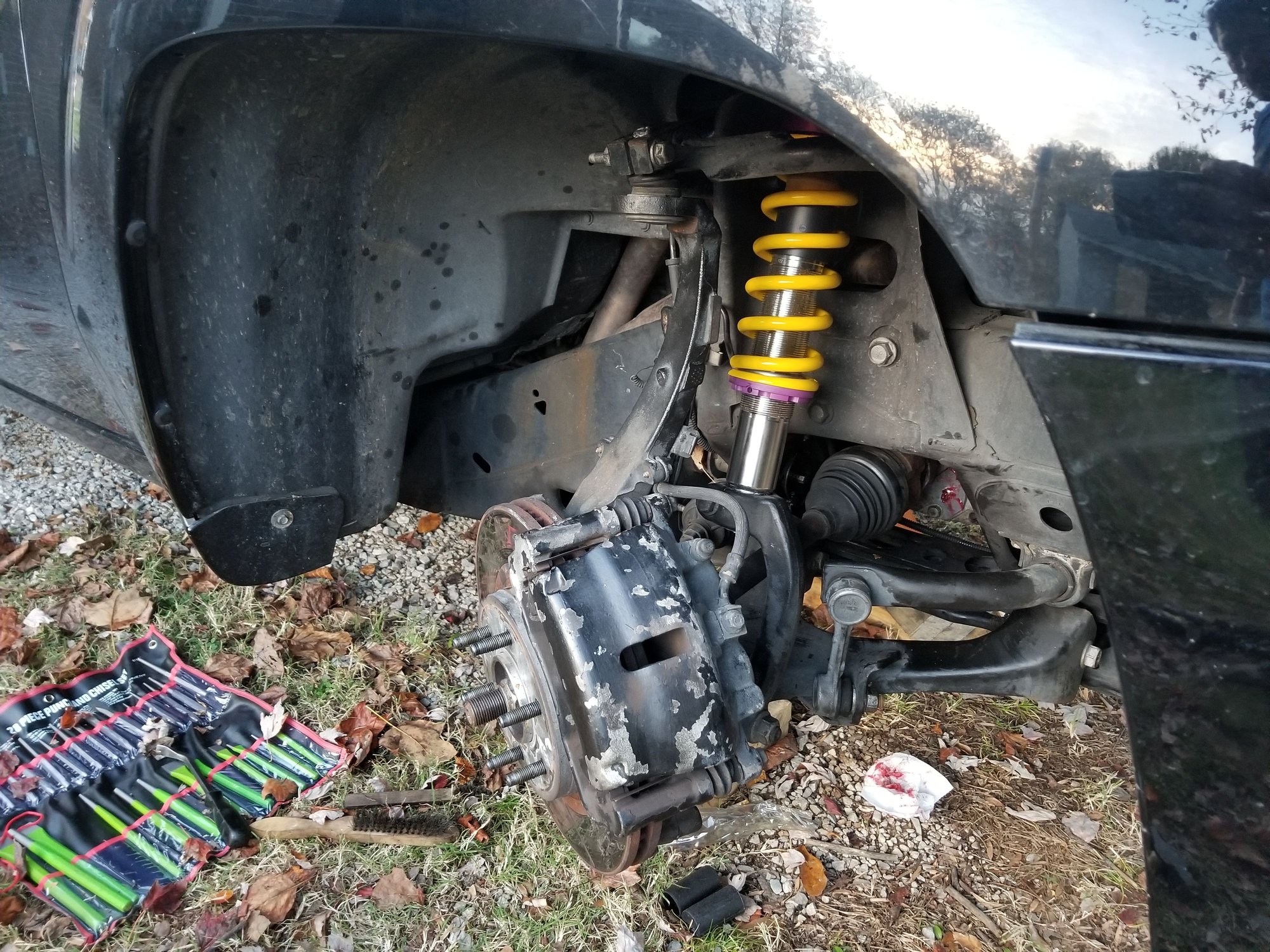

dropped 4/6 & added helper bags
popped some Yukon's on

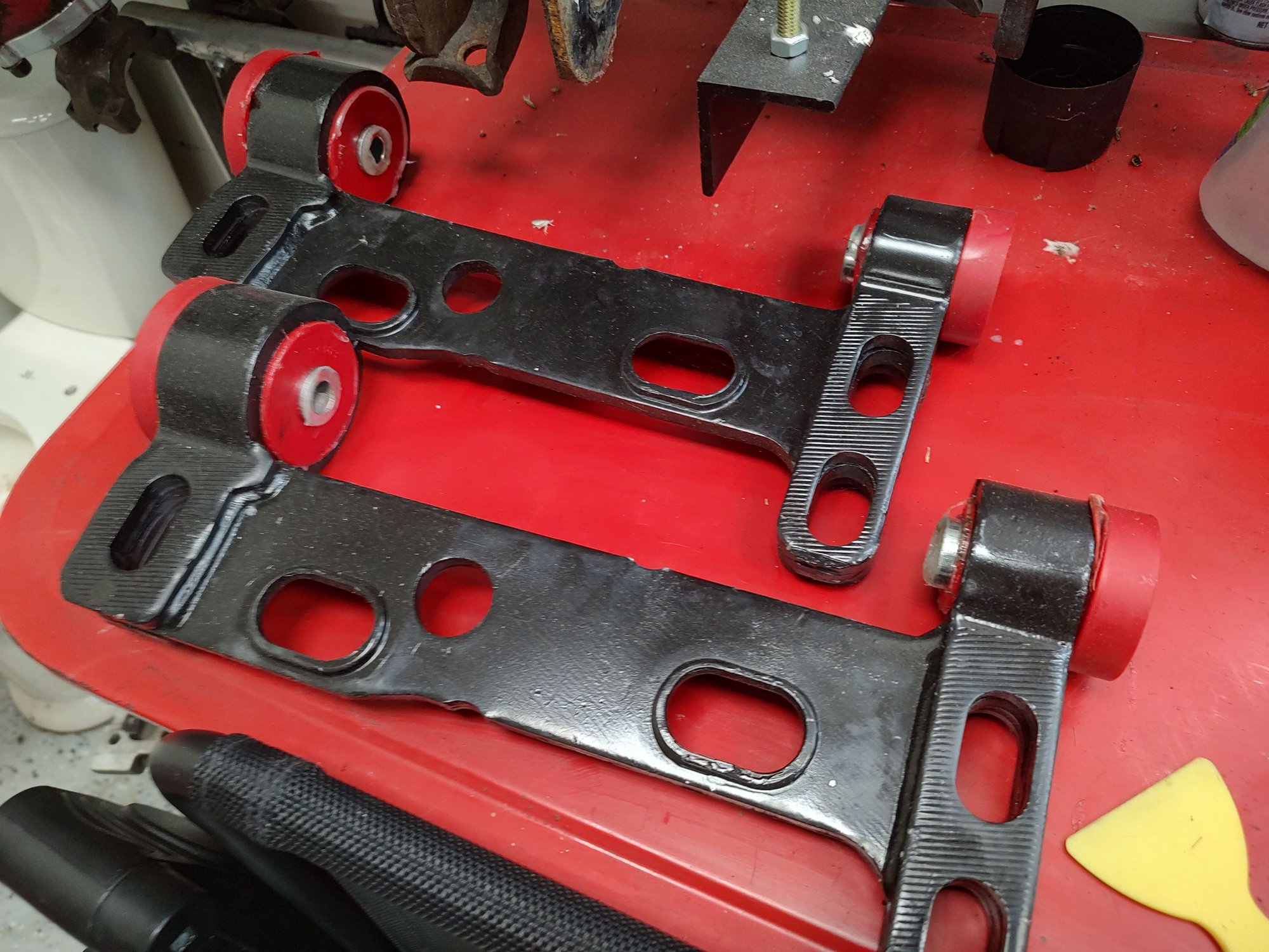

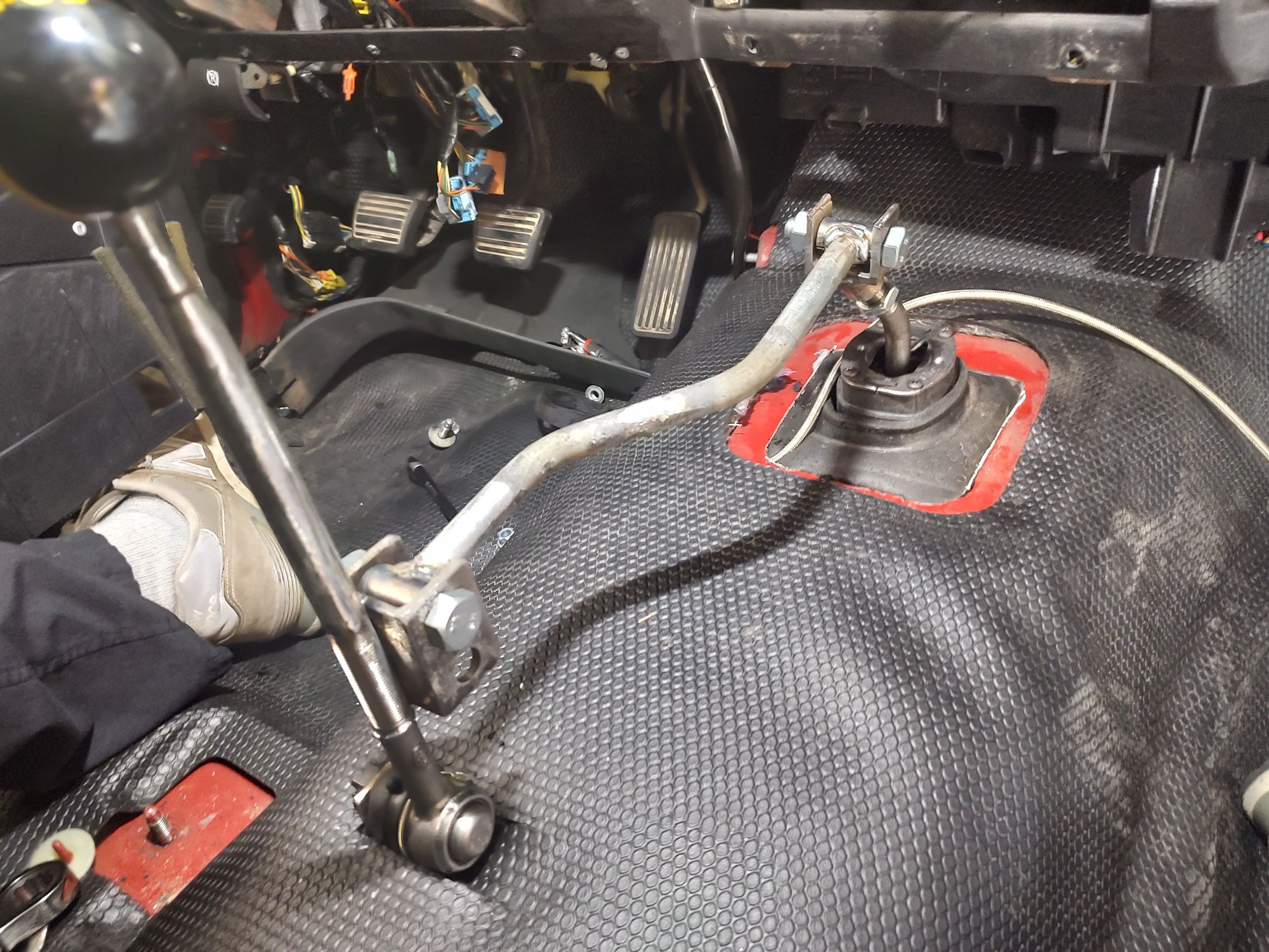

My take on a remote shifter setup & yeah.... I ran my remote bleeder inside for solo clutch bleeds

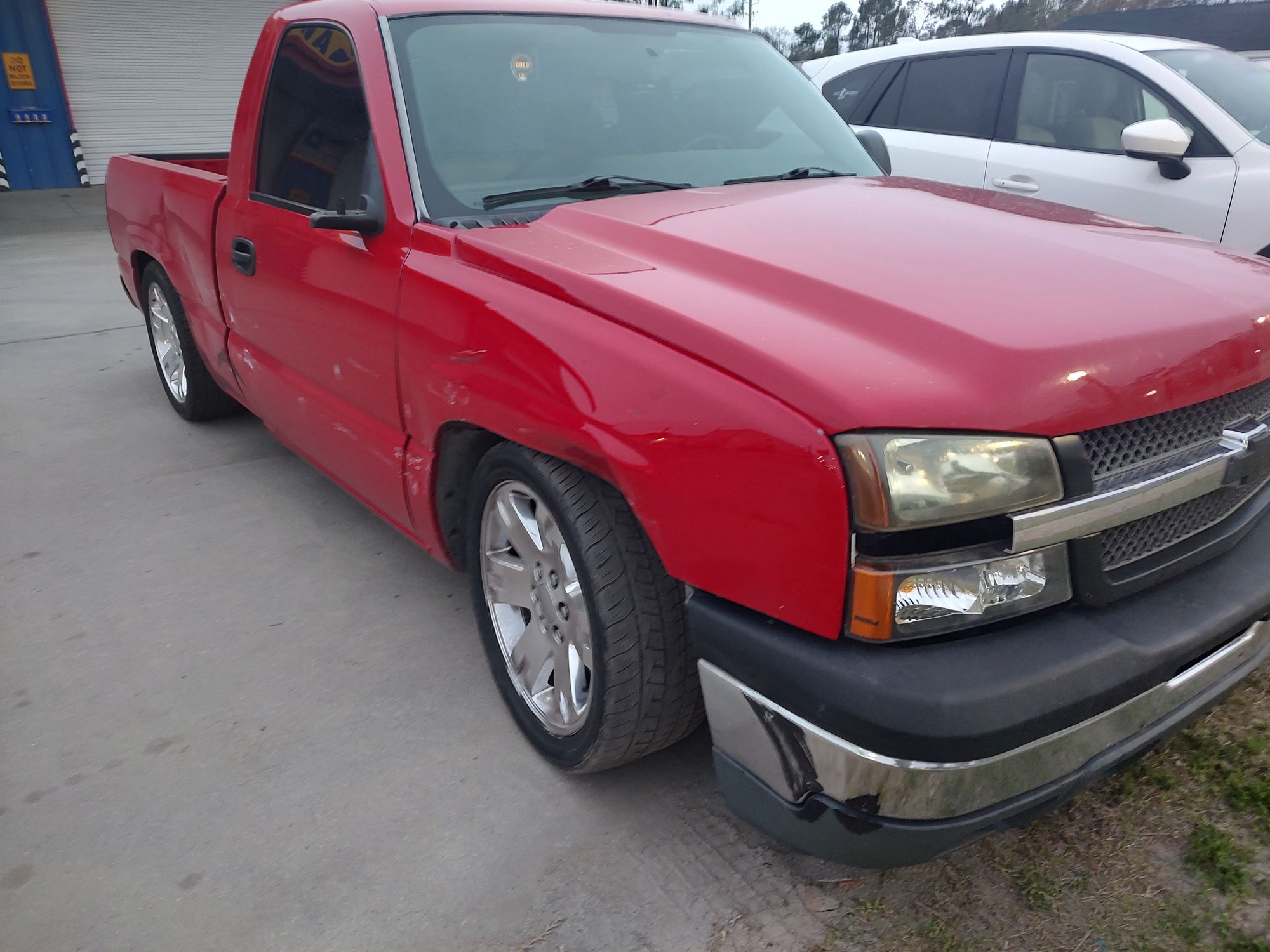

Talked to the body shop about painting them on my way to Georgia & then, this.
F*&^&*^*^% B(*&*& Hit & ran on the interstate...... 480 miles from home
lucky for me there was a repair shop close by

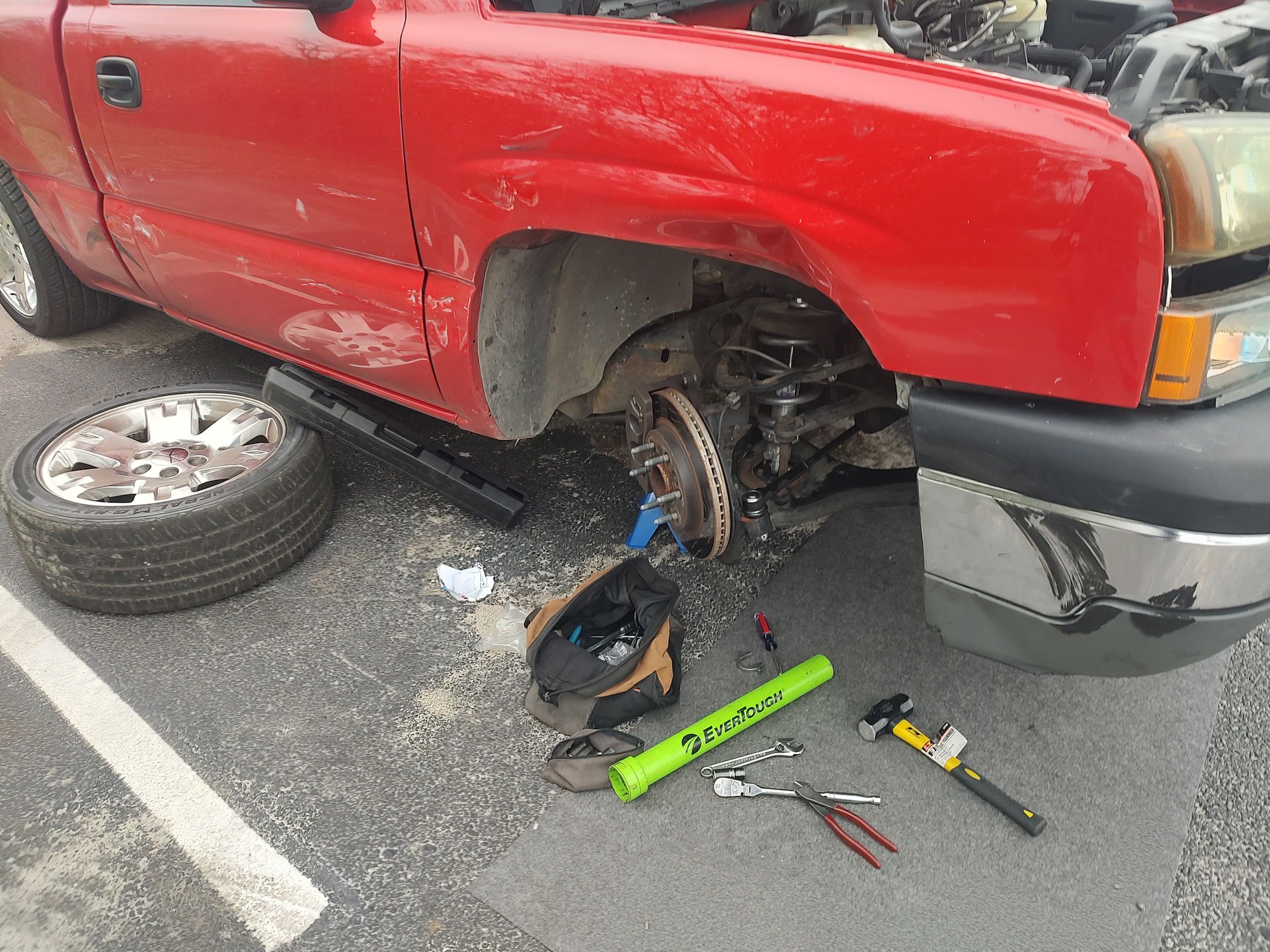

The shop tried to tell me that the rack & pinion needed to be replaced & something about warranties, & liability & not able to align it....
I'd already scoped out an alternative when the Gomer Pyle tech couldn't drive a stick.
went next door, bought a tape measure, a hammer, a jack, a pair of stands & got busy
I set the toe with the tape measure & was back in the road in 2 hrs including the teledoc appointment in the middle of this that i'd forgotten about. I wasted more time dealing with the shop and the GHP
now i'm arguing with the insurance company over the value of an 18 year old, v6 truck
