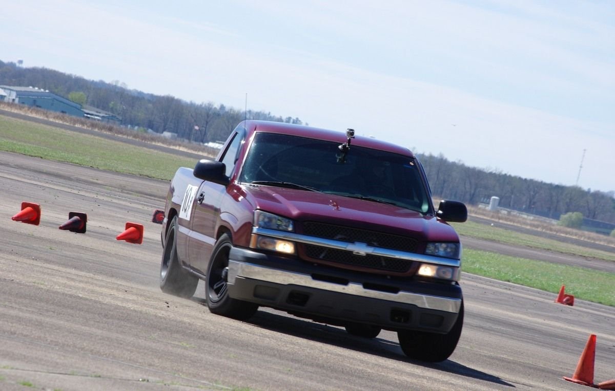

I've been researching swaybars lately.. I'm thinking I will go with a splined bar on the front, similar to how the Nascar bars are adjustable. I'll be sure to update this thread when the time comes.. I do have a couple pics from the last SCCA event I attended, the next event is Sunday I plan on attending it.
Punishing the RF tire:
Look at this lean, this is why I need bigger bars:

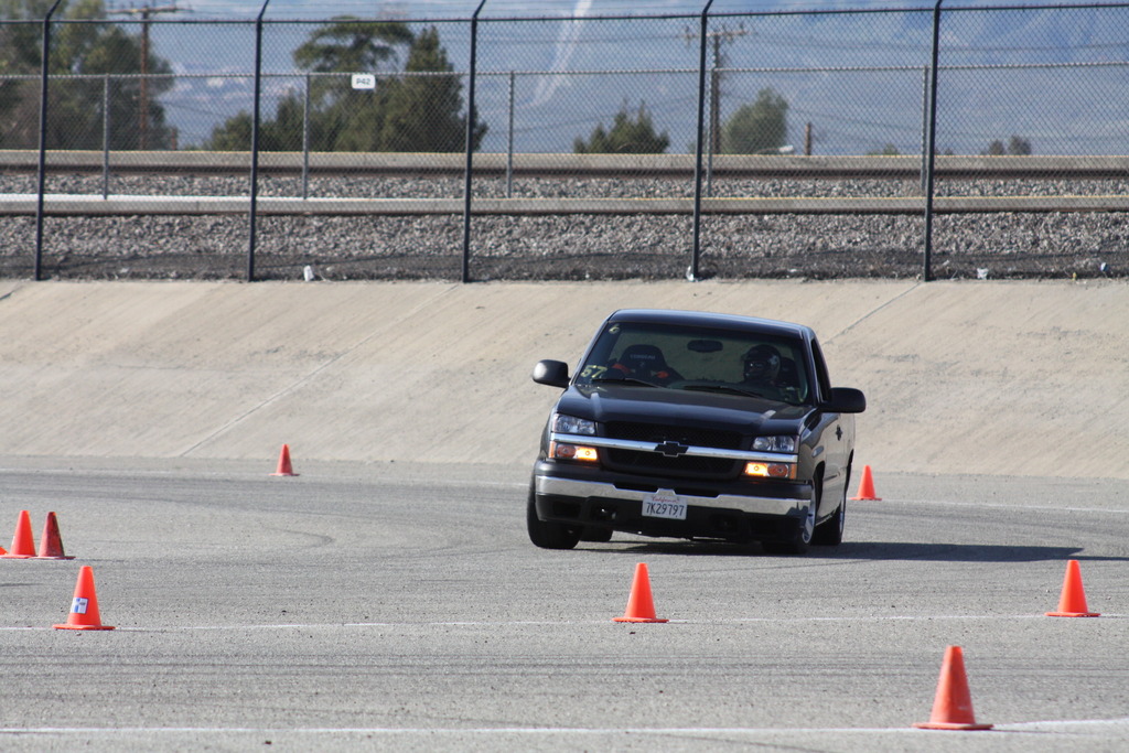

Pretty sure when you are doing your thing this is what everyone else out there in their miata's see

I would rethink adding a rear bar. Looking at the pics, a lot of your roll is coming from the rear. Introducing some oversteer will help with pushing the front end too.

Lots of oversteer and losing traction brings the rear around, lots of understeer and losing traction will cause the front to plow. I think if you find some adjustable bars you can find the right balance of front to rear roll stiffness to get the load more balanced on your outer tires in a corner.
Afterall, that is what you are looking for, to load the outside tires more evenly front to rear so they each give their maximum traction. You don't want to really heavily load the front outside tire relative to the rear because that is the one that will lose traction first and the rear tire won't be doing much. You can also take it too far and load the rear tire too much which will cause it to lose traction first. Its all about balancing that.
Call a sway bar manufacturer and ask if they can make you adjustable bars. I've seen bars where there was no holes on the ends and instead they put sleeves on the round bar that had attachment points for the end links. This allowed them to move the sleeve up and down the bar to increase or decrease roll stiffness. Until they found what worked best. Good luck and post back with what you find!
I know exactly what that's like. This is actually with bigger sway bars, but not enough spring.

I installed a rear swaybar on my Typhoon and considered it the best mod I ever did to that truck, and I hear ya.. and I am not opposed to adding a rear bar. The bigger concern is that with the 4 link in the rear it is very busy back there in terms of mounting a swaybar. Between the 4-Link, gas tank, spare tire, driveshaft and misc brake lines there's a lot of 'confusion' back there and I'll need to make a concentrated effort to get something that fits well without hitting other components. Not impossible, but not just an order & install affair. I want to get a better setup in the front and resolve that first before I start on the rear.
Ugh.. I know that feeling Steve-O.. That's exactly how it felt last Sunday.. I know there's a fix, just gotta keep chipping away at it..

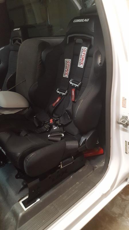

One thing I did find myself doing was I was 'hugging' the center console in preparation for turns!! I didn't realize this before, and I am certain it isn't helping my technique so I believe I will be working towards a harness of some sort or at the very least, a competition lap belt to help hold my butt in place!!!! In the mean time to compensate, I have moved my seat forward about 3-4 clicks to help wedge me in place, at 6'5" tall it's not uncommon for me to get wedged in a car/truck anyhow. This did wonders for my technique and I actually felt better on my last 3 runs.. I can't believe I didn't do this before, I used to back when I autocrossed my BMW back in 2008-2010. I believe a 4 point harness is in my near future if I can figure out a way to mount it in place without losing too much recline room on the seat (being 6'5" tall I don't always want to feel 'wedged' in place), I do use the truck for other daily usages. Anyhow, more to come.

I am just going to leave this here and say this is what you need
Just kind of said screw it there at the end eh?
Attached Thumbnails So I Autocrossed My Truck in an SCCA Event This Weekend.... (Pics and Video)-16998683_10210230104921595_2677242339364761300_n.jpg
