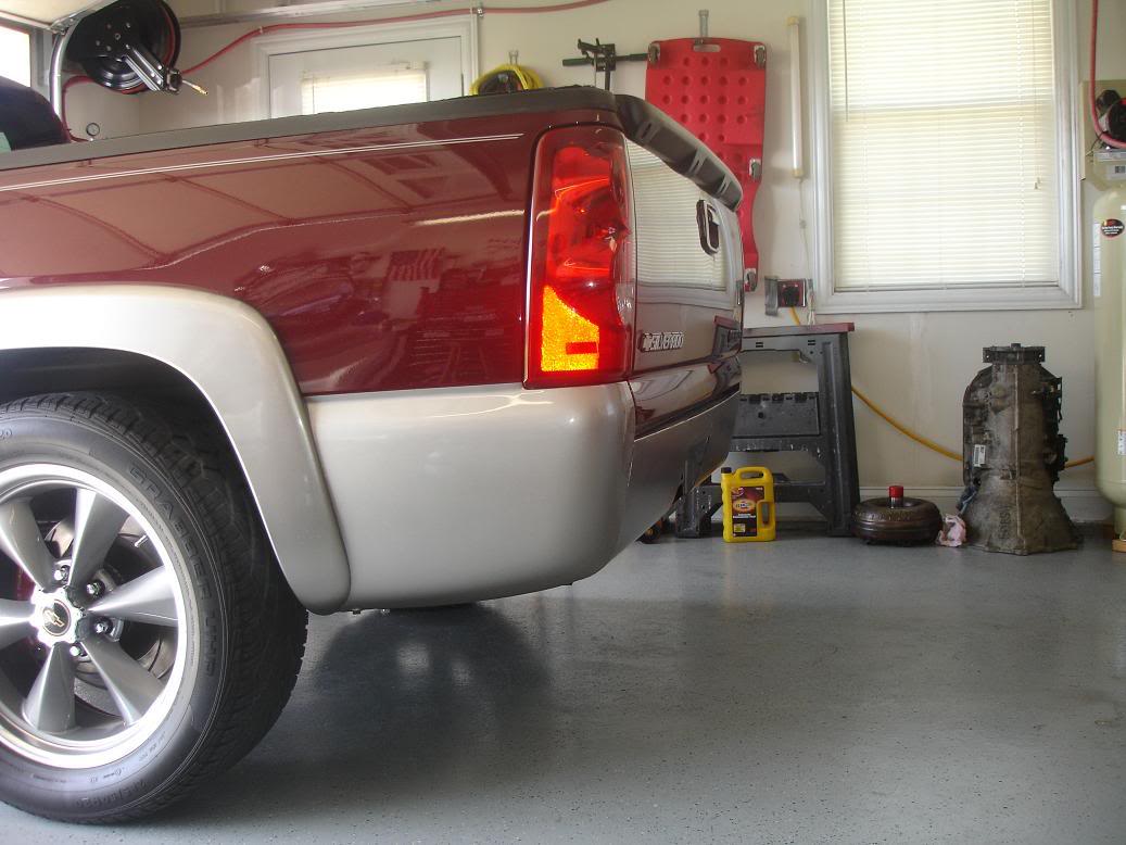

Getting the rear of the pan buttoned up.
Seam sealer.
Then undercoated.
Getting the bumper off. Pain in the *** by myself.
Bolted up the new hitch. Wow the tips are long
Tips off. Still had to cut off a bit of the pipe to start the test fitting of the roll pan

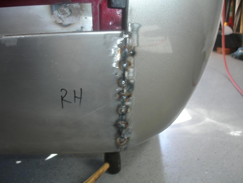

Quite a bit of trimming on the roll pan needed both sides to fit it up. Decided to weld it in.
As she sits right now. Have to pull it back off and grind down the spots to weld.

Point of no return.
Lots of grinding and still a long way to go before its right.
