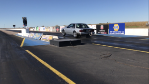

Little update, traveled from ND to Nebraska for a small tire shoot. Just trying to get a few more runs in before the snow falls. We ended up getting second place out of a 8 car shootout. Wasn’t able to make the last race because after the burnout the car had a knock in it so I shut it down. It’s either a main or rod bearing. I been watching a low oil pressure issue since I got the car and after 3 track visits it spun. Any case should have Engine at local builder within a few weeks to get a complete update on her. Hope it’s a simple fix cleanup and bearings. Attached weekend fun! Was a great weeekend even though we didn’t get to finish last race.

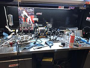

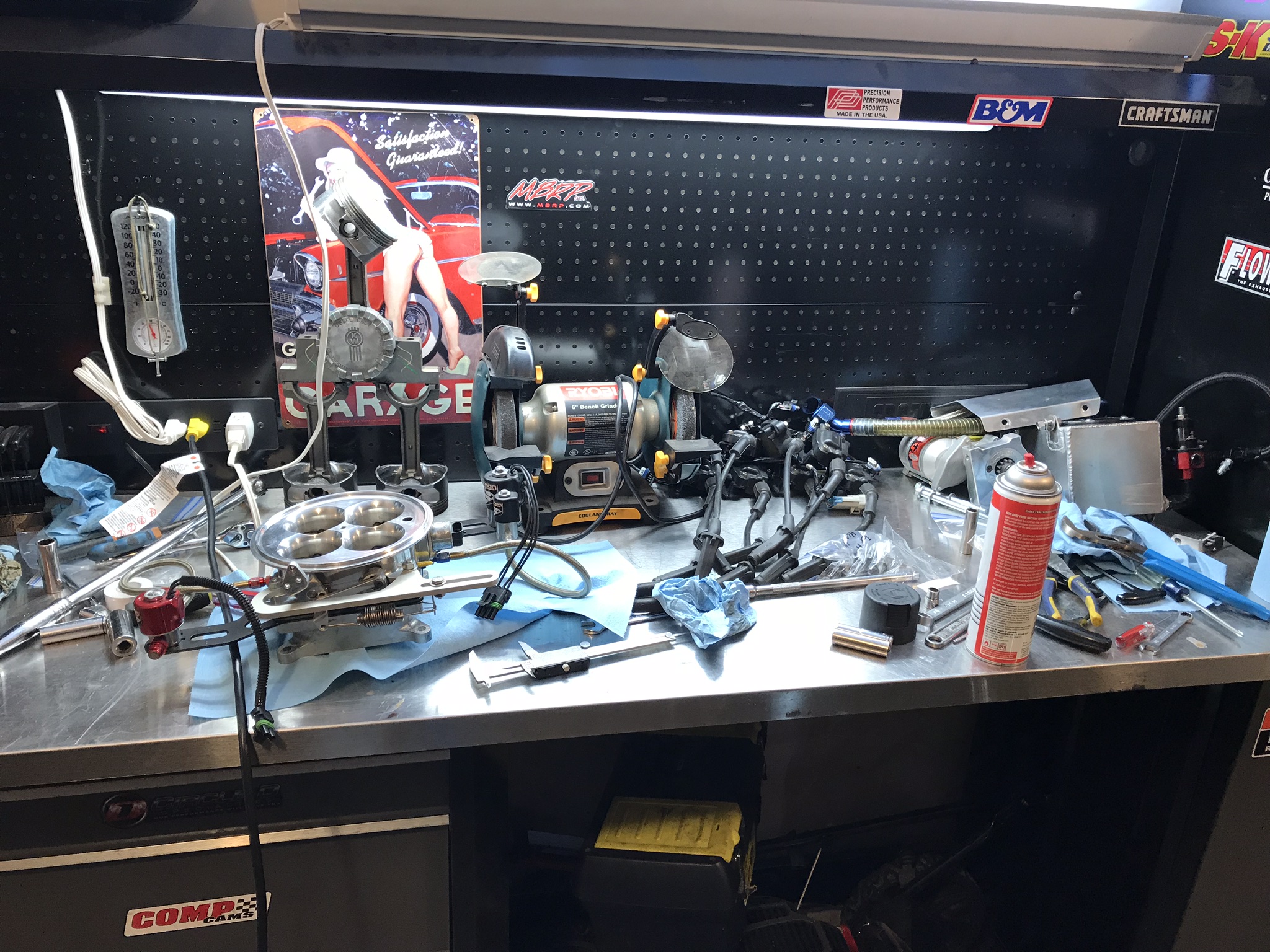

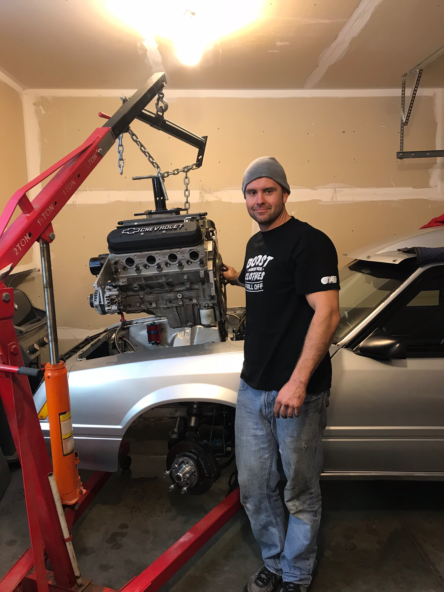

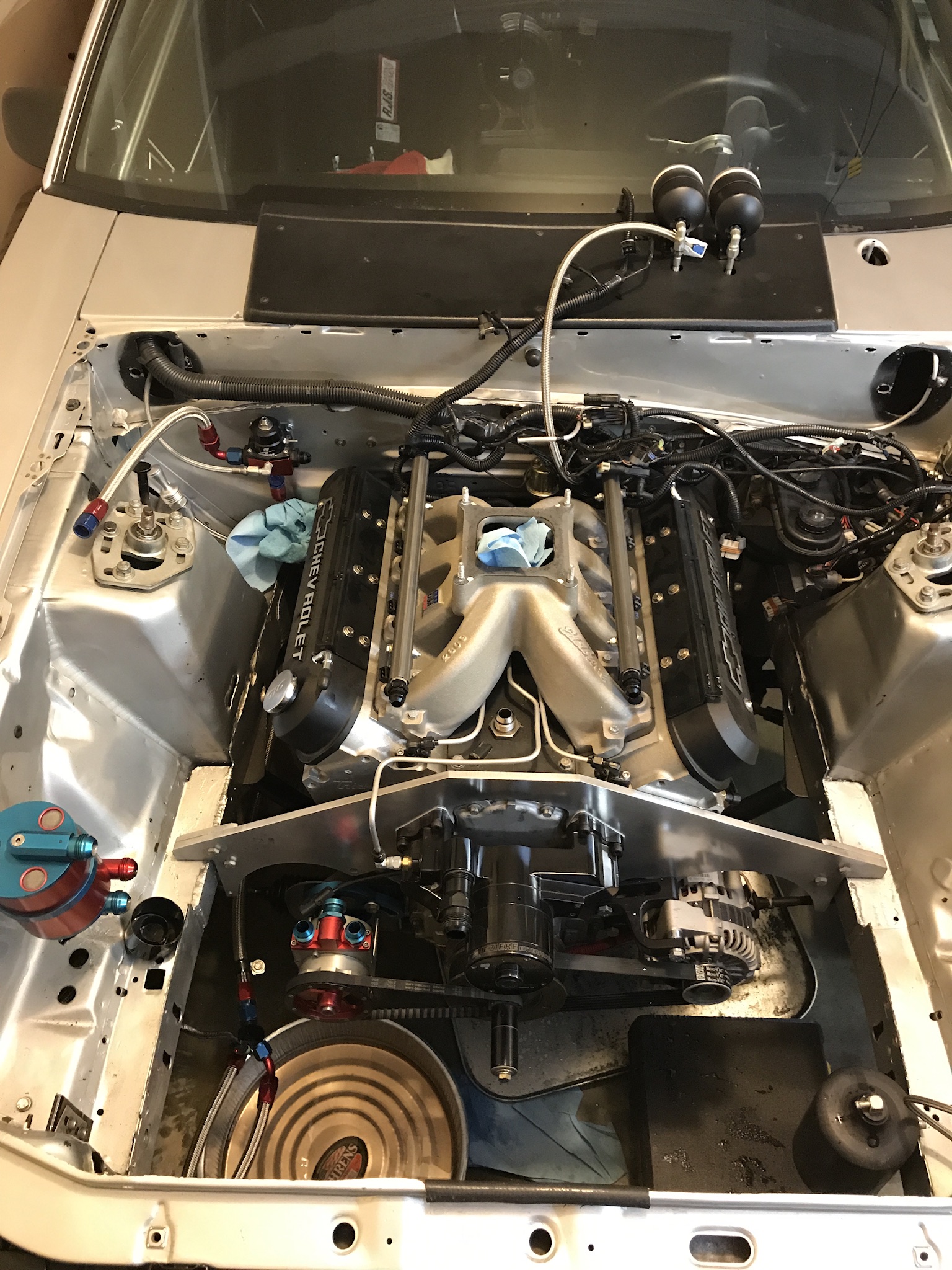

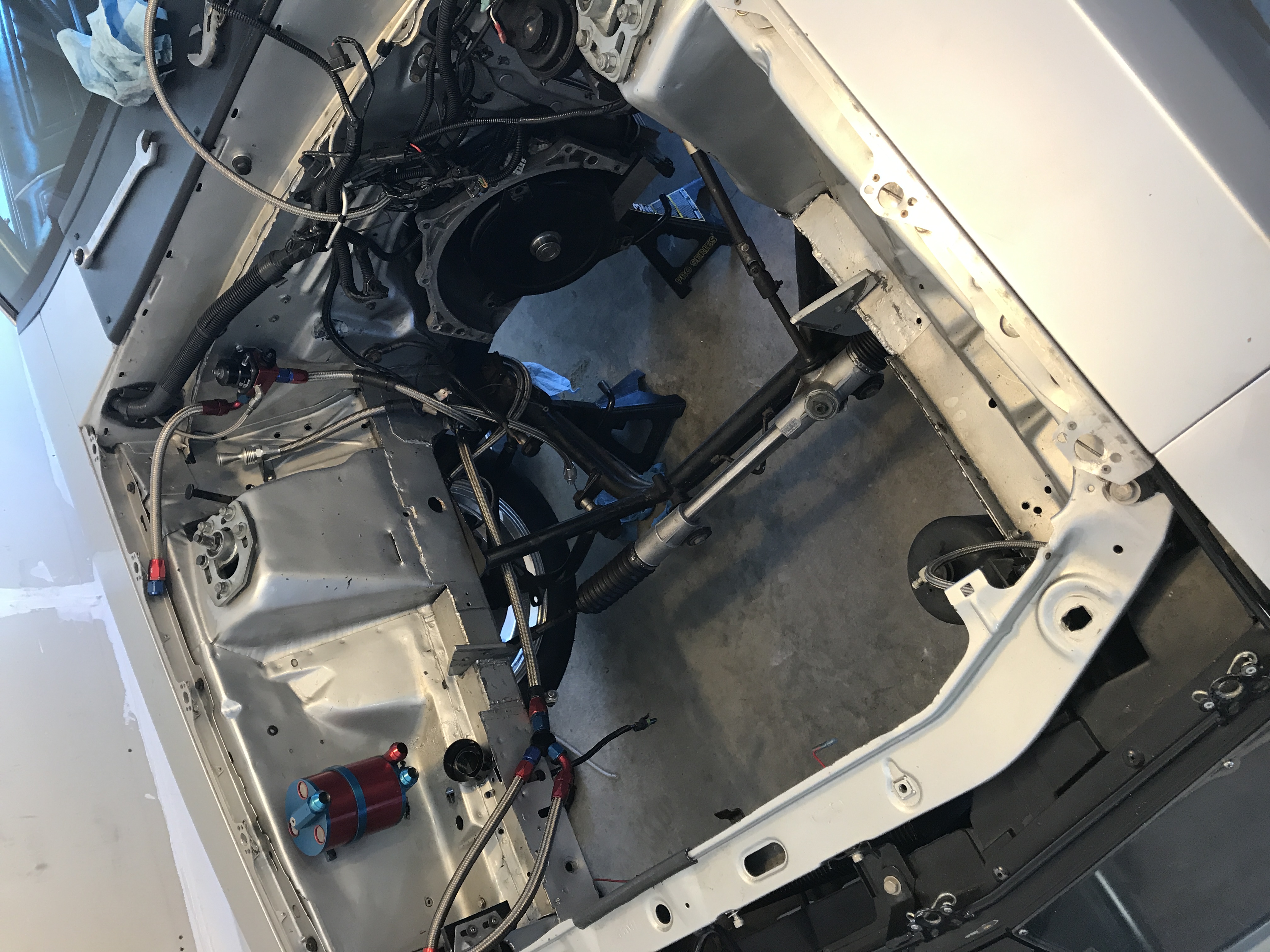

She’s out getting freshened up and inspected. Also getting mains pinned and block half filled. Considering switching from the real street plate to the sledgehammer or going direct port. Any one have similar experience making the switch? Would really like to get this car setup on around a 300 and let it ride every time out on it.
