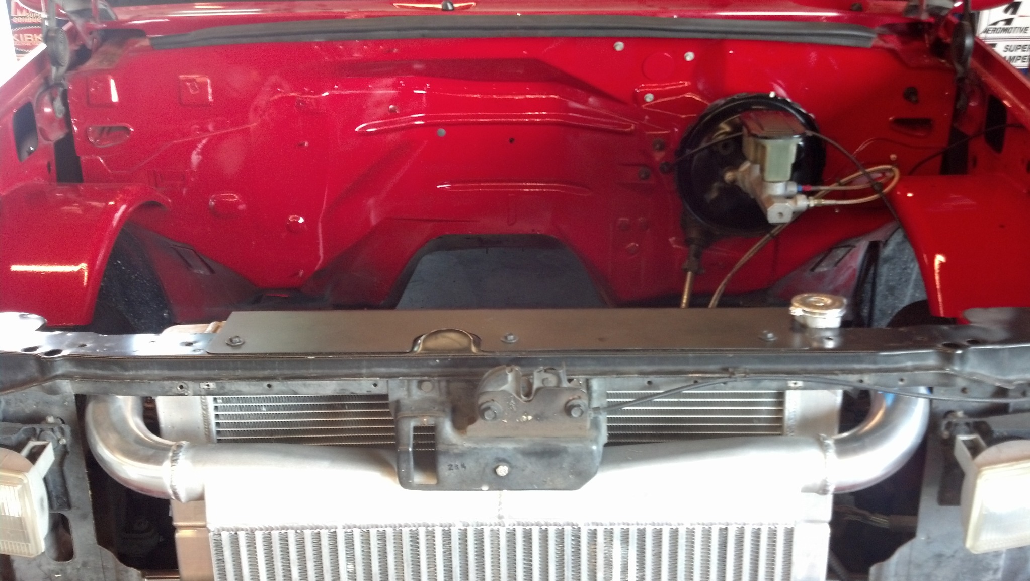

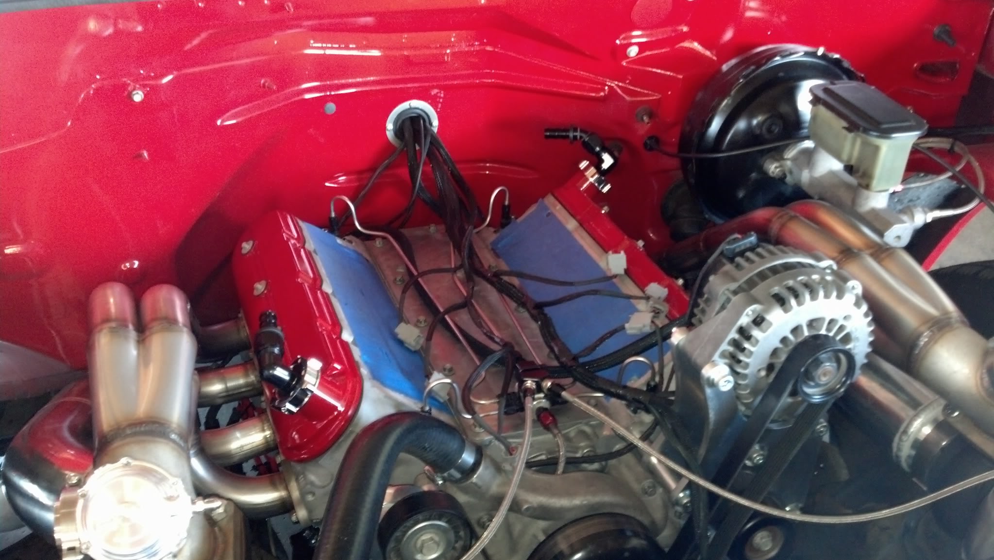

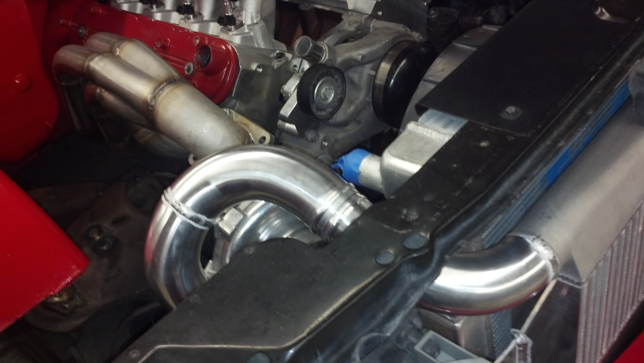

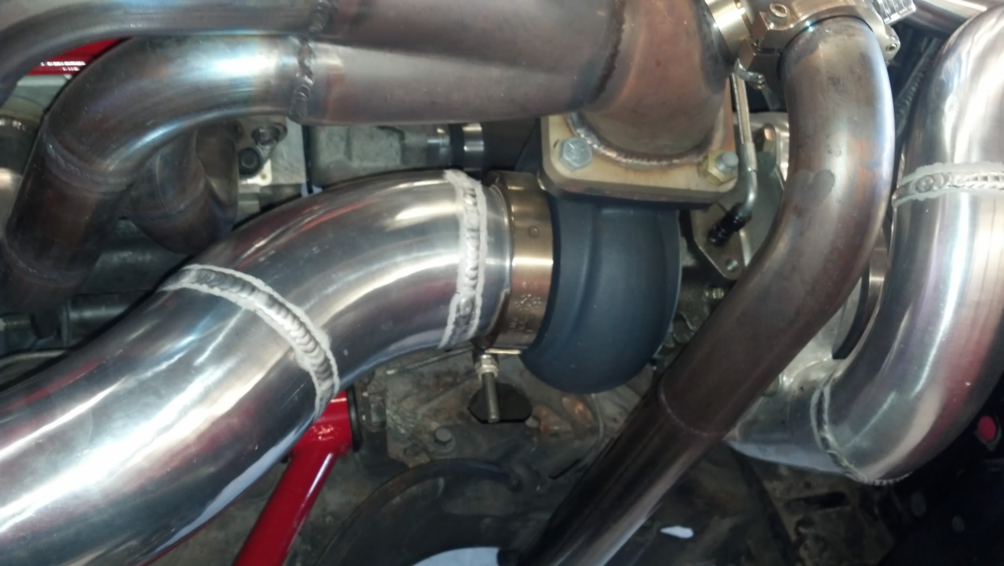

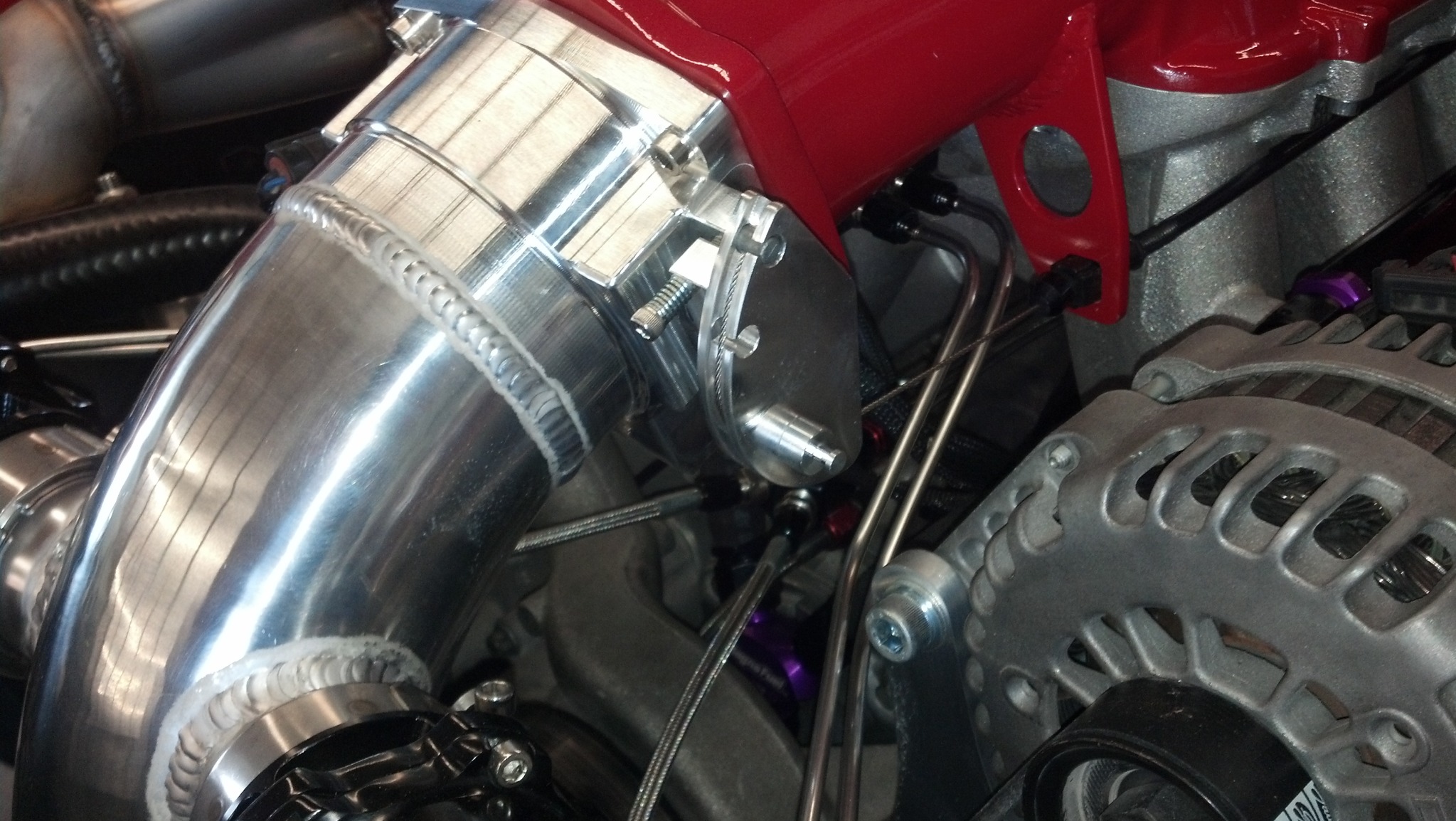

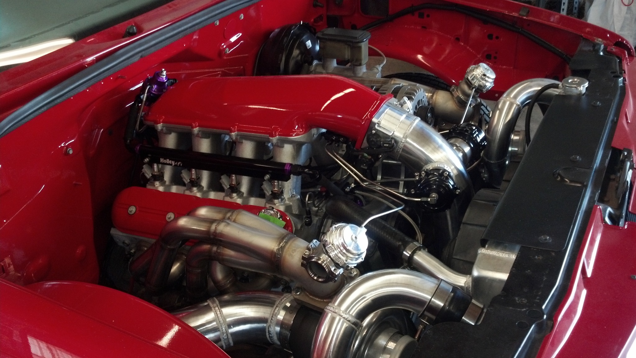

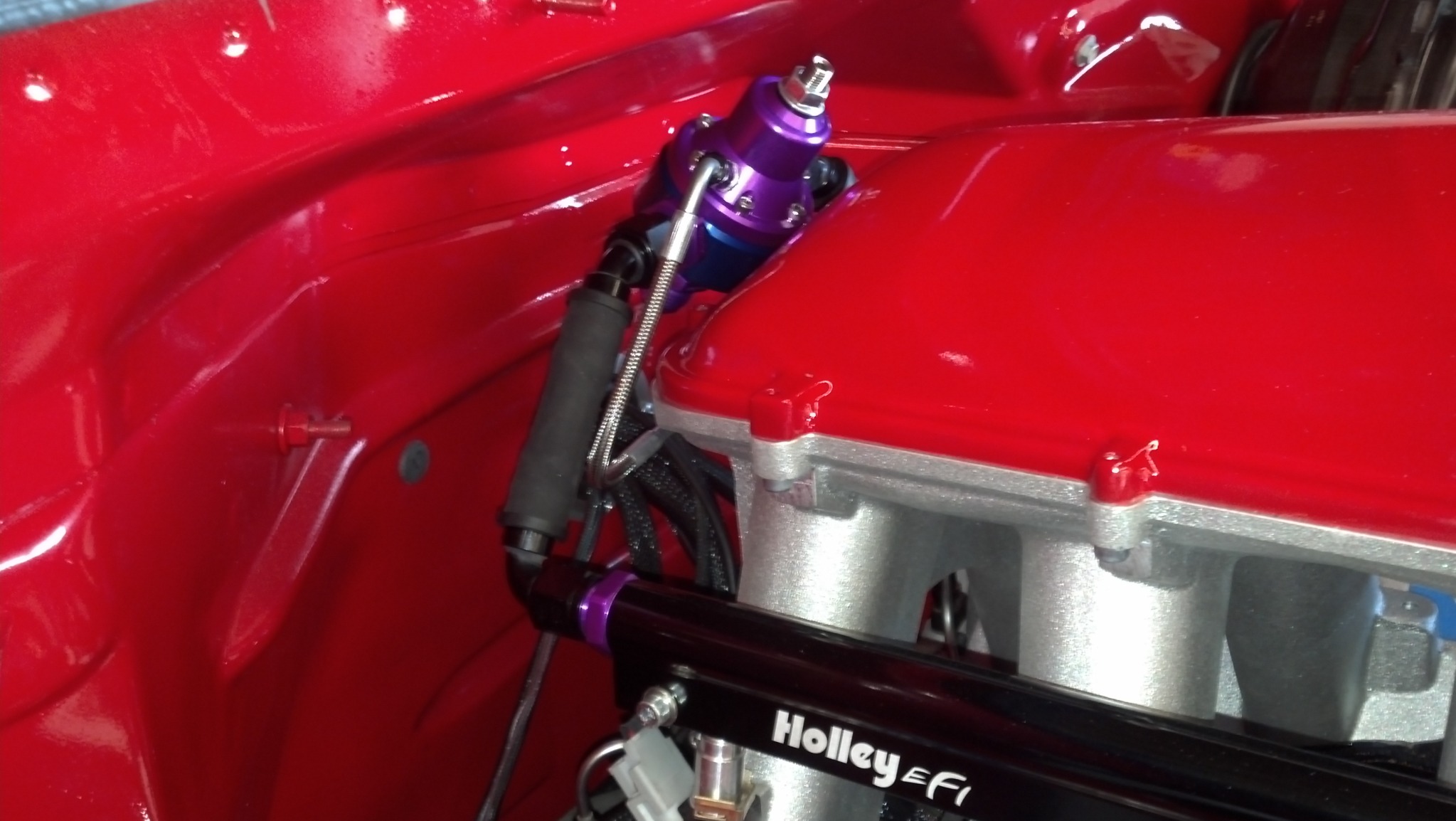

Finally switched from the bottle to boost. Been wanting too for a few yrs but finally got around to doing it. Should have done this years ago!!! The truck is still mainly built for the street but we will see what the track has to offer..

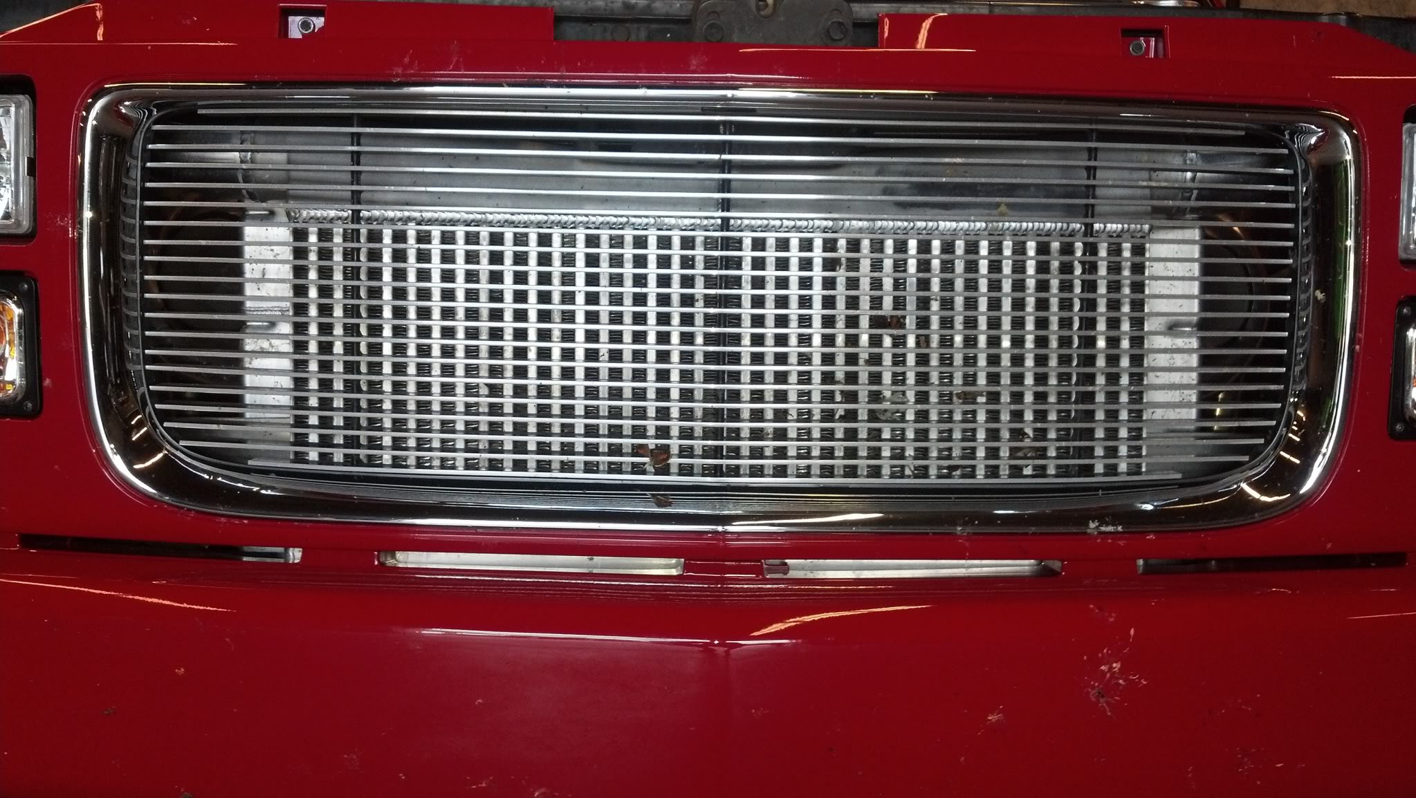

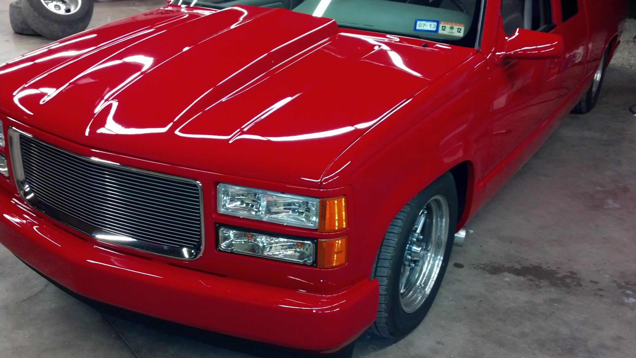

Looks damn good. What intercooler are you running?

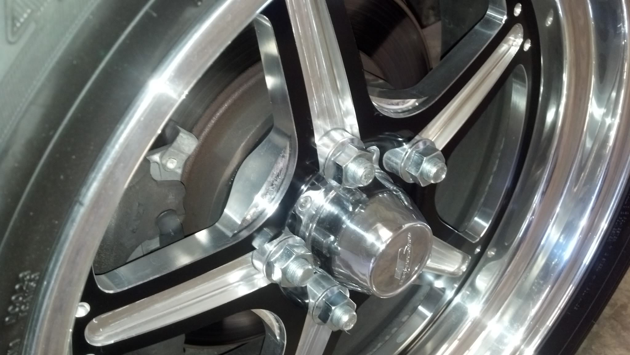

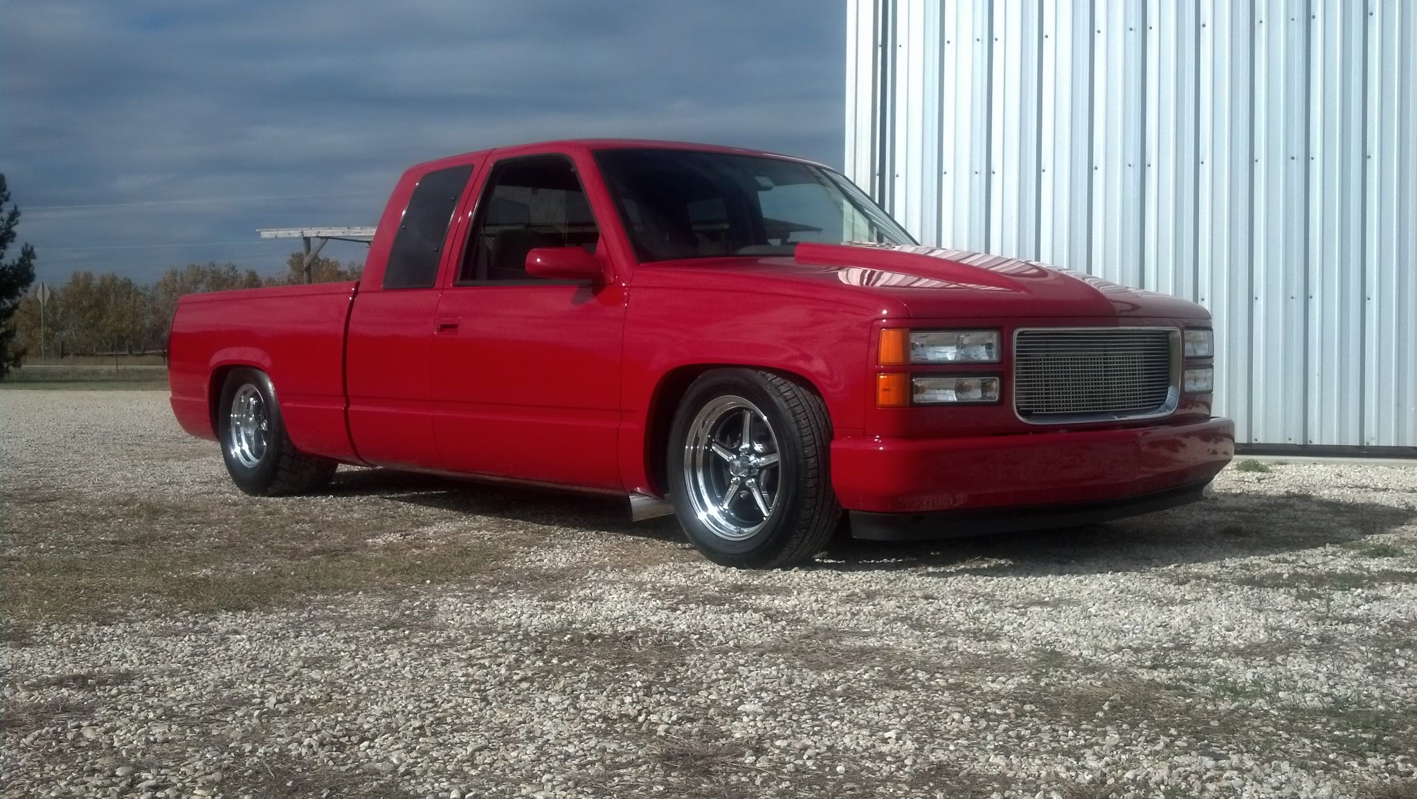

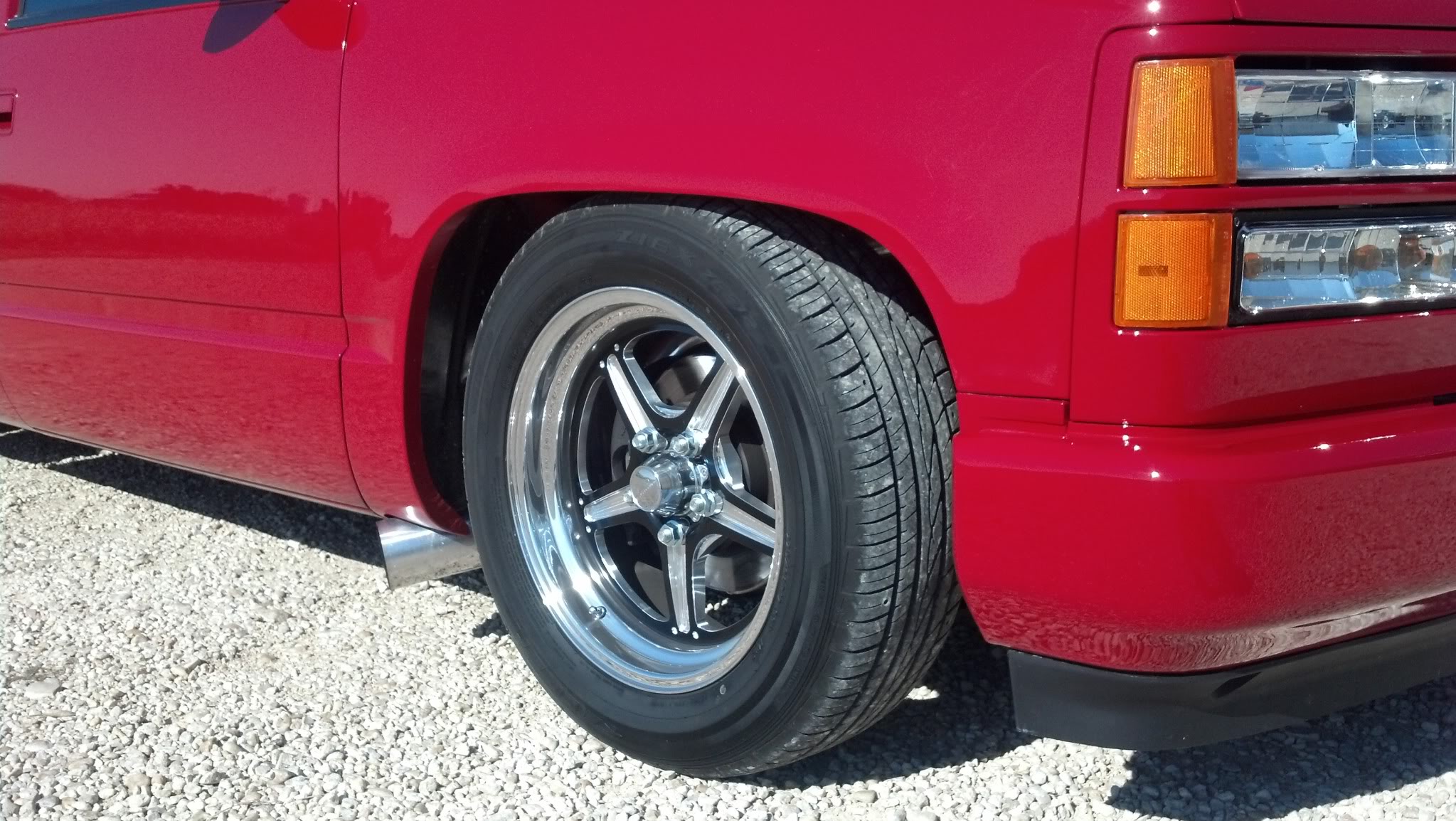

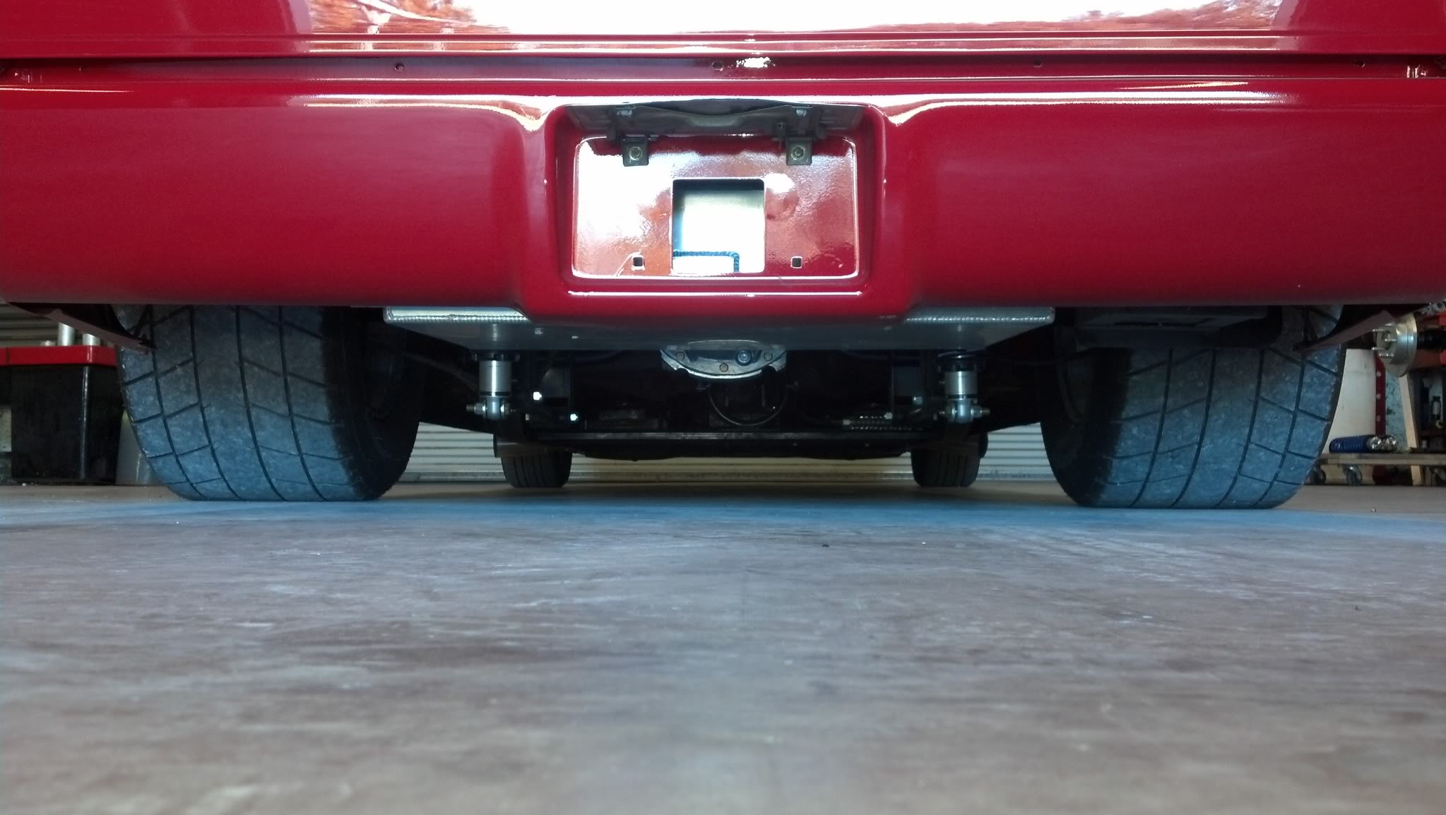

Damn thats one badass truck. Makes that bodystyle look real good with ur rear wheel setup.

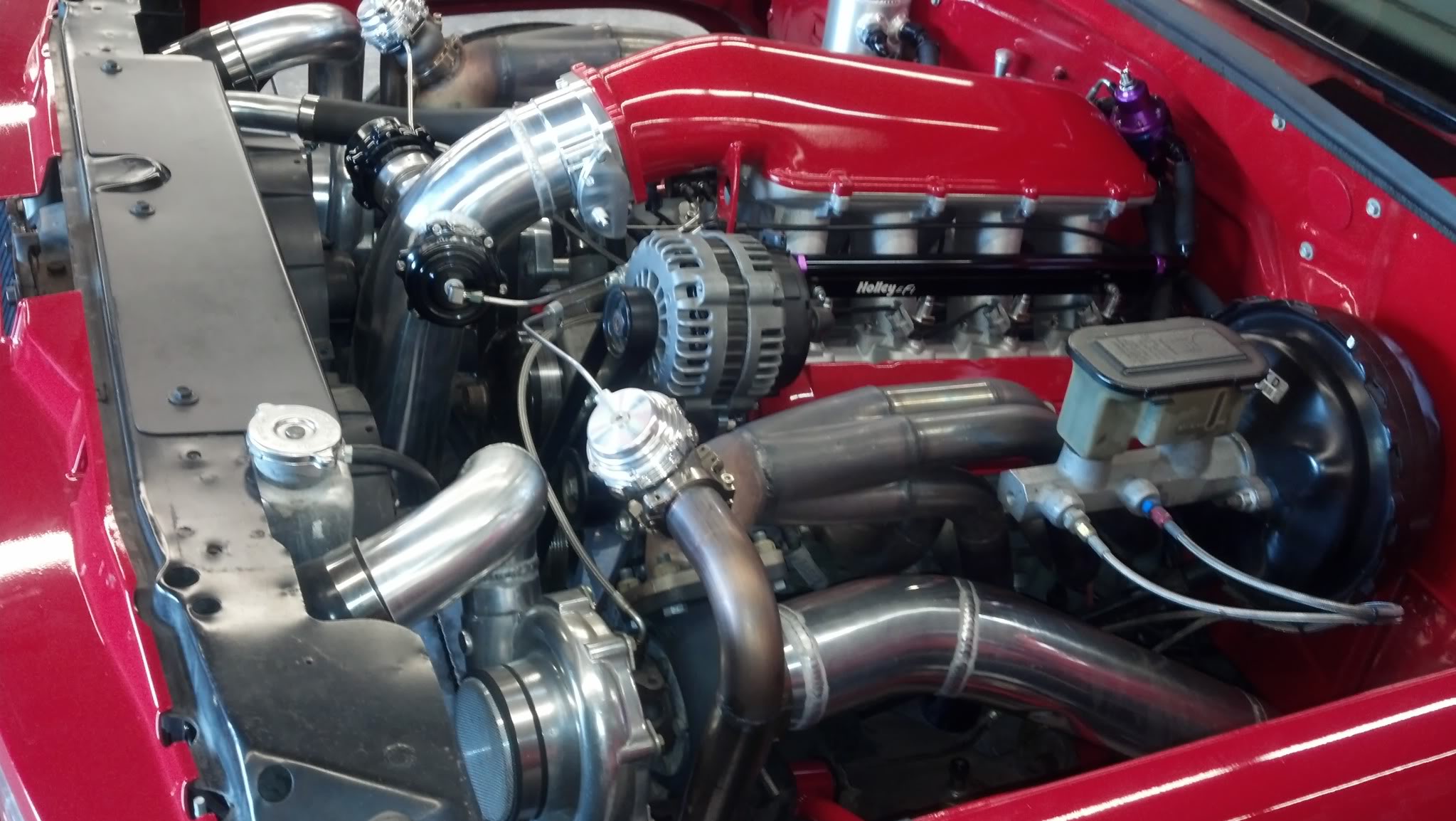

looks awesome! any specs on the engine/turbos?

Wow! That's one clean set up! I love it! Everything welded up beautifully!
What size are those turbos? And how much boost will you be turning it up to?

Great looking truck, pics are a bit big though.

Right now its a L33 with 317 heads and LS9 gaskets. Twin Magnum 76mms with .96 housings. Just a temporary setup till I put the stroker back in. It will be a 404 with same turbos or bigger. Its on 26# right now..
