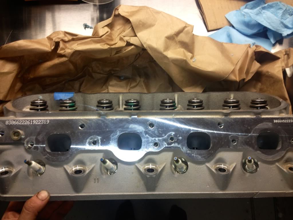

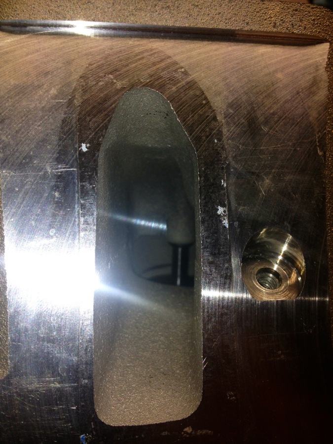

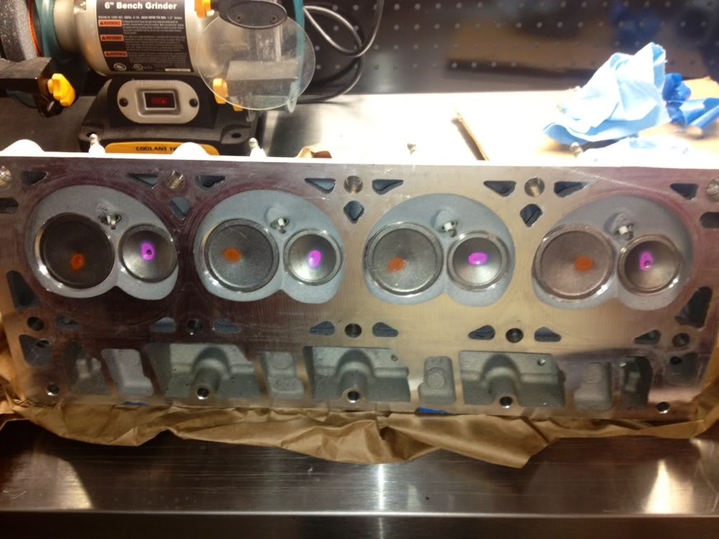

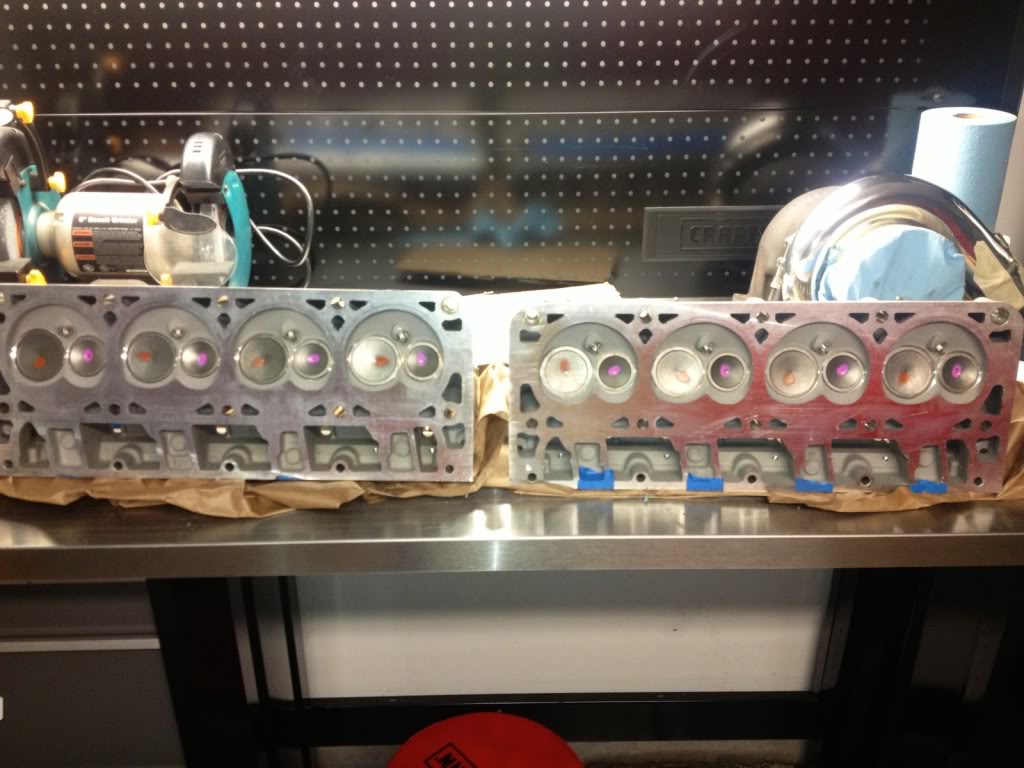

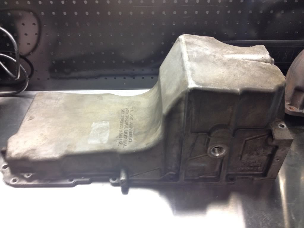

New 317's came in, even have the OEM Acdelco/ngk spark plugs. Any body need a set lol? See if I can make some power on the OEM stuff again!

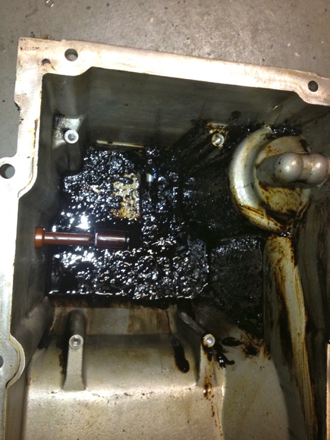

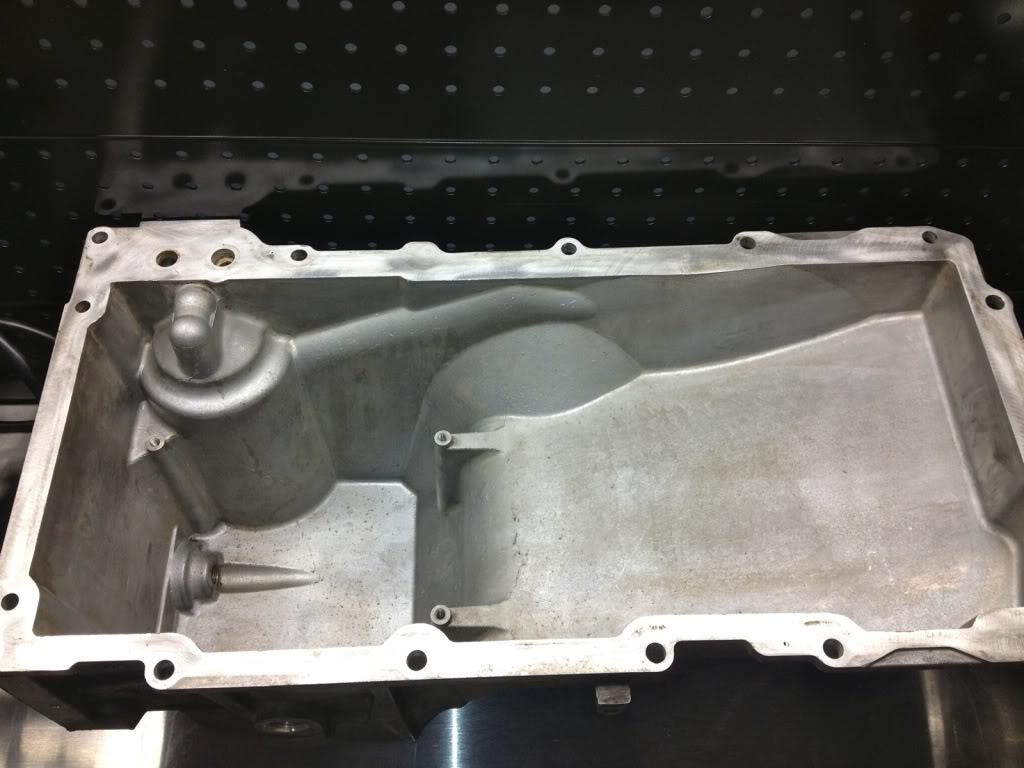

Also picked up a oil pan as mine was cracked by the angry rod. This pan was nastyyyyy, but couple cans of carb cleaner and a roll of shop tows later I think it's pretty close. Outside of pan still looks kinds dirty though even though it's clean. Any ways to paint this bad boy black and have it stay looking good?

I sandblasted all my aluminum covers and they looked brand new. Not painting all of them black when I had it disassembled is something that I regret. I say paint it and see how it looks.
