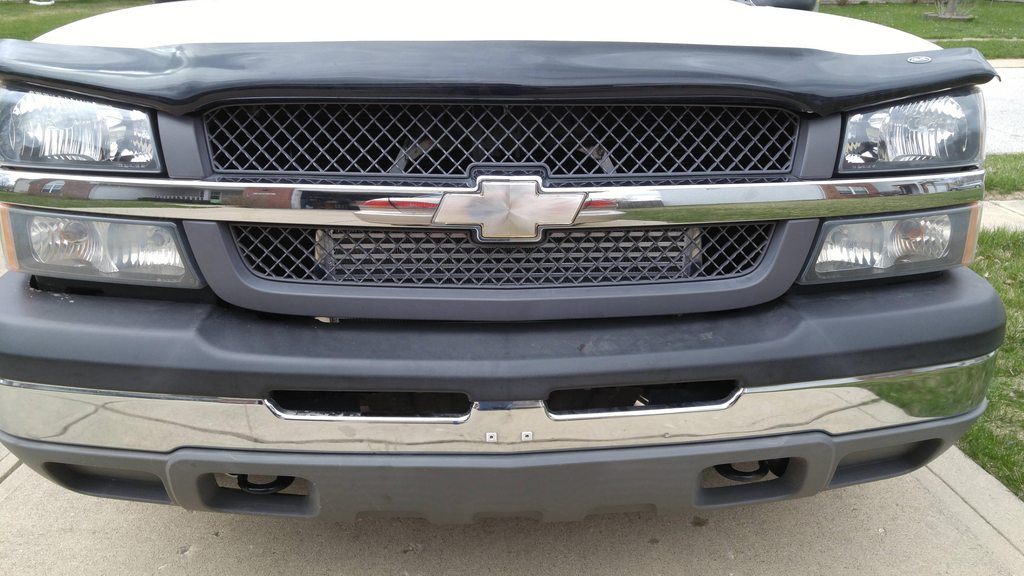

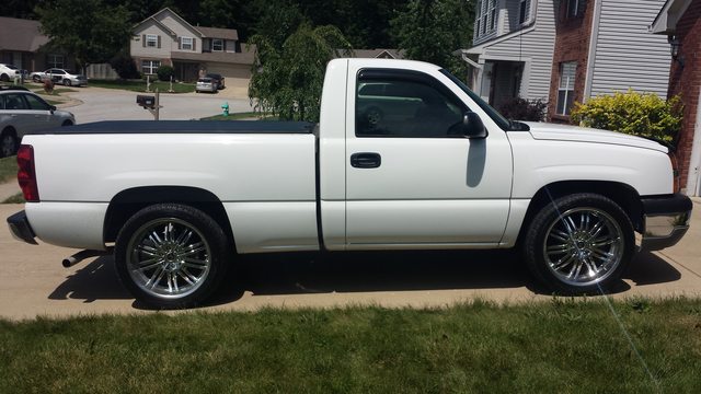

The day I brought it home. It had 22's on it which rode like poop, and weren't exactly my style.

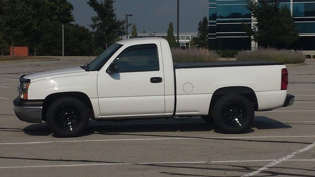

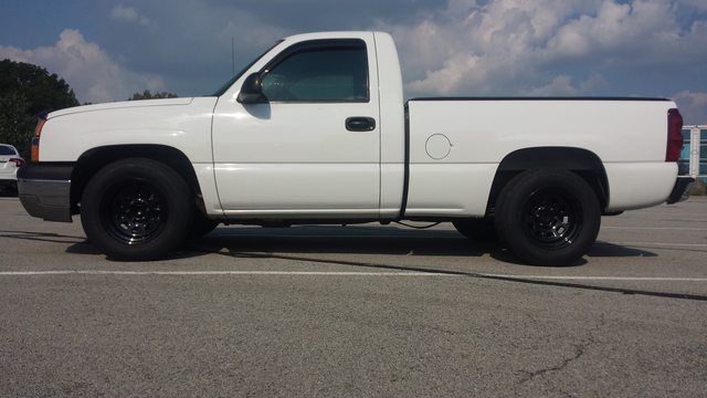

First thing I did was sell the wheels, and buy some D Window Steelies and put some Nitto 420s's all the way around.
*the pictures are pretty shitty to help see what the wheels actually look like. I will try to get it in some better lighting.

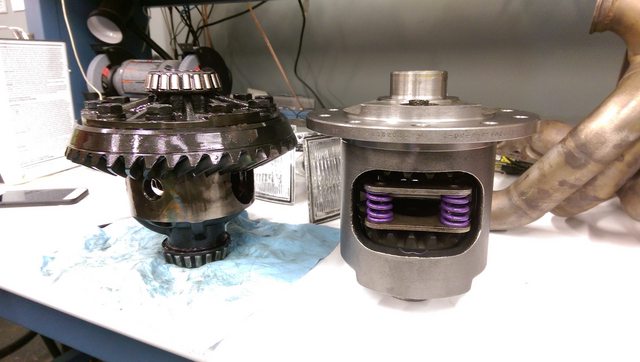

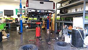

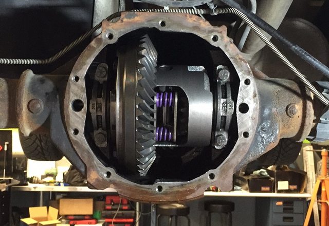

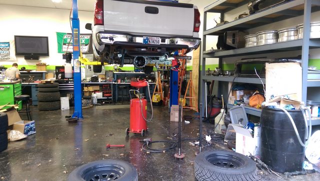

I am trying to get some of the ancillary projects taken care first on the truck. So first I started with a new posi diff.
I went with the RMS Performance Diff for the 10 bolt. It uses a Yukon Carrier Housing, and then Ron has his own ingredients for the internals. As I have zero experience with building a rear end, I employed Damon at Demon Motorsports to install the diff. I will tell you, he got it done in very quick time, and the new clutch pack diff makes less noise than the stock did. I would highly recommend him.
I am hoping this one holds with my power wants come next year. I figured eventually, I will have to upgrade to an entire beefier rear end. Everyone loves a beefy rear. :suspect:

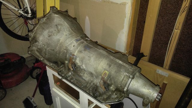

I have picked up a 4l80e with a transgo hd2 shift kit.

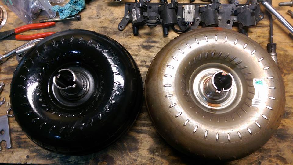

Also picked up a Circle D 3200 Converter for the 80e

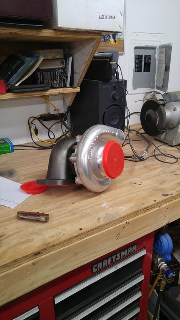

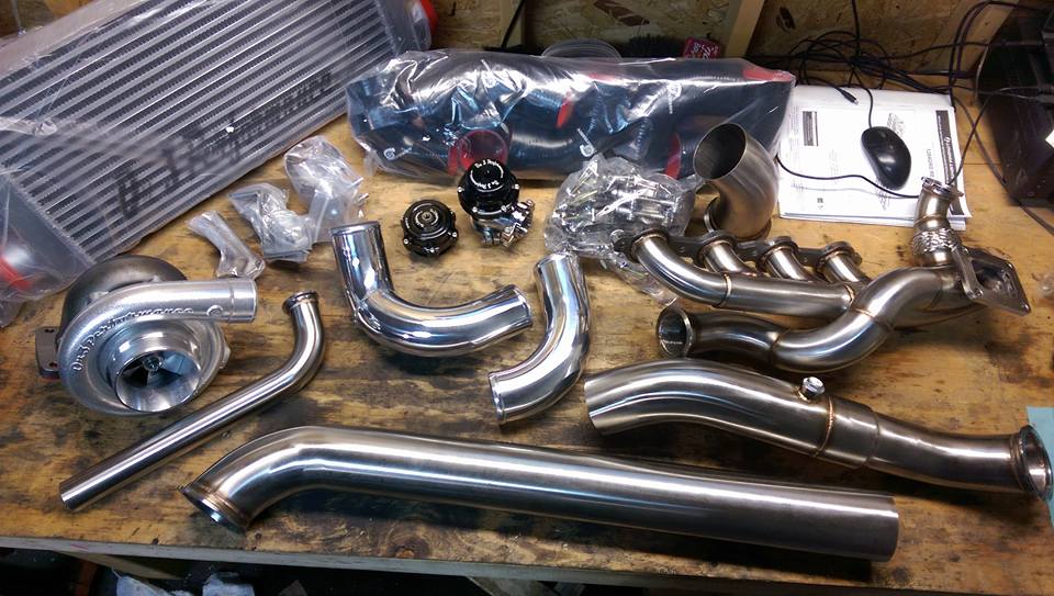

Bit the bullet on the on 3 76/75 kit, I will take more pictures when I start taking everything out of the boxes.

Went with a cheap 3200 torque converter for now since I am using a stock 60e. Once the truck is fully tuned, I will start saving up for a new trans setup.

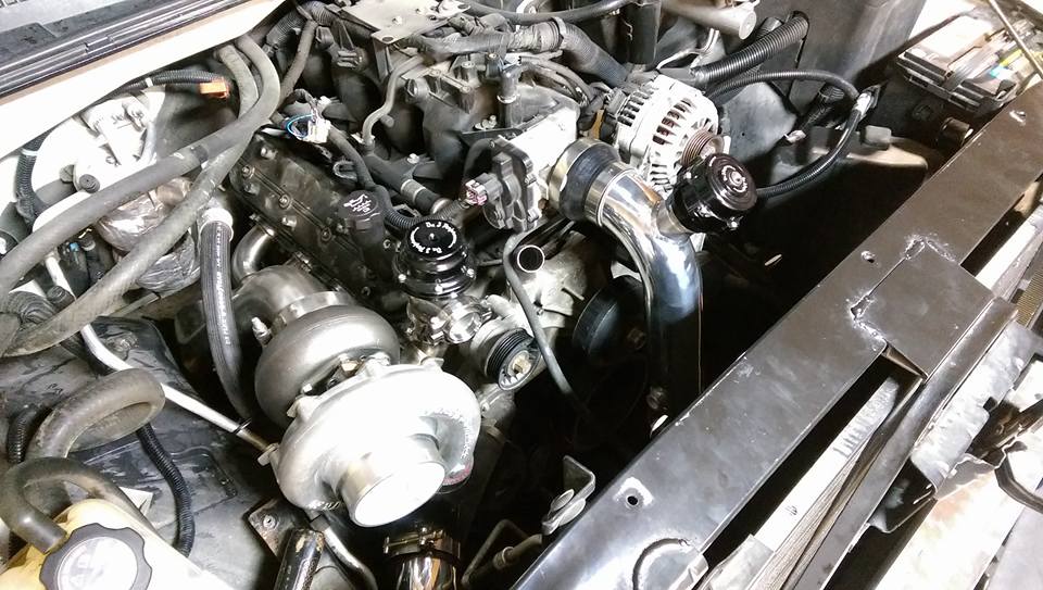

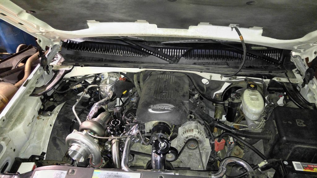

I got a great deal on an on3 performance kit with the 76mm turbo. Future goals will be to replace the turbo, but for the power goals I am looking for this season, this turbo should do just fine.

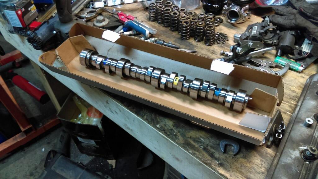

Also went with a Trickflow Shelf Cam, Pac1218 springs, and of course hardened push rods. Also did a trunion upgrade as well.

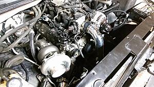

Now for pictures of the turbo install. The kit was actually really nice. Everything fit pretty much dead on. The only complaint would be the hose clamps were not the sizes we needed.
I will get videos posted up soon when it is running a little smoother after the tune. I am driving it now just around town and it is running pretty good as it sits, of course 0 boost.
