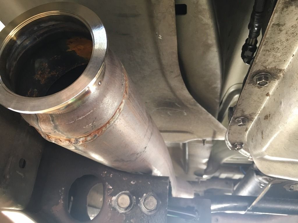

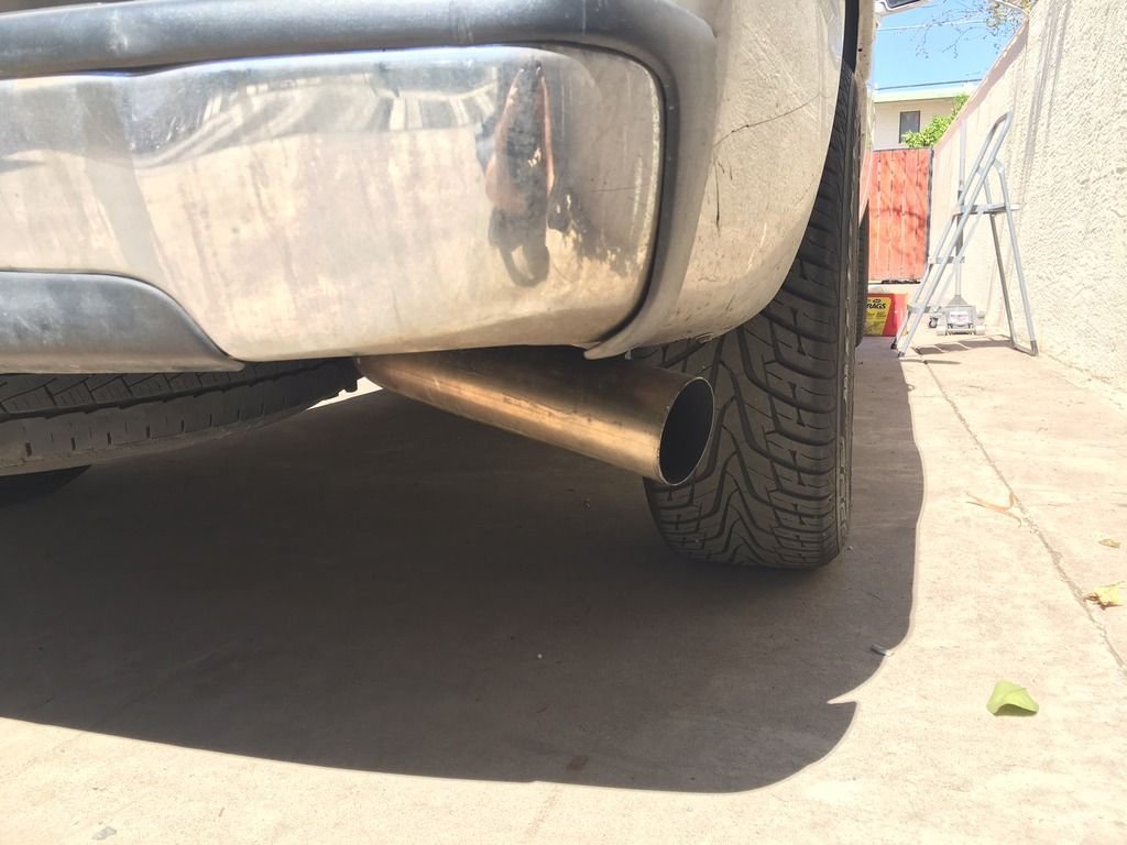

i had them remove the slip fit and just weld the crossover together and put a new flex join in. the downpipe got a 3" vband added to the end and we hacked off the wastegate dump tube. the waste gate dump is now to the atmosphere. dumps on the outside of the frame next to the wheel . there is a bracket on the dump that bolts to the downpipe for extra support.
the rest of the exhaust was purchased from a pt.net member. it was cut into three sections for shipping and i had the shop vband it together with my muffler. muffler is a 36" magnaflow.

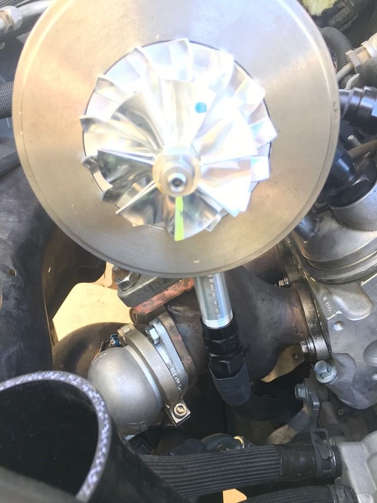

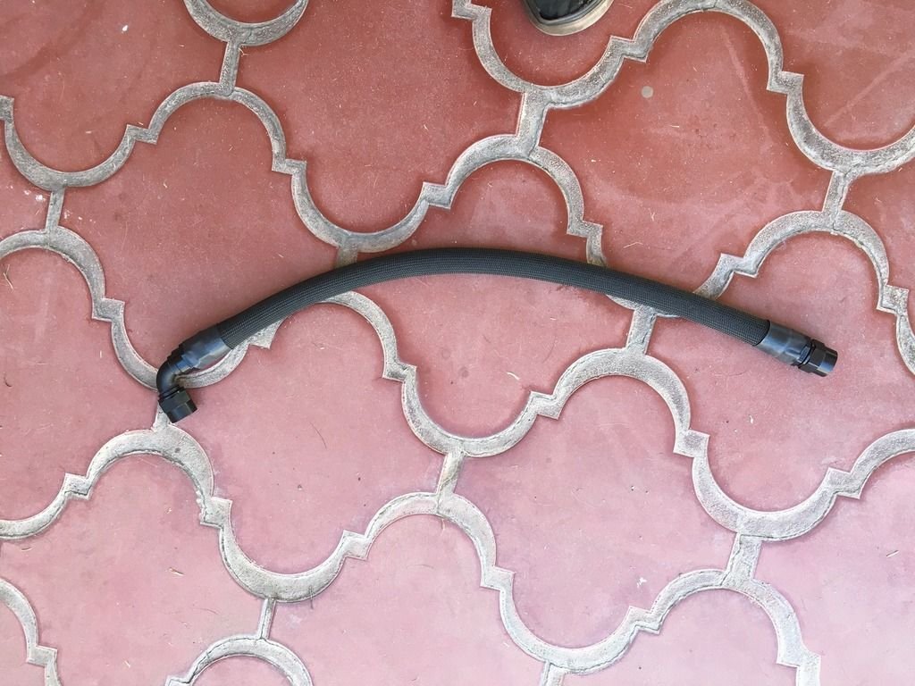

got the oil drain and oil feed lines installed. im using -10an return fittings and with the angle of the turbine i had clearance issues if i wanted to get anywhere near straight down with the oil drain. i bought an extended oil drain fitting so the an threads were below the turbine flange. i still had to clearance the extended fitting as it rubbed a bit against the turbine flange. i wrapped the hose in a heat sleeve as it sits right next tot he manifold. it will have about 1/2" ~ 3/4" clearance away from the manifold.
here is the turbo drain return into the pan. i wanted to keep a downward angle as much as possible so i took a bit out of the starter so i could angle the fitting a bit more to keep it at a downward slope.
here i have the oil feed line. i zip tied it to the bellhousing bolt to keep it away from the exhuast as much as possible. might throw a random nut on the bolt to keep the zip tie from coming off..

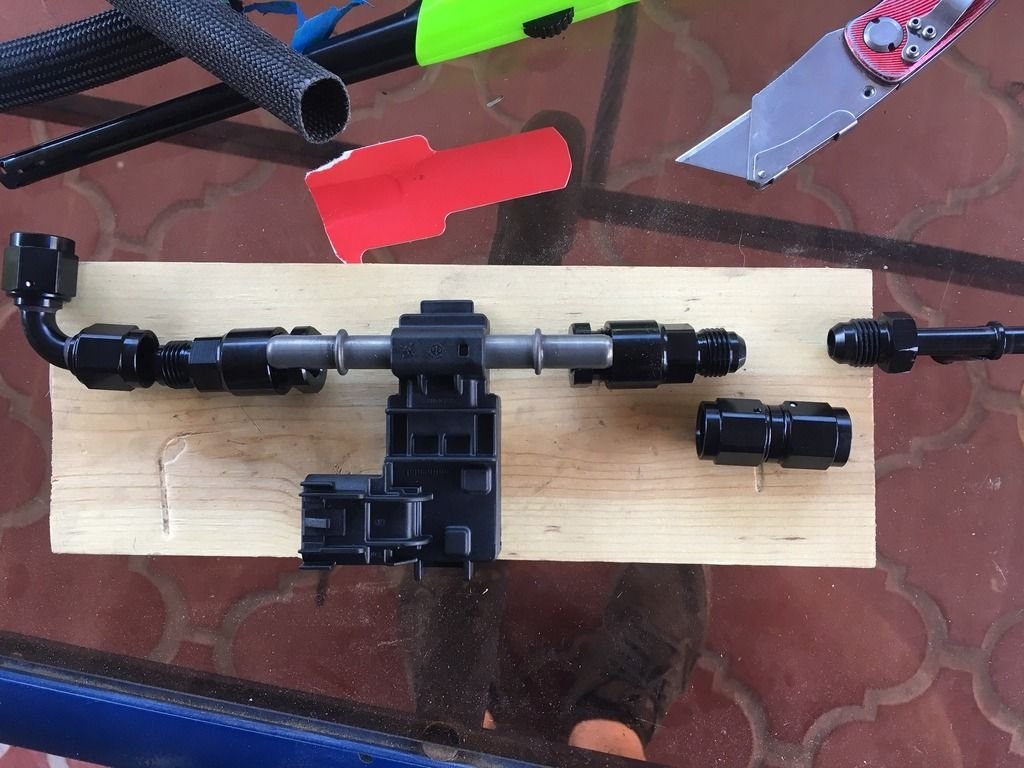

finished up the last of the hardware for my fuel system. swapped out the injectors (plug and play with the supplied wire adapters ) and plumbed in the flex fuel sensor into my return line.
just need to wire up the flex fuel sensor and do the required tuning for the sensor and bigger injectors so i can fire it up this coming weekend.

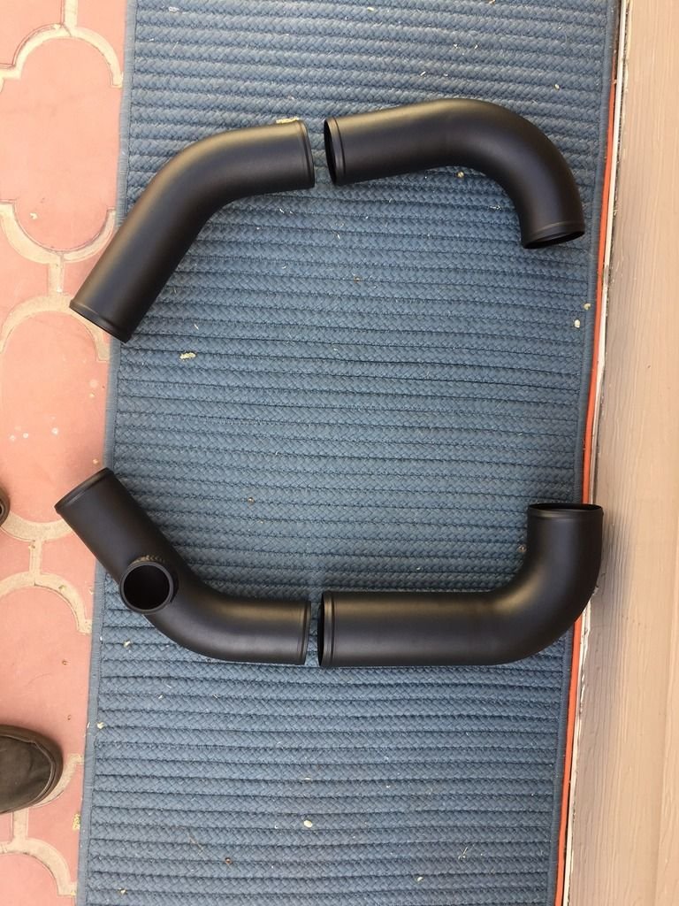

got my cold side back from powder coating
here i have the cold side installed and testing for leaks.
