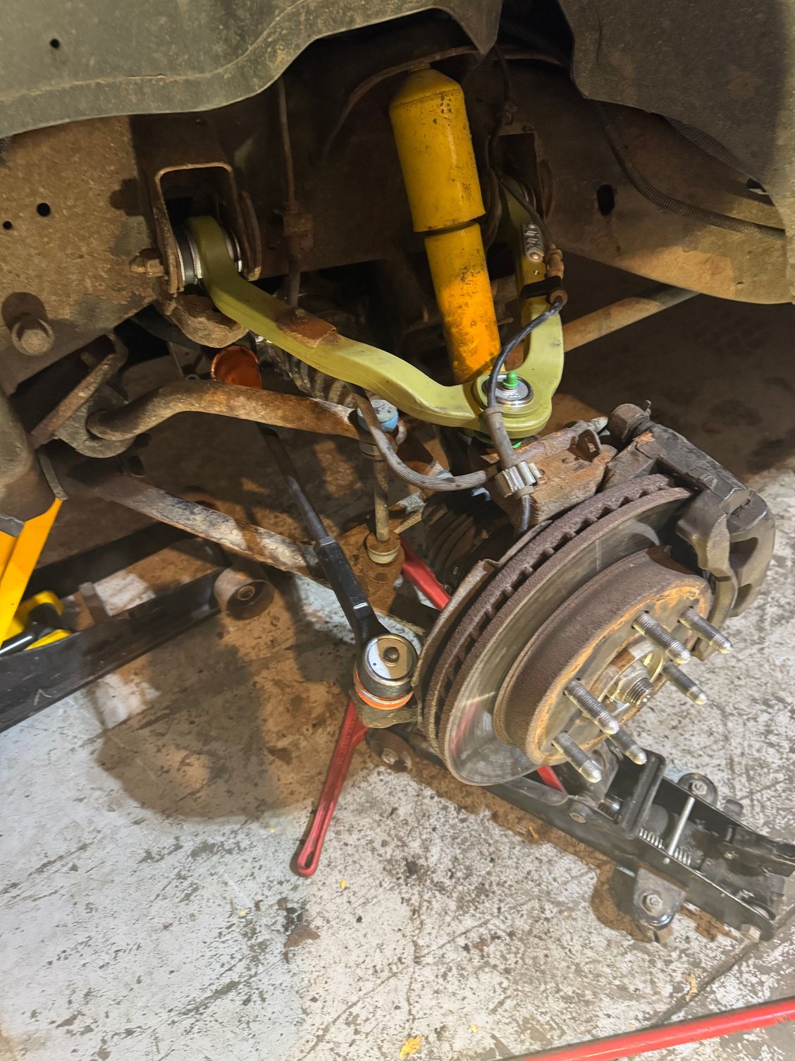

So I replaced the inner and outer tie rods on both sides. Plus I put in new upper control arms. It's going in tomorrow to the shop for alignment - so I'm hoping the steering is tighter.

Steering is way tighter after replacing those parts and the alignment has fixed the cocked steering wheel which is nice.
