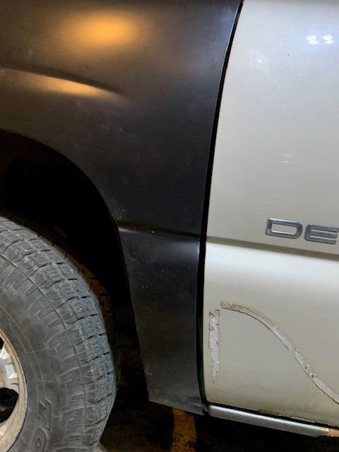

It has just affected the gap at the lower part of the fender where it meets the door. I shoved it in at the bottom but the door fender gap goes from 3/16 inch at top to a bit over 1/2 inch at bottom. I had to shim the new fender up at the back - so the issue could be the new fender, but not sure.
Picture isn't great -
This is the only gap that is out - everything else lines up good. Well the hood gap is a bit wide on this side also but that should be easy fix.

That gap is because the frame rail is pushed up on that side.

So my thinking was if the frame rail is pushed up a bit it's affecting the mount (#5). The new front fender mounts up really good and I was thinking I could just shave down the rubber mount (#6) which would lower the radiator mount (#1).
This would move the front fender mounting points down a bit (like 3/16 inch) and should close the gap at the lower part of the fender /door.
That way I wouldn't have to get the frame straightened or use a BFH to pound the mount down a bit.
What do you think?
The frame can only be out by 1/4 inch max - it's not visible when you look at the truck. Hood doesn't look crooked.

I think it's your truck and it's your choice. I have seen all kinds "repairs"...
But Before you do anything, I would recommend getting that bumper bracket and mocking everything up with a good bumper first to make sure you have enough adjustment to get everything else to line up.

I bought a wrecked 90s Silverado that had a bent frame in the front like that, but it was probably much worse. I cut off the front core support/bumper mount and welded it about 1 1/2 to 2 inches lower on the bent side and that made the fender and grille line up good. You wouldn't know that section was bent by driving it or even really by looking at it from a short distance. The IFS can compensate for some messed up stuff.... lol
Your idea will probably work, shortening the body mount on that corner, but 1FastBrick does have a good idea to mock up the bumper and other parts in front to make sure they won't be misaligned.
