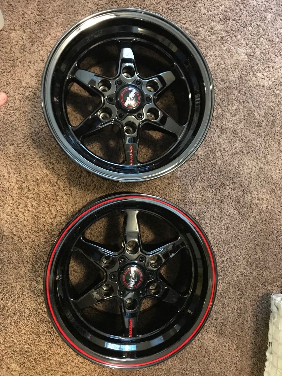

1320wheels had a sale running for a complete drag pack with free 15'' conversion brackets so I snagged a pair while the sale was running. Ended up getting the 17x7 fronts and 15 15x10 rears and talked him into throwing in the Dual caliper brackets instead of the single brackets. I have a buddy that runs the dual rear calipers and he loves them, i have heard some negative things about them so we will see. I also swapped to Hydroboost at the same time.
Started on the brake swap, welded some tabs on the rear and welded on a bracket to a -3an tee fitting for the brake lines.
Brackets and calipers all mounted and plumbed
When i ordered the racestars i really wanted the Chrome, but they were backed ordered and wouldn't ship for 3-4 weeks. I liked the look of the black chrome but i cant stand the red stripe that comes on them. 1320 said that the stripe was painted on after the wheel was coated and i should be able to remove it. I took a chance and got the black chrome with hopes i could strip the stripe without hurting the black chrome finish.
What a royal pain, but it is possible! Here is the before and after, i will be painting the red "Racestar" logo since stripping the paint down in the little letters was not going so easy.

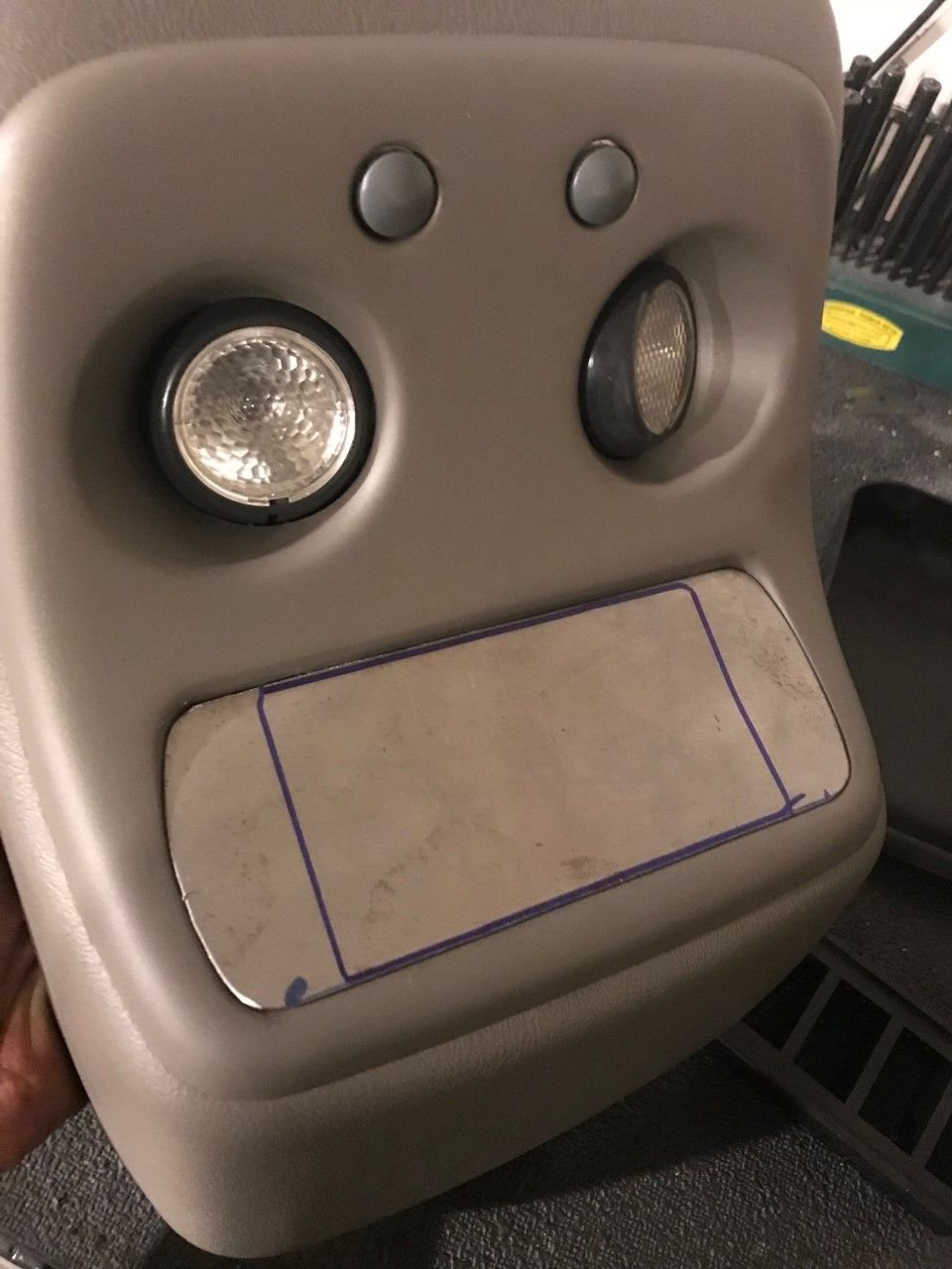

I also added a MSD 2 step and rewired my Efans so that i could override the A/C trigger so i could run the fans manually if i needed. I wanted something clean for the switch's to control all 3. i couldnt find a switch panel i liked online so I built one. I never use the little cubby in the over head console and thought it might be clean to keep all the switch's up out of the way. this is what i ended up coming up with
