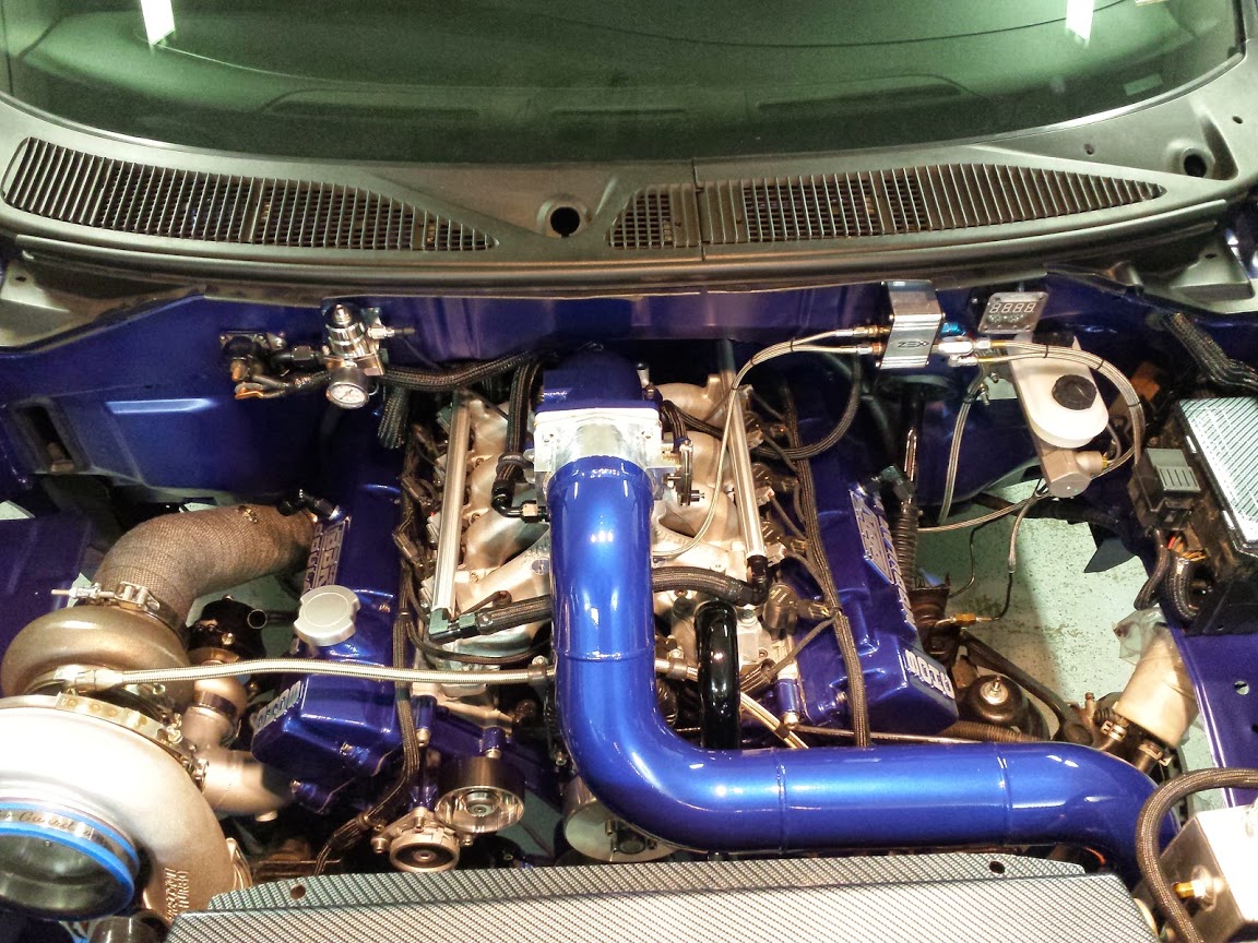

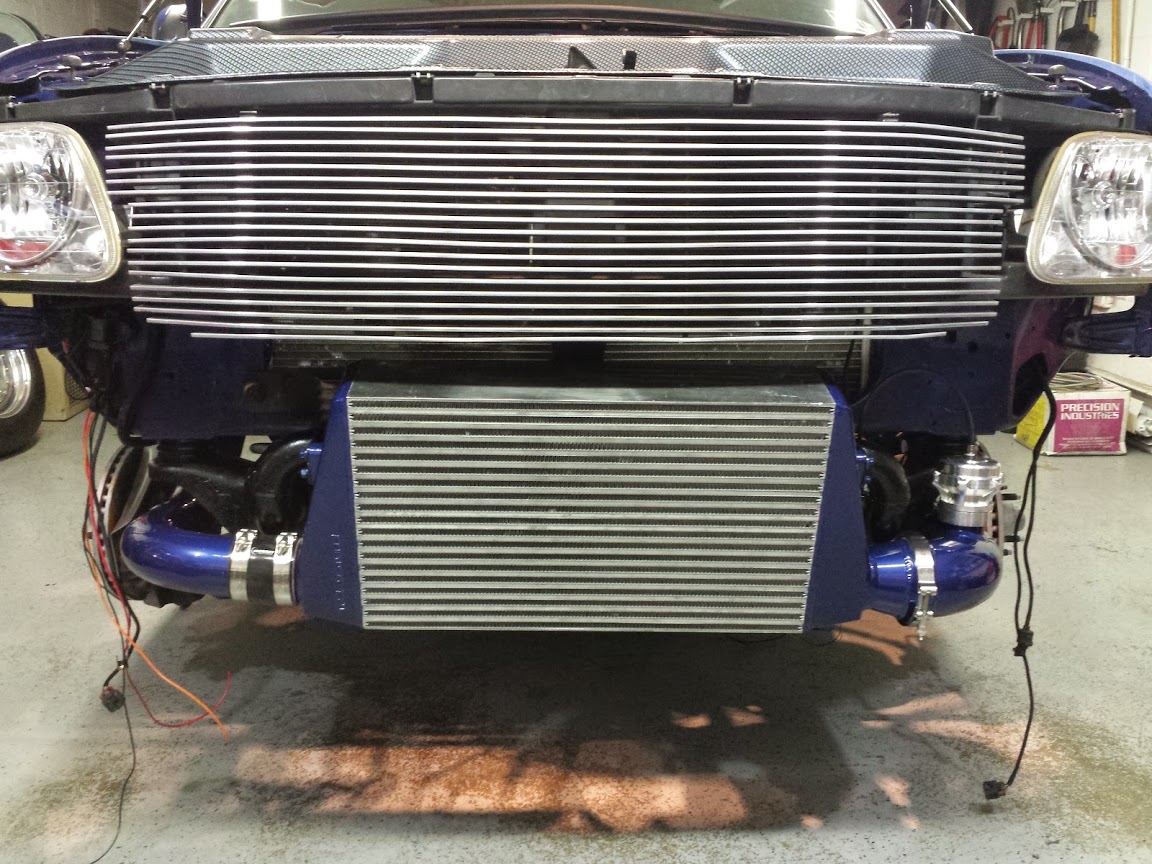

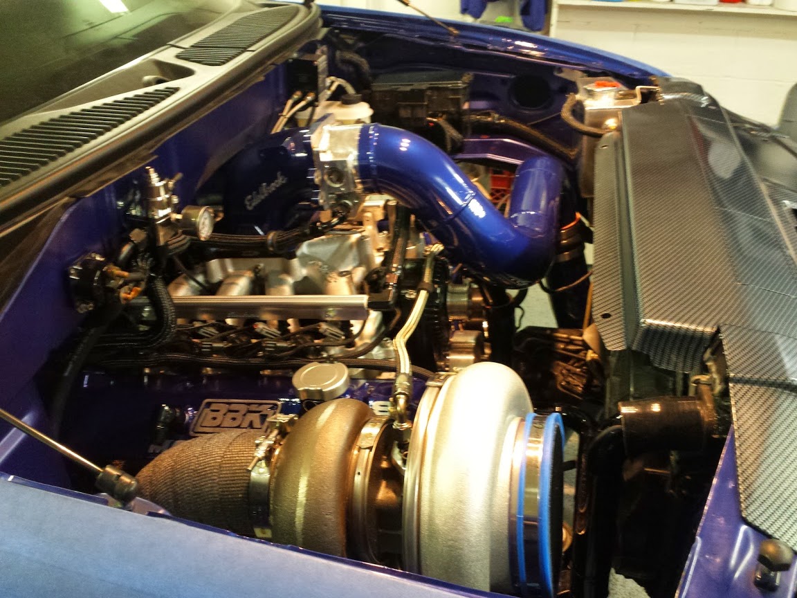

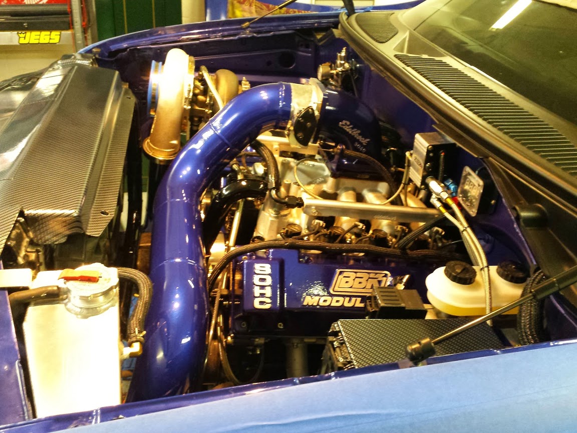

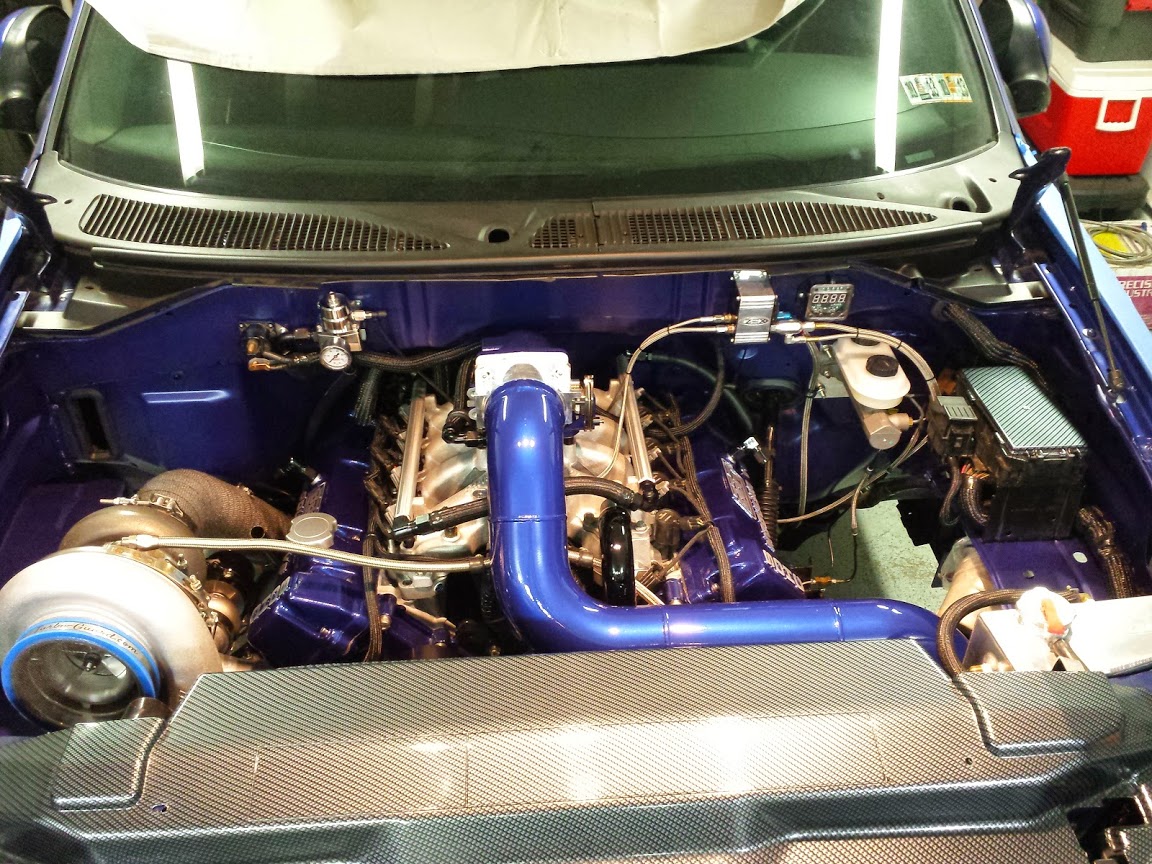

few pics of the assembled engine bay with color on the parts
Attached Thumbnails Project Blue Beast-20150201_194454.jpg   Project Blue Beast-20150201_194411.jpg   Project Blue Beast-20150201_194354.jpg   Project Blue Beast-20150201_194341.jpg   Project Blue Beast-20150201_194313.jpg
