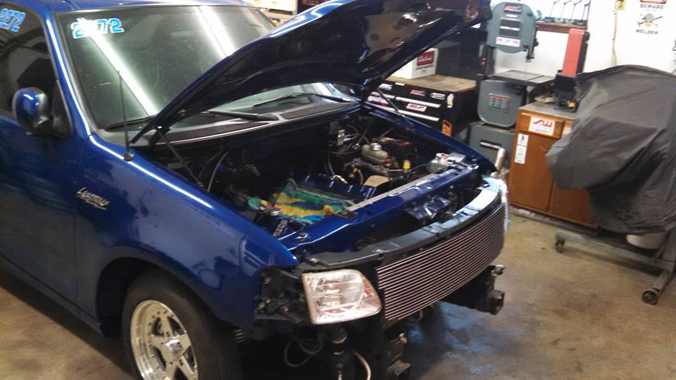

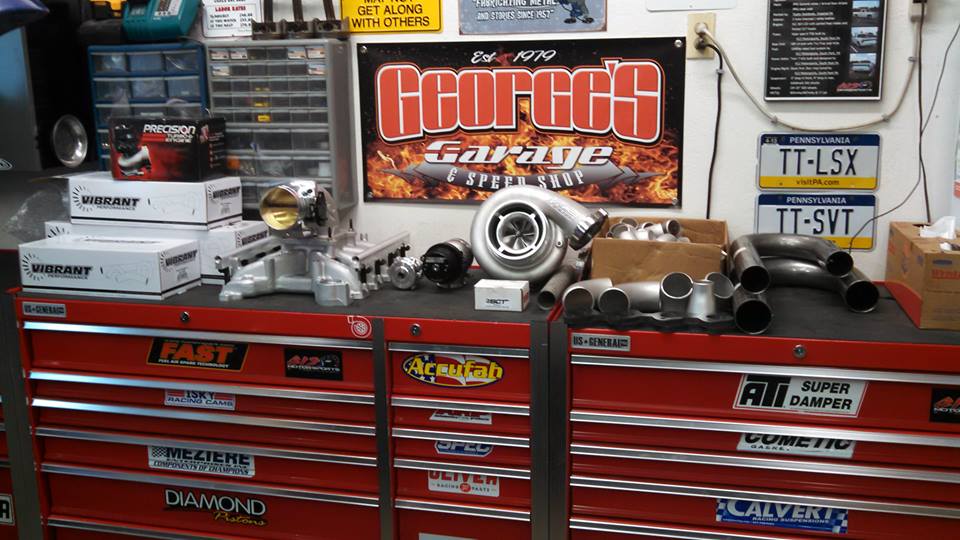

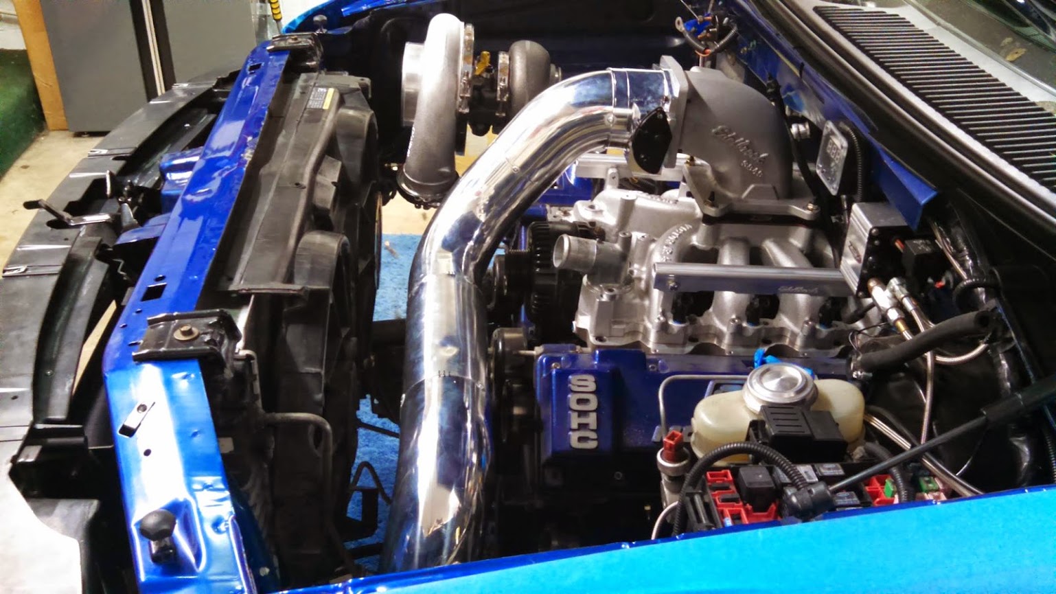

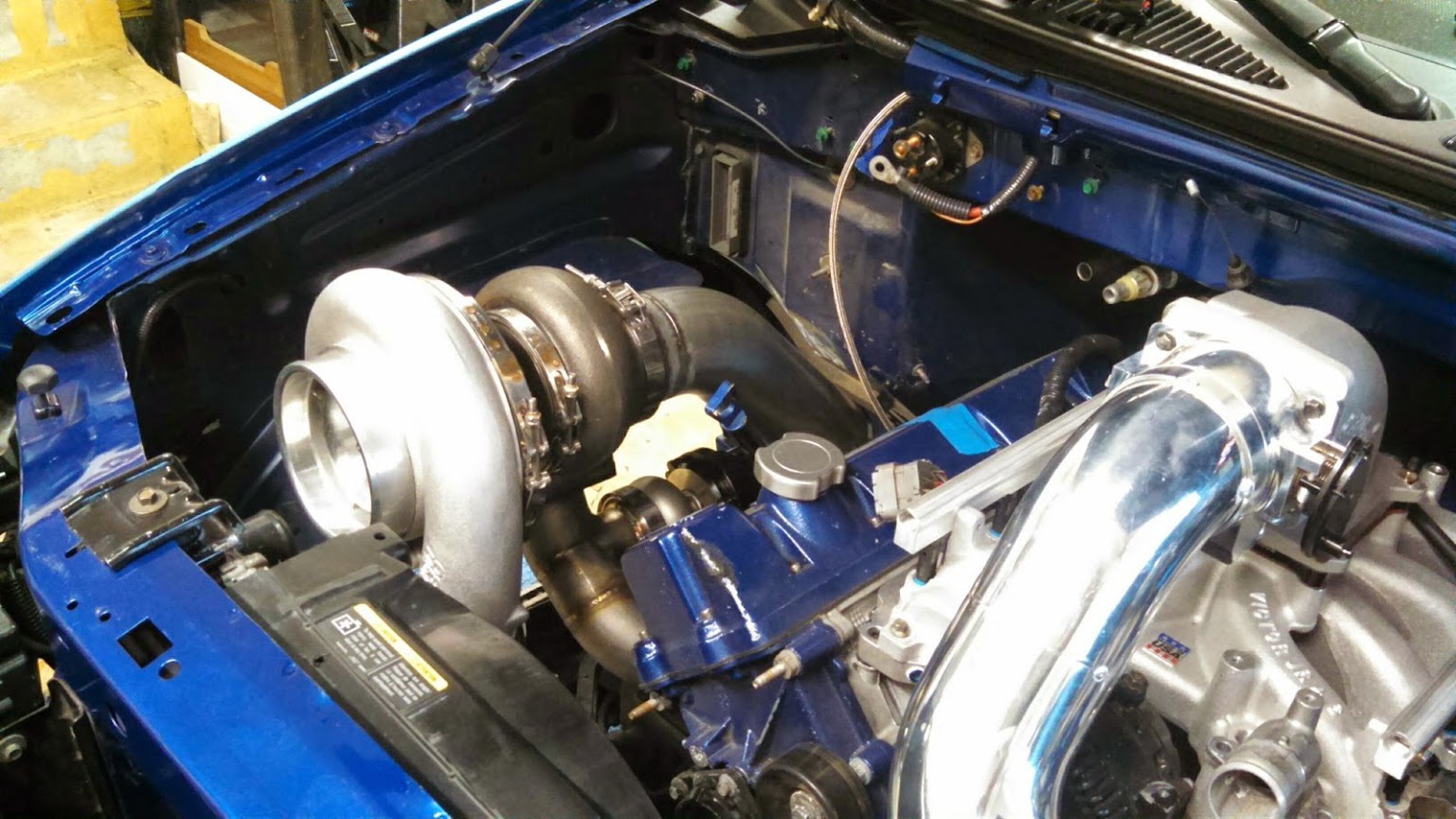

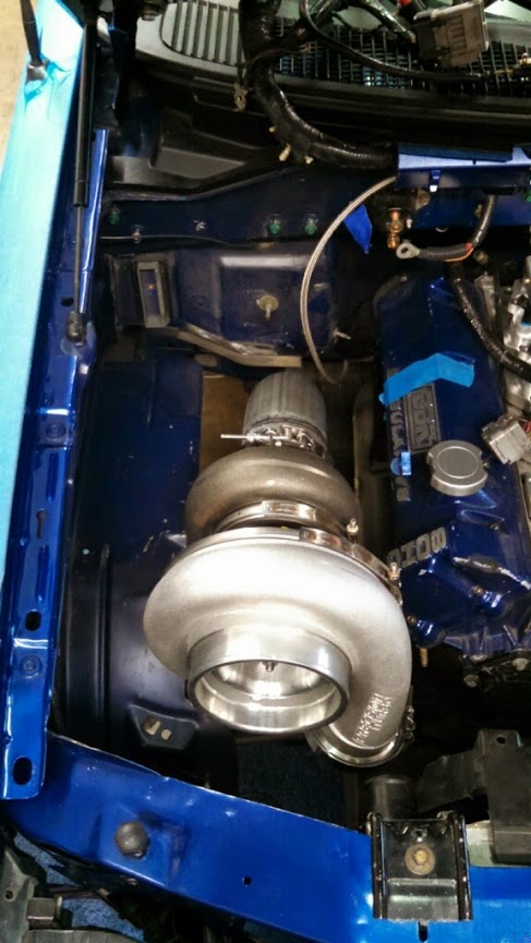

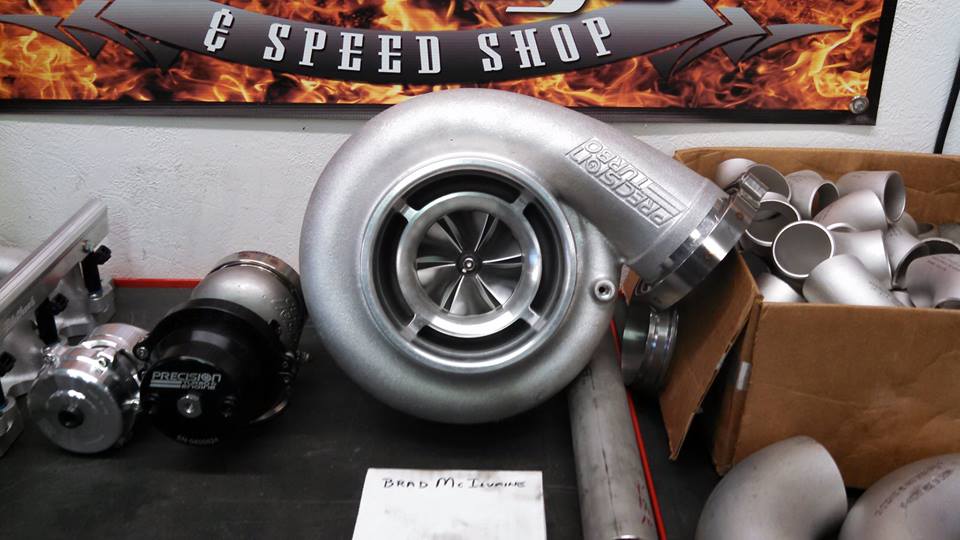

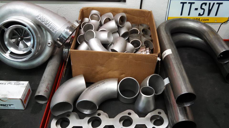

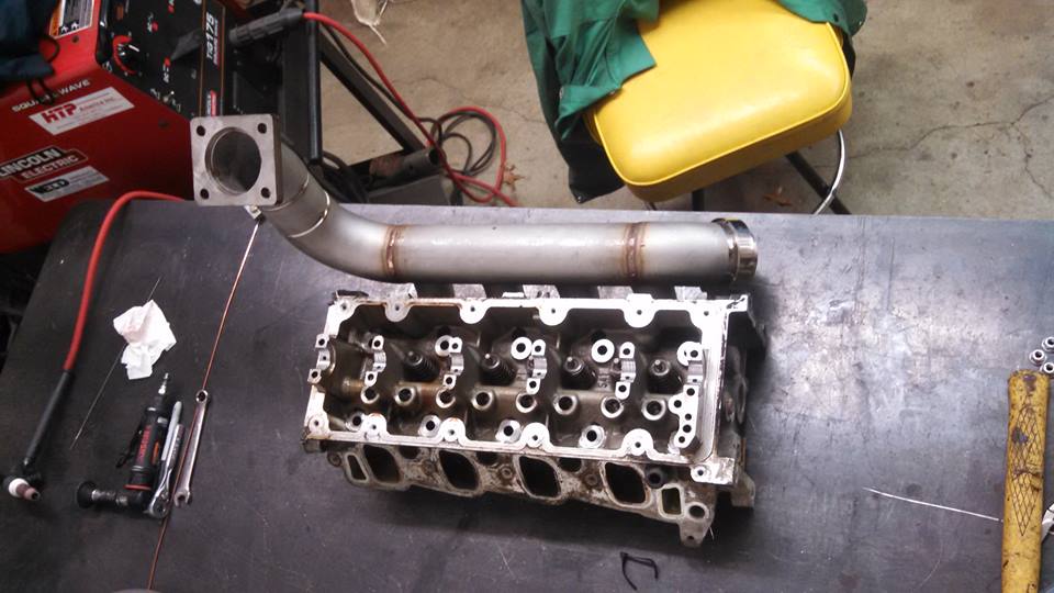

This is my Bro's 2004 sonic blue lightning. A few yrs ago i took on this truck when it was a blower setup. Built a custom exhaust for it, did the 8pt roll bar in it and tuned it. We went 10.79@129 on boost only 2nd time out

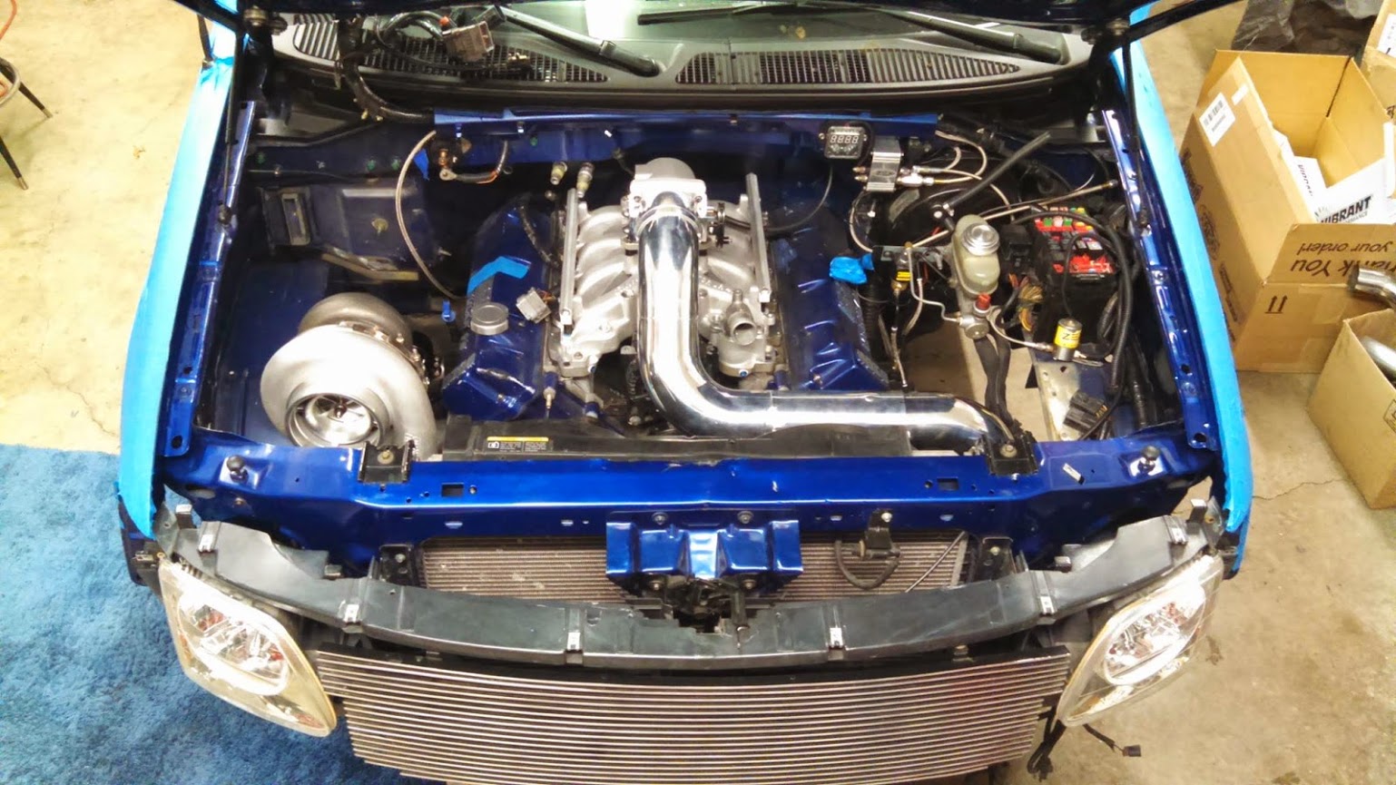

with how many turbo builds ive done, we decided to go ahead and turbo this truck
heres the build pics
Attached Thumbnails Project Blue Beast-1384242_852575431459285_192247236161973715_n.jpg   Project Blue Beast-1798482_852576004792561_8564021683898500123_n.jpg   Project Blue Beast-10449522_852575781459250_6587369056451548232_n.jpg   Project Blue Beast-10689654_852576458125849_2567960628103018442_n.jpg

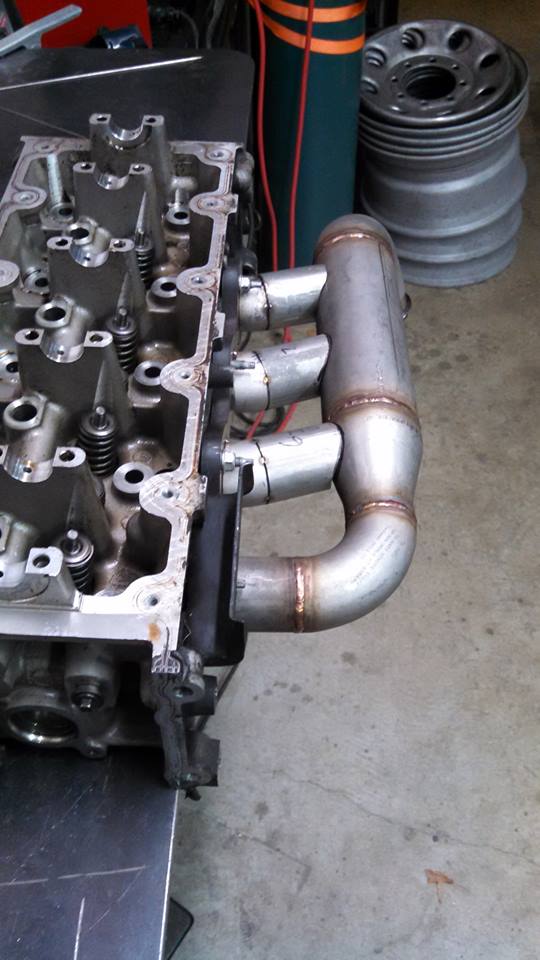

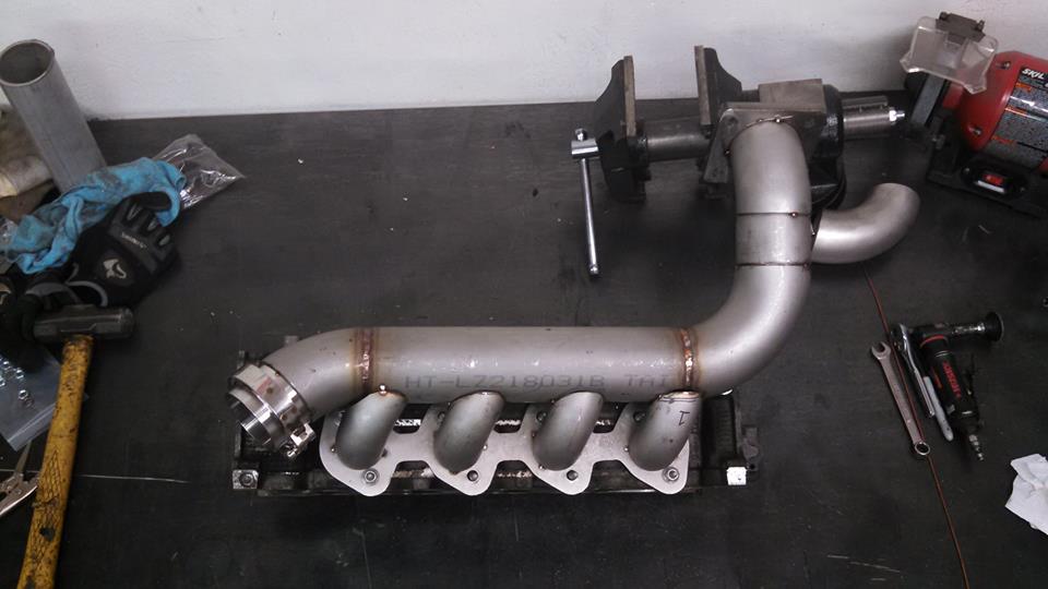

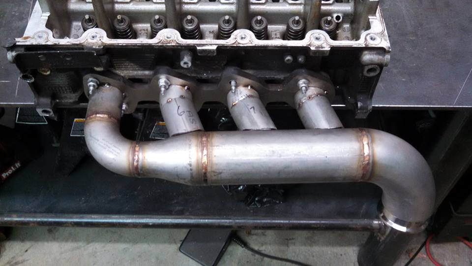

few pics of the manifold i built for this truck
Attached Thumbnails Project Blue Beast-1724549_853943154655846_5494055903572253596_n.jpg   Project Blue Beast-10314683_853942977989197_3505895802580887813_n.jpg   Project Blue Beast-img_20141125_233215_726.jpg   Project Blue Beast-10694255_855053921211436_3626082669754504244_o.jpg

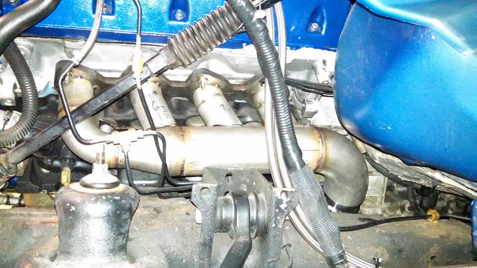

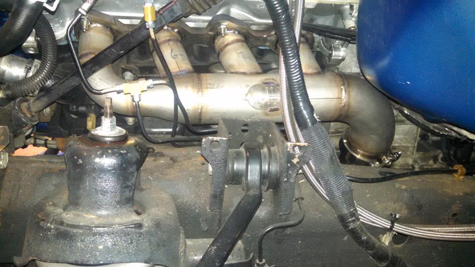

heres what i Came up with for driverside manifold
Attached Thumbnails Project Blue Beast-driver-manifold.jpg   Project Blue Beast-driver-manifold-2.jpg   Project Blue Beast-driver-manifold-3.jpg   Project Blue Beast-driver-manifold-4.jpg   Project Blue Beast-driver-manifold-5.jpg

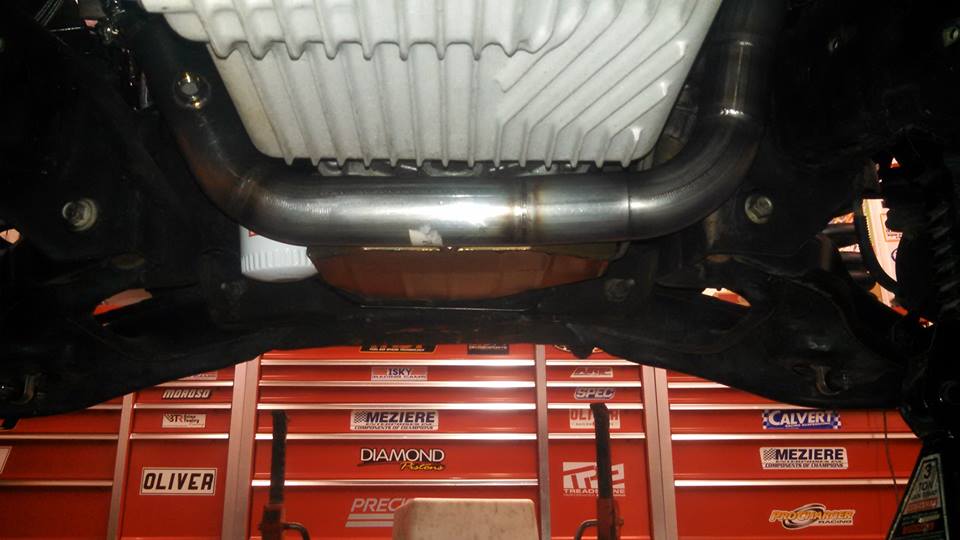

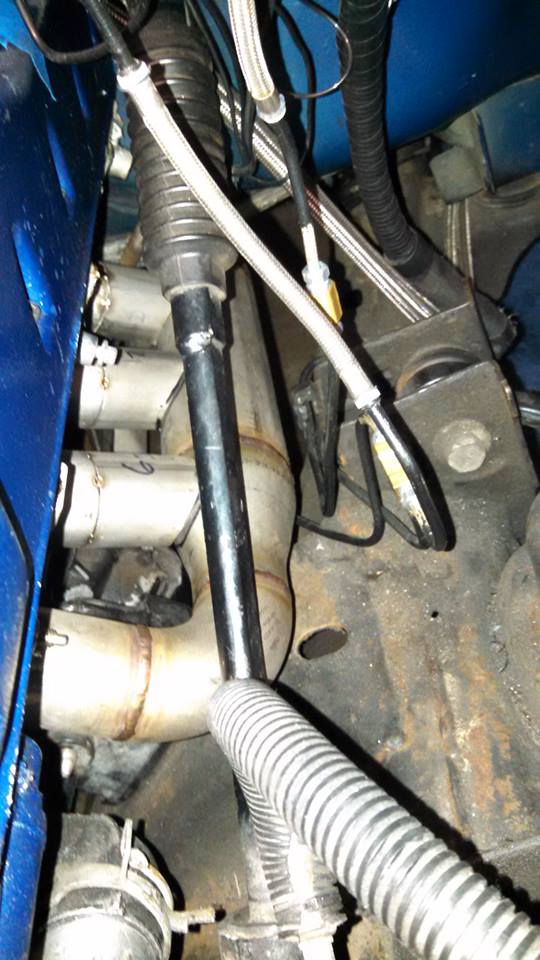

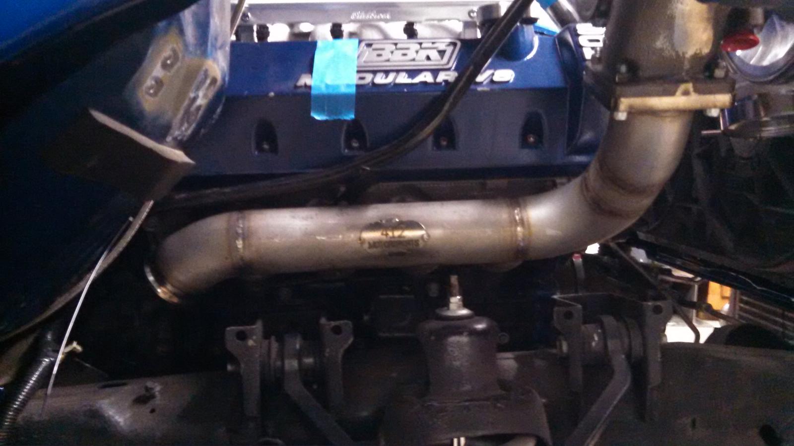

pics of how the crossover was ran
Attached Thumbnails Project Blue Beast-514.jpeg   Project Blue Beast-517.jpeg   Project Blue Beast-crossover.jpg   Project Blue Beast-crossover-manifold.jpg   Project Blue Beast-crossover-3.jpg

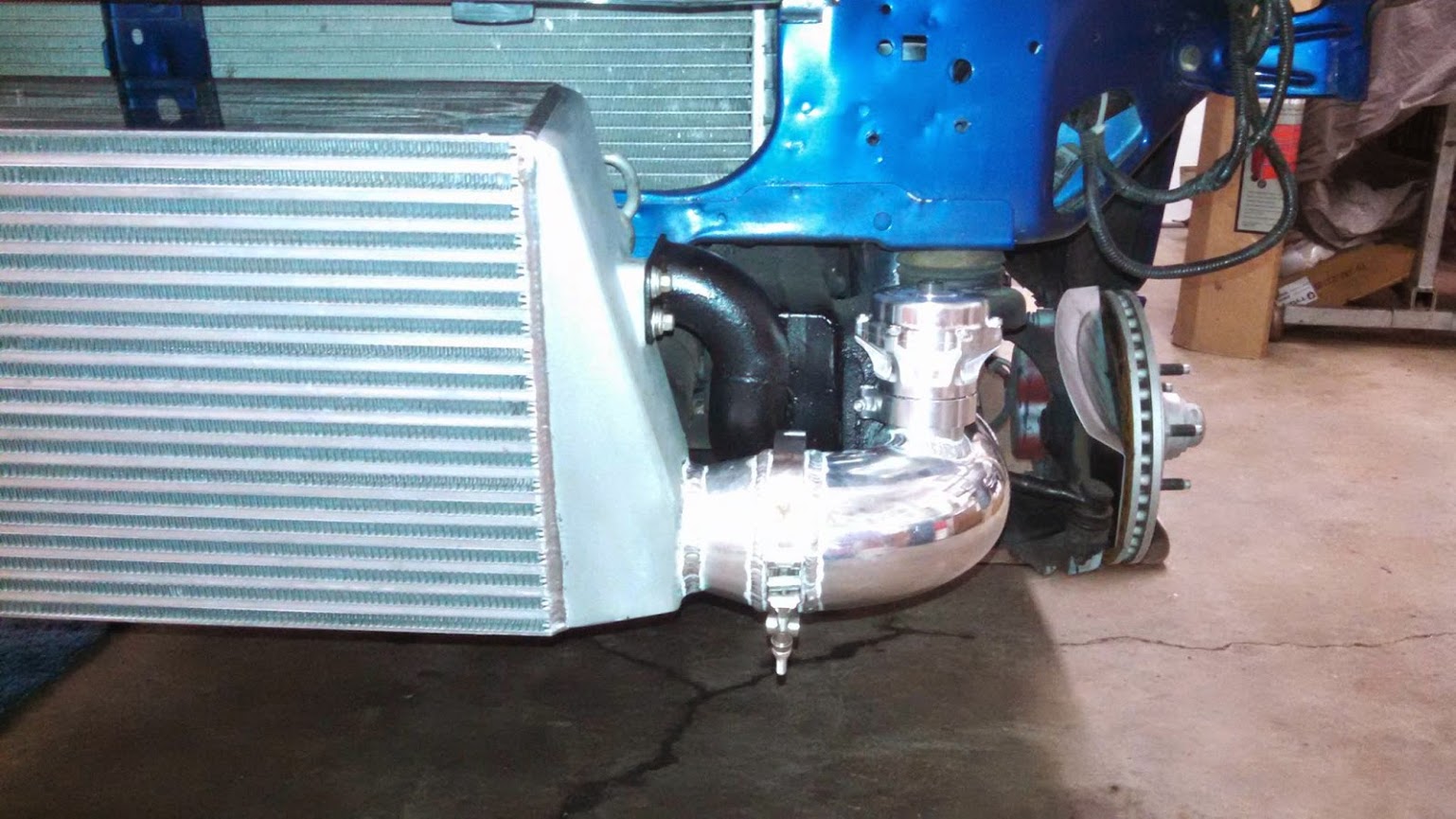

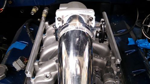

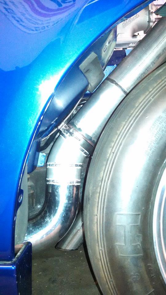

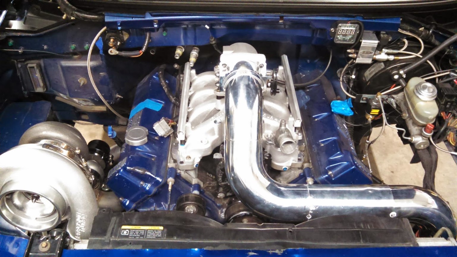

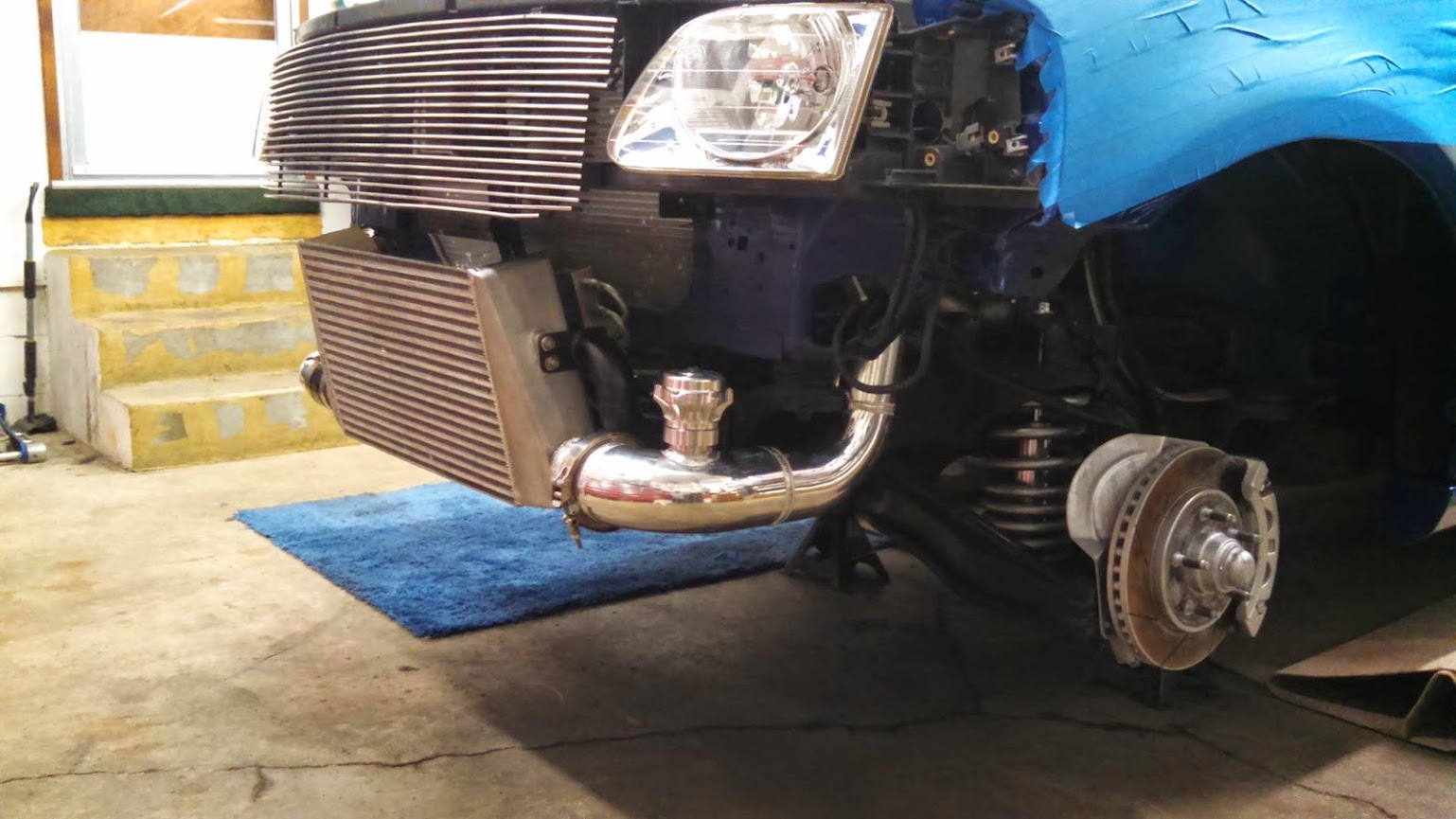

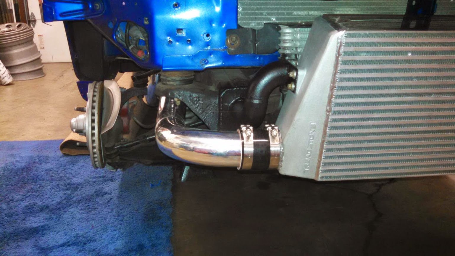

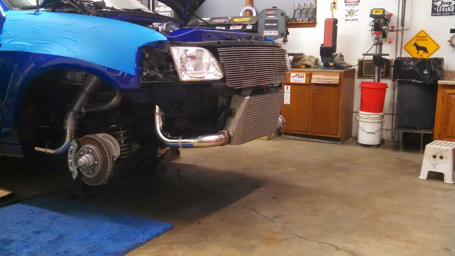

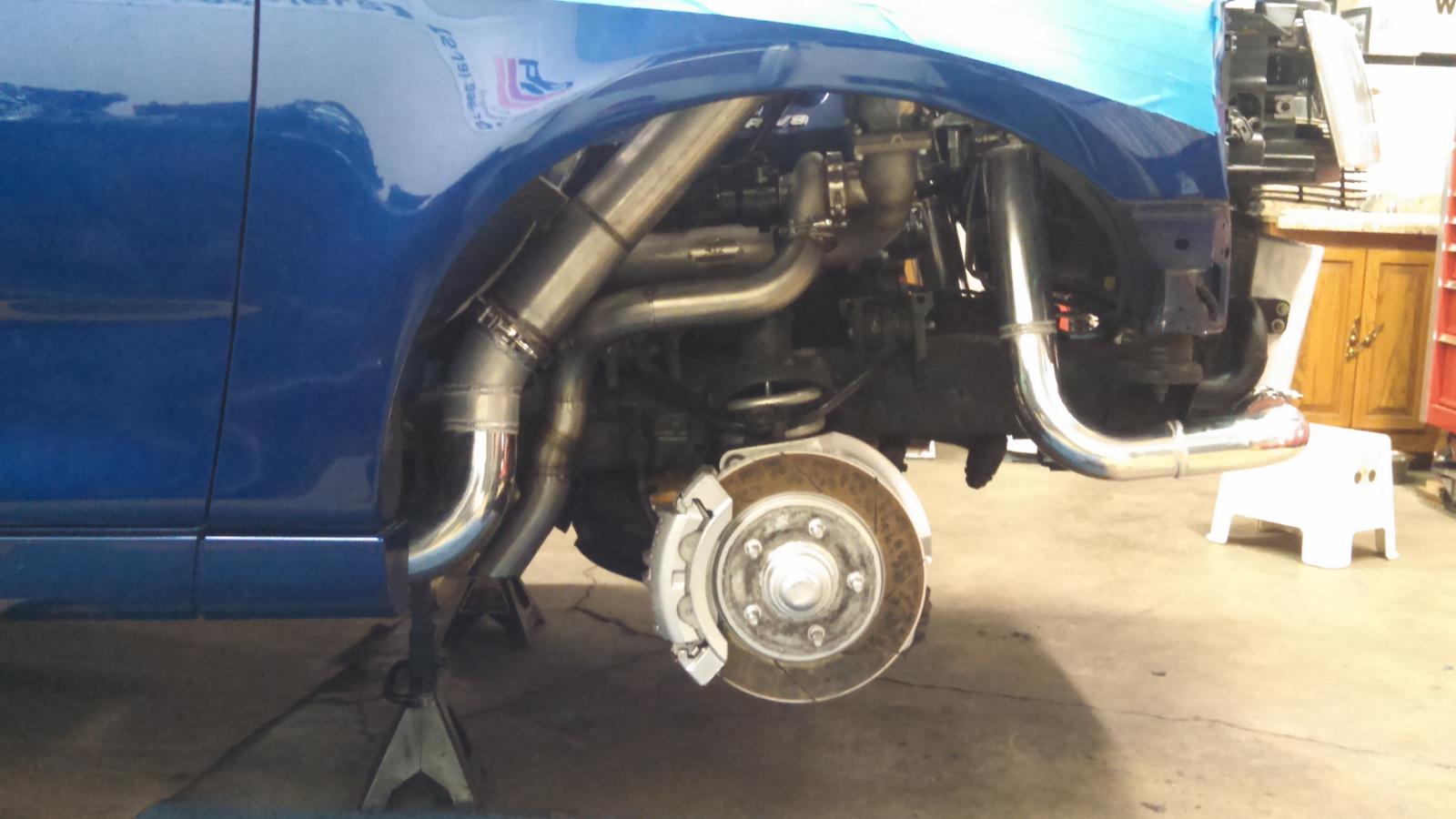

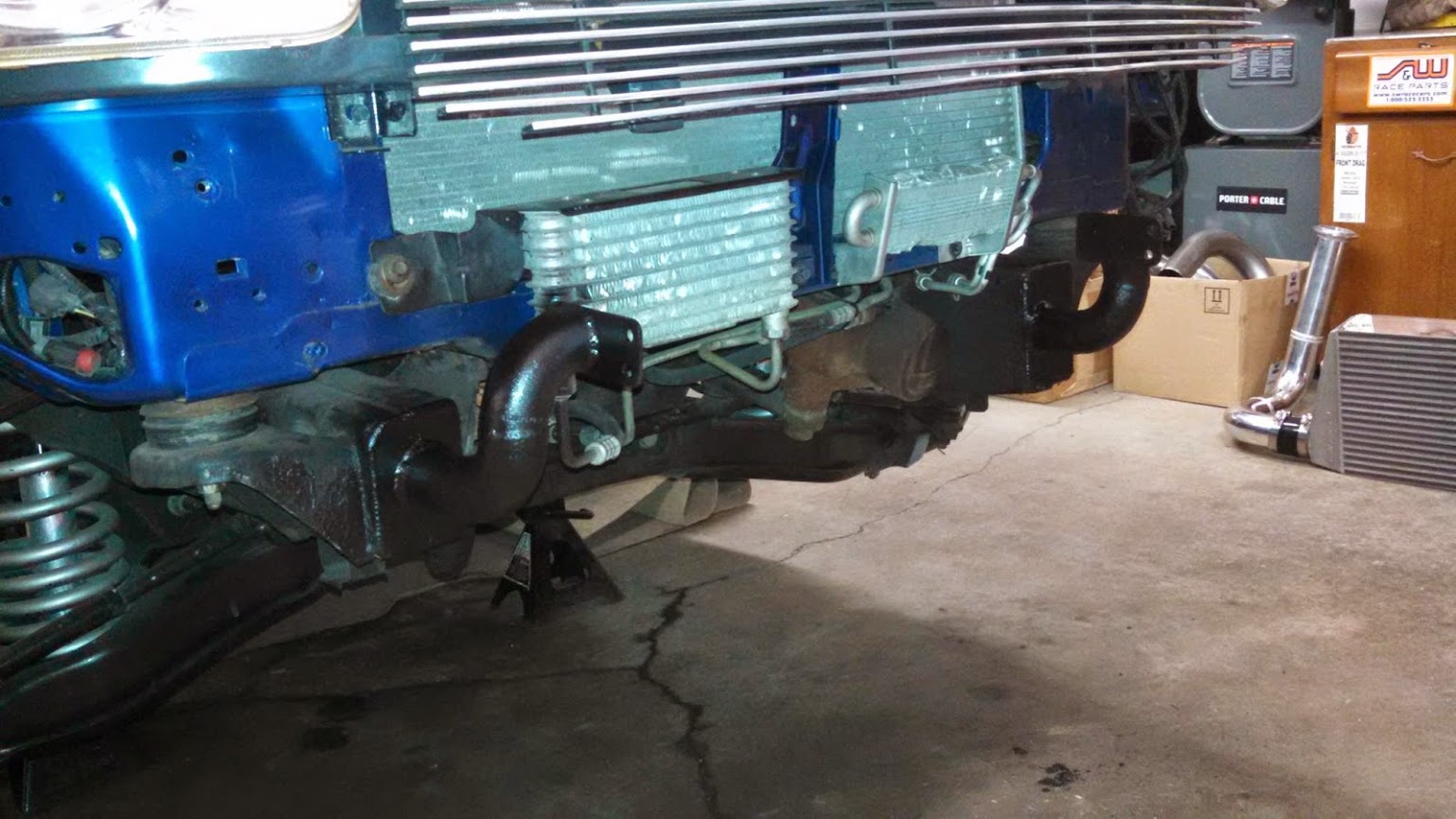

heres how i came up with mounting the intercooler
Attached Thumbnails Project Blue Beast-10387010_862691840447644_5192336757798269757_o.jpg   Project Blue Beast-10469294_862691890447639_4665183632919136790_o.jpg   Project Blue Beast-10547940_862691990447629_2891479139625014254_o.jpg   Project Blue Beast-10854215_862691627114332_5475967695729274781_o.jpg   Project Blue Beast-10861054_862691580447670_303637560586041835_o.jpg

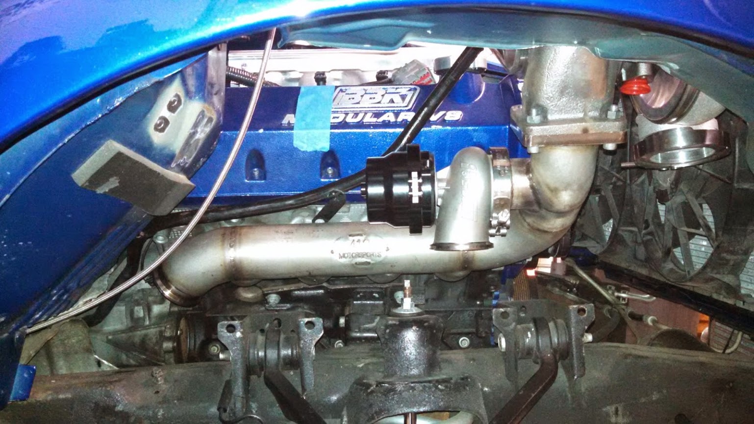

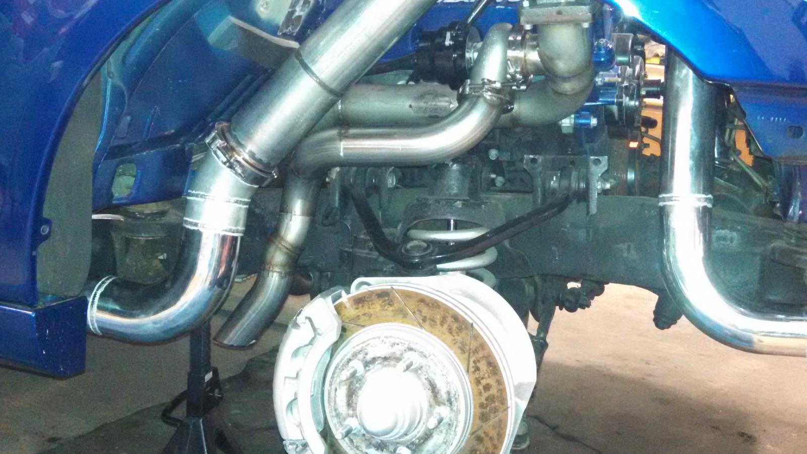

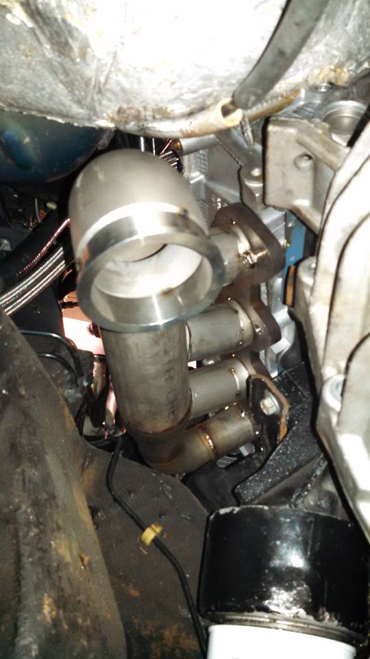

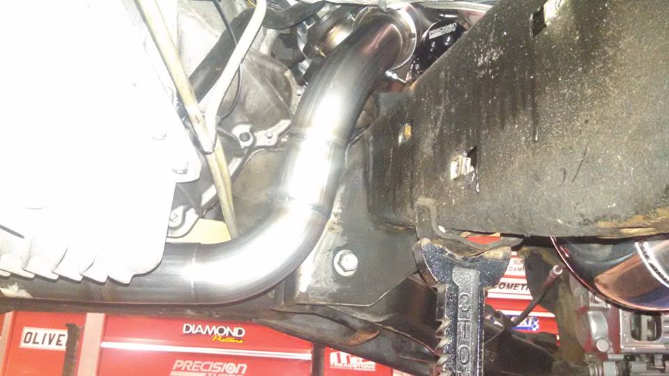

heres how i did the wastegate dump tube and downpipe
Attached Thumbnails Project Blue Beast-img_20141212_224123_825.jpg   Project Blue Beast-img_20141212_224101_589.jpg   Project Blue Beast-10806205_864928090224019_8015876825238405799_n.jpg   Project Blue Beast-10806352_864928260224002_610802125511620621_n.jpg   Project Blue Beast-1908474_864928326890662_6014507149973628994_n.jpg

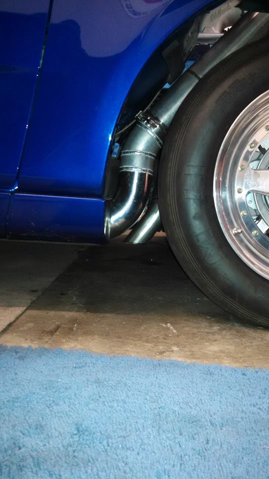

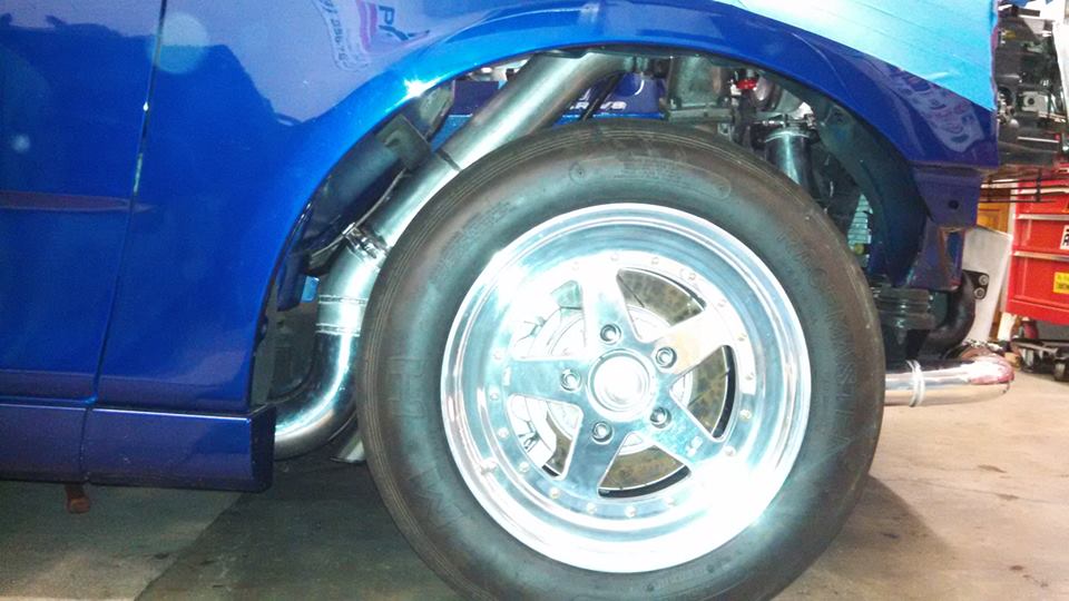

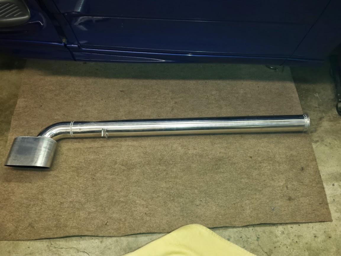

exhaust tip i built with how exhaust is ran
Attached Thumbnails Project Blue Beast-20141220_000052.jpg   Project Blue Beast-20141220_001733.jpg

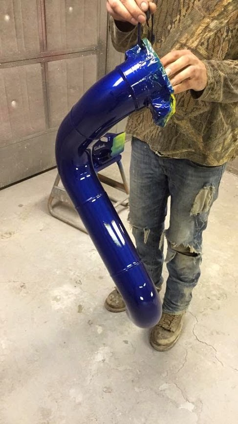

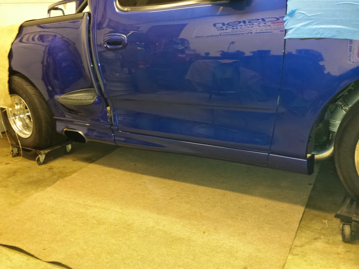

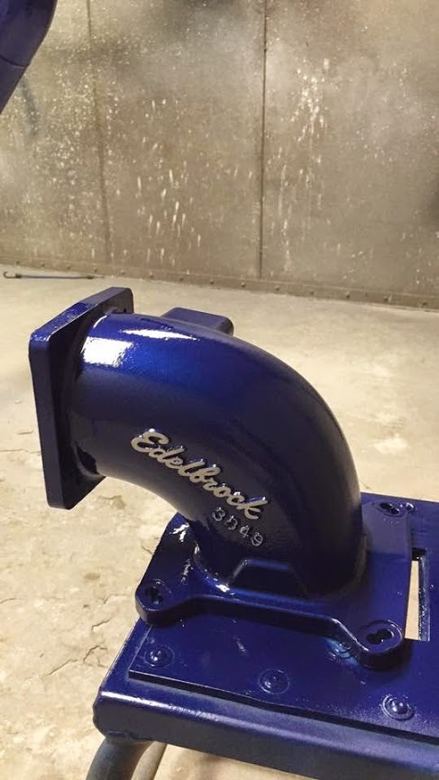

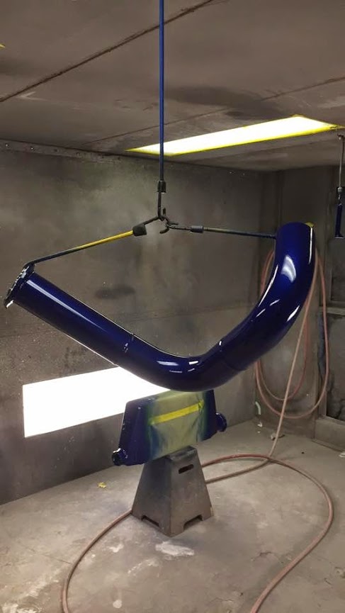

few pics of the parts that were painted
Attached Thumbnails Project Blue Beast-10877657_10204682381333516_519580462_n.jpg   Project Blue Beast-10884567_10204682388093685_850719771_n.jpg   Project Blue Beast-10866719_10204682389253714_1114479966_n.jpg
