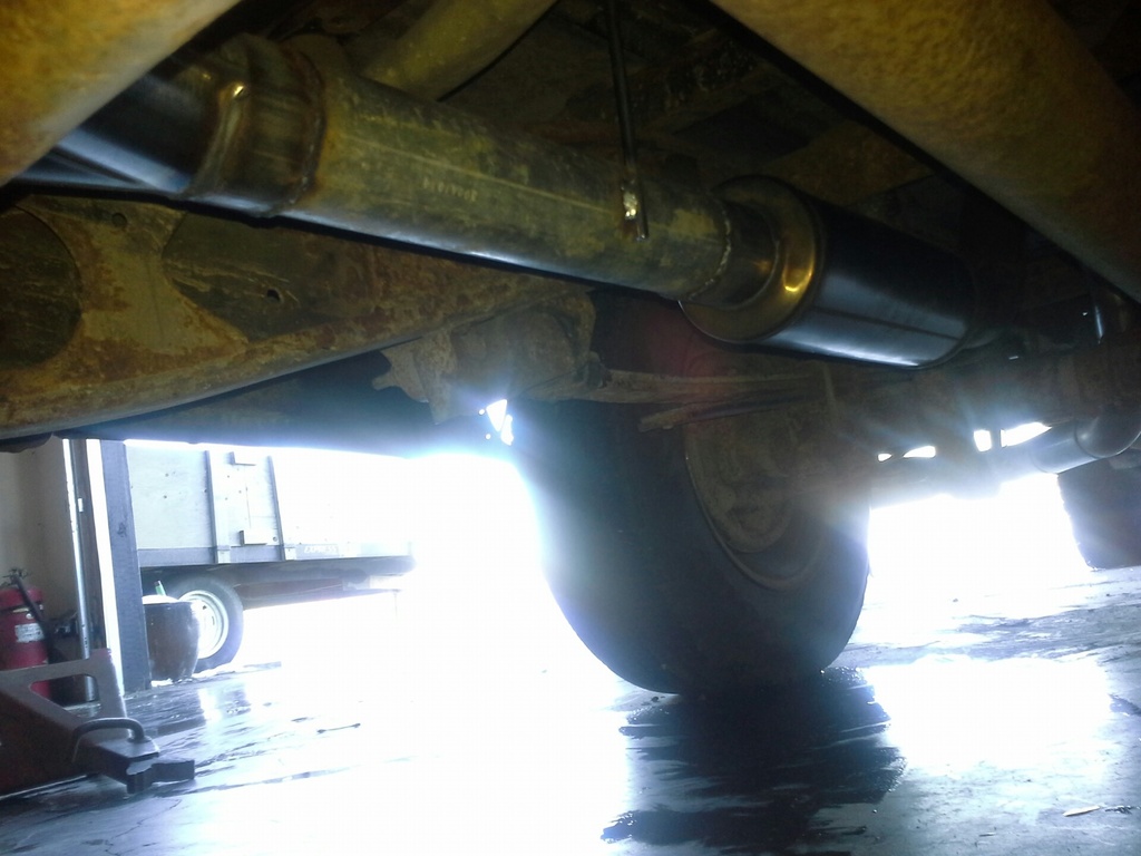

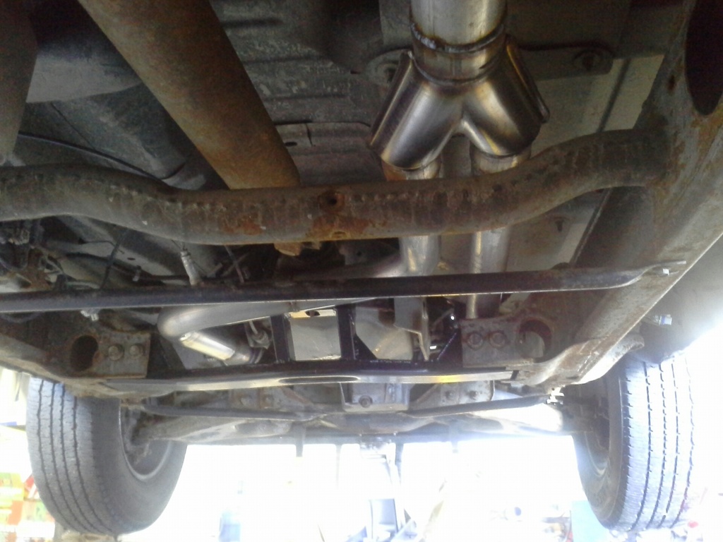

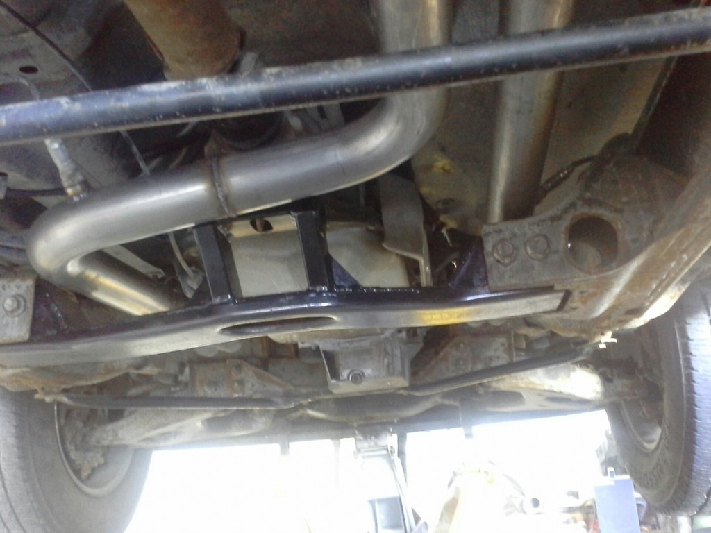

I picked up some exhaust parts last weekend, and started building pipes last night. Originally I was going to run duals, but the budget got the better of me. I picked up two Vibrant Performance 2.5" mandrel 90 degree bend sections, which worked out perfect. The drivers side goes straight back from the header, through the trans crossmember, 90's and goes under the tail shaft, then 90's again at the pass side pipe. The pass side has a few degrees of rise, but basically its straight pipe from the collector back. Both pipes meet up right after the welded crossmember to a Magnaflow high flow y pipe transition (10" long, 2.5" dual in, 3" single out). From there its 3" pipe to a 5"x14" round Magnaflow (3"in/out straight through #12867). I really wanted a Borla xr1, but the speed shop I went to didn't carry Borla stuff. I have to build the tail pipe yet, but plans are to exit in the stock location with possibly a 4" tip. I also welded in 02 bungs for the rear sensors for now, until they get tuned out later. I had to fire it up, just to hear it, (even if it was just straight out of the muffler) and I'm very happy with the muffler choice. I will post pics, and video of how it sounds hopefully in the next week or so when its wrapped up.

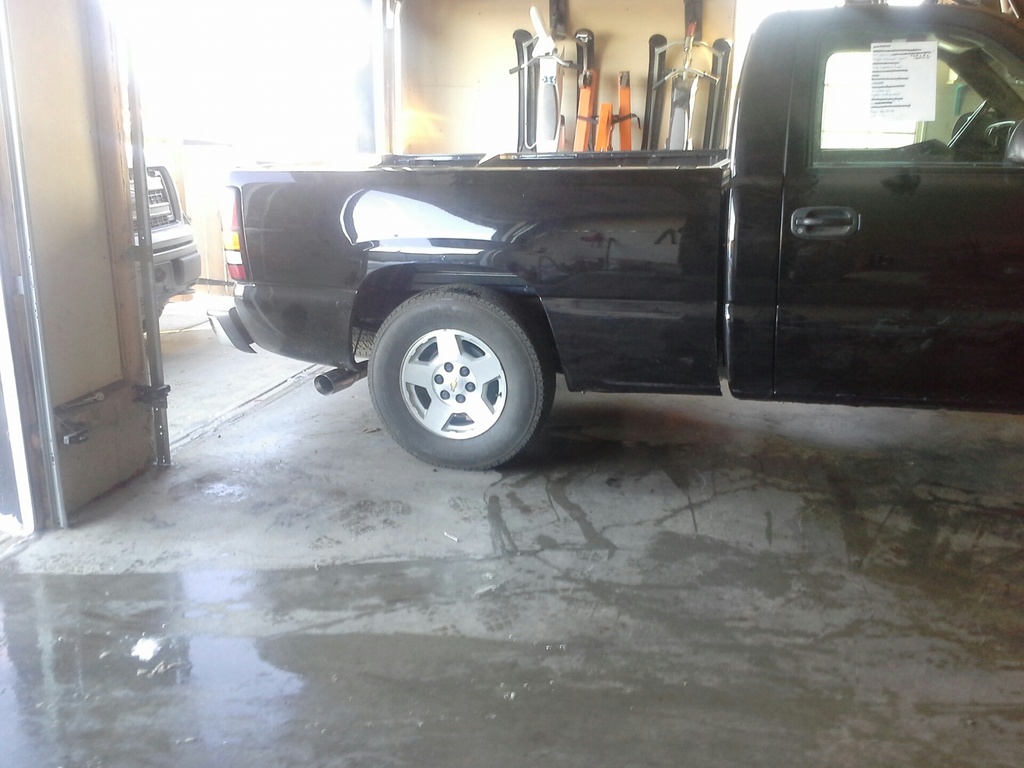

I finished up the exhaust tonight. I picked up a 4" dual wall tip to finish it off. It was getting too dark to take pics, so I will take some in the day light on the weekend.

I finally took some pics of the exhaust in day light. Its sort of hard to take pictures of this, lol.

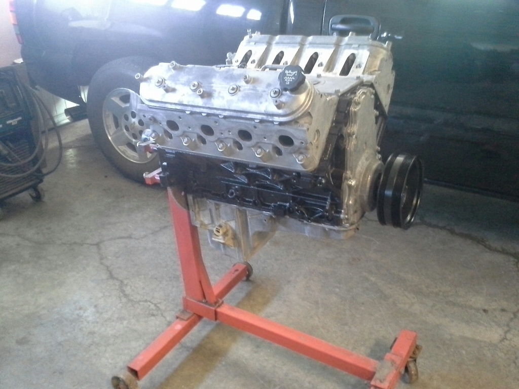

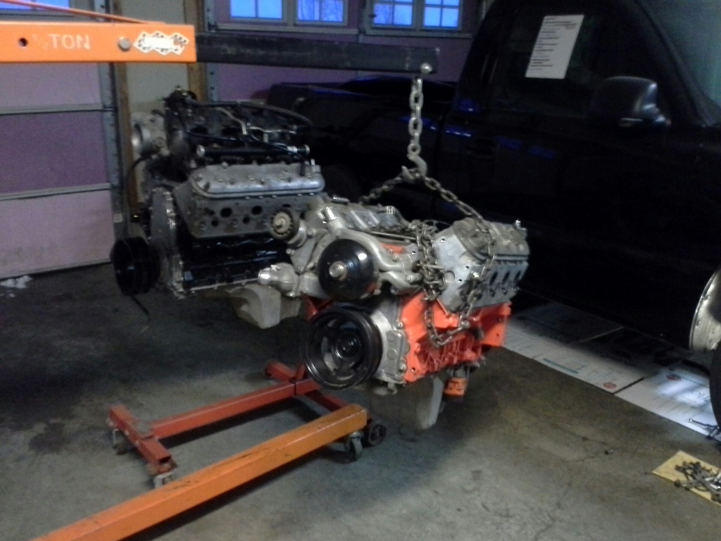

Shortly after taking exhaust pictures, I had the truck running again, and I noticed it was making a light squealing noise, I didn't really think too much of it, until it starting getting worse. I popped the belt off thinking it must have been from the accessory drive somewhere...things just got worse from there. I'm not sure if the thing spun a bearing or what, but the motor is back out, and the 4.8 that I bought for the harness is in. What a bummer. I spent a little time to doll it up before it went in anyways. No sweet Chevy orange this time though.

The orange 4.8 is back on the stand for tear down to find out what happened. If worse comes to worse, I will just keep the good parts as spare inventory for down the road. I may have the heads cut for 2" valves, and pick up some new springs, and valve seals, etc, and look for a better cam
