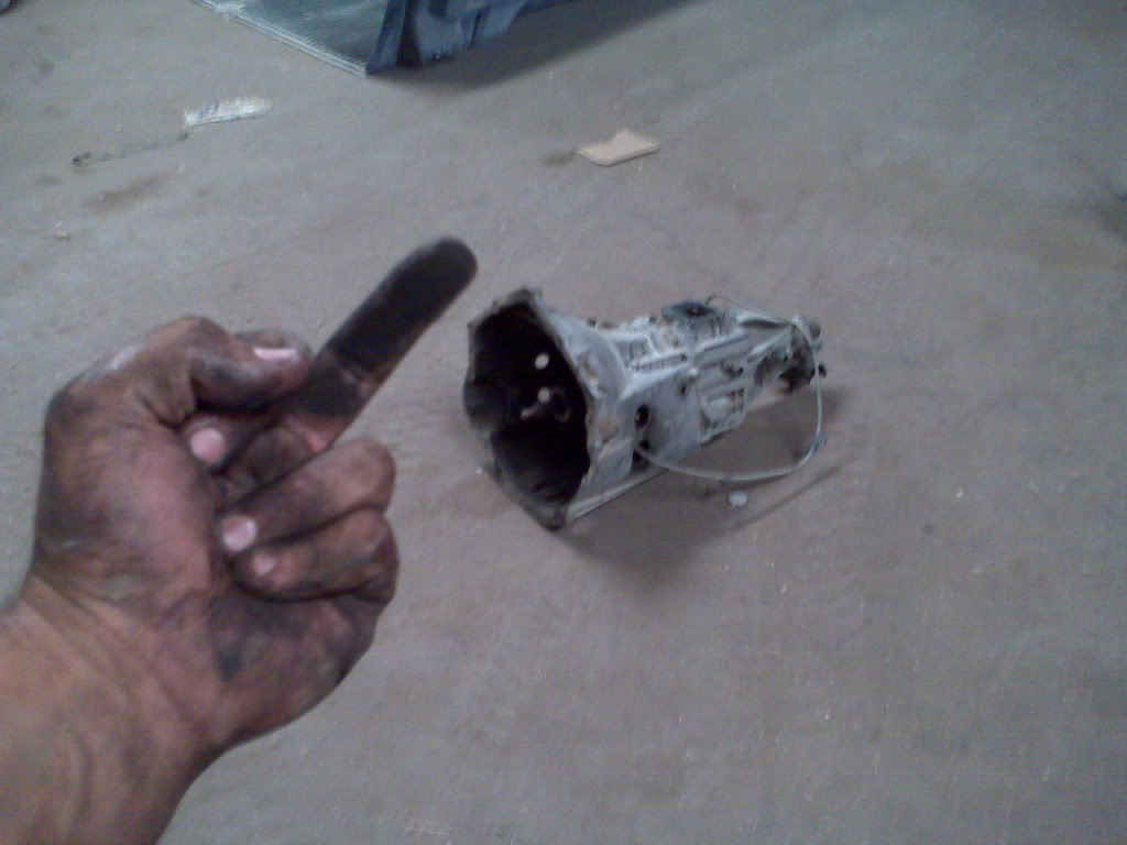

Got a late start this morning. Didnt even get to the shop until 11:15.
NV3500 is out...all im going to say about it is...
Pressure plate and clutch still look good...so all along it was the slave cylinder going to **** i had ALOT of clutch material left, and to my surprise there was very little signs of heat scaring.
