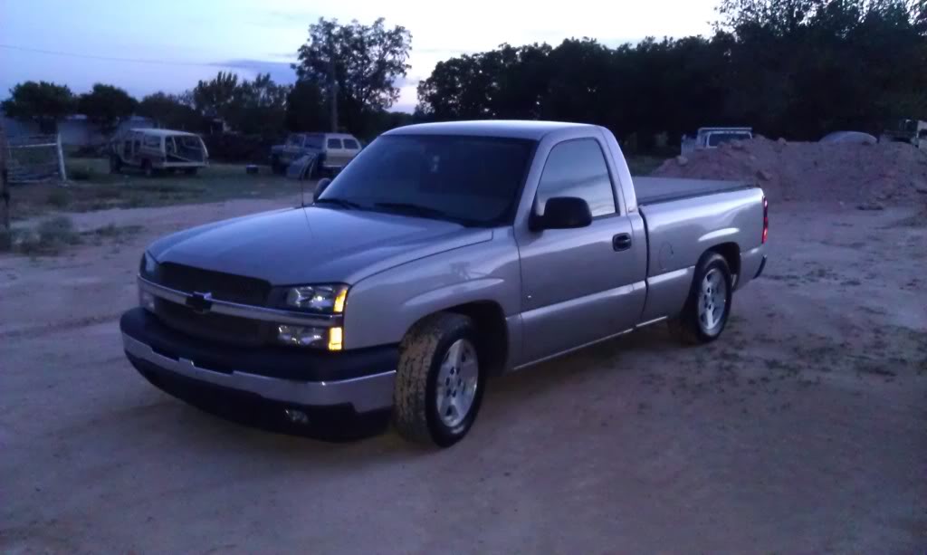

Old Jul 31, 2011 | 10:22 PM
  #30
2005 Silverado's Avatar
SPAM HUNTER
iTrader: (19)
Joined: Jan 2004
Posts: 4,099
From: NM
Finally My truck is shifting correctly.
Fast/TCI Ez-Tcu is by far one of the easiest things i have installed on my truck.
It is now shifting correct in all gears. My only complaint is even with the adjustments available i think the 2-3 and 3-4 shift are to soon but ill live with it since its finally SHIFTING.
I also added a 2-4 drop and did a few minor mods to the turbo kit installation.
SO. When doing this 1 buy an aftermarket controller i guess. 2 do the rest like the 60e to 80e way. What i had to do. OR just get a full manual valve body.
