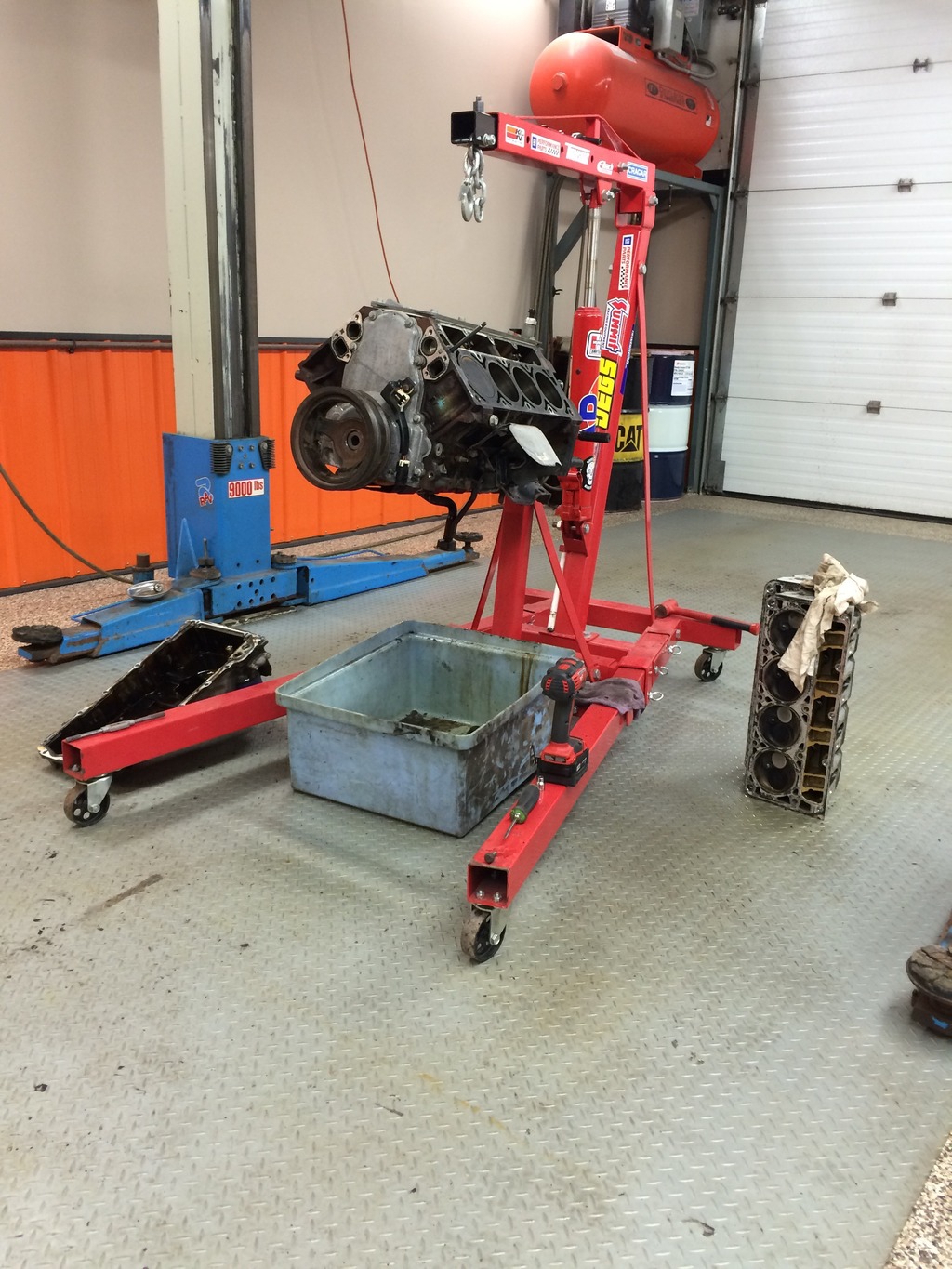

Down to a short block...

...getting there...milled/freshened the heads,double springs,Titanium retainers,seals,GM mls head gaskets,Pro Comp head studs,boost Comp.cam(ish),3 bolt sprocket,LS2 chain,LS7 lifters and -10 male bung welded in the pan.
Waiting on timing chain damper,gonna make a shim for the oil pump.
Still need the trans back too.Dom

What did the machine shop charge ya? Did you have the head surface "touched" or actually milled down?

is that engine stand attached to the cherry picker? i've never seen that before...
Heads were machined with cutter,very nice smooth finish about $50 each.
Yes it is a package,but the engine stand is detachable.

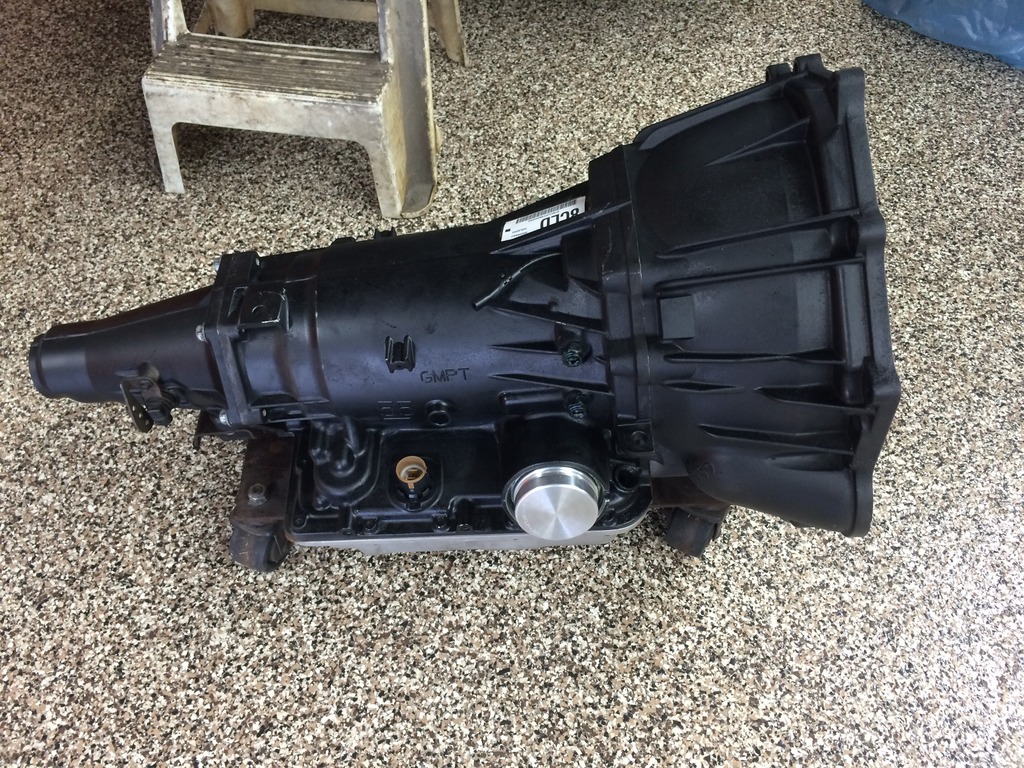

Trans done(this is what a $5k tranny for a $5k truck looks like!(Canadian funds)

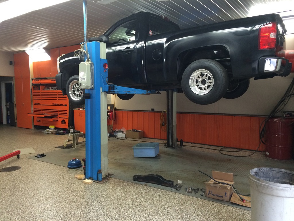

Reinstall begins
