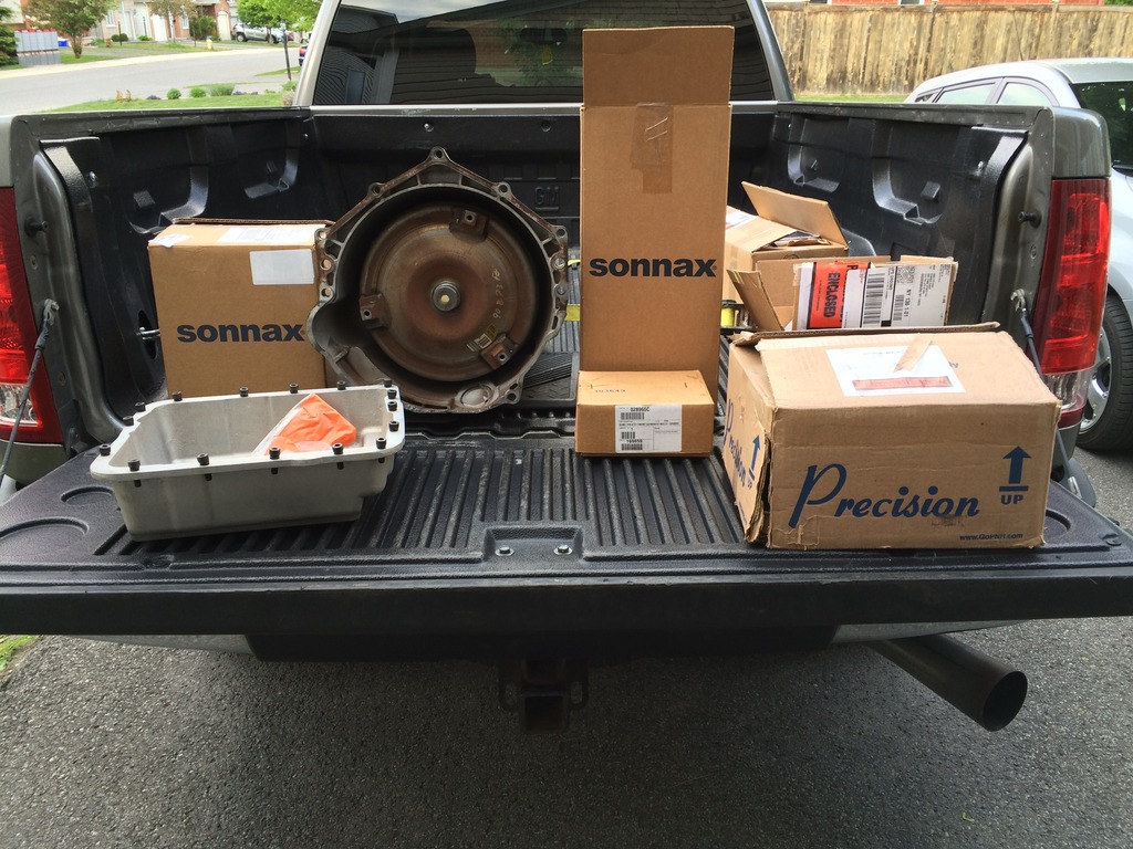

Off to get the max level 4L65E rebuilt
Bought everything available for this trans!

Why are you waisting money and time on that 65?
Well being that it was meant to be uncomplicated budget build,i was trying to avoid the 80e swap.Also seeing that the goal was just rolling on fun and maybe a half mile event i thought i could get away with the 65e...but it snowballed from a good rebuild into the hardened input/drum,hardened output,new ratio first gear set,billet cover converter and all the other stuff!Though i am curious to see if it can be done.
Hindsight
