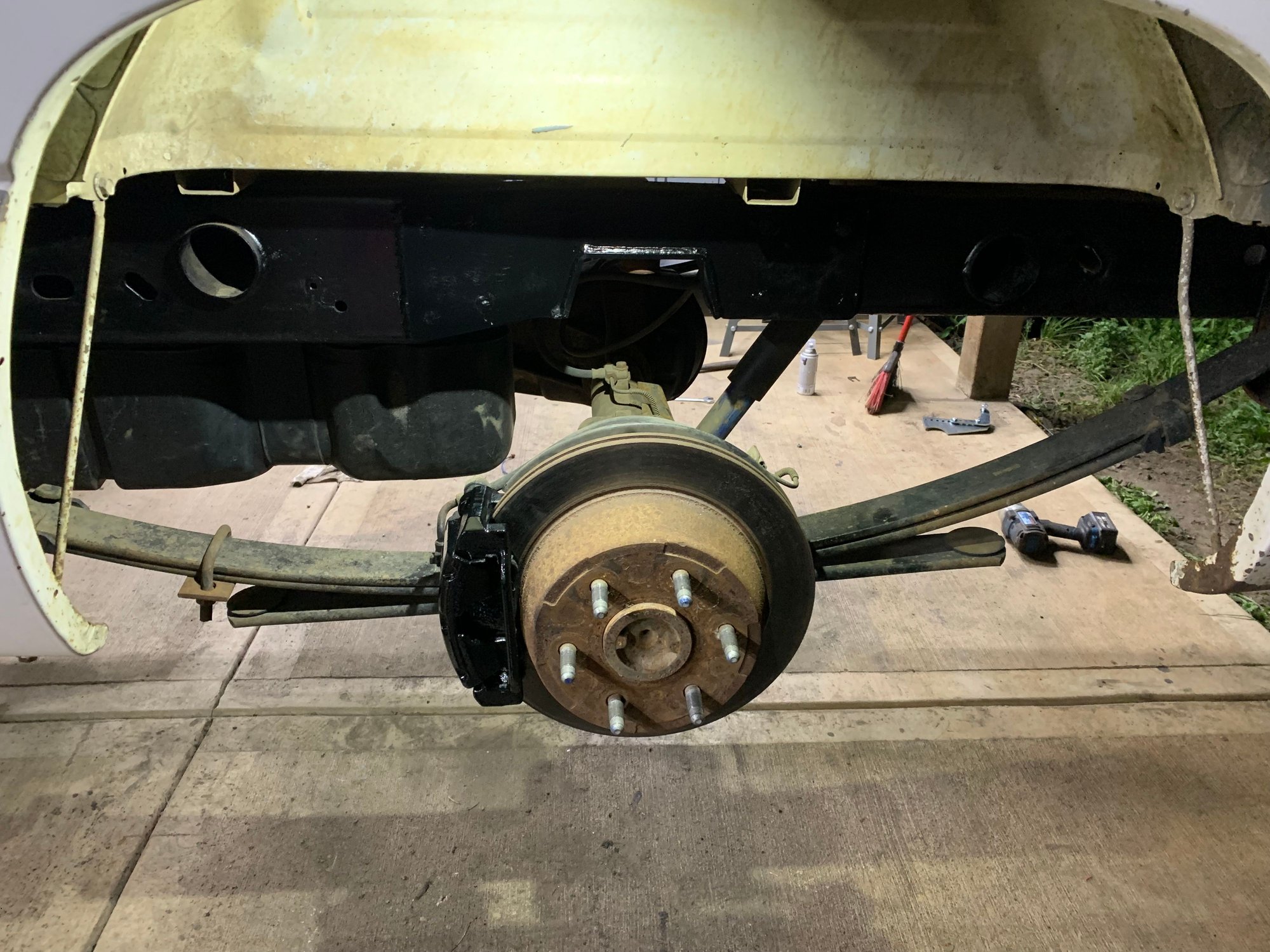

I’ve had some Hondas like that over the years lol. Got the c notch all done. Welded it to the frame instead of using bolts. Shocks felt kind of worn at the spot where normal suspension travel was so now they are a bit more compressed and it actually rides better lol. Looks like the front needs to come down about another inch but I’ll check again in daylight. New seat heaters work awesome. I really like this truck, I think as long as I can keep it useable I’ll probably end up keeping it for quite a while.
I will probably do the limited slip diff next and then break it in then do the fuel pump, super servo and turn the boost up but I’m excited to drive this again for a little bit.
