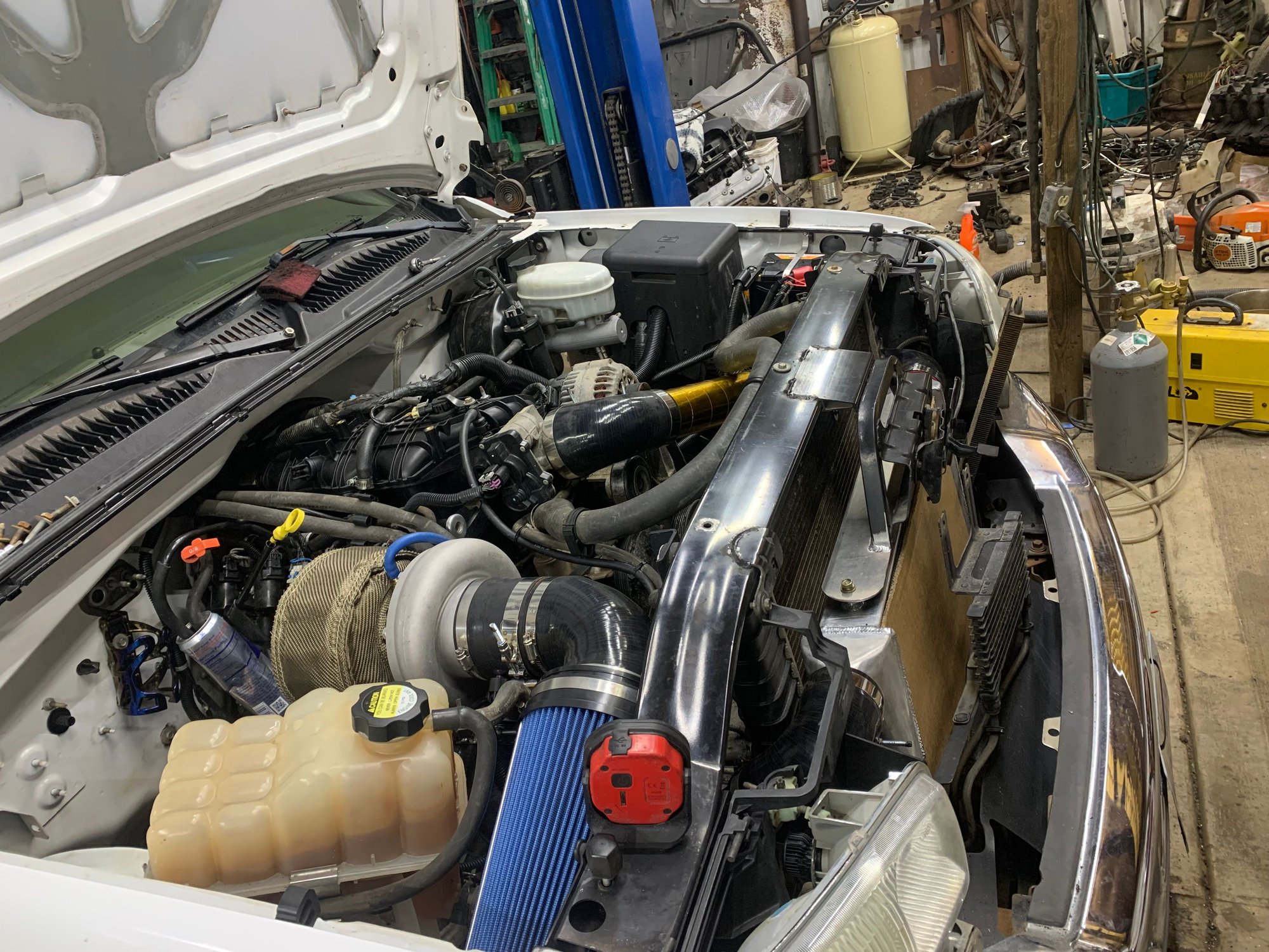

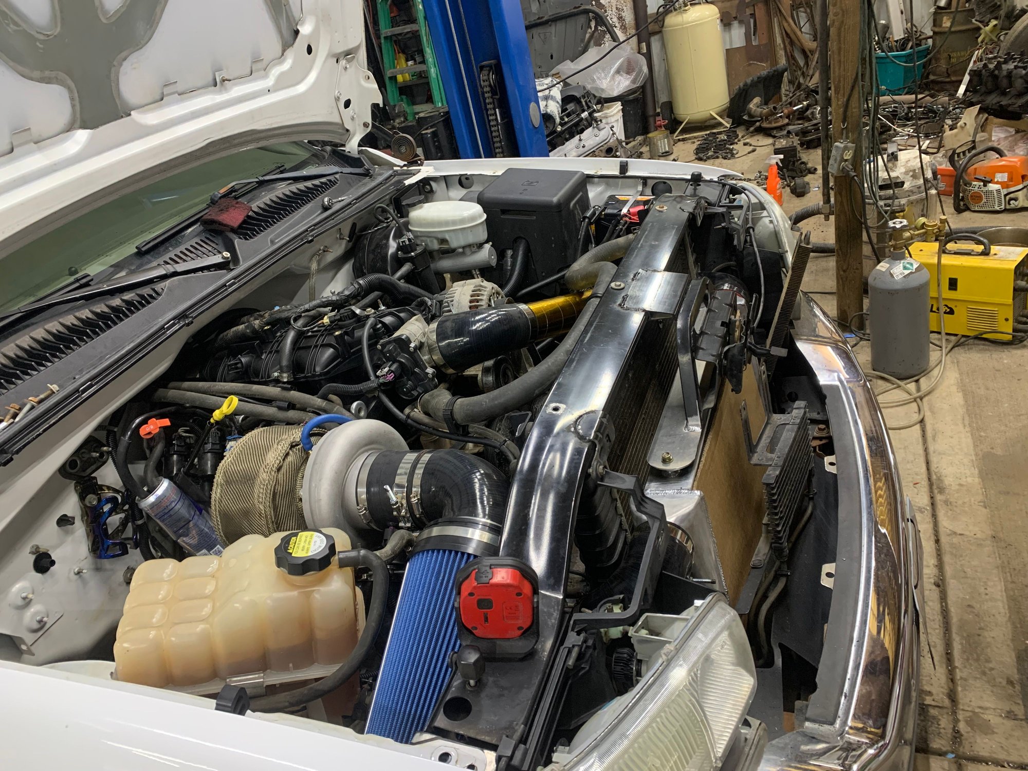

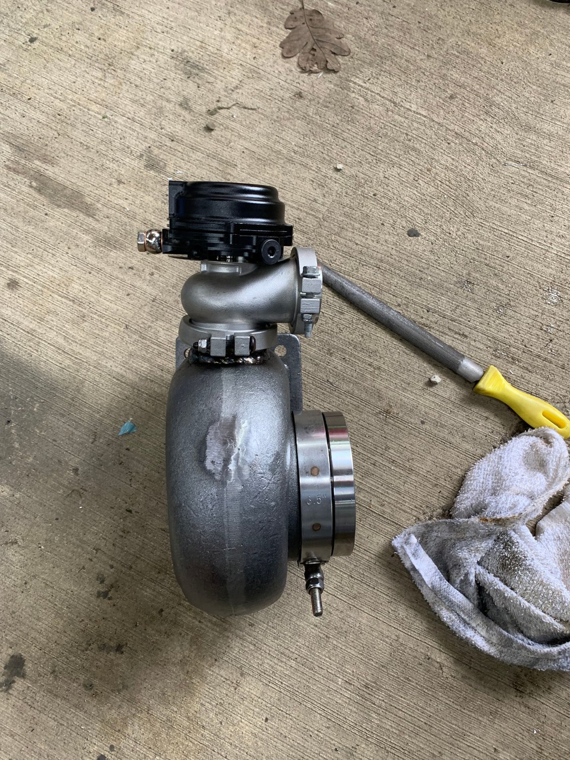

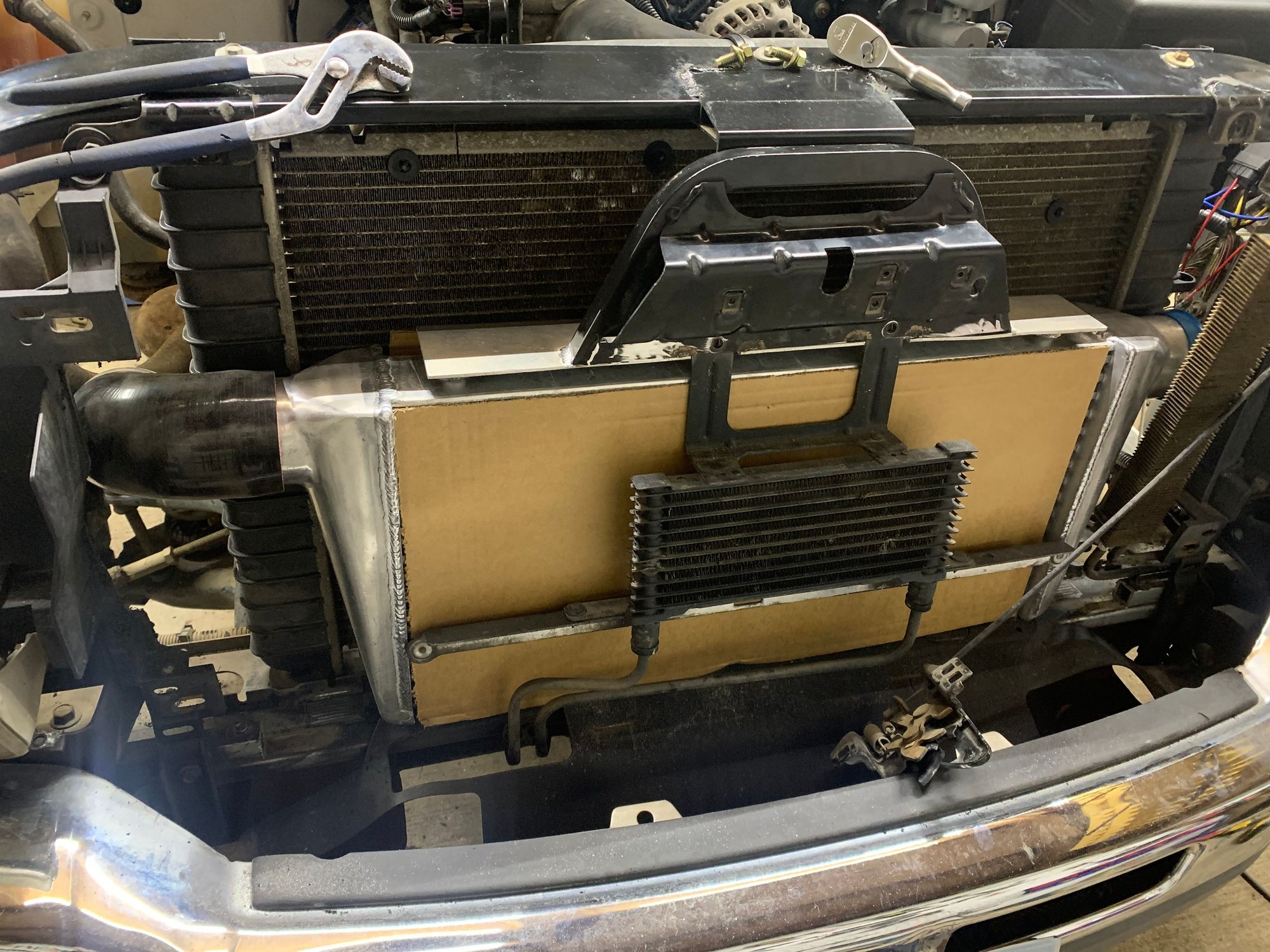

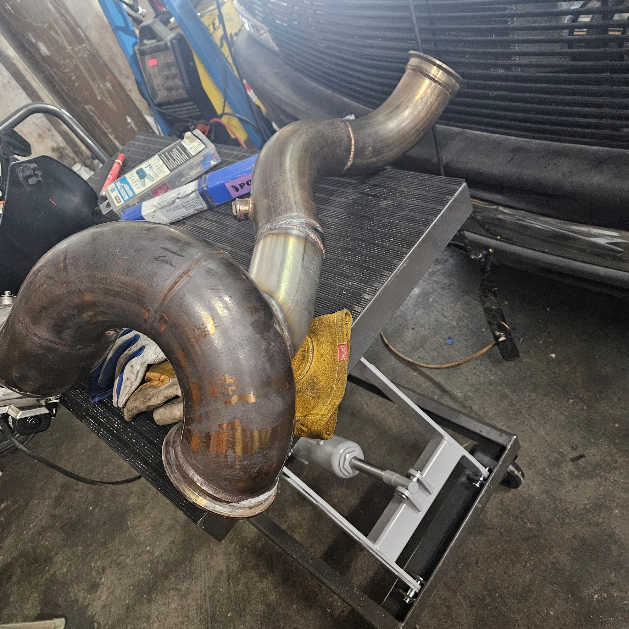

Making a little progress. Both charge pipes are done. Intercooler mount is welded up. Gotta finish the cross over pipe, downpipe and weld my wastegate onto the turbine housing. Also decided to change to a nnbs intake manifold on it because I’ve heard they have much better distribution of air to the cylinders. I also replaced all the passenger side manifold bolts with grade 12.9 socket cap bolts for strength. Still gotta install the super servo in the trans, fuel pump with relay, decap and flow test the injectors. Just trying to tackle one small task a day on it so the progress continues.

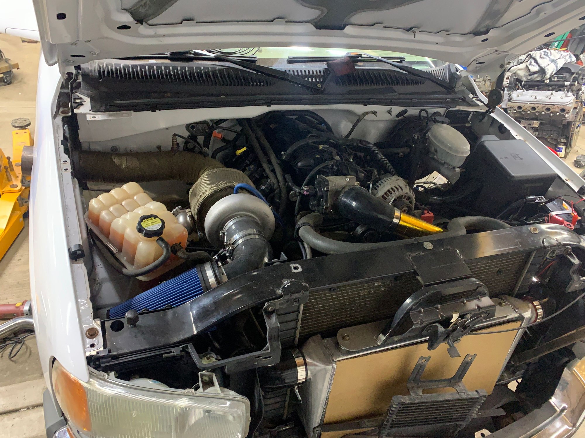

Decapped my injectors and took them to my buddys to flow test and clean them. They came out to 72ml per min for the lowest flowing and 77ml per min for the highest flowing. I put the highest flowing injectors in the back cylinders. Also swapped a nnbs manifold onto the truck. Still need to finish the downpipe/ cross over pipe and dump tube, install my 450 lph fuel pump and wire up a relay to it as well as install my super servo but it’s getting closer to being able to drive it. I think I have a half tank of regular in the truck still so it will give me plenty of time to work on the part throttle tune first before really getting into it.

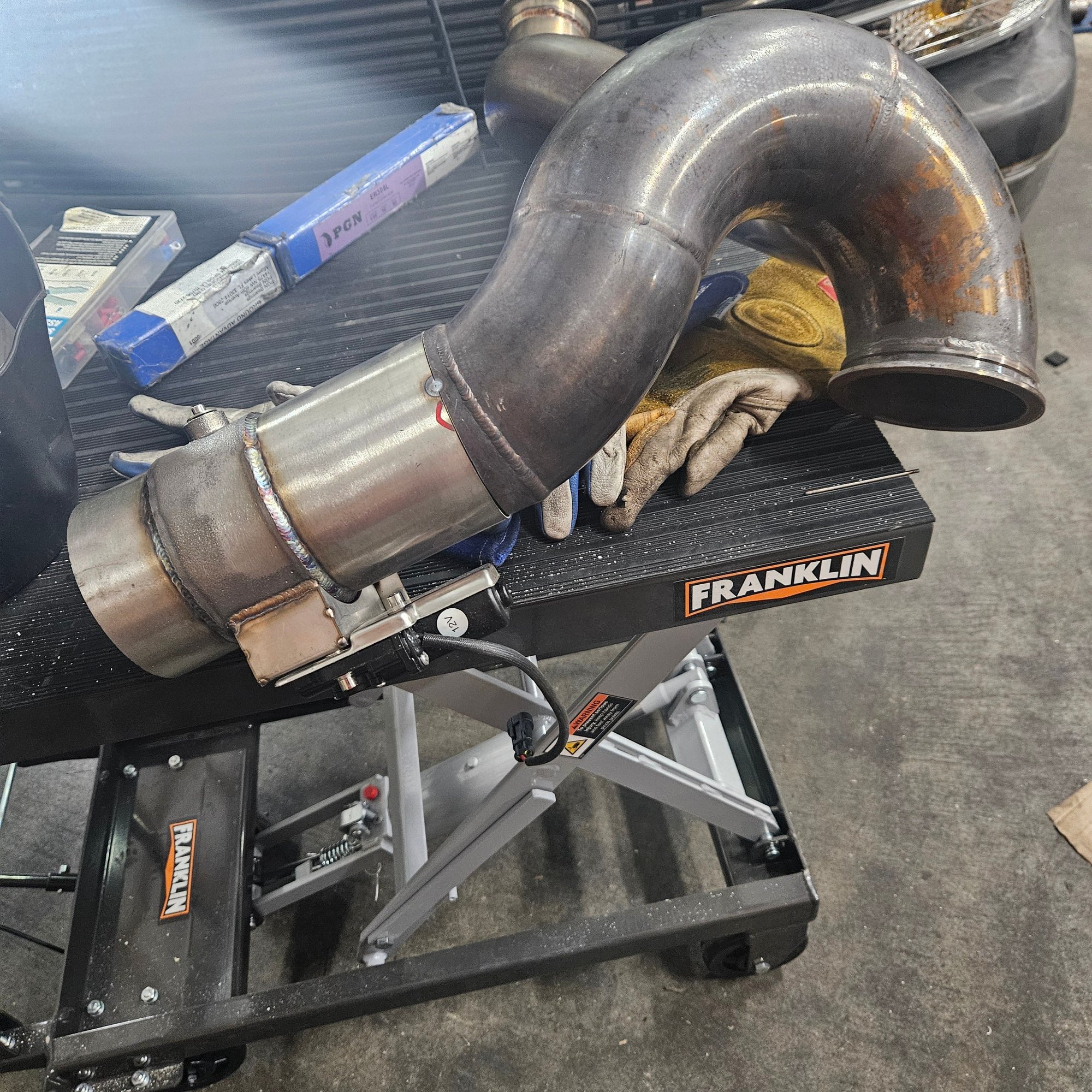

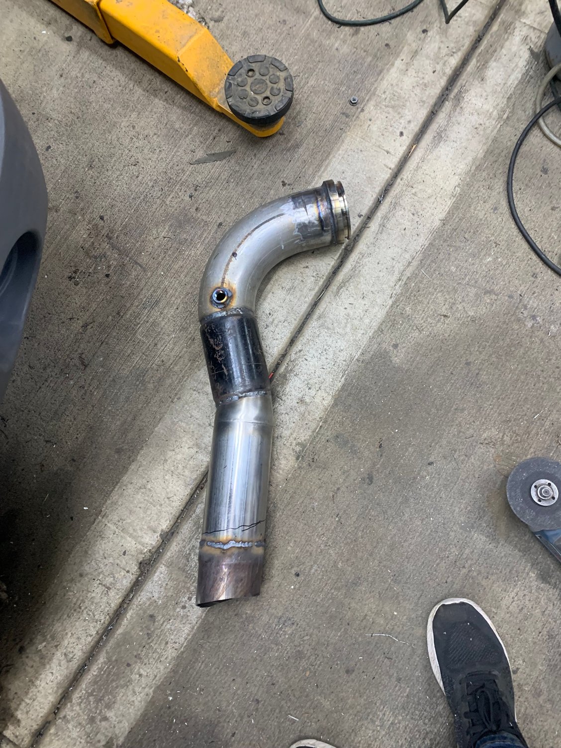

down pipe is pretty much done besides final shaping on the tip and I’ll probably open the fender opening slightly larger and then put some of that protective door edging on the opening as a trim. Dump tube is done. Gonna finish up the cross over tube and it will be ready to fire up.
yours is exactly how mine use to be, fyi mine is pretty cool the way we did it. Right where you have it going out the fender we put a cutout right there and then on the back side close to the firewall we cut a hole in the bottom side by the 90 and put put a 3" flange right there and then ran full exhaust off of it under the truck. So im im driving around its on the exhaust under the truck and if I want i have a switch inside to open the cutout and I also have a holley output on it which opens it at 3400 rpm

Well it’s alive. Changed over to a 3 bar os in the tune, put 67lb in for injector flow rate and it fired right up as soon as it trigger the code for the maf failing. Runs great so far. E fans work and are super quiet. Exhaust is surprisingly quiet while cruising it. Gotta install my trans cooler, super servo and wire in the new fuel pump with a relay (after I run this regular out) super happy with it so far though and also no leaks which is always a big plus.
