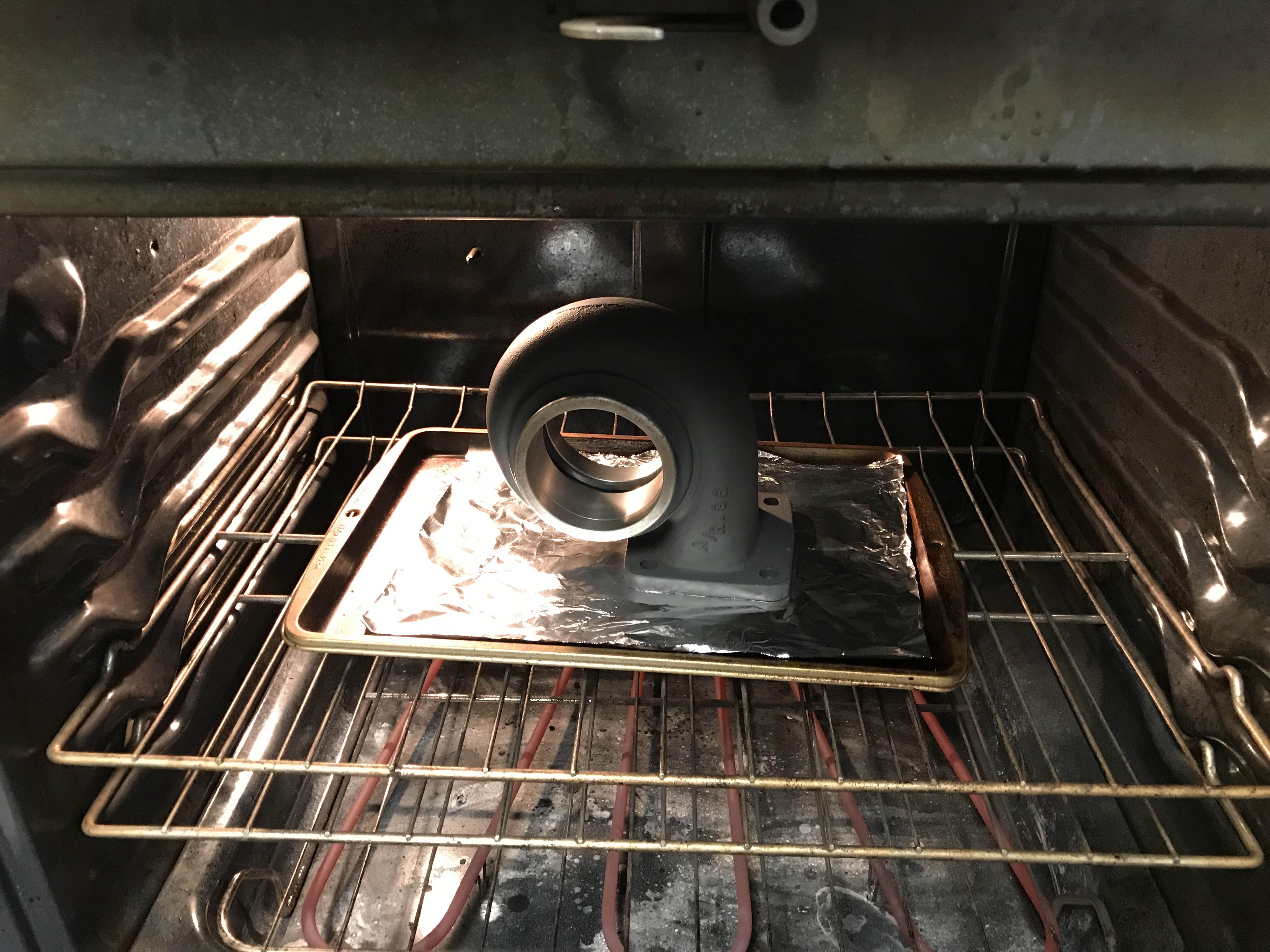

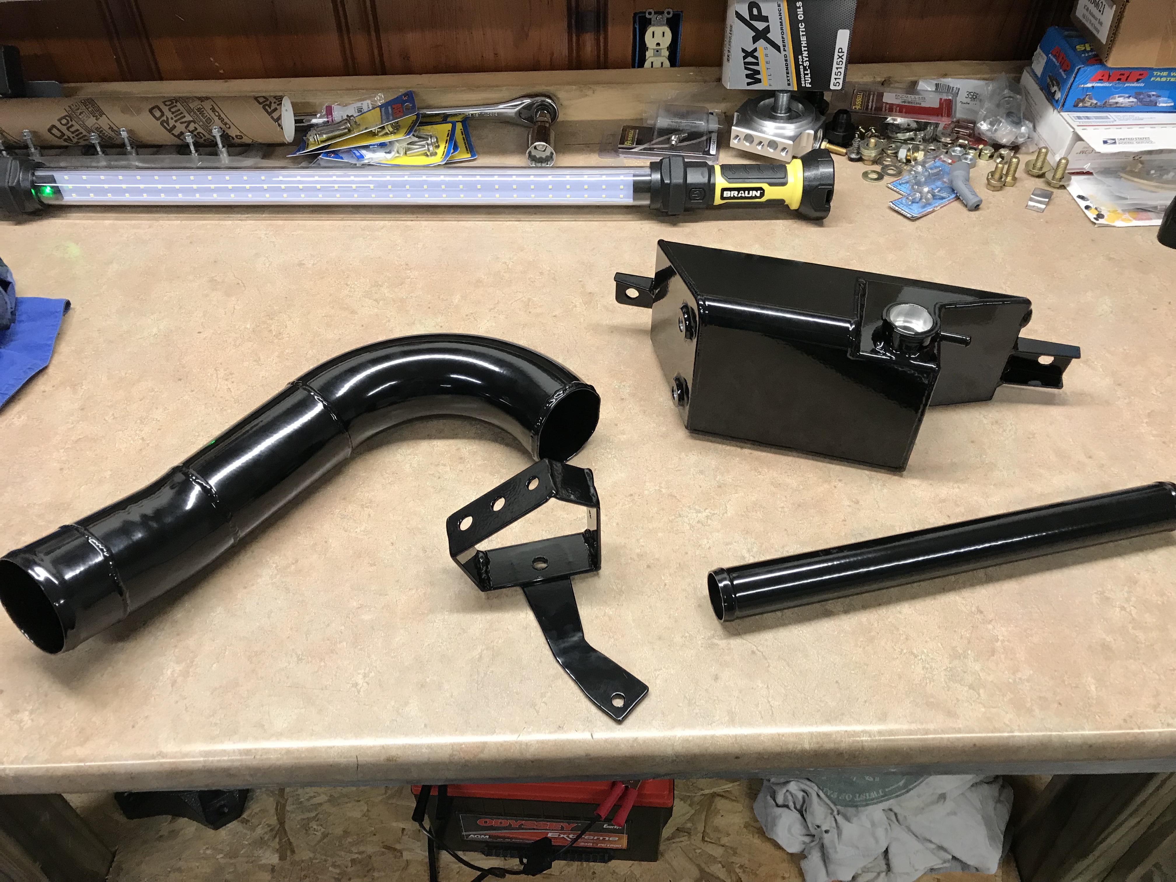

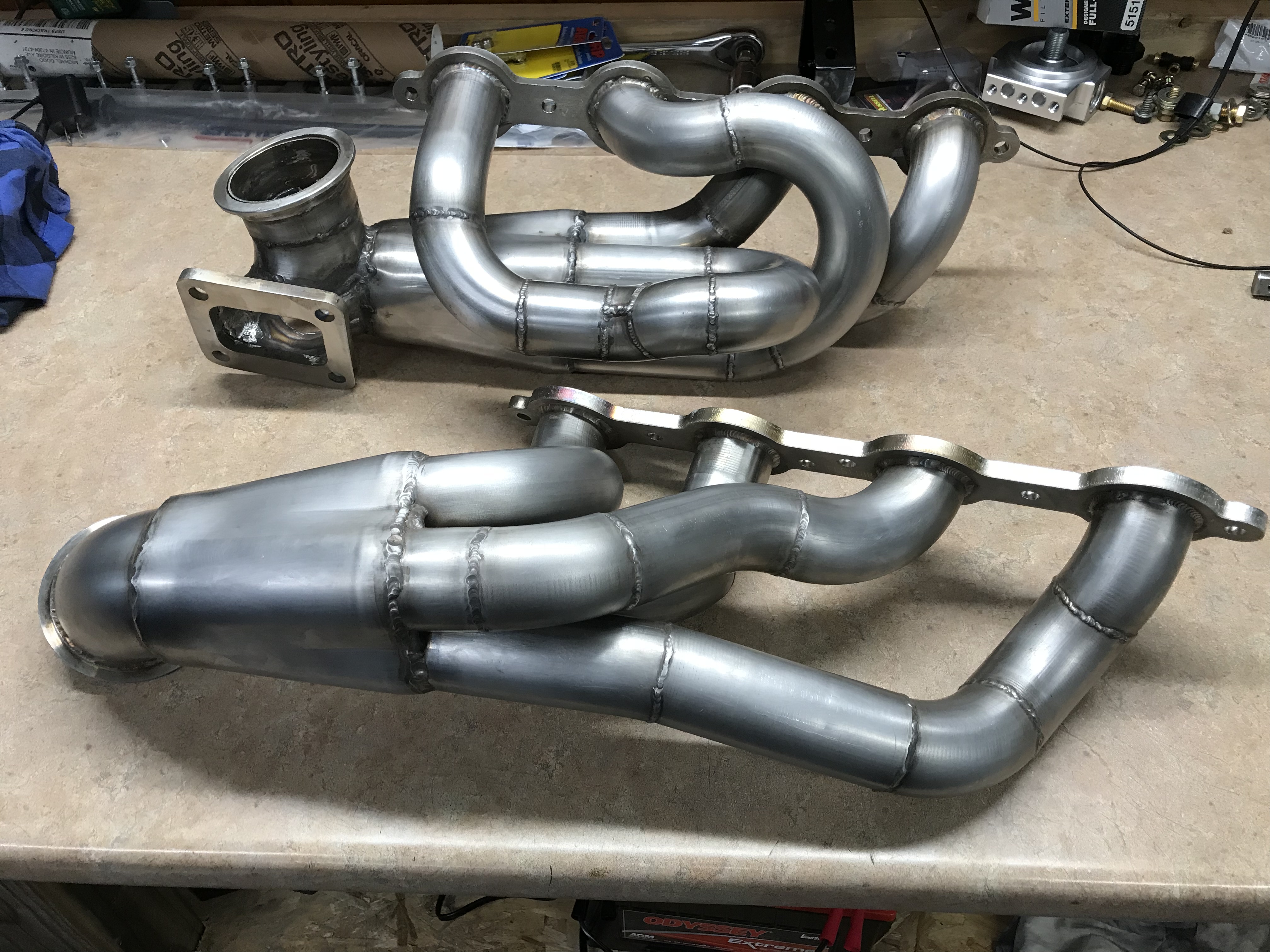

Got some more stuff coated and am baking the turbo right now with rustolem high heat, mainly so it doesnt rust as ive got a blanket to go on it as well.
Wheels are suppose to ship next week but we will see..

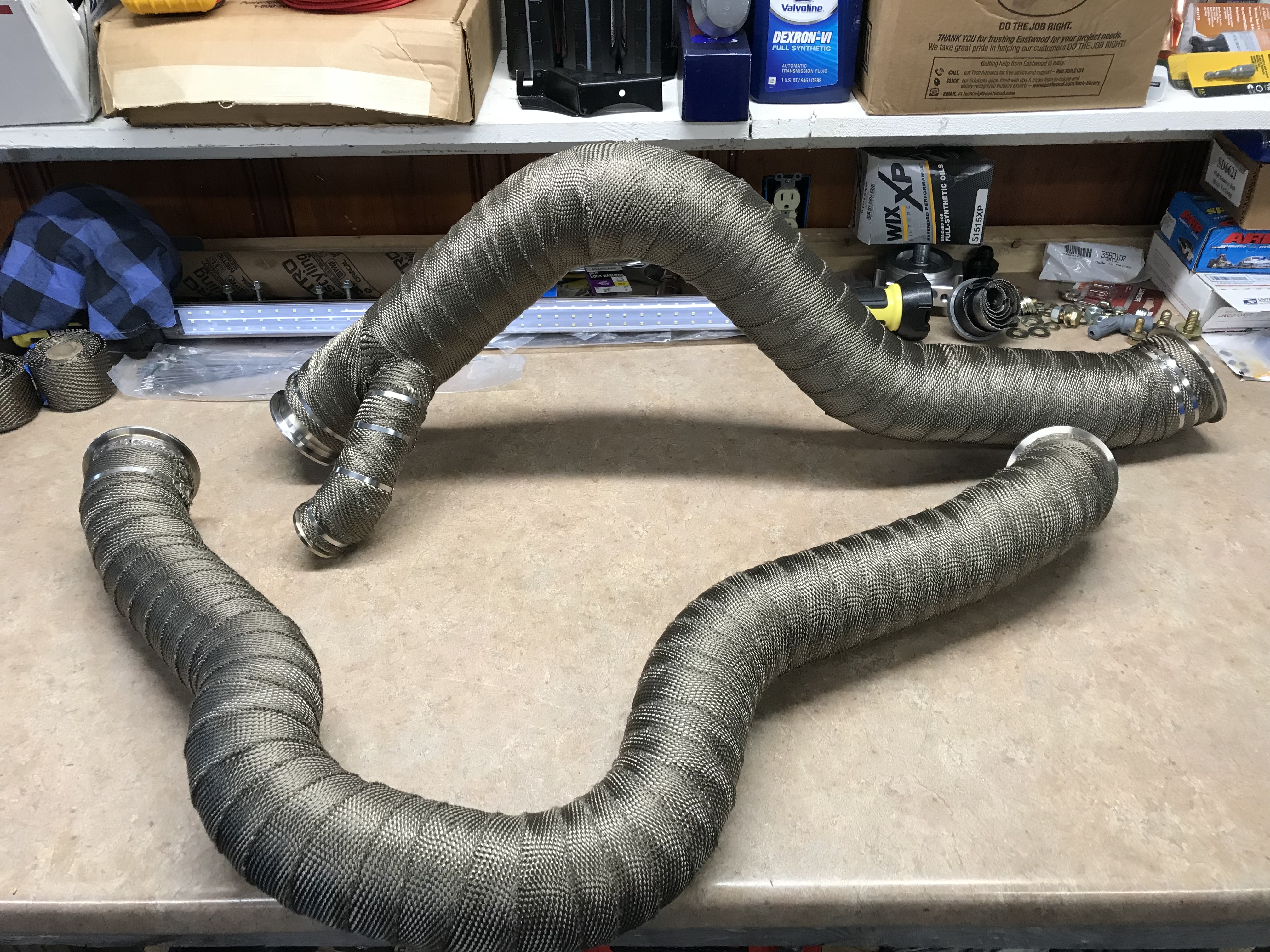

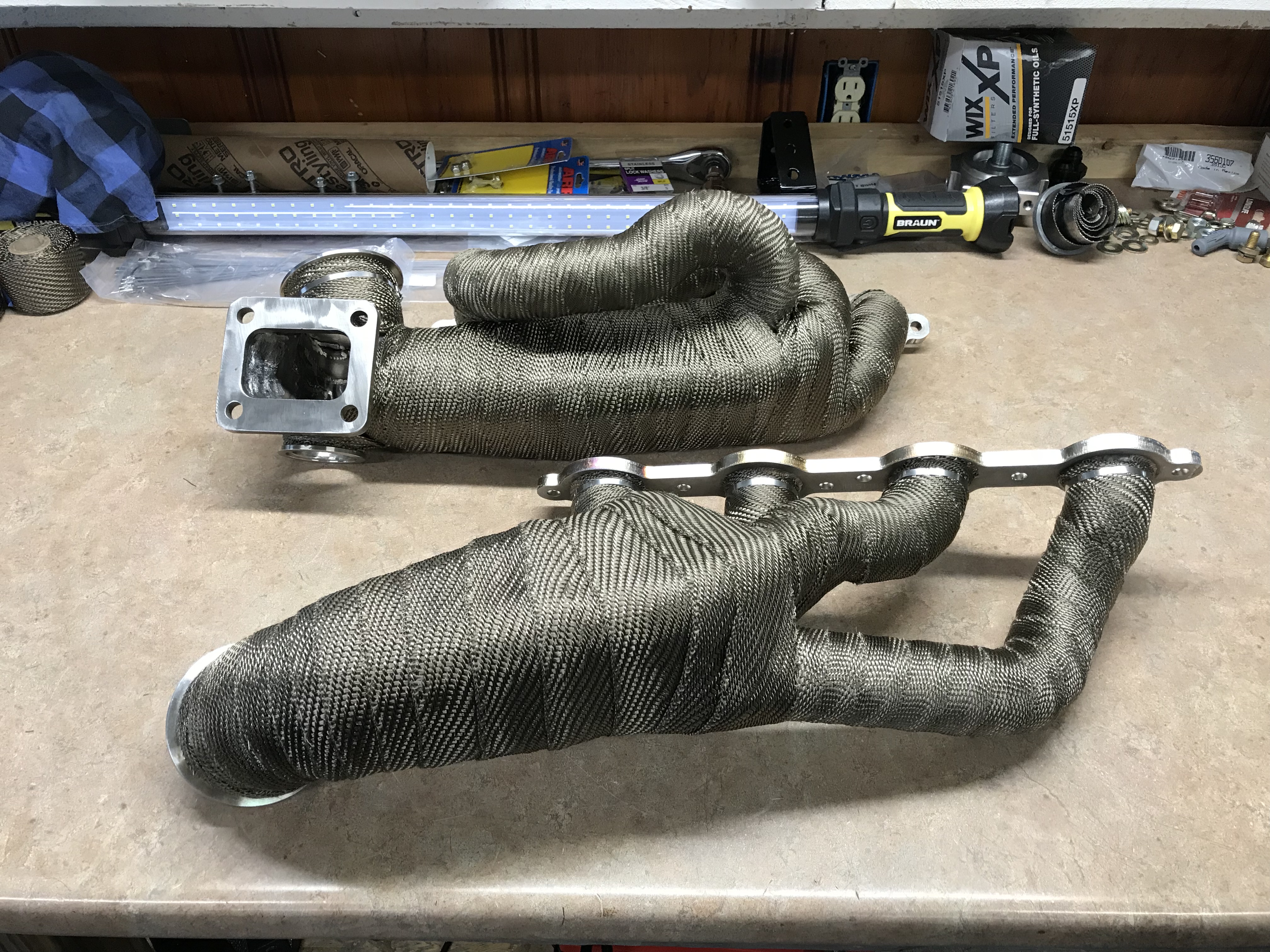

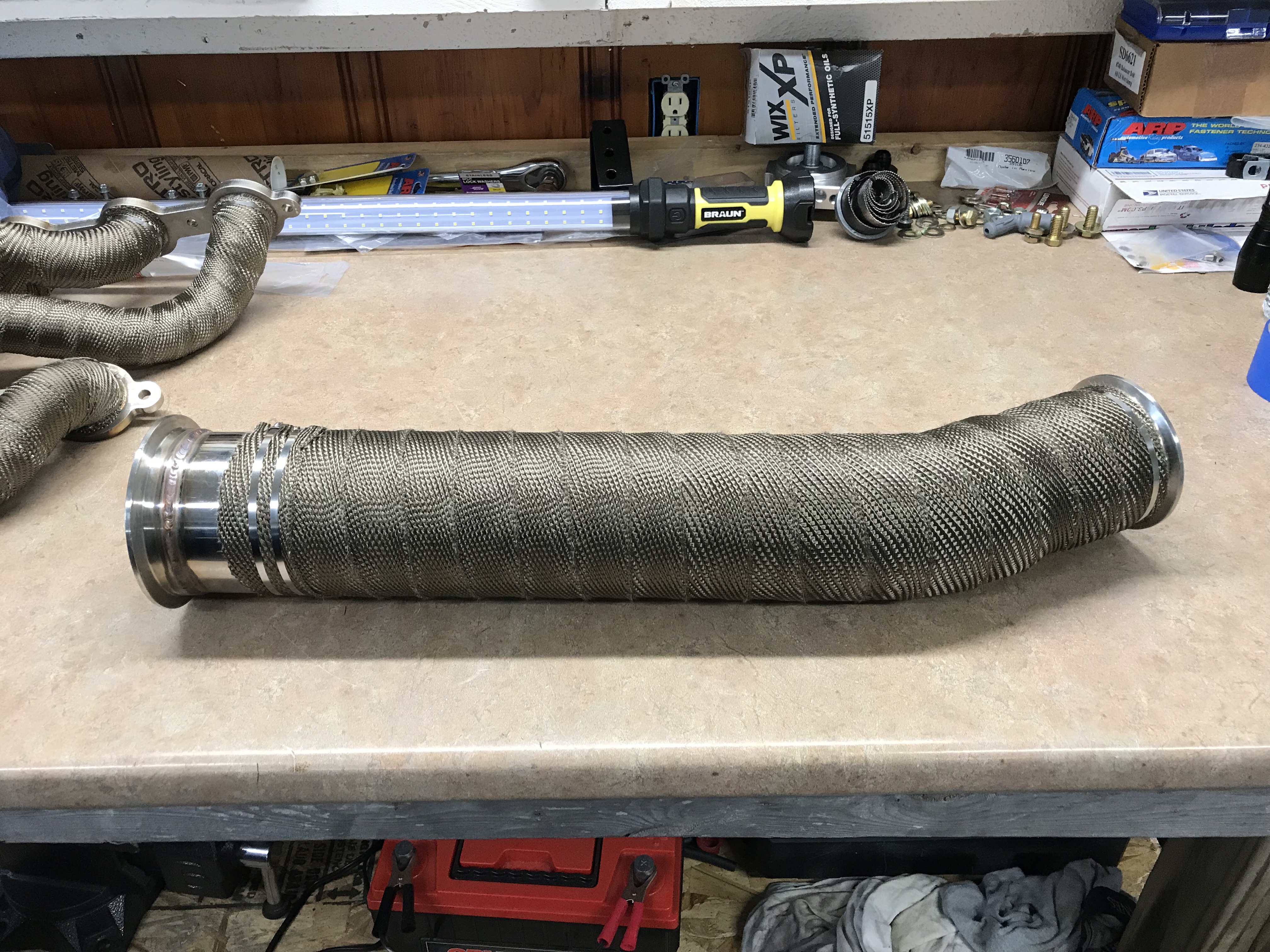

Everything wrapped, thought i was going to have too much wrap when i started, turned out i had to order more..
and they shipped the front wheels, still waiting on rears..

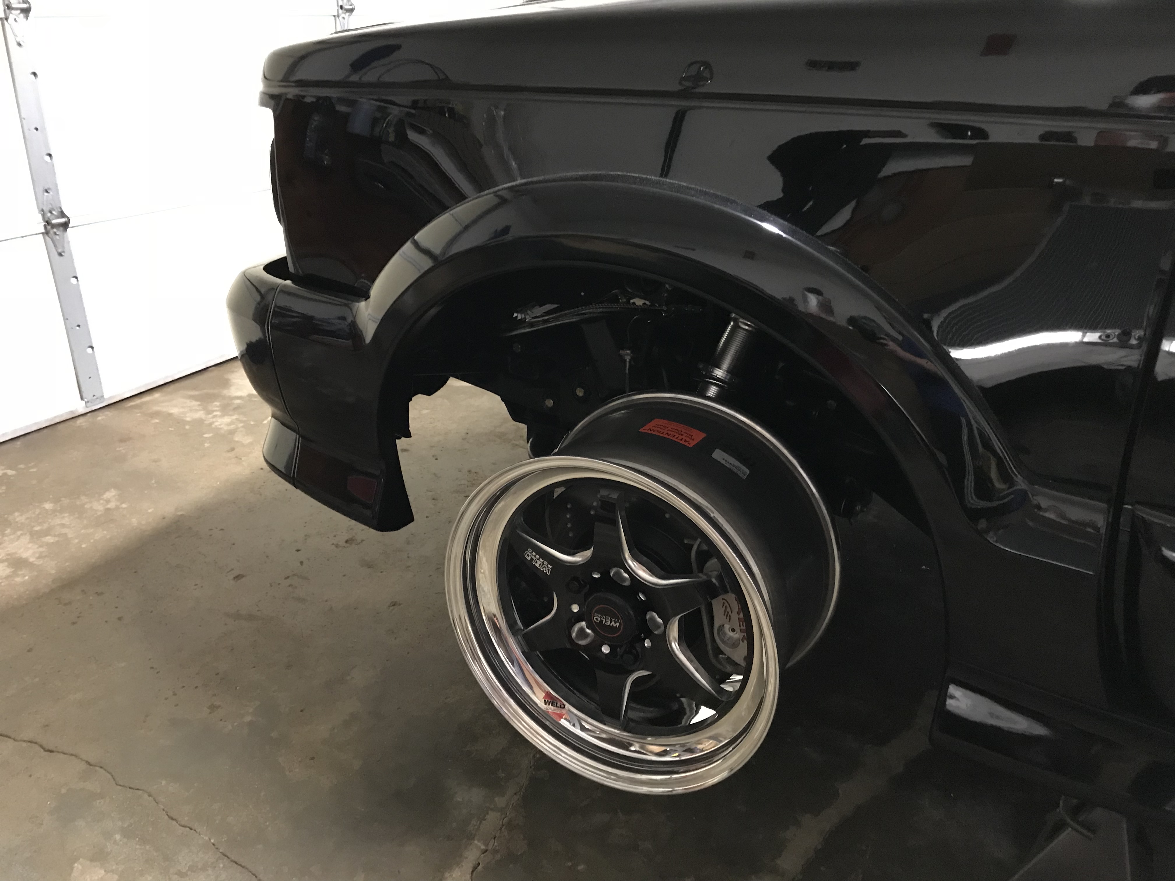

Weld does theirs in back spacing not offset, but i ordered everything to be as close as possible to c4zr1s that fit with no spacers. 17x9.5 and 17x11s

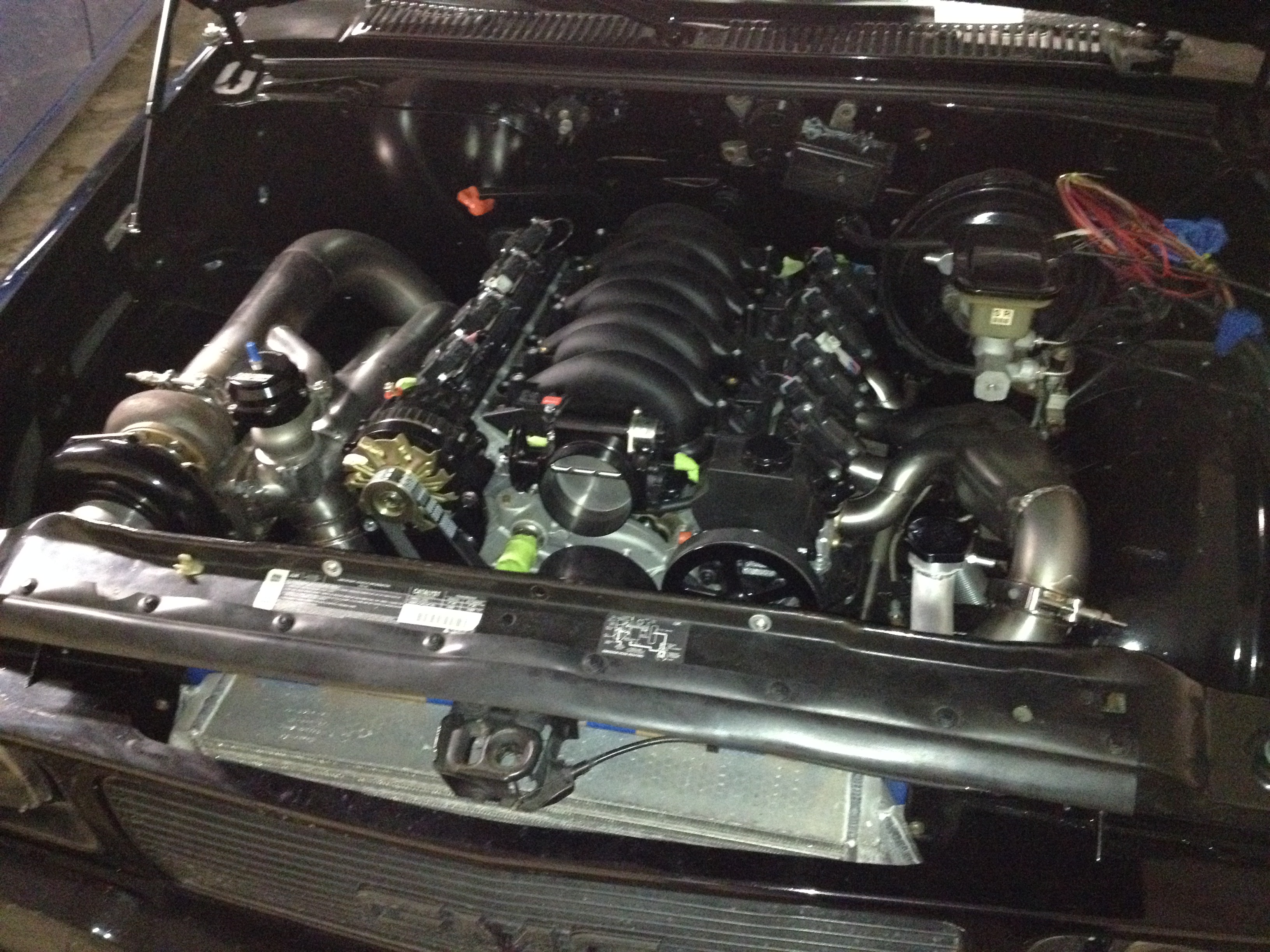

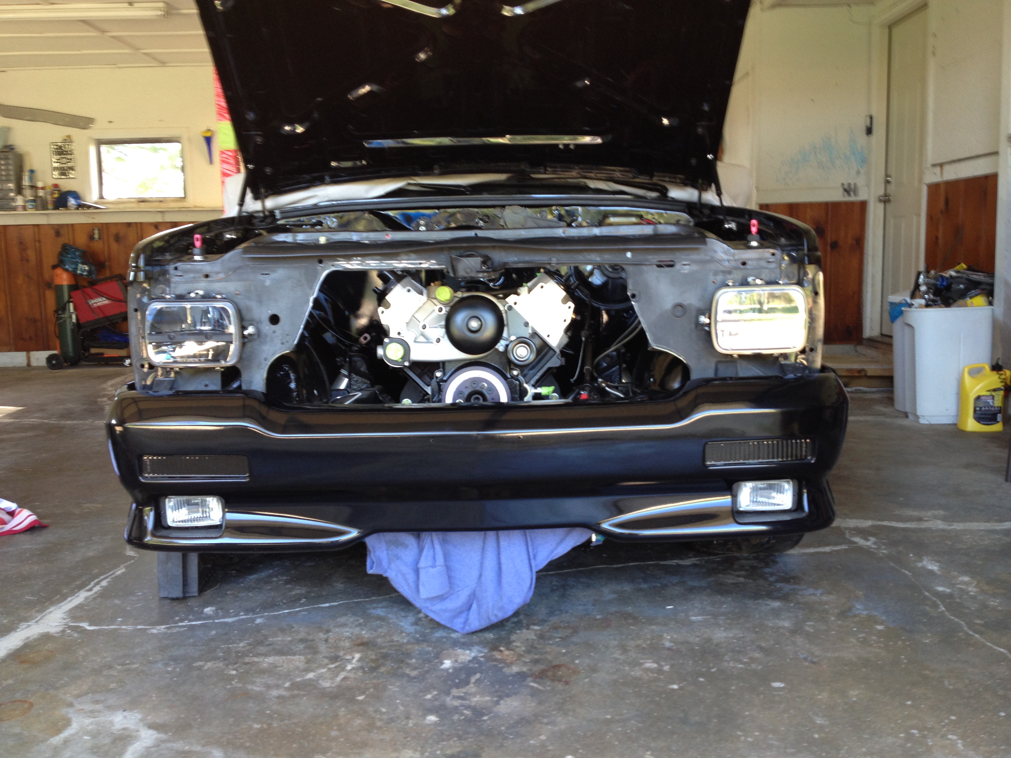

Any pictures of how your intercooler/radiator ended up being mounted? What where the final dimensions on the intercooler? I'm working on converting a beat up 91 4x4 to awd right now, and I'm fighting radiator/intercooler fitment. Not much room to work with.
Old Mar 3, 2018 | 08:02 PM
  #90
skolman91's Avatar
iTrader: (28)
Joined: Feb 2009
Posts: 2,019
Likes: 58
From: muncie IN
Yea talk about no room.. only pics i have, if you zoom in on the first one you can see the thick tabs welded on the top corners with a bolt thru the core support, and on the bottom of the IC is a dowel peg which slides into a hole drilled into the the core support. The top of the rad has a bent piece of alum that connects it to the top of the core support, and two more dowel pegs welded on the bottom that slide into two more holes in the core support.
Im pretty sure the IC core is 24x12x3 and thats without end caps just core size and you see how much i had to cut away to make it fit..
Not sure how much fab work your into but i know someone is making a square tube alum core support that gives plenty of more width, just only so much you can fit behind the grill opening anyways imo so i stuck with hacked stock one..
