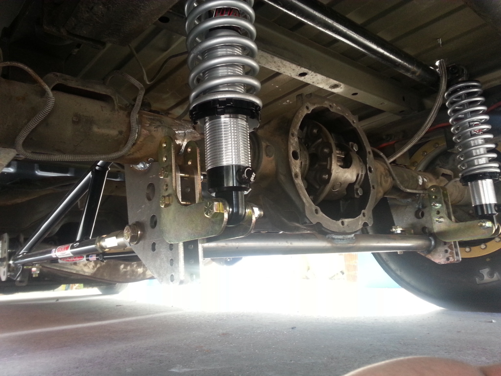

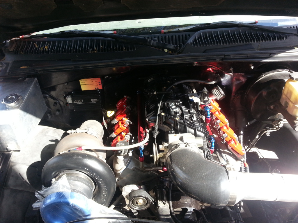

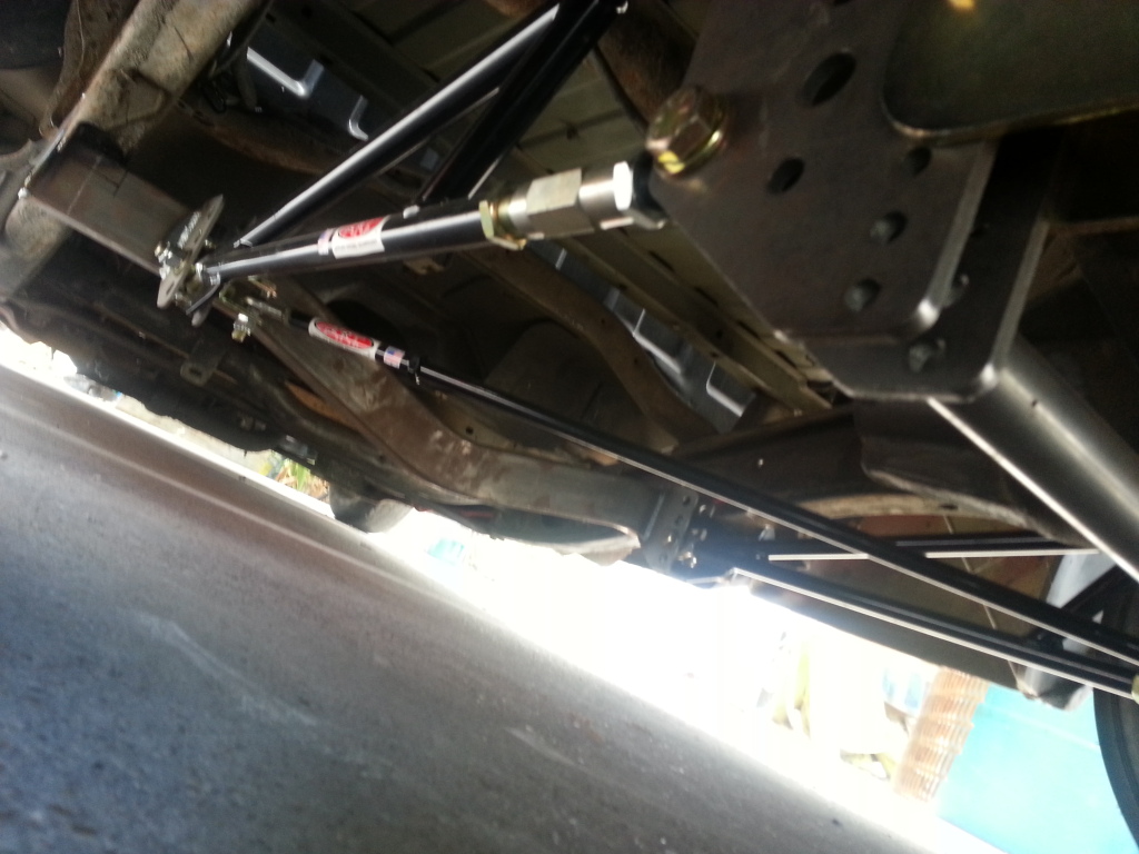

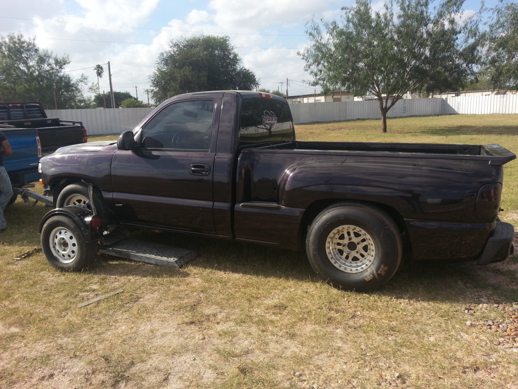

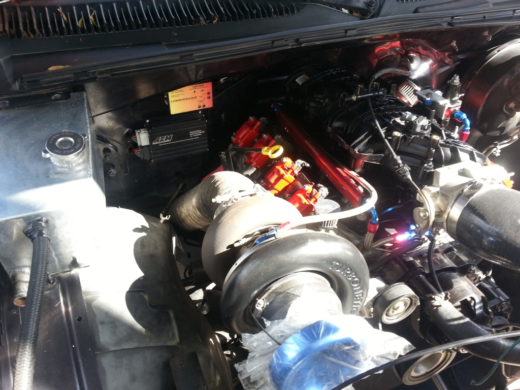

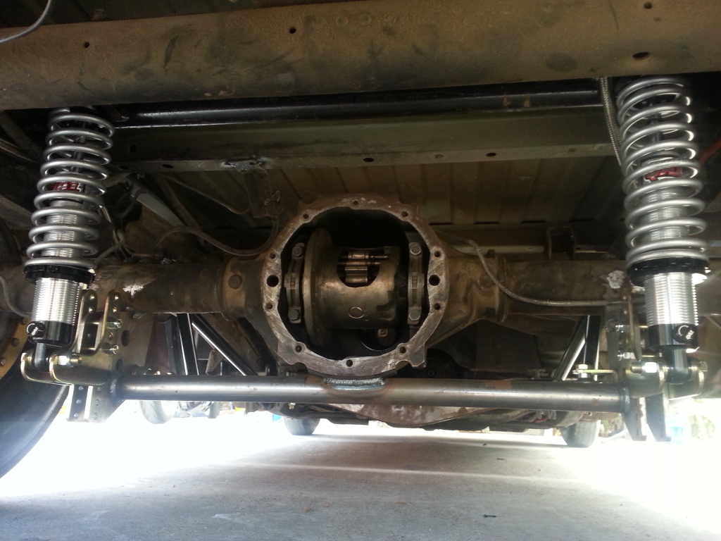

Just need to wire up gauges some electrical stuff and gears and truck should be up and ready here are some quick pics

When will it hit the track and what is the engine/turbo set up?

does the fuel line come from the tank, under the manifold to a T and then to each rail? Was just looking at the pic and couldn't tell if that was in or out.

Engine: 346ci 243 heads stock tbss intake with a 90mm throttle body custom boost cam kit
Turbo kit: its a Tellez Motorsports log style kit with a 4 inch cooler and 88mm turbonetics turbo
Fuel system: running 195lbs injectors with a holley dominator billet pump along with aeromotive billet fiktersand a fuel cell and 10an feed 8an return (the rails get fed from the rear by a Y and the front T goes under the intake towards the regulator)

Suspension:consists of 2way adj coilovers in the front and ladderbars with coilovers in the rear

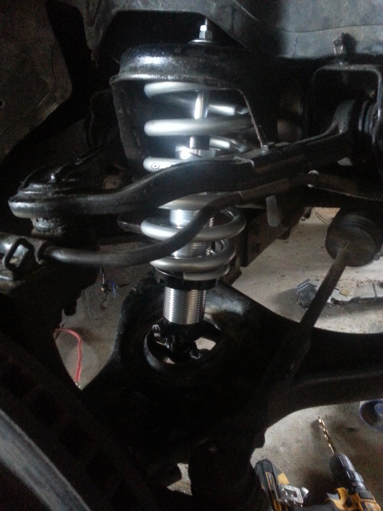

Really good choices made IMO. What coilover set up is that? I need my front to lift more.

Thanks and the front is some qa1 double adjustable coilovers

Besides that carms and spindle are stock
