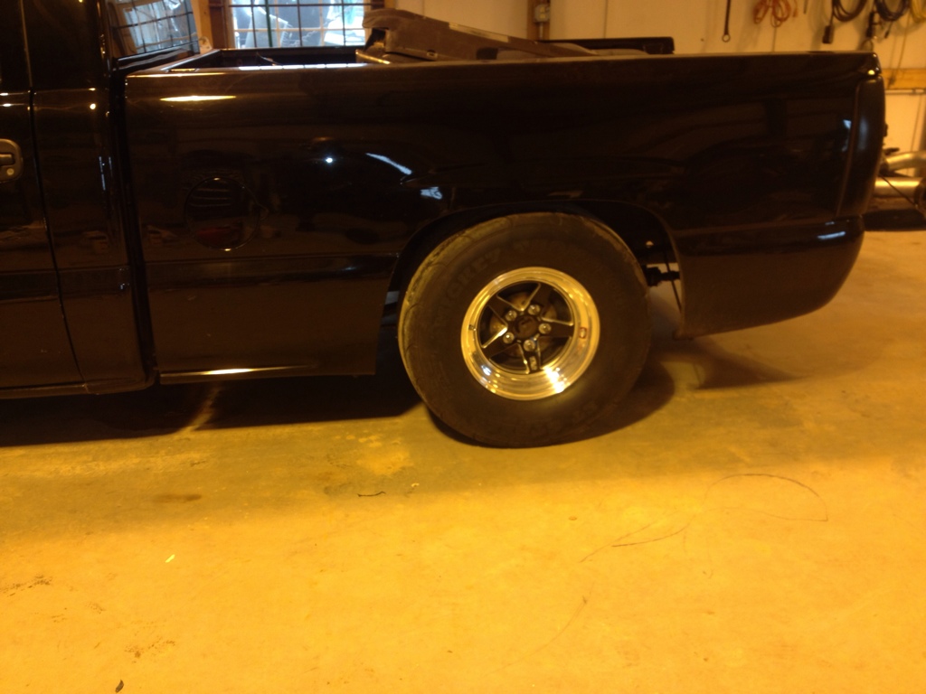

I was hoping to get a favor out of you. Could you get a hub to fender lip measurement on the rear of your truck? Wondering how my shackles, hangers, and overload delete sit compared to yours. I was looking into assassin bars and I'm not sure they'll fit with my hangers. Be nice if your middle leaf delete and stock shackles/hangers sat lower than mine.

Roughly 15.25" from center of hub to lip

Thank you good sir. I reckon helper bags are mandatory for any hauling with one spring, but that's not an issue.
