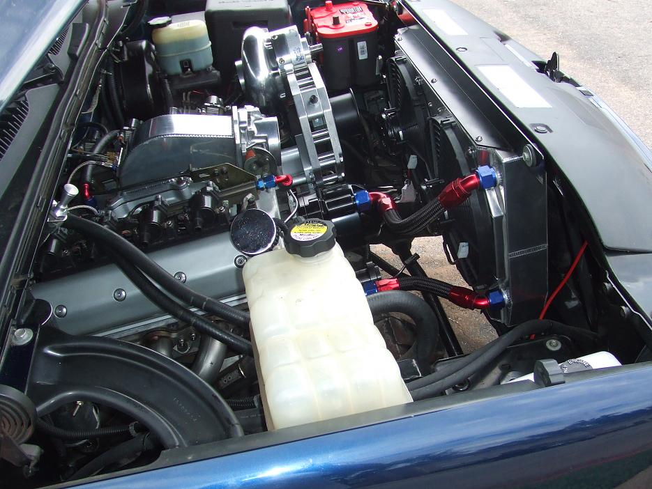

What size hose and fittings did you use for your radiator hoses? Any other pics of it?

it is -16an feed and return. I ran this same setup on my procharged engine and worked great. Its a dual pass ron davis radiator so that helps. This is a pic of the old setup but I am using all the same cooling stuff.

How did you connect them to the pump?

Its a miezere electric street pump. I ordered the -16an adapters for the pump and the radiator came with -16an connections.
