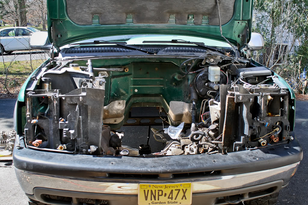

Old Mar 16, 2010 | 11:17 PM
  #36
DV2000NJ's Avatar
13 Second Truck Club
Joined: Nov 2009
Posts: 1,102
From: Central NJ
We're getting closer...

Old Mar 16, 2010 | 11:32 PM
  #37
_zebra's Avatar
makes children cry
Joined: May 2009
Posts: 2,897
Likes: 456
From: cold & windy
ahh... i remember that sight. it'll sure feel good when it's all buttoned back up
Old Mar 16, 2010 | 11:50 PM
  #38
DV2000NJ's Avatar
Joined: Nov 2009
Posts: 1,102
From: Central NJ
I'll be happy enough just knowing the truck runs again, I don't care how quick it is.
At least the next one I do will be a lot easier.
