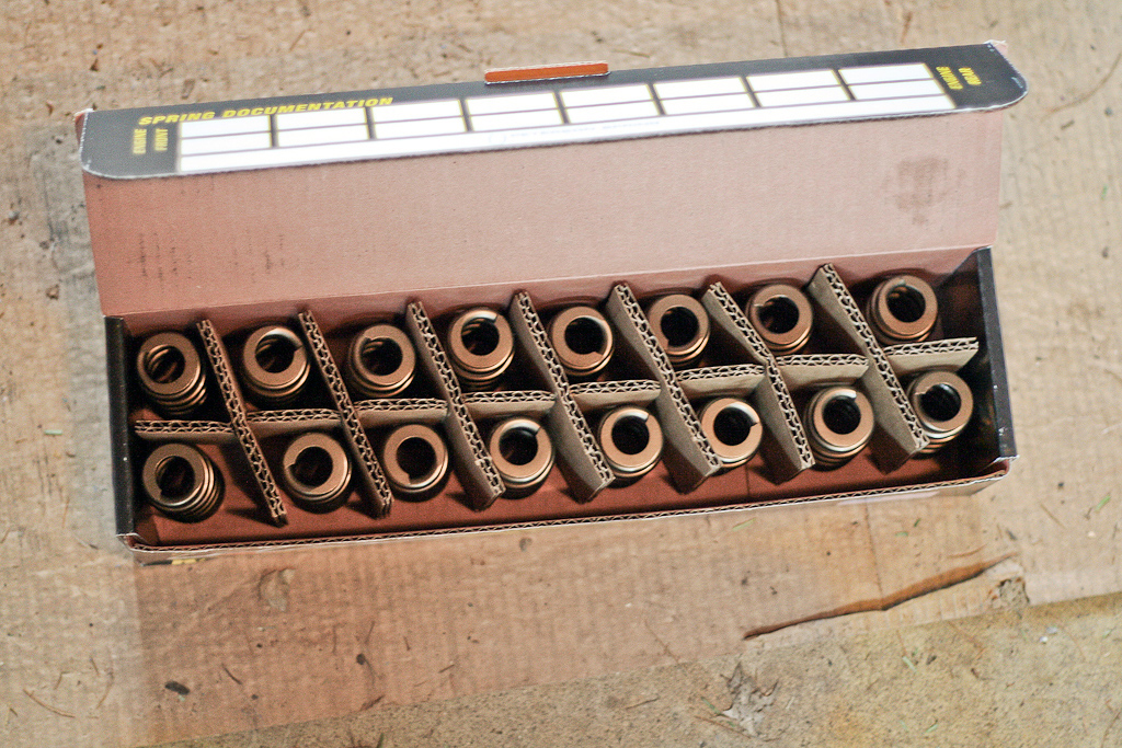

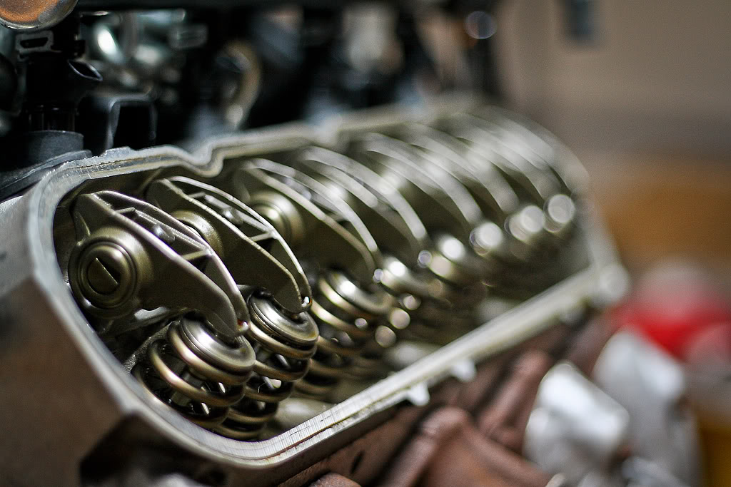

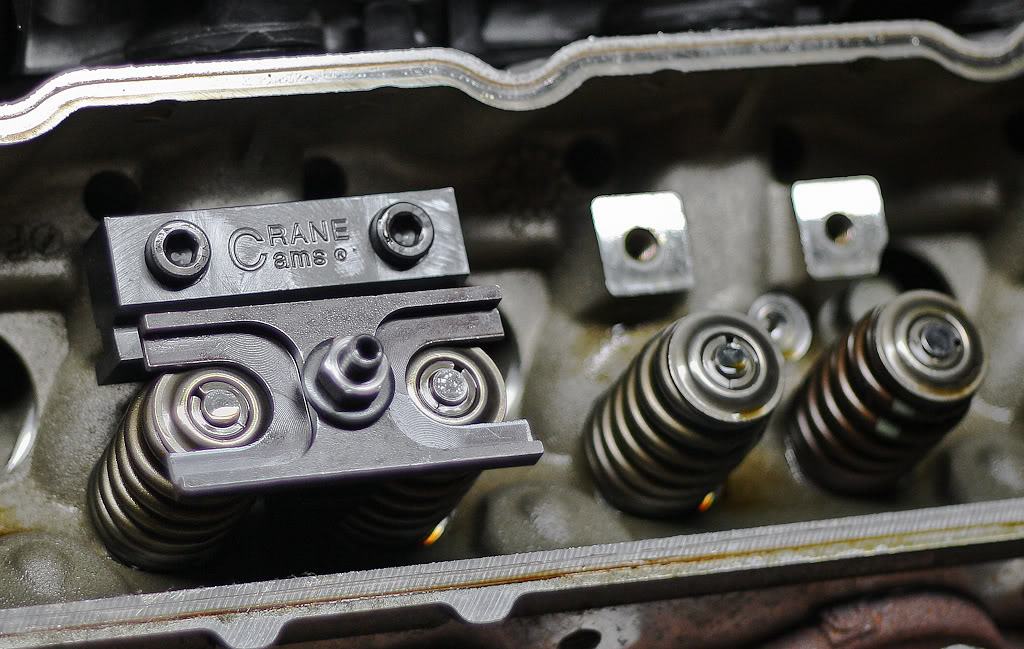

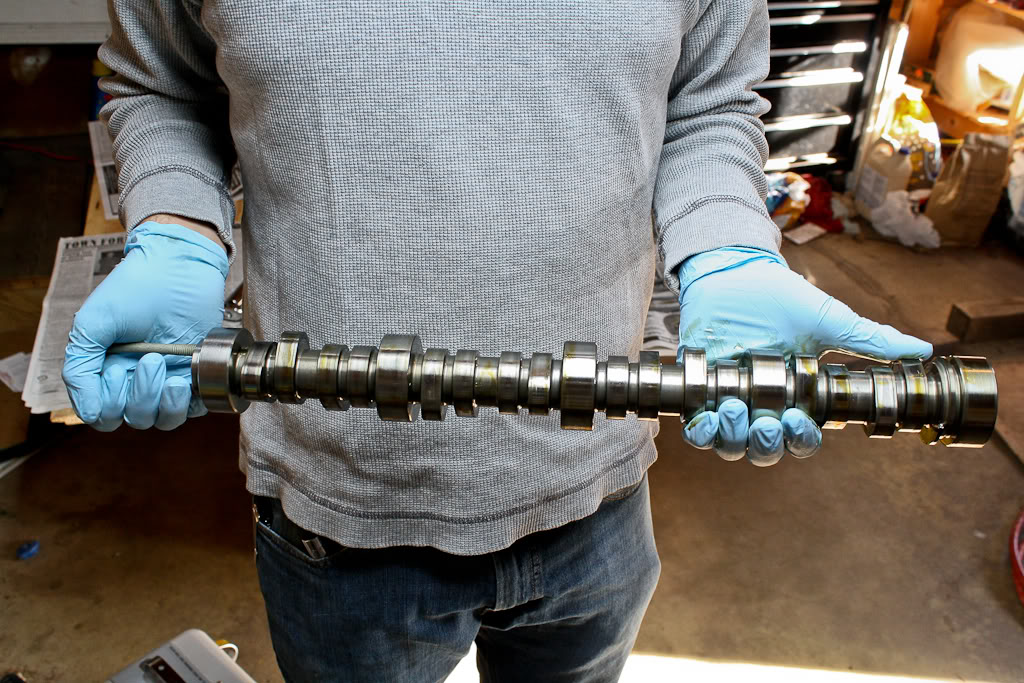

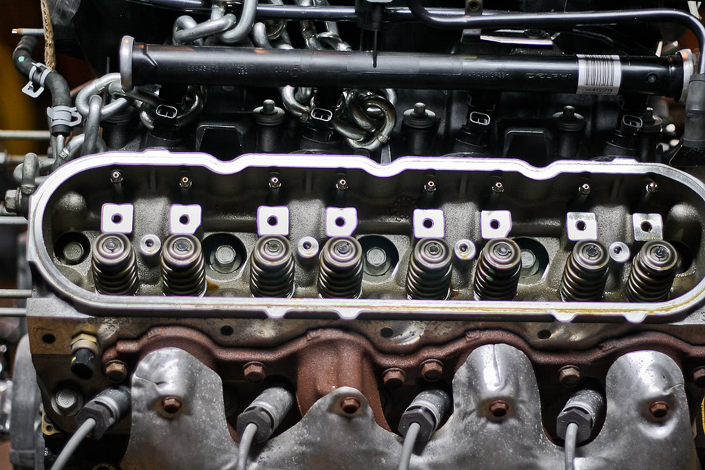

Did the valve springs a couple weeks ago, and the cam this past weekend.
PAC 1518s on the left.

Old springs.

Ooh, pretty.

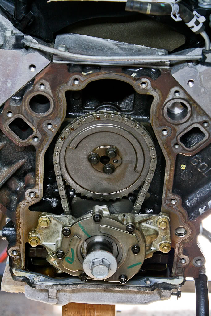

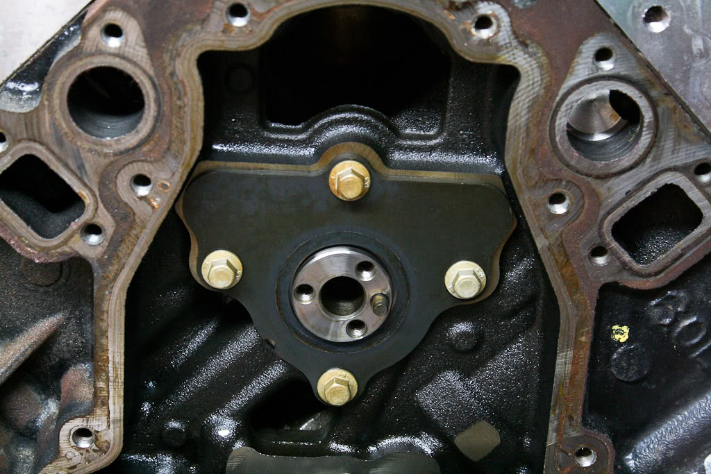

Cam install:
Timing cover off
Cam gear off, cam retainer plate visible

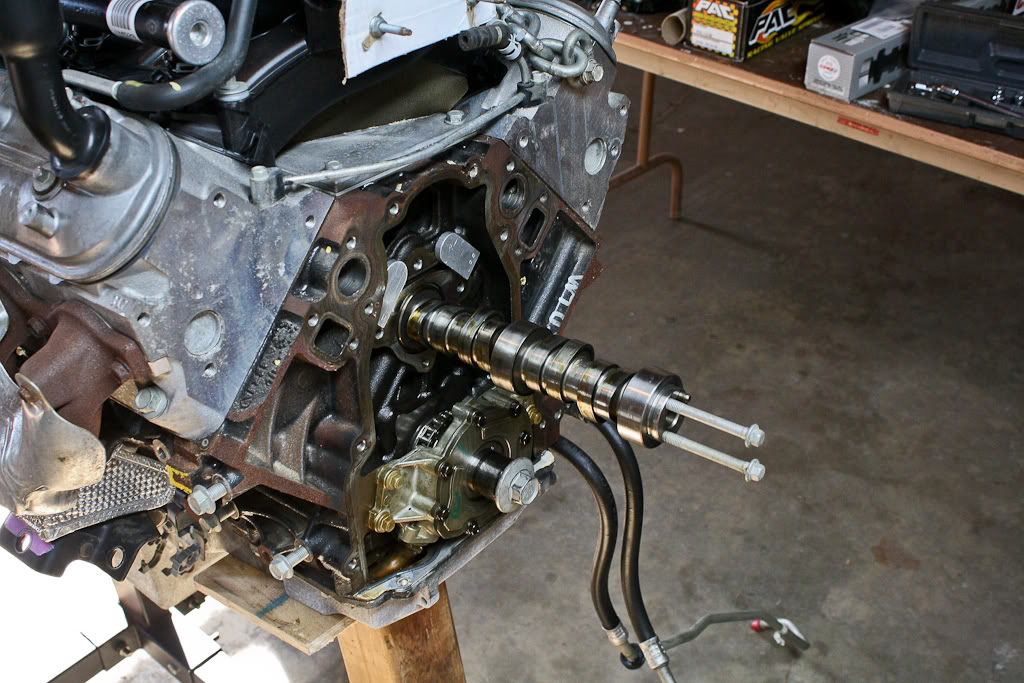

Old cam halfway out

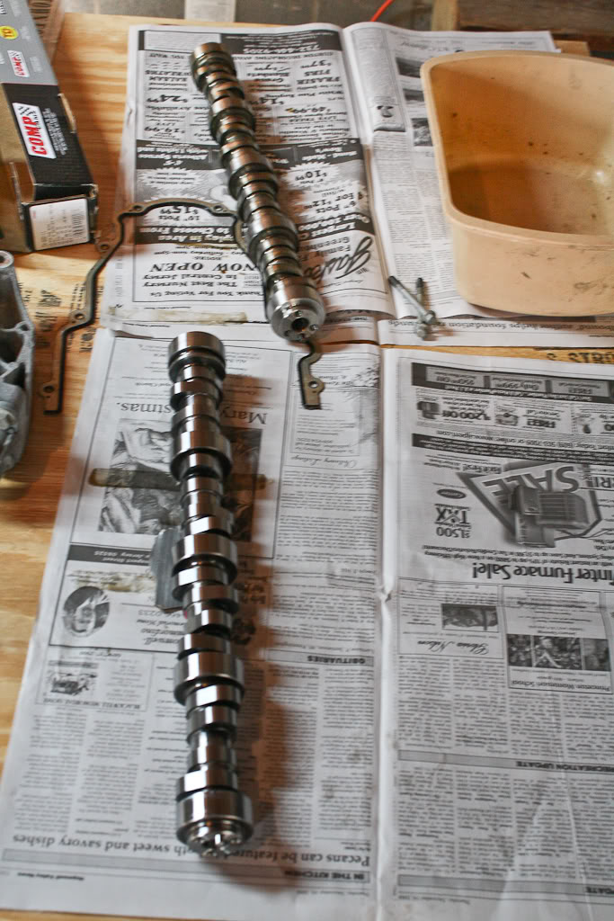

Old cam
Old cam in the background, new up front
And... Then I forgot to keep taking pictures.
The pushrods are in, rockers torqued back down, harmonic balancer installed, and I threw the coils back on.
HUGE thanks to Billy (BudHayes3) for letting me borrow the balancer puller, Crane valve spring compressor, and the JPR tools. Saved my ***.

216/224 .561/.568 114
