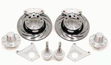

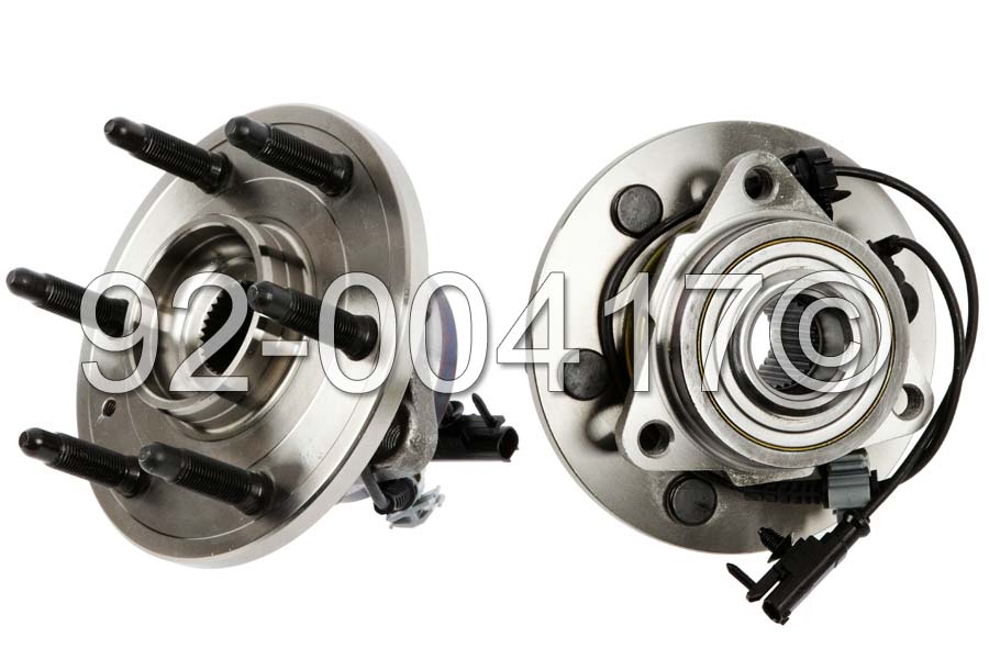

I want a setup similar(not exactly the same) to this
Instead of this
Just gives the option to run smaller, lighter weight drag brakes.

That's exactly what I want Phantom, what I'm planning on doing and testing is to buy the TRZ s10 spindles, with the aluminum steering arms of course, the strange pro drag brakes and since I already have aftermarket control arms I can switch ball joint on the upper control arm to fit the s10 spindle, and on the bottom as you all know the ball joint is pointing down as it goes into the stock spindle from top to bottom, SO... on my lower control arms I can flip the ball joint and use a reamer to open up the trz spindle to fit my ball joint and that's IF I can't find a ball joint that can work before using the reamer, I already made some measurement and the control arms should almost stay the same, even if not, I'll set the ride height that I want and order the coil overs... after all that is done I'll still send the control arms to get them in chrome-moly and fully adjustable, lower and upper...
Well that's my future plans after I get it running...lol
