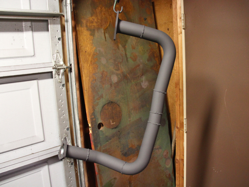

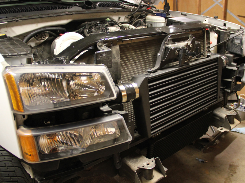

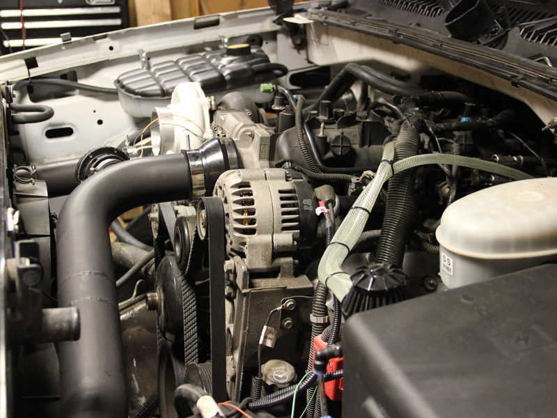

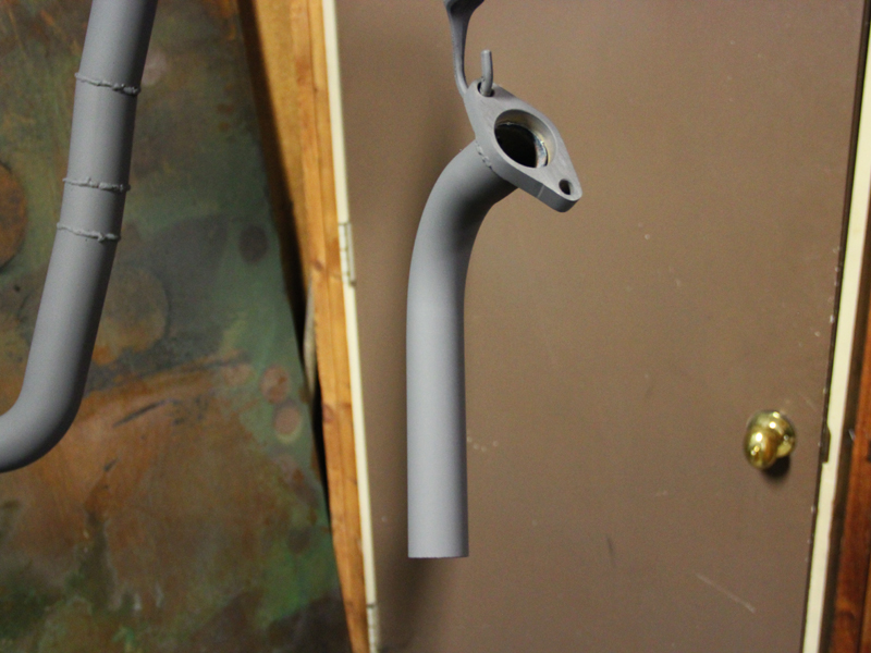

Over the last couple days some decent progress was made. I welded the dump tube last night and painted it and the crossover with high temp paint.
I also got the cold pipes mounted for what I hope is the last time and the blow off valve and IAT sensor installed. I still need to wire the IAT sensor though. I also finished wiring the fuel system.
Lastly, I put some of the front panels and the headlights put back on.
