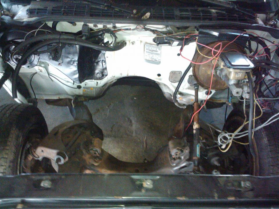

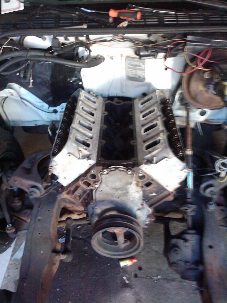

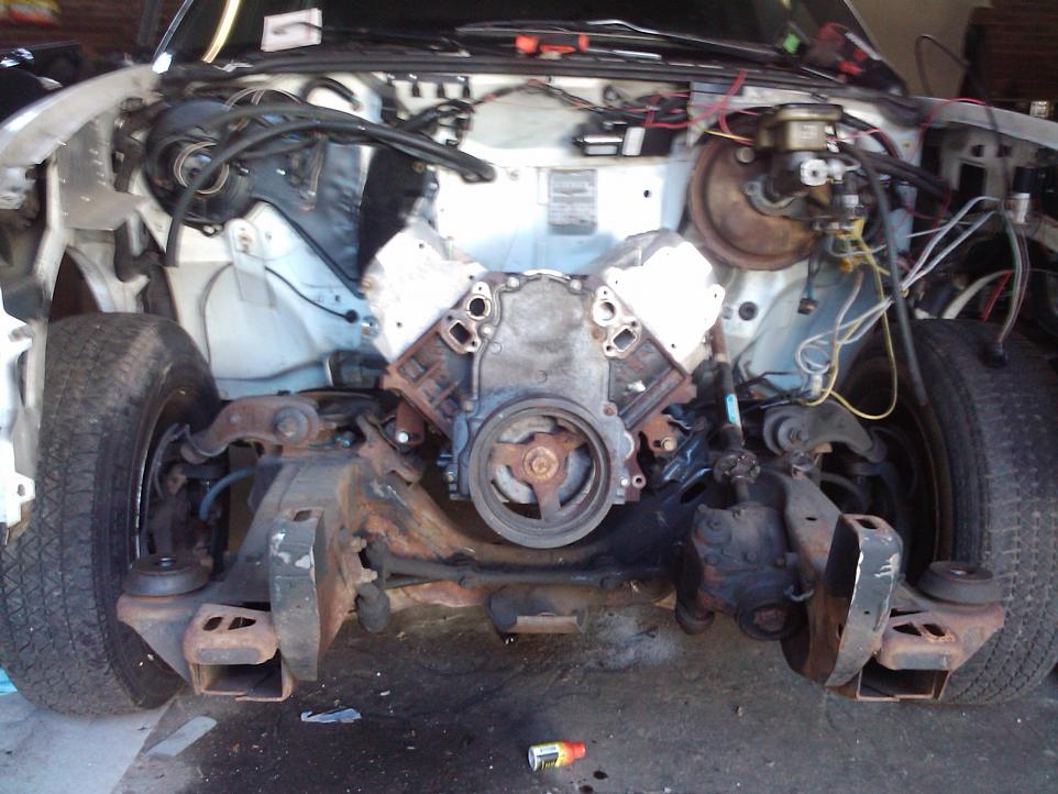

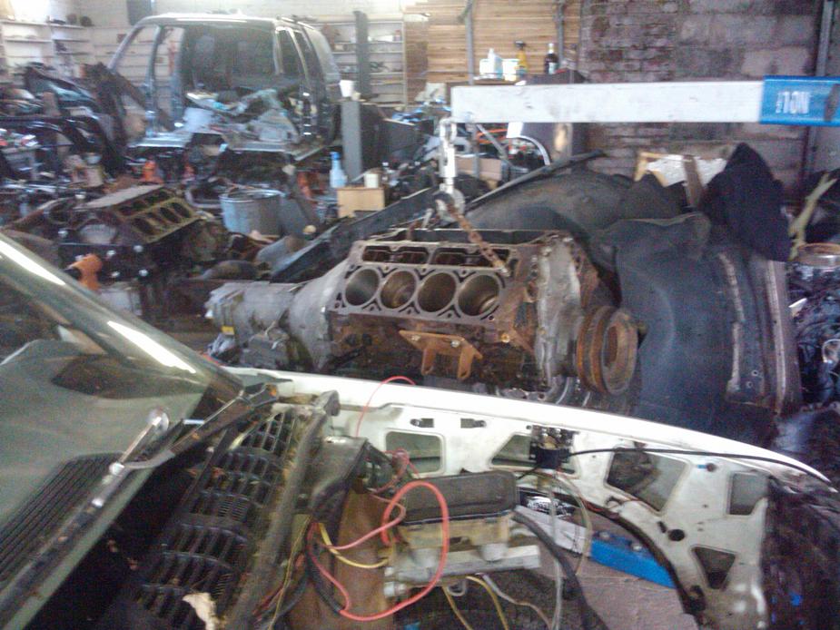

dropped my son off at 4 then got this done. removed rad support and hood, removed some of the wiring from the previous owner (everything he wired in he used red wire on everything!) cleaned it up a little . bolted my mock up 4l80e (empty) to my lq4 short block. had these mounts for two years never thought they would work so I figured I would try them and it worked!! here are some cell phone pics ... sorry bad quality
