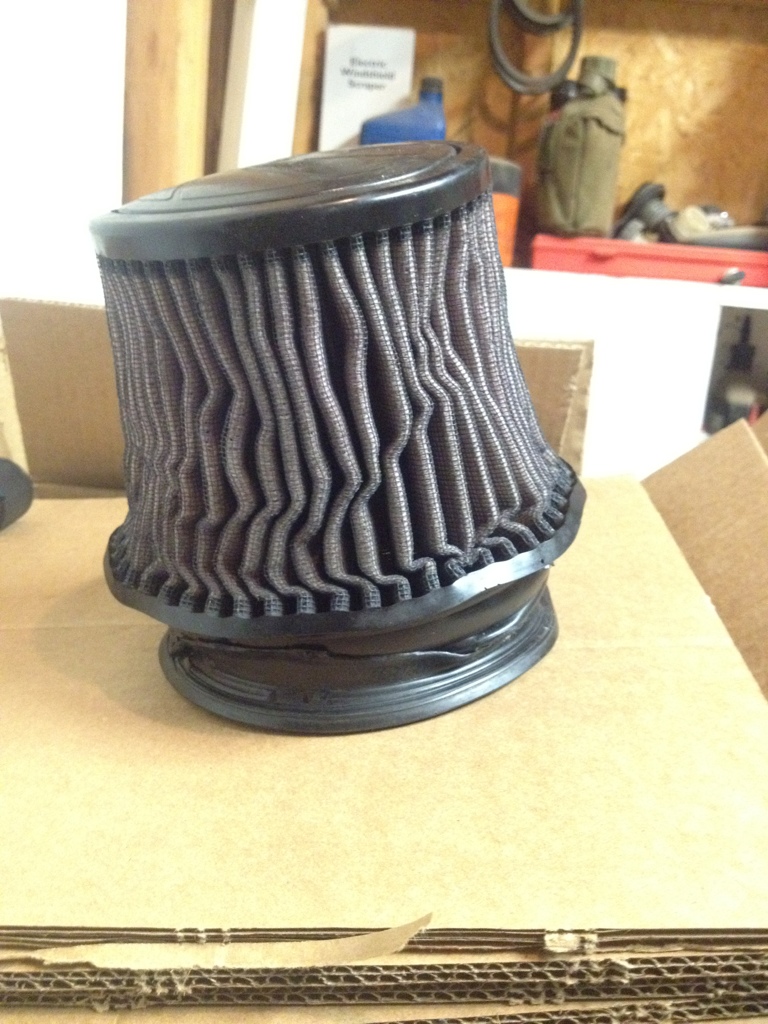

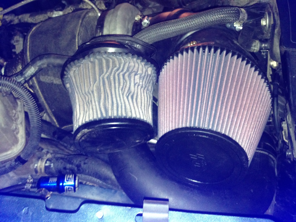

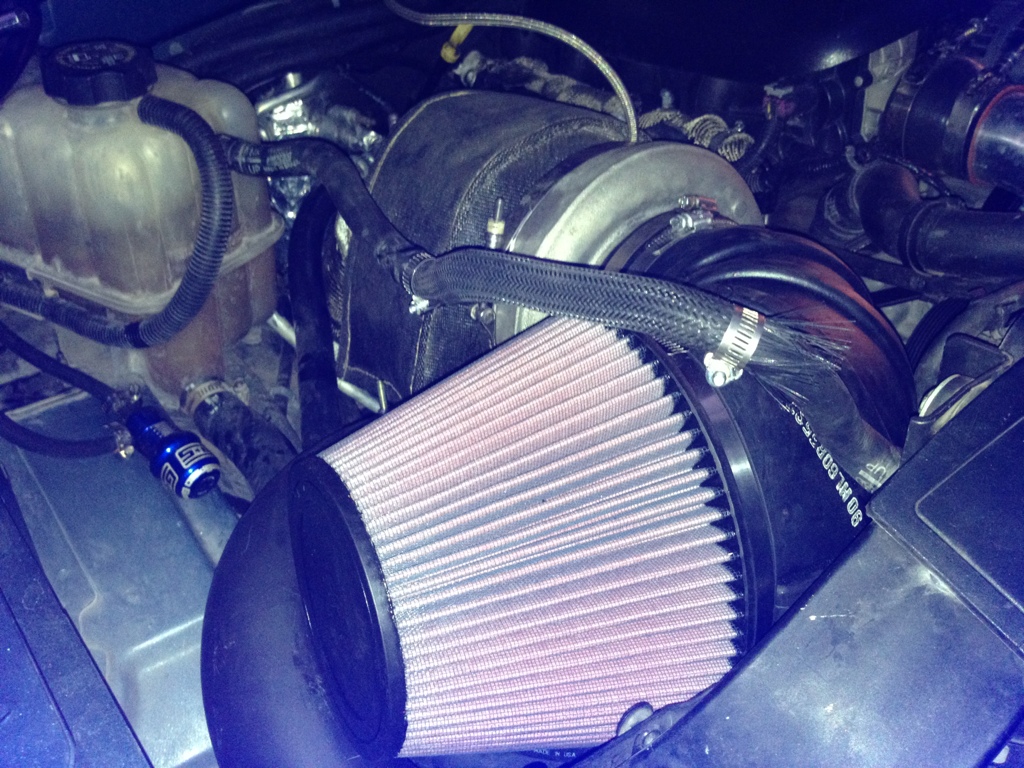

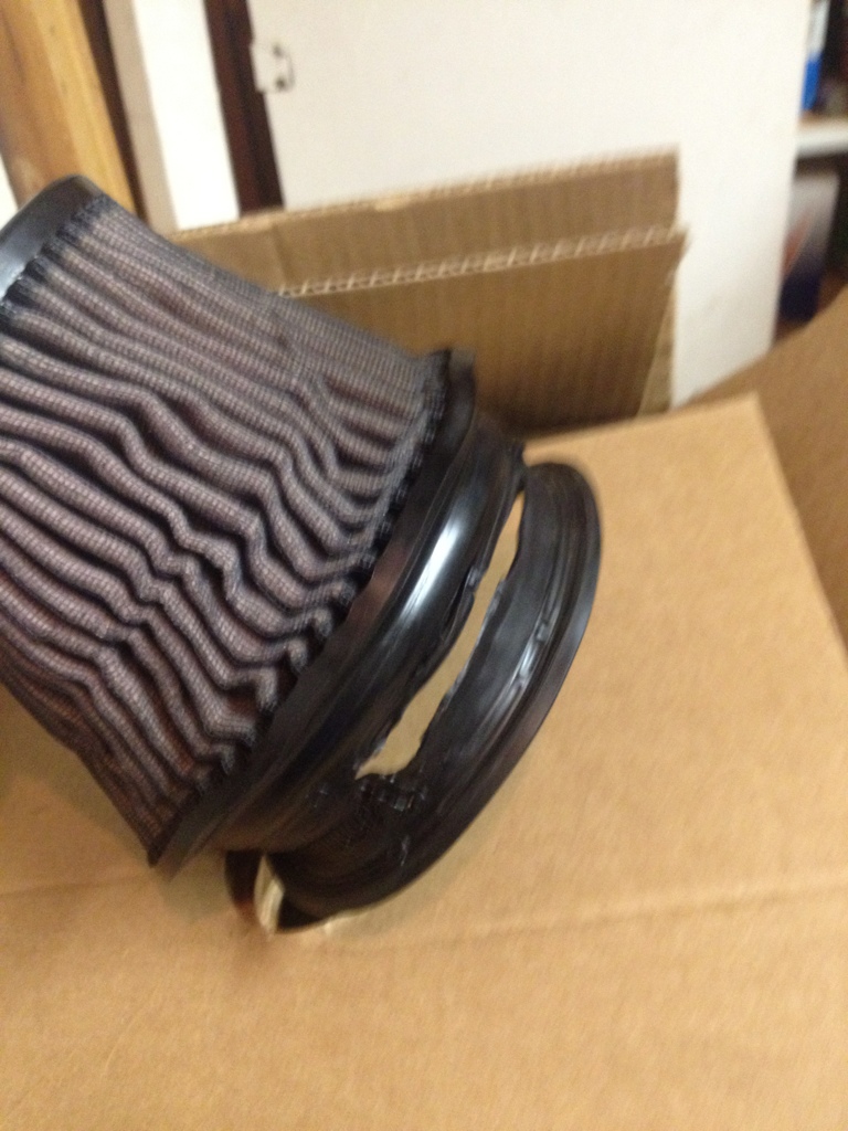

Then I took a look at my air filter, and well it was pathetic. Way to small and the rubber was re-formed from the heat and the filter it self seemed to get sucked into the turbo! So I order a 5.5" to 6" silicone elbow, and a 6" filter.
Seems to be a lot better set up. I should of took pix of my fuel set up but I did get one of my filter.
You can see the difference in filters
Hope to dyno soon, and new track times will come

Hope my fuel pump setup helped you out! The filter is scary looking

Which filter is scary ? The new or old one.
I'll get a better pic of old one. It's mangled lol
Wish I waited to order the filter until I had the elbow, I could of ordered the 10" long filter instead of a 6" long filter. It's still a 6" inlet filter so should be hell of a lot better.

The old filter.
I shouldve went with something bigger than 4" on mine but that barely fits by the fans so who knows...I take it off when I race anyway.

Yeah it was a tight fit, you can see in the pic, where the elbow hits the port on the radiator for the over flow, but it works.

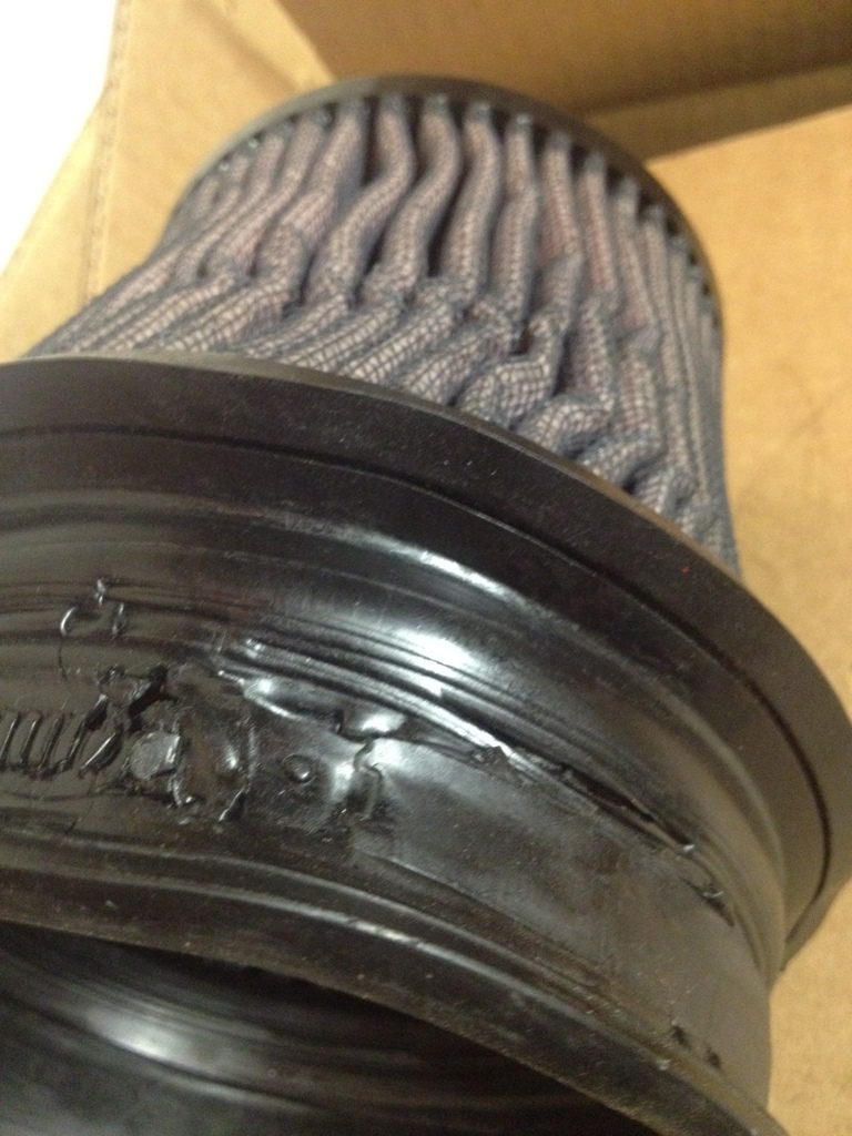

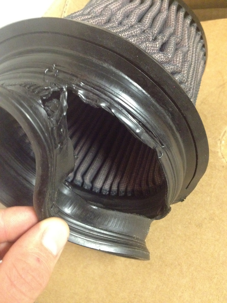

So here is the poor old filter

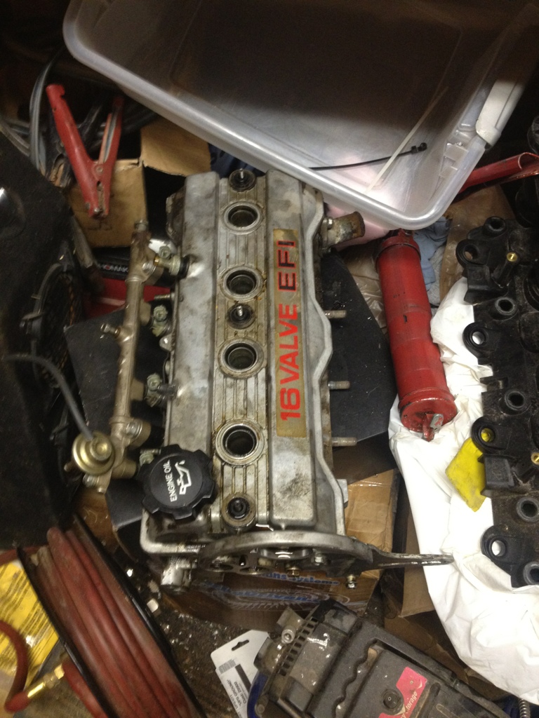

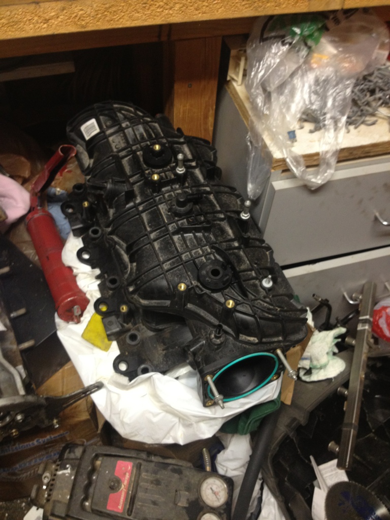

And here is my next project, just need a xlink
And my secret weapon! My new head
Kidding! But not really. It is my secret weapon, the head to my DD. I need to get it runnin soon!
