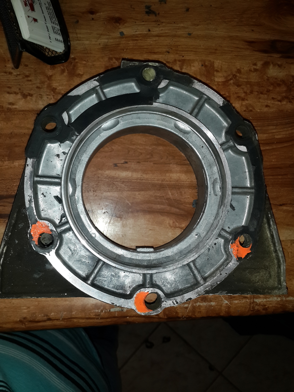

Quick question... So that transfer case is off a 6l80? The 4l80 bolted straight to it no problem?
Old May 18, 2015 | 11:20 AM
  #84
denalircsb's Avatar
Joined: Jan 2014
Posts: 78
From: Nanton AB
Yeah thats right, its of a 6l80 and all i had to do was modify 2 bottom holes of the spacer and it fitted right up!
Heres a pic of the spacer and the orange parts are where i had to modify but im just not sure which side it was so thats why i marked them both.

Cool thanks for the pic

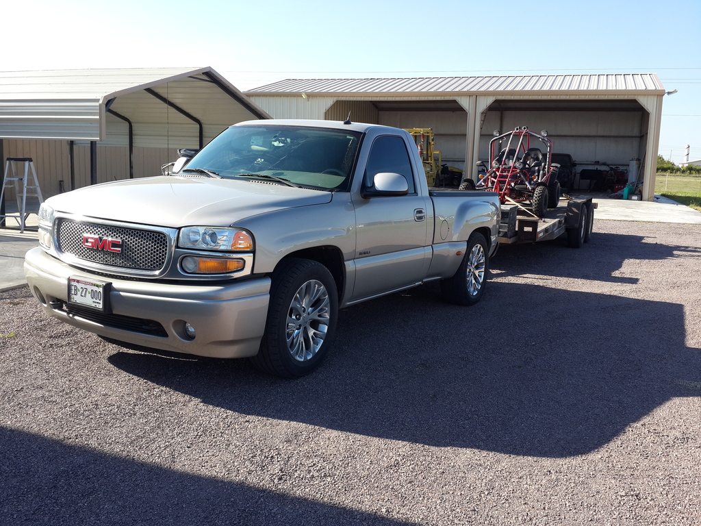

Thinking on getting the back 1" up cause i did some pulling and just putting the trailer on (pretty heavy trailer though) i was squating alot already here a pic of it.
is it just me or is the bed tweaking down in that pic also? i love this build, you did it right and it turned out awesome btw.
Old Aug 28, 2015 | 12:46 PM
  #90
denalircsb's Avatar
Joined: Jan 2014
Posts: 78
From: Nanton AB
Thanks man, and now that you mention it, it does look like that way but i think the problem was which i saw later that the hitch was not bolted on completely so the frame wanted to bend a bit n i think that might have been the problem!
