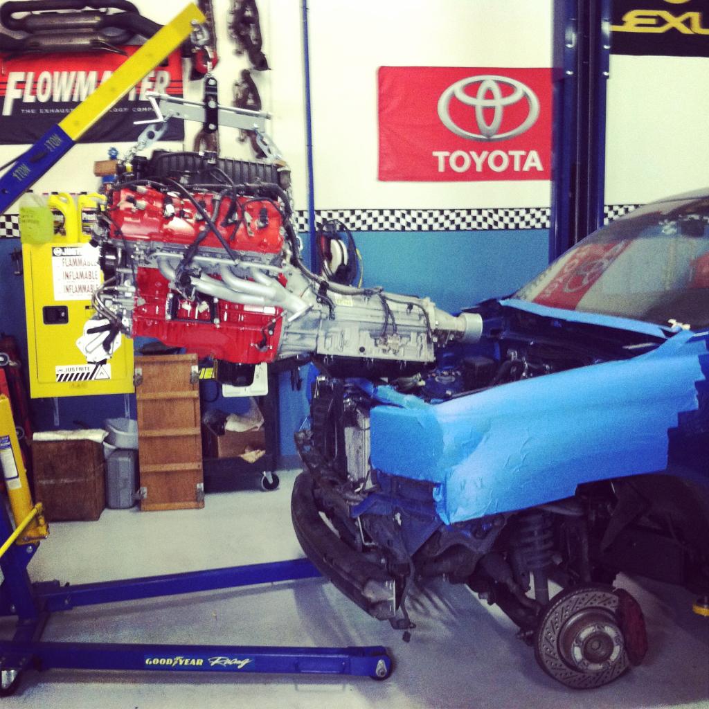

Cleaned the transmission case and mated the two. Went in last night.Name:  photo%201_zps9gznkypf.jpg

Not flex fuel, when this one came out it was not an option. They do have a forged crank, it's pretty beefy. 6 bolt mains. The other components were cast, good for stock, not for boost. It now has forged rods and pistons. Valve train was also upgraded. Going to be running the TRD tune for now, I'll be installing a Haltech elite standalone later when I have more cash so I can tune it and turn up the boost.
