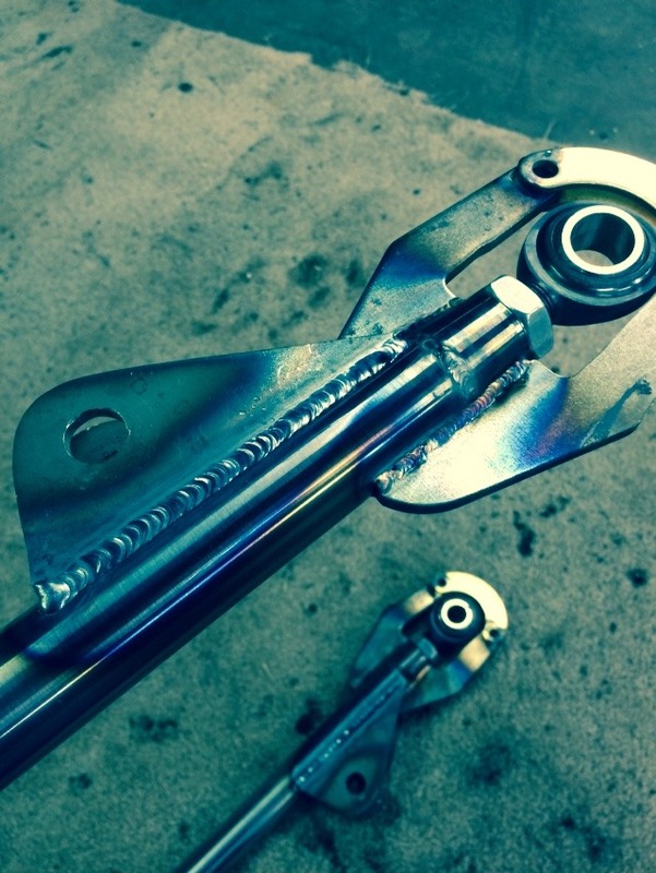

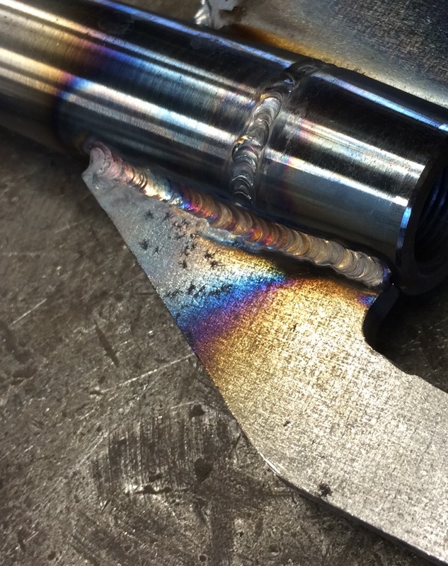

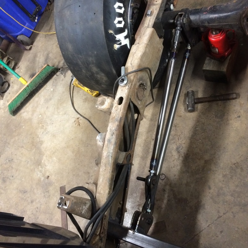

Safety straps tig welded around the front heim end

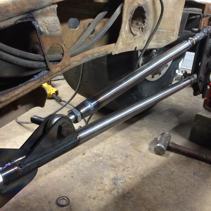

Upper ladder bar bracket

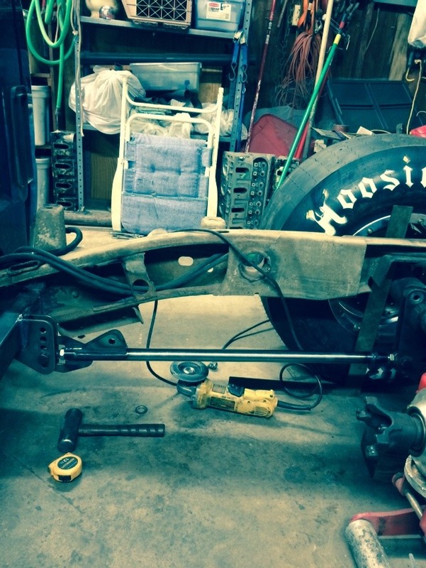

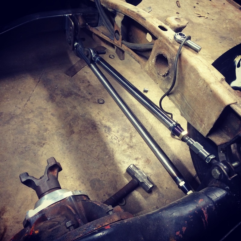

Bars bolted in place

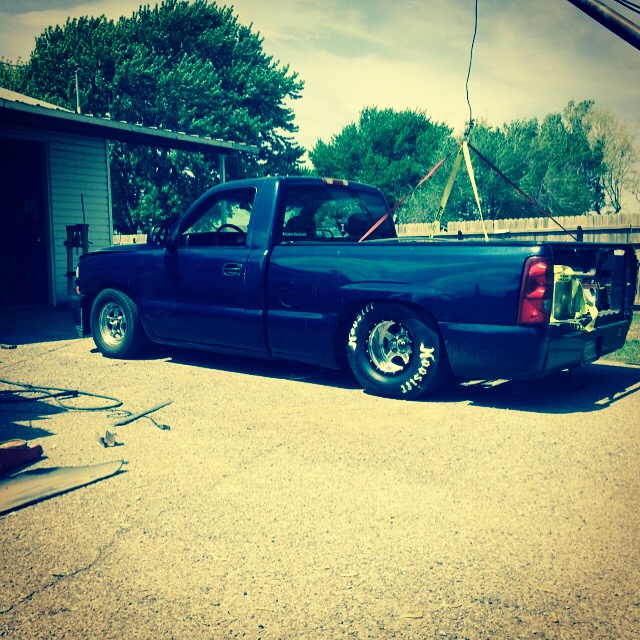

Got the bed set on it just to see how it looked.
