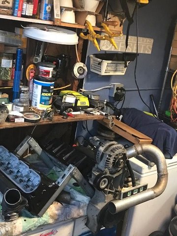

mock up turbo build
just clears going to heat wrap the crossover

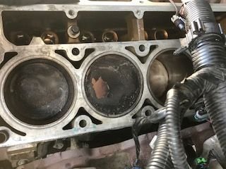

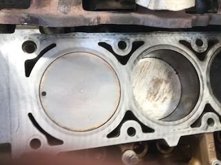

Well those of you doing the dod swap you need lifter traysthat have the slot on one side. I don’t have a part number as I lm going to call my local Cadillac gm parts and see if they have them. But if you look at the afm lifter trays or the block. One side of the lifter trays has a notch and the trays I have are flat and won’t sit right. So now I have to go get the right lifter trays and I’ll post back with part number and pics

heres the pic of the lifter tray notch oh can see on the photos where I got the pistons

That head jig is legit!
Thanks I know it’s not perfect but it’s close and the angel is correct and the distance between top of head to head and bottom to bottom of the heads are same distance as if they were mounted to the block. Just strut from my job lol
