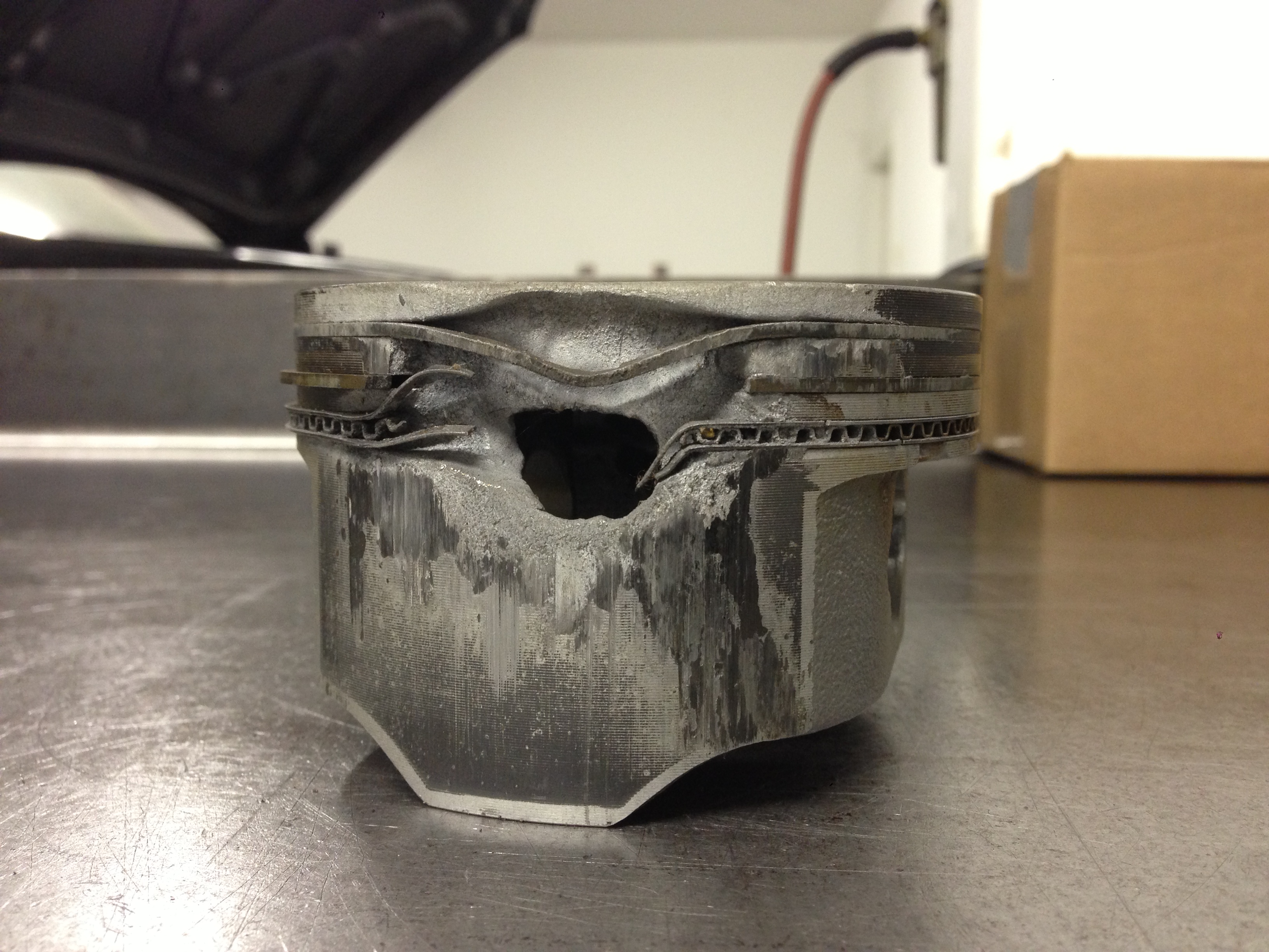

I was cleaning up some **** in the garage tonight and ran into this. This is what started it all........The original piston out of the truck with a staggering 14,000 miles on it.

Seems as youve always been a fan of buttload of timing
Yes I have, lol. However, that one wasn't my fault. Some guy named Jason that used to tune at a place called MTI in Houston did that. Blew up my brand new truck in less than 2 days. Told me it was safe.

Thats a shitty deal, what was all done to truck for it to melt like that

Like I said, truck was 100% bone stock with 14k miles on it.
I did a 4" cat-back exhaust that I made with a 4" magnaflow and part of a system for a diesel truck.
Fuel upgrades where a 255 in-tank with 44lb injectors (still returnless)
D1sc blower with their 3 core intercooler and a 4" pulley.
MTI charged me $725 for a dyno tune.
Thats it. Was planning on driving it like that for a while till I could figure out a different daily driver situation. Like I said, 2 days after they dyno tuned it, it blew up and I was out shopping for another new truck.
On MTI's dyno, it made 450 rwhp with the above mods. I have no idea of timing or air/fuel. I was there when they tuned it and I drove it home. Probably made about 10 dyno pulls and I got on hard about 10 times in those two days. I actually had the thing trailered back to them so they could put the scanner on it and see what the check engine light was. It showed miss fire on cylinder 7 (imagine that). Then proceeded to ask me what type of long block I wanted to build for it. I politely told them to **** off, did my own thing and learned to tune myself from that point forward. My next motor lasted 4 years with plenty of street driving/racing and eventually ran mid 10's at over 4500 lbs and never once had a valve cover off of it. I actually sold the motor to someone on here and last I heard it was in Indiana and still fine to this day.
